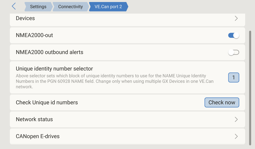

Warning
System voltage compatibility
While Victron components accept up to 70 V on their CAN-bus ports, some NMEA 2000 devices do not.
Many require a 12 V supply, and some may tolerate up to 30–36 V.
Before connecting, always check the datasheets of all NMEA 2000 devices in the system.
If lower network voltage is required:
Use the OSUKL 3802 VE.Can Adapter, or
Use the VE.Can to NMEA 2000 cable without its fuse, and supply power to the NMEA 2000 network using a separate 12 V NMEA 2000 power adapter cable (not supplied by Victron).
The VE.Can port on the GX device does not require external power to function.

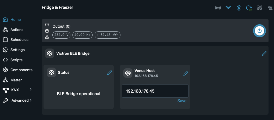

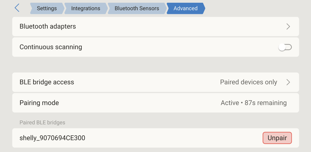

6.5.1. Extending Bluetooth Range

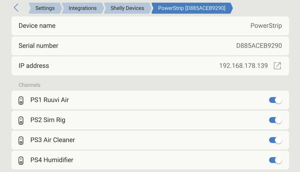

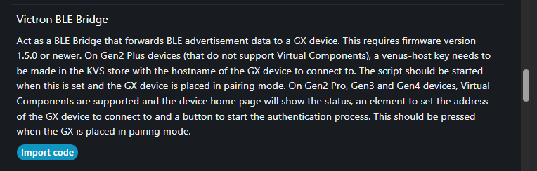

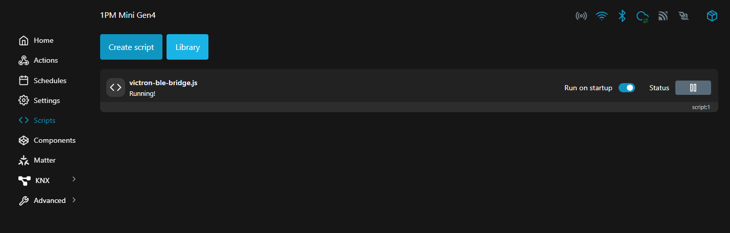

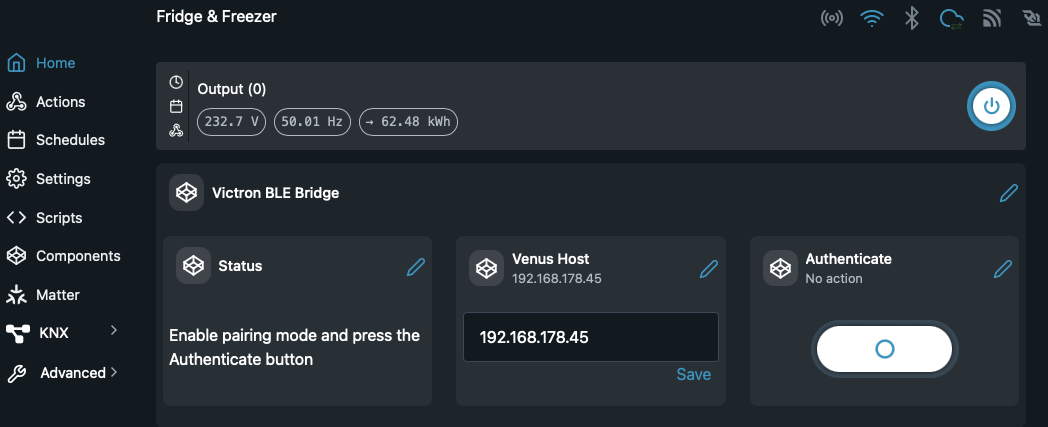

A Bluetooth sensor, or a Victron product connected over Bluetooth, needs to be within Bluetooth range of the GX device, or of whichever Bluetooth receiver is being used, to be read out. Where that range is not enough, it can be extended in two ways: with a USB Bluetooth adapter on a long USB extension cable, as described earlier, or with a compatible Shelly device acting as a Bluetooth receiver.
A Shelly device used this way receives the Bluetooth data locally and forwards it to the GX device over wired Ethernet or Wi Fi, rather than over Bluetooth itself. This removes the Bluetooth distance limitation between the sensor or device and the GX device, since only the short distance between the sensor and the Shelly device still needs to be within Bluetooth range.
Supported devices
Extending Bluetooth range with a Shelly device works for every device supported by the Bluetooth Sensors integration:
Supported Bluetooth Smart sensors: Ruuvi, Mopeka, Safiery, Gobius, and Garnet
Victron SolarSense 750
smallBMS NG, VE.Bus BMS NG
Requirements
A compatible Shelly device, running Shelly firmware v1.15.0 or later:
Plus 1, Plus 1PM, Plus 2PM, Plus Plug S, Plus i4
Pro 1, Pro 1PM, Pro 2, Pro 2PM, Pro 3, Pro 4PM
1 Gen3, 1PM Gen3, 1 Mini Gen3, 1PM Mini Gen3, Plug S Gen3
1 Gen4, 1PM Gen4, Mini Gen4 (when not running in Zigbee mode)
BLU Gateway, BLU Gateway Gen3

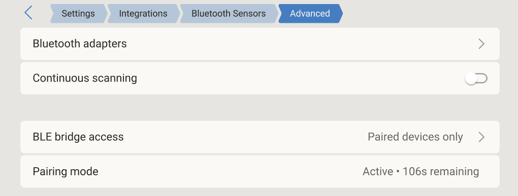

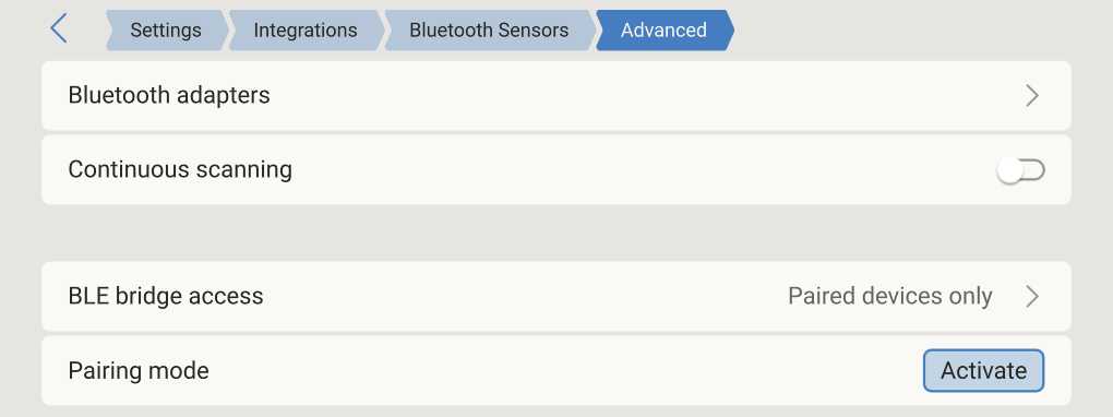

6.5.2. Configuration
Mopeka, Safiery, Gobius, and Garnet sensors do not include a sequence number, and can repeat the same reading several times. To avoid switching back and forth unnecessarily, the GX device waits until the local Bluetooth adapter has not received anything from that device for 2 seconds before reporting its data through the Bridge instead.
Configuring a Shelly Gen2 Pro, Gen3, Gen4, or BLU device
Configuring a Shelly Gen2 Plus device
Configuring the GX device

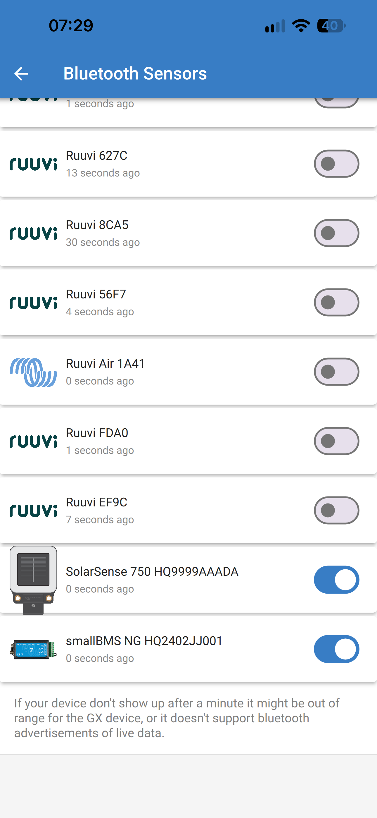

Via VictronConnect v6.40 or later:

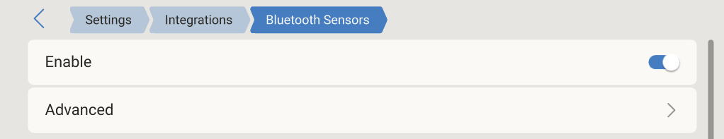

Connect to the GX device over Bluetooth.
Go to Settings → Bluetooth Sensors and enable the desired devices.
Via the GX user interface:
Open the user interface of the GX device, either on its own screen or through the Remote Console.
Go to Settings → Integrations → Bluetooth Sensors and enable the desired devices.
Switching between the local Bluetooth adapter and the Bridge
Where a device can be reached both directly over the GX device’s own Bluetooth adapter and through a Shelly Bridge, the GX device decides automatically which of the two to report data from.
RuuviTag sensors and the SolarSense 750 include a sequence number in each message, so the GX device always knows which reading is the newest, and switches to it immediately.

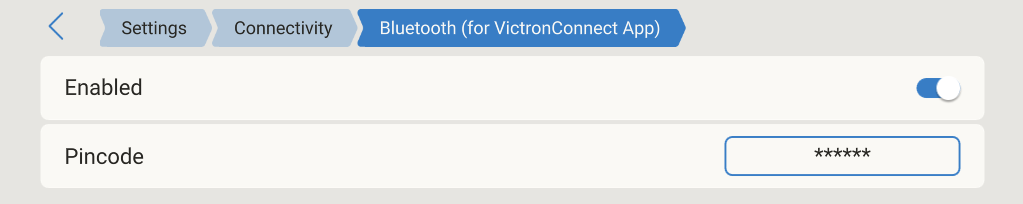

The Bluetooth PIN of the GX device
The smallBMS NG and/or VE.Bus BMS NG already connected to at least once in VictronConnect
Connecting directly to the BMS allows VictronConnect to store its encryption key. The GX device needs this key to read the transmitted data.

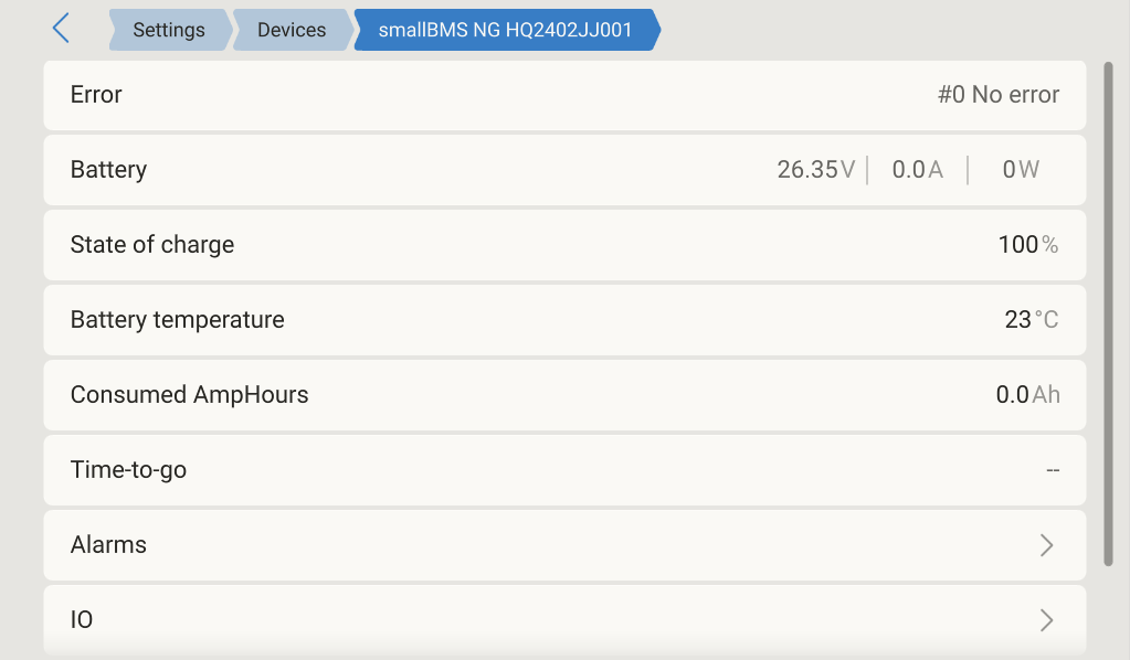

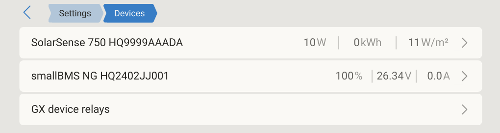

Once synchronised, the BMS appears in the Device List of the GX device. The same list of sensors is also available on the GX device under Settings → Integrations → Bluetooth Sensors, where each enabled BMS is shown with its switch enabled. If a BMS does not appear in the list within a minute, it is either out of range of the GX device or its instant readout is not enabled. | ![]() |

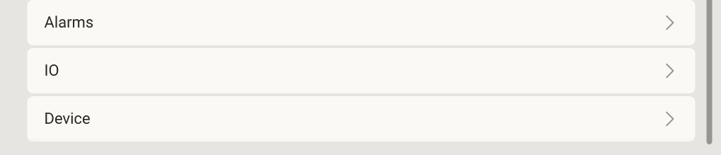

Available data

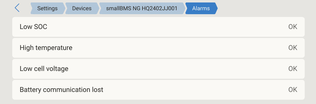

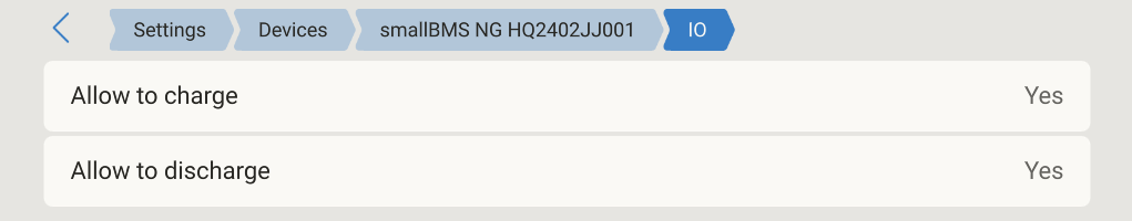

The BMS has its own entry in the Device List, showing state of charge, voltage and current at a glance. Opening the entry shows:
Three submenus provide further detail:

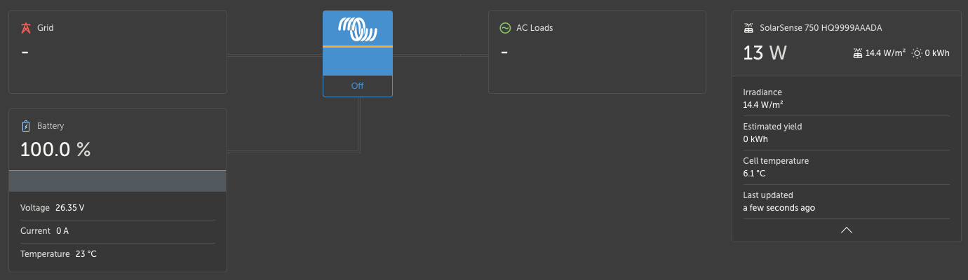

The battery data is also shown on the GX device overview and on the VRM portal. | ![]() |

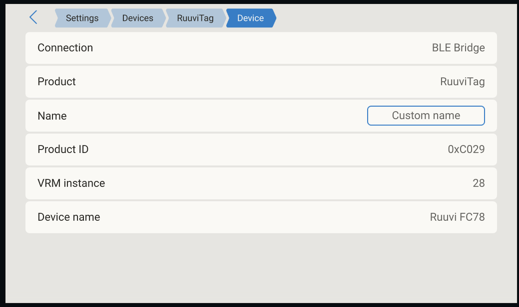

6.9. Wireless Bluetooth Ruuvi temperature sensors
Ruuvi sensors transmit temperature, humidity, and atmospheric pressure wirelessly to a GX device via Bluetooth.
To connect the sensor to the GX device via Bluetooth, the GX device needs Bluetooth functionality. For more information on Bluetooth requirements, limitations, and compatible USB Bluetooth adapters, see the Bluetooth connectivity requirements section.
Installation procedure Ensure Bluetooth is enabled in the Bluetooth menu (enabled by default). To do this, go to Settings → Integrations → Bluetooth Sensors, and click 'Enable' to activate Bluetooth temperature sensors. The Bluetooth adapters submenu displays a list of available Bluetooth adapters. The 'Continuous Scanning' option allows for constant scanning of new Bluetooth sensors. However, be aware that enabling this option can affect the WiFi performance of the GX device. Only enable it if you need to search for new Bluetooth sensors; otherwise, it’s best to keep it disabled. The sensor will appear in the menu as 'Ruuvi ####' with a 4-digit hexadecimal device ID. Enable the specific Ruuvi sensor. Any previously installed and activated sensors will be displayed with their user-defined names, if set. The sensor should now be visible in the Device list - by default, it is labelled 'RuuviTag' In the temperature sensor setup menu, you can adjust the type (choose between Battery, Fridge, and Generic). The Device menu allows you to set a custom name for the sensor and provides additional information such as connection type, Product ID, and VRM instance. Battery Life and Status for Ruuvi Sensors: Ruuvi sensors use a replaceable CR2477 3V lithium coin cell, which typically lasts over 12 months, depending on the ambient temperature.
Low Battery Warning: A low battery warning will appear on the Remote Console. If the GX device reports to VRM, the warning will also appear there. The warning threshold is temperature-dependent:
You can update the Ruuvi's firmware using Ruuvi's dedicated phone app, though this is only necessary if you're experiencing issues. |

6.11. Connecting IMT Solar Irradiance, Temperature and Wind Speed Sensors
IMT Technology GmbH offer a range of digital silicon irradiance sensor models within the Si-RS485 series, all of which are compatible with GX devices.
Compatibility
The optional sensors external module temperature, ambient temperature, and wind speed are also supported.
These optional sensors can be connected to the solar irradiance sensor via pre-installed plugs or pre-wired connections (for module temperature and ambient temperature only). When external sensors are connected through an appropriate solar irradiance sensor, all measurement data is transmitted to the Victron GX device using a single interface cable.
Each model in the Si-RS485 series of solar irradiance sensors varies in its compatibility with external sensors (some come pre-wired with external sensors), so it’s important to carefully consider future needs and requirements before making a purchase.
It is also possible to connect an independent IMT Tm-RS485-MB module temperature sensor (displayed as ‘cell temperature’) or IMT Ta-ext-RS485-MB ambient temperature sensor (displayed as ‘external temperature’) directly to the Victron GX device, either without a solar irradiance sensor or alongside one.
Operation
The IMT Si-RS485 series solar irradiance sensors utilise an RS485 electrical interface and the Modbus RTU communication protocol.
To operate correctly, the Victron GX device must be running version 2.40 or later. IMT sensors with firmware versions earlier than v1.53 are also supported; for more information, please contact IMT.
The physical connection to the Victron GX device is made via a USB port and requires a Victron RS485 to USB interface cable.
A suitable external DC power source (12 to 28 VDC) is also required, as the sensor is NOT powered via USB.
Recent IMT models feature a second temperature sensor, which is also supported.
Wiring Connections
The schematic in the installation guide below illustrates the wiring configuration for a typical installation.
Wire connections
Si-Sensor | Victron RS485 to USB interface | Signal |
Brown | Orange | RS485 Data A + |
Orange | Yellow | RS485 Data B - |
Red | - | Power Pos - 12 to 28VDC |
Black | - | Power Neg/Gnd - 0VDC |
Black (thick) | - | Ground / Cable Shield / PE |
- | Red | Power Pos - 5VDC (not used) |
- | Black | Power Neg/Gnd - 0VDC (not used) |
- | Brown | Terminator 1 - 120R (not used) |
- | Green | Terminator 2 - 120R (not used) |
Installation Notes
The maximum DC power supply voltage permitted for the IMT Si-RS485 series solar irradiance sensor range is 28.0VDC. For 24V and 48V battery banks/systems, an appropriate Victron DC-DC converter (24/12, 24/24, 48/12 or 48/24), or AC-DC adapter must be used in the installation.
For 12V battery banks or systems, the IMT Si-RS485 series solar irradiance sensors can be powered directly from the battery bank and will continue to operate down to a minimum voltage of 10.5V (as measured at the sensor, please account for voltage drop in the cable).
For detailed wiring, installation notes, and specifications, refer to the IMT Si-RS485 series solar irradiance sensor 'Quick Reference Guide' and the Victron RS485 to USB interface cable ‘Datasheet’.
To ensure signal integrity and robust operation, please adhere to the following guidelines:
Extension cabling must comply with the minimum cross-sectional area specifications listed in the related table, depending on DC supply voltage and cable length.
Extension cabling should have appropriate shielding and twisted pair cores.
If the total cable length exceeds 10m or if there are installation-specific interference issues, the original cable attached to the Victron RS485 to USB interface should be reduced to a maximum length of 20cm. In such cases, use high-quality cabling for the entire length, rather than just the extension.
Ensure that cabling is installed separately from main DC or AC power cabling.
All wiring must be properly terminated (including unused wires) and adequately isolated from weather and water ingress.
Do not open or tamper with the sensor housing during installation, as this will compromise sealing integrity and void the warranty.
The IMT Si-RS485TC series solar irradiance sensor features internal galvanic isolation (up to 1000V) between the power supply and RS485 Modbus circuits, making the non-isolated Victron RS485 to USB interface suitable for most installations.
However, if an isolated RS485 to USB interface is preferred, the only compatible device is Hjelmslund Electronics USB485-STIXL (other type will not be recognised by the GX device).
Multiple Sensors
It is not possible to connect multiple IMT Si-RS485 series solar irradiance sensors to a GX device; additional sensors will be ignored.
Configuration
Generally, no special or additional configuration is required - the default 'as shipped' configuration is compatible for communication with a Victron GX device.
However, if the IMT Si-RS485 series solar irradiance sensor has been previously used in another system or if the settings have been changed for any reason, it is necessary to restore the default configuration before further use.
To revise the configuration, download the IMT 'Si-MODBUS-Configurator from the software downloads section. Follow the instructions in the Si-Modbus-Configurator manual, download from the same link and check or update the following settings:
MODBUS Address: 1 | Baud Rate: 9600 | Data Format: 8N1 (10 Bit) |
For further support related to configuration of the IMT Si-RS485 Series irradiance sensors, please contact IMT Technology directly.
User Interface - GX device
Once the Victron GX device is connected and powered on, the IMT Si-RS485 Series irradiance sensor will be automatically detected within a few minutes and will appear in the 'Device list' menu. |
Within the ‘IMT Si-RS485 Series Solar Irradiance Sensor’ menu, all available parameters will be automatically displayed (depending on the connected sensors) and will update in real time. |
Within the ‘Settings’ sub-menu, you can manually enable or disable any optional or additional external sensors connected to the IMT Si-RS485 Series irradiance sensor. |
Data Visualisation - VRM
To view logged historical data on the VRM portal, expand the ‘Meteorological Sensor’ widget list and select the ‘Meteorological Sensor’ widget. | ![]() |
Data from all available sensor types will be automatically displayed in the graph. You can enable or disable individual sensors or parameters by clicking on their names in the legend. | ![]() |

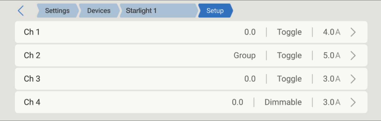

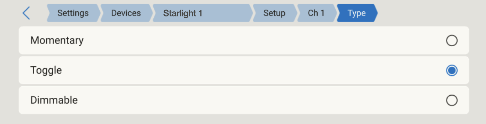

Once connected and powered, the SmartSwitch DC4 will appear in the Devices list on the GX device. The SmartSwitch device page displays:
A dedicated Setup menu allows configuration of each channel individually. On each individual channel page in the Setup menu, the following options are available:
Grouping outputs
Each channel can be grouped by assigning a group name on the channel’s setup page. Channels with the same group name are displayed together in a single group card on the Switch pane. This makes it easy to combine related outputs, for example, grouping all lighting channels under one tile. Channels without a group name will appear in a card labelled with the module name. | ![]() |

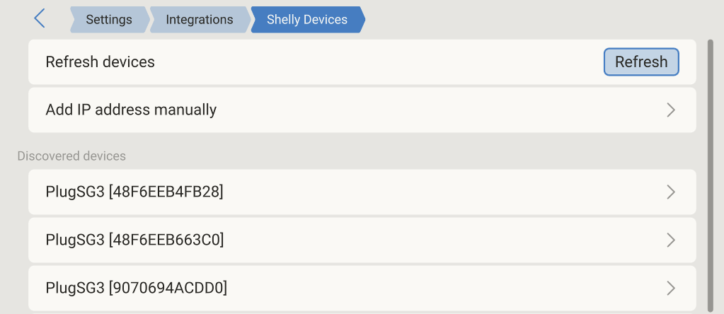

6.14. Shelly Energy Meters & Switches support
Venus OS supports Shelly Gen2 and later devices that provide digital switching, dimming, RGBW control, energy metering, or a combination of these features. Sensors and other Shelly hardware are not supported.
Detected Shelly devices are disabled by default and must be enabled manually.
Depending on the model, the Shelly appears in Venus OS as a switch, an energy meter, or both.
Features
Auto-discovery of Shelly devices in the same network as the GX over mDNS.
Shelly devices are integrated over the local network. In most cases, compatible Shelly devices are discovered automatically via mDNS. The GX device then connects to the Shelly device via its WebSocket endpoint.
Manually adding Shelly devices by submitting an IP address. If a device is not discovered automatically, it can be added manually by entering its IP address.

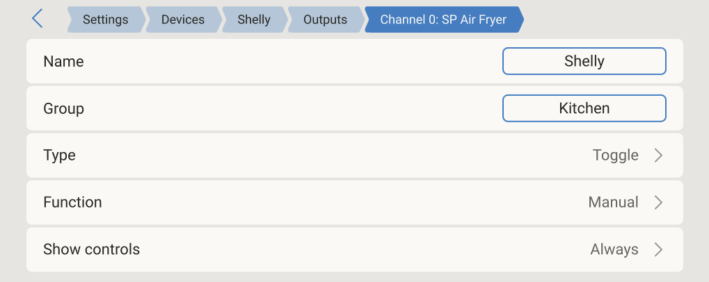

Enabling/disabling individual channels.
Switching the output from the switching pane in the GUI. The output type depends on the device capabilities (simple switching device supports momentary and toggle, RGBW supports the RGBW and RGB color wheel).
Naming the device and channel. The Shelly device name is synchronised with the service custom name. For switching outputs, the channel name is synchronised with the output’s custom name.
Using a dedicated EM (one without switching capabilities) with one of the following roles: Genset, AC load or PV Inverter. Note that the Grid role is not supported.
An energy metering device with switching capabilities (like Shelly plus plug S) only supports the EM role AC load.
Supported Shelly devices
The following devices have been tested to work correctly:
Shelly plus plug S (SW +EM)
Shelly Pro 4PM (SW +EM)
Shelly Pro 1PM (SW + EM)
Shelly Pro 3EM (3 phase EM only)
Shelly 1PM Gen4 (SW + EM)
Shelly Mini 1PM Gen4 (SW + EM)
Shelly Mini 1 Gen4 (SW only)
Shelly Dimmer Gen3 (Dimmable AC load switch)
Shelly Plus RGBW PM (Dimmable 4-channel RGBW controller).
Shelly Gen3 CCT & Multicolor Bulbs
Notice
Shelly devices using the Z Wave protocol are not supported by GX devices. These devices will not function when connected, regardless of firmware version.
Limitations
Password-protected devices are not supported. Shelly devices secured with a password will not appear in the device list.
Device and channel naming: It is not possible to assign individual names to each EM channel of a multi-channel device. The channel name is synchronised with the Shelly device name. This only affects multi-channel EM devices (with or without switching), such as the Pro 4PM.
For EM devices with a potential-free contact (for example Pro EM50), only the potential-free contact is shown as a switching channel.
Single-channel EM devices are not supported (for example Shelly 1 EM Mini Gen4).
Shelly add-ons are not supported.
Connecting to or configuring a Shelly device via Bluetooth is not supported.

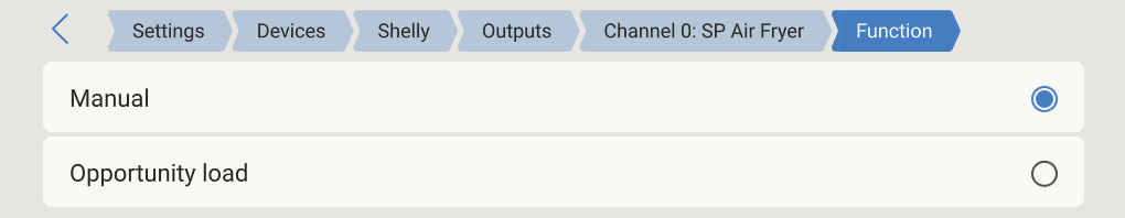

Using Shelly switching devices for special functions (for example Opportunity Loads, Generator start/stop, alarm relay, etc.) is supported on devices that expose these functions. The available functions depend on the device capabilities and can be configured in the channel's setup menu. Devices that only support the Manual function will not show the Function option. Advanced automation can also be implemented using Node-RED.
6.14.1. Installation
Installing a Shelly device is straightforward. First, follow the Shelly installation instructions and connect the Shelly device to the same network as the GX device. Once this is done, continue with the steps below to complete the setup on the GX device.
The device submenu provides additional information:
6.14.2. Configuration
Depending on the Shelly device type (switch, dimmer, RGBW controller, or energy meter), the available configuration options and display settings differ. As a result, some menus shown in this chapter may not appear on all systems.
Shelly switches
Shelly energy meters Use the GX device menus to configure how the Shelly energy meter is used and how it is displayed.
6.14.3. Monitoring
Depending on the Shelly device type and channel configuration, Shelly devices can be monitored (and, where supported, controlled) in the following locations:

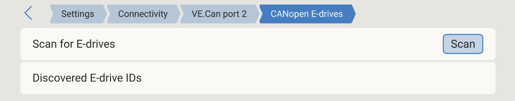

6.17. CANopen E-drive support
Venus OS provides support for Sevcon Gen4 AC, Curtis F series, and Curtis E/SE series motor controllers. This enables communication and E-drive data reporting via D-Bus to The Boat Page.
Features
Works out of the box without requiring motor controller configuration.
Supports Sevcon Gen4 AC, Curtis F series, and Curtis E/SE series controllers.
Displays motor power, speed (rpm), direction, temperature, torque, and controller temperature.
Automatically detects compatible motor controllers via CAN bus scan.
Supports multiple controllers on the same CAN bus (each controller requires a unique CANopen node ID).

6.17.4. How to configure the Victron GX device
Requirements
Venus OS version 3.70 or later is required.
Configuration
Troubleshooting
If no controllers are found:
Verify CAN bus wiring and termination
Verify the selected CAN-bus profile matches the controller baud rate

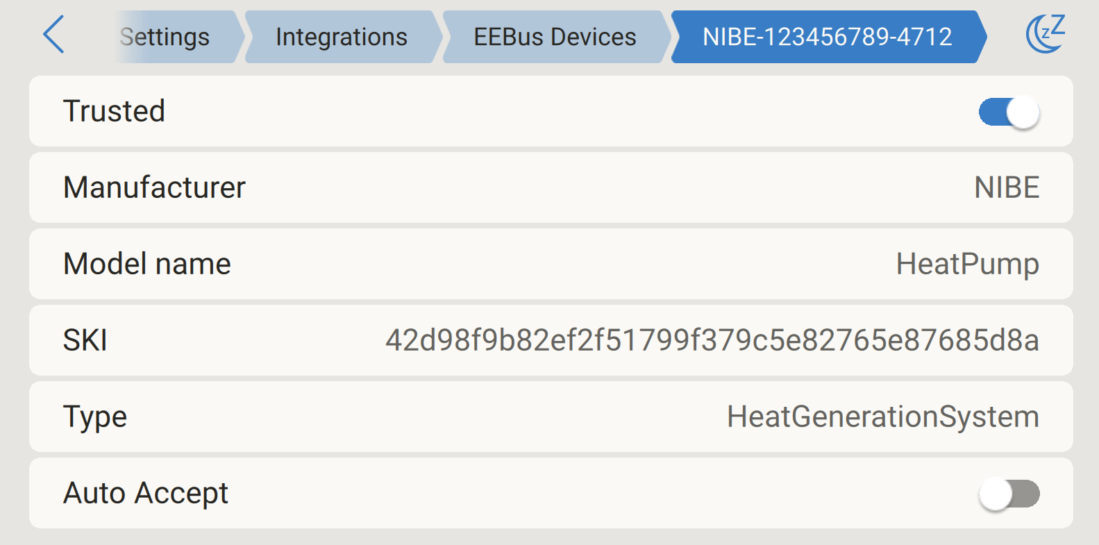

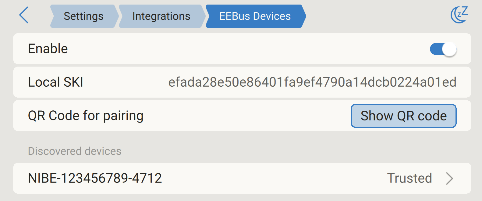

6.19. EEBUS Device support
EEBUS is a standardised protocol that allows the GX device to communicate with third-party devices, such as heat pumps, EV chargers, etc., over the local network. Each EEBUS device identifies itself with a unique identifier called a SKI. Devices only communicate after pairing: both devices must trust each other's SKI.
The EEBUS Devices menu
Go to Settings → Integrations → EEBUS Devices:
Pairing a device
Make sure the device is connected to the same network as the GX device.
On the GX device, go to Settings → Integrations → EEBUS Devices and enable the EEBUS service.
Wait for the device to appear under Discovered devices, then tap it.
Check that the SKI shown matches the SKI displayed by or printed on the device, then enable Trusted.
On the other device, trust the GX device in return, using the Local SKI or the QR Code for pairing. Refer to the device's manual for details.
Once both sides trust each other, the connection is established automatically.
Device page
Troubleshooting
The device does not appear under Discovered devices
Check that it is powered on, connected to the same network as the GX device, and that EEBUS is enabled on the device. Some devices must be put into pairing mode first, refer to the device's manual. Note that discovery normally does not work across different networks.
The connection is not established even though Trusted is enabled
Pairing must be confirmed on both sides. Check on the other device whether the GX device has been trusted there as well.
