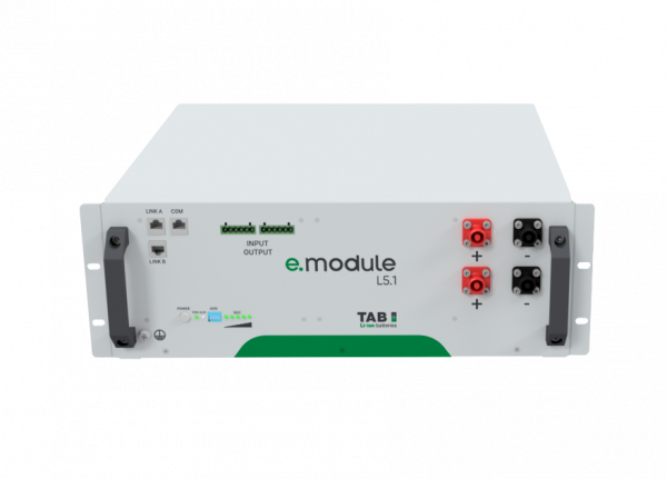

Testing was completed with TAB e.module L5.1 running BMS firmware version 0.3.5 and Cerbo GX running VenusOS v3.63
1.1 A GX device is required, eg Cerbo GX, etc
It is essential to use the BMS-Can (or CAN-bus) connection of a GX device with these batteries for communication of charge and discharge limits, error codes and state of charge. This is set to 500 kbit/s.
It is recommended to use the latest firmware version on new installations and when troubleshooting issues.
Victron BMS cable type A or B can be used to connect between the TAB COM port and the GX device.

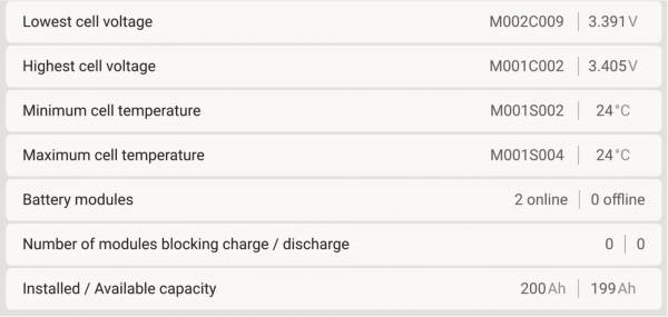

At 3.70V cell voltage battery will trigger a warning and disable discharging, at 3.78V battery will trigger an alarm. If the battery is overcharged, only the module with overcharged cells will isolate charging mosfets and stop charging, other modules can still charge, but CCL will be 0. The system can normally discharge.
When the battery is over discharged (min cell voltage below 2.50V and above 2.00V) it will still allow charging with low current (CCL 5A per module). Normal charging will be restored after min cell voltage reaches 2.80V.
If the minimum cell voltage drops below 2.00V it will disable charging and discharging. Contact your supplier for support.
