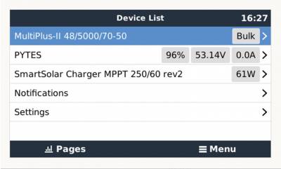

Without properly connecting this cable, the battery will not show up on the display of the GX device.
It is important to ensure this connection and display of the battery on the GX device display before attempting firmware updates or settings changes on other devices if they depend on the power supply from the battery. DO NOT attempt to operate the battery cells normally without connection to the BMS.
