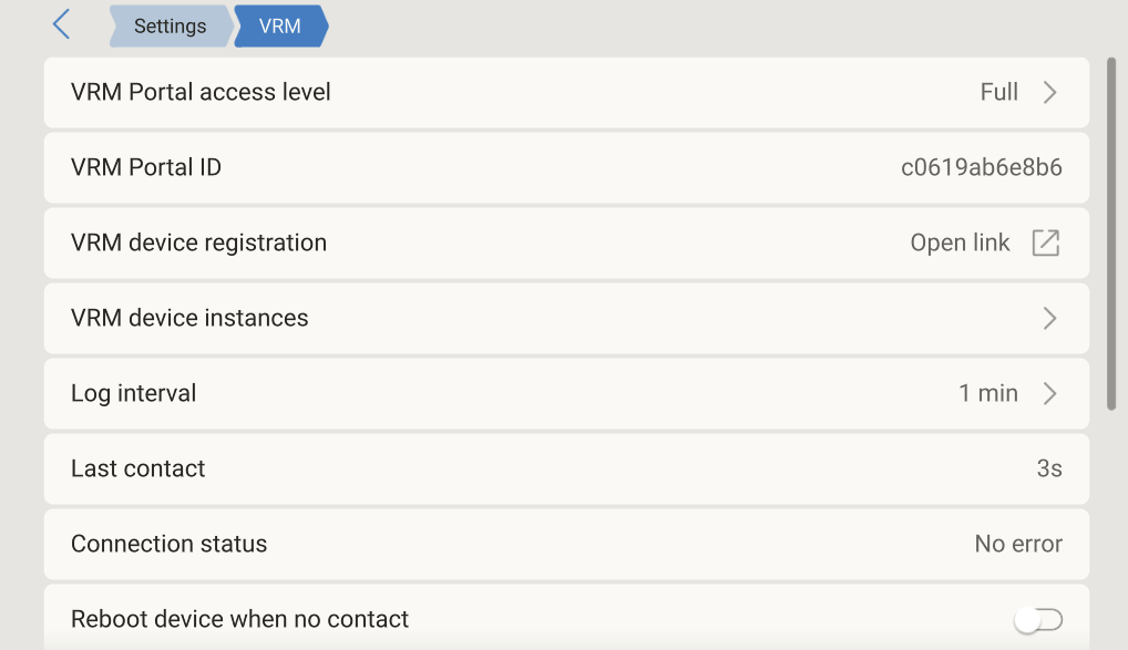

VRM device registration from touch screen
A GX device can be added to the VRM portal directly from a physical touch screen. The UI provides a QR code in Settings → VRM, removing the need to read the portal ID from the device sticker. This option is only available on physical touch screens such as the GX Touch 50, GX Touch 70, or Ekrano GX.
VRM device registration from Remote Console
A GX device can also be added to the VRM portal via Remote Console. The Settings → VRM menu includes a link button, removing the need to read the portal ID from the device sticker.

This optional feature (Settings → VRM - disabled by default) reboots the GX device if it fails to connect to the VRM Portal. Configure the "No contact reset delay" to set reboot intervals. For example, setting a one-hour delay causes hourly reboots until connectivity is restored.

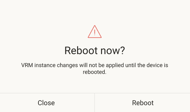

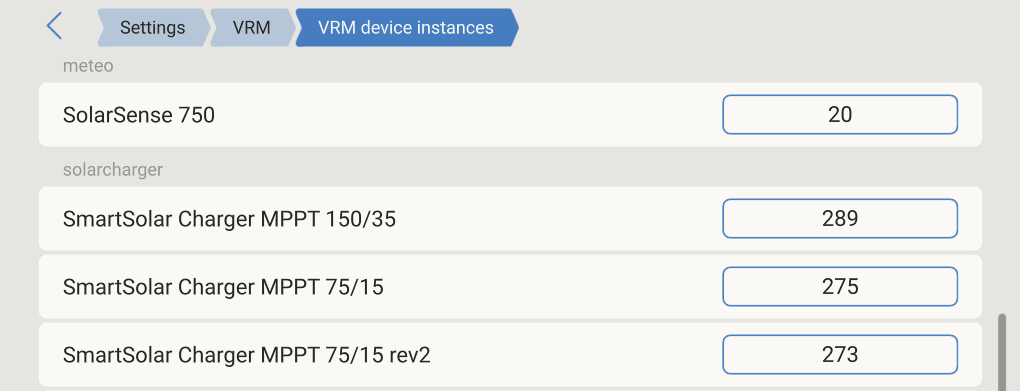

13.8. VRM device instances
The VRM device instances page is accessible via Settings → VRM → VRM device instances. It provides an overview of all devices connected to the GX and their assigned VRM device instance numbers.
Device instances are used by the VRM portal to uniquely identify devices of the same type within an installation. For example, if two solar chargers are connected, each is assigned a unique instance number so they appear and are logged separately on VRM.
