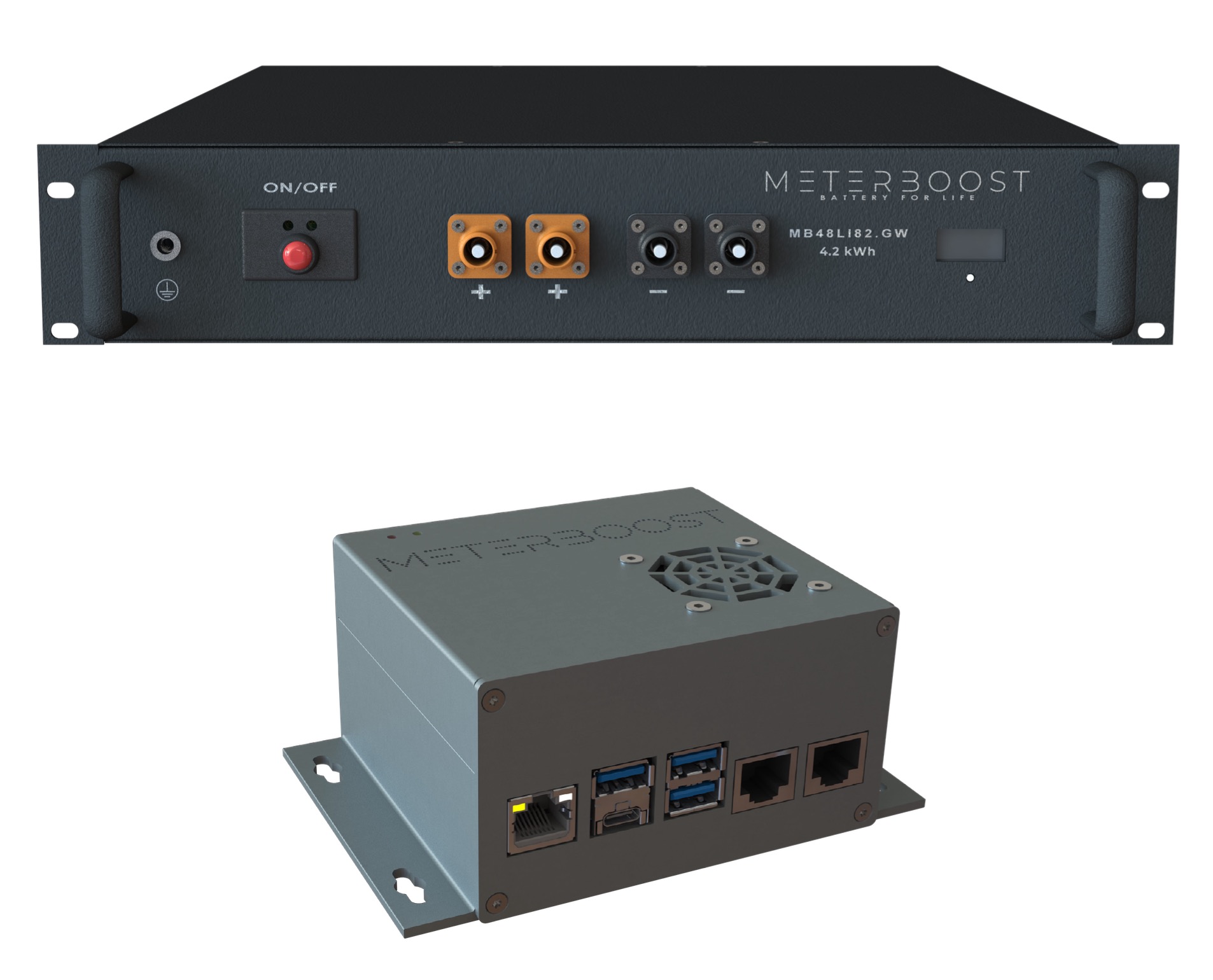

1. Product & System compatibility
1.1 A GX device is required, eg Cerbo GX, etc
It is essential to use the BMS-Can (500 kbit/s) or VE.Can (250 kbit/s) connection of a GX device with these batteries for communication of charge and discharge limits, error codes and state of charge.
It is possible to use either the BMS-Can or VE.Can ports with this battery. Depending which one you use will require additional configuration on the MeterBoost side, please see the documentation linked below for instructions.
The minimum supported firmware version is v3.40. It is recommended to use the latest firmware version on new installations and when trouble shooting issues.
It is permitted to use either Type A or Type B VE.Can to BMS-Can cables.
1.1.1 Accessing the MtB Smart GateWay
The MeterBoost Smart GateWay can be accessed through a web browser on any device connected to the same local network as the GX device (which is connected to the GateWay).
To find the IP address for connection, go to the GX device, navigate to “Device List,” select “MeterBoost battery,” then “Details,” and look under “Connection Information.”
1.2 All 48V Multis, MultiPlus, Quattros and RS models are compatible
The minimum supported firmware version for VE.Bus models is 469. Minimum supported firmware for RS models is 1.16. Updating to the latest firmware is recommended for new installations, and troubleshooting issues.
These inverter/charger units must be connected to the GX device via the VE.Bus connection port.
In grid connected systems, advanced control functions are configurable in the ESS settings on the GX device.
In off-grid systems, the control functions of the Battery Management System (BMS) are built into the latest version of the GX device.

On-grid parallel anything below 5 kVA total inverter power can work with just one MB48LI82.GW battery or one MB48LI50.GW
On-grid parallel above 5 kVA total inverter power:
- 8 kVA: 2 MB48LI82.GW battery or 2 MB48LI50.GW
- 10 kVA: 3 MB48LI82.GW battery or 3 MB48LI50.GW
- 15 kVA: 4 MB48LI82.GW battery or 4 MB48LI50.GW
- For 3-phase and parallel systems multiply the number of batteries needed for single phase setup by the number of inverters in the installation.
2.2 Off-grid or on-grid series
This configuration refers to when loads are connected to the AC-output of the inverter.
- Below 5 kVA: 3 MB48LI82.GW or 5 MB48LI50.GW
- 5 kVA: 4 MB48LI82.GW or 8 MB48LI50.GW
- 8 kVA: 7 MB48LI82.GW or 12 MB48LI50.GW
- 10 kVA: 8 MB48LI82.GW or 15 MB48LI50.GW
- 15 kVA: 13 MB48LI82.GW or 22 MB48LI50.GW
Systems with fewer batteries are possible but the full inverter capacity will not be achievable, and may lead to overloads, high current and low battery alarms.
