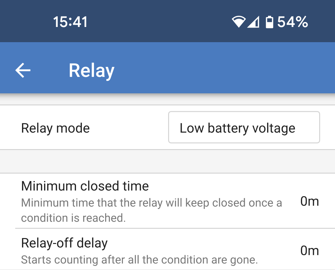

A programmable relay is available in the Multi RS19 Solar. The contacts are accessible via the User I/O terminals. See the User I/O functions table for the pinout.
  • Relay mode: Tap in the box to select or change the mode of operation for the relay.
Some of the options allow additional settings for the relay contacts to remain closed for a minimum amount of time, or an amount of time after a condition has been cleared.
  • Minimum closed time: Specifies the minimum amount of time that the relay will remain closed for after being set by a condition.
  • Relay off delay: After an alarm condition has cleared, the relay will remain closed for this additional amount of time.

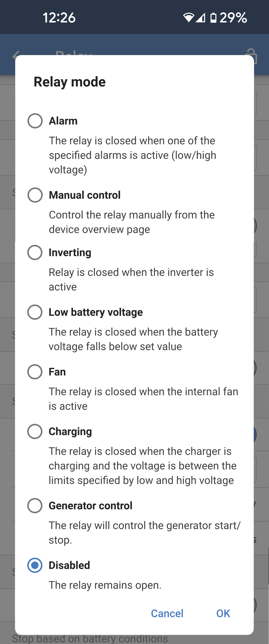

One of several relay modes can be selected from the list:
  • Alarm: The relay is closed when either a high battery voltage or low battery voltage alarm is active.
    • Low voltage relay: Choose the parameters to set and to clear a low battery voltage alarm.
    • High voltage relay: Choose the parameters to set and to clear a high battery voltage alarm.
  • Manual control: Use this option to control the relay manually from the Settings - Relay page or from the Status page.
  • Inverting: The relay contacts will close when the Multi RS19 Solar is inverting.
  • Low battery voltage: The relay will close when the battery voltage falls below the set value.
    • Low voltage relay: When the battery voltage falls below the set level, the relay will close. The relay will open again when the voltage rises above a higher set voltage.
  • Fan: The relay will close whenever the internal fan of the Multi RS19 Solar is running.
  • Charging: The relay will be closed when the charger is charging and the battery voltage is between the low and high voltage limits.
    • Low voltage relay: The relay opens when the battery voltage falls below the lower set voltage and it closes again when the battery voltage is above the higher set voltage.
    • High voltage relay: The relay opens when the battery voltage is above the higher set voltage and it closes again when the battery voltage is below the lower set voltage.
  • Generator control: Choose this mode for the relay contact to control starting and stopping a generator. See the section below for more details.
  • Disabled: The relay is always open, and will not close under any condition.
