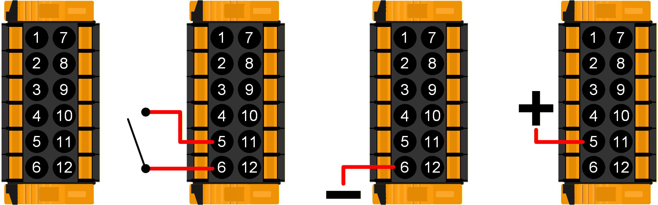

The Multi RS19 Solar will be switched on if the inputs are wired in one of the four ways pictured on the right.
  • The factory wire link is in place,
  • A closed switch contact is wired between REMOTE_H and REMOTE_L.
  • REMOTE_H is wired to battery positive (+48V).
  • REMOTE_L is wired to battery negative.

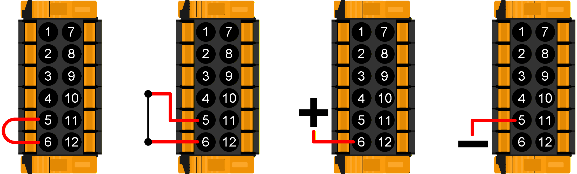

The Multi RS19 Solar will be switched off if the inputs are wired in one of the four ways pictured on the right.
  • The factory wire link is removed and REMOTE_H and REMOTE_L are open circuit.
  • An open switch contact is wired between REMOTE_H and REMOTE_L meaning that they are open circuit.
  • REMOTE_H is wired to battery negative.
  • REMOTE_L is wired to battery positive (+48V).

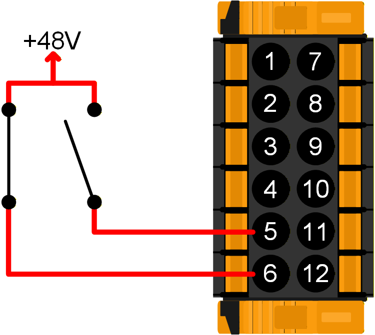

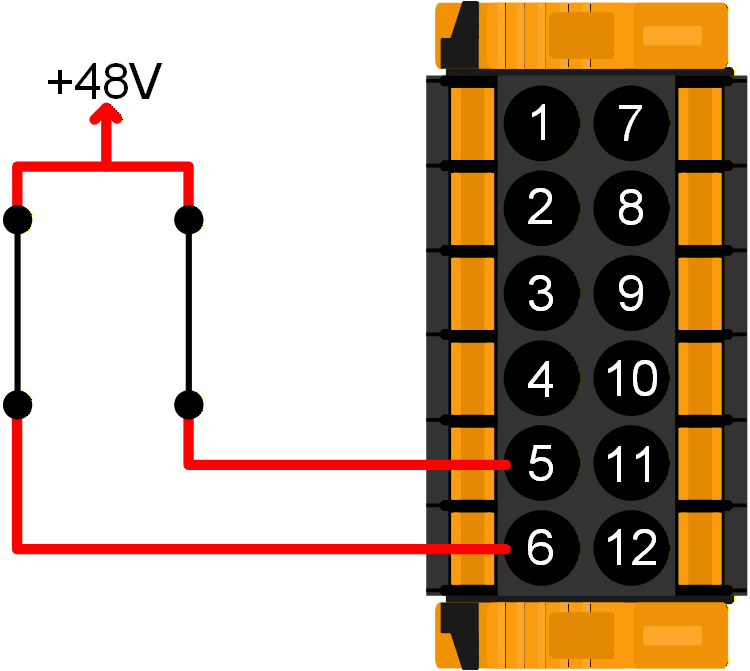

In 2-wire BMS mode, if the REMOTE_H and REMOTE_L terminals are linked (and not connected to +48V), the Multi RS19 Solar will be on, but charging will be disabled.
The BMS' "Allow to charge" and "Allow to discharge" contacts are both closed.
The REMOTE_H and REMOTE_L terminals are both pulled up to +48V through the BMS switch contacts.
The Multi RS19 Solar operates normally, and is allowed to charge and discharge the battery.

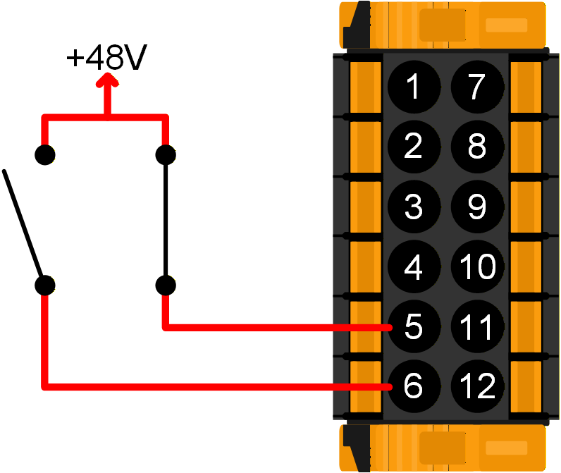

The BMS has opened its "Allow to charge" contact.
The REMOTE_H is pulled up to +48V through the BMS contact and REMOTE_L terminal is open circuit (floating).
The Multi RS19 Solar stops charging the battery from AC and/or solar sources, but continues to discharge the battery as normal.

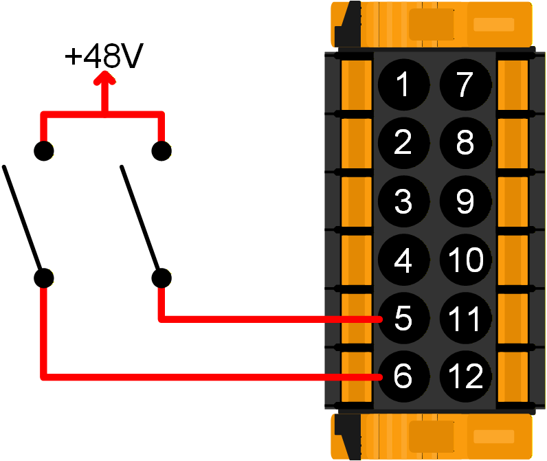

The BMS' "Allow to charge" and "Allow to discharge" contacts are both open.
The REMOTE_H and REMOTE_L terminals are both open circuit (floating).
Neither charging nor discharging is allowed, so the Multi RS19 Solar switches off.
