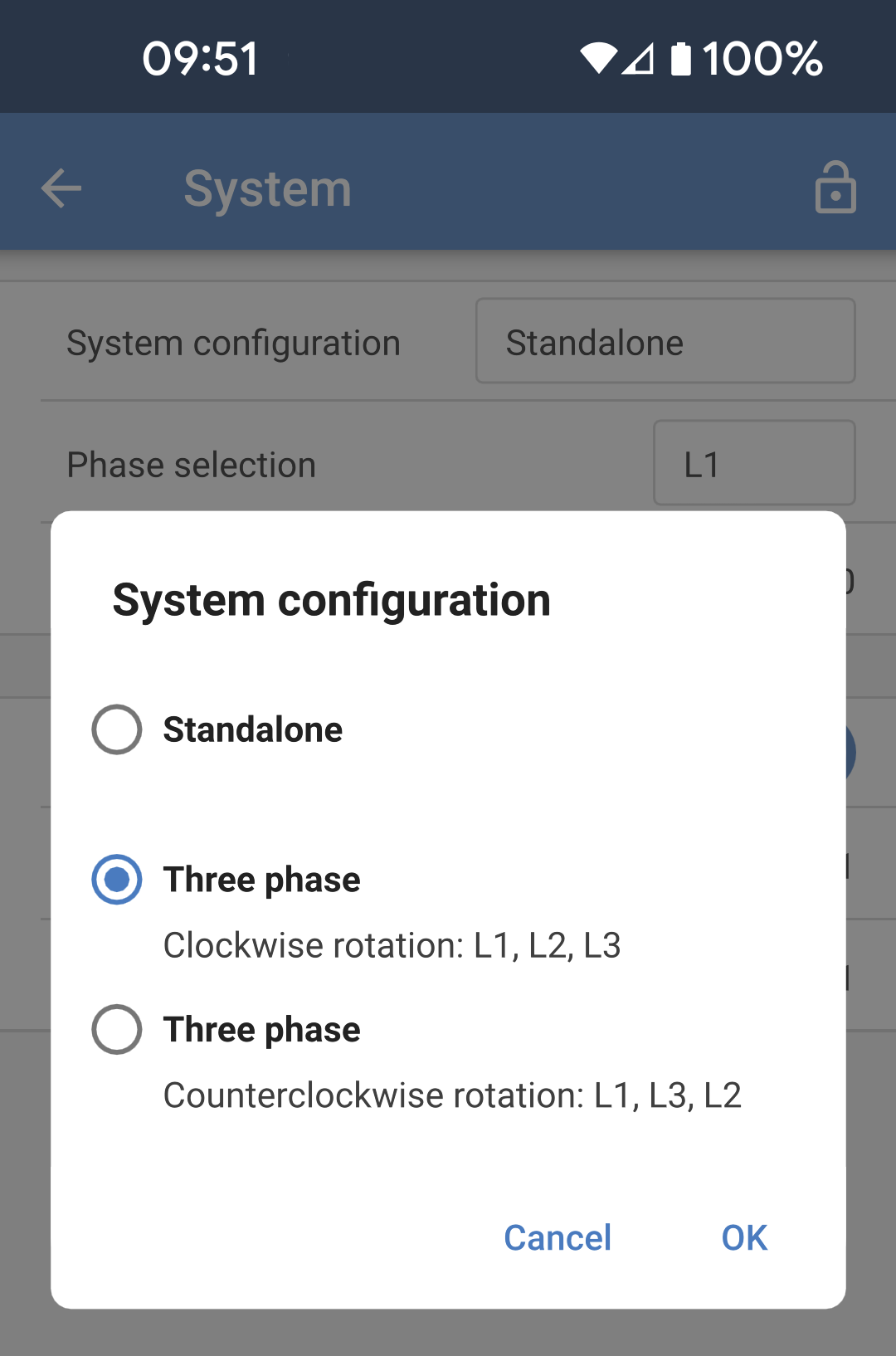

Configuring a system for three phase or single phase is done in VictronConnect in the System menu.

System configuration:
The factory default System configuration setting is "Standalone".
Tap the box to bring up a popup menu where you can select "Three phase". There are two three phase options to choose from, either clockwise or counter clockwise, depending upon the phase rotation at the installation site.
You'll need to apply these same settings to each unit individually.
Phase selection:
Select the correct phase that each particular unit is connected to. There can only be one unit per phase.
Do this for each individual unit.
