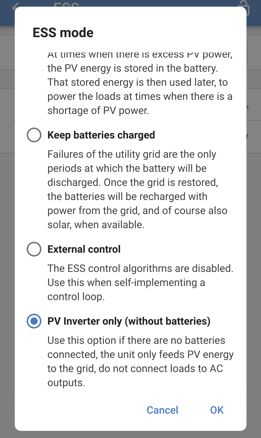

Set the following option on the ESS settings page:
  • Set the ESS mode to "PV Inverter only (without batteries)".
After setting "PV Inverter only mode (without batteries)", the following settings will be enforced:
  • System -> System configuration = Standalone
  • General -> Energy meter support = Disabled
  • AC input control -> Conditional AC input connection = Disabled
