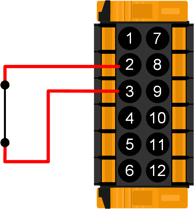

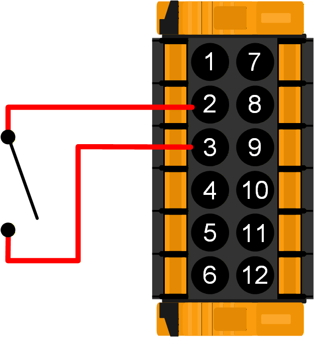

The Multi RS19 Solar is equipped with 2 digital input ports, they are labelled AUX_IN1+ and AUX_IN2+ on the removable terminal block, with AUX_IN- being the common terminal for both.
An AUX_IN+ input is considered active when it is connected to AUX_IN-.
Warning
Do not connect any of the AUX_IN terminals to the battery positive or negative.
The diagram on the right shows AUX_IN1 as active.
The diagram on the right shows AUX_IN1 as inactive.
