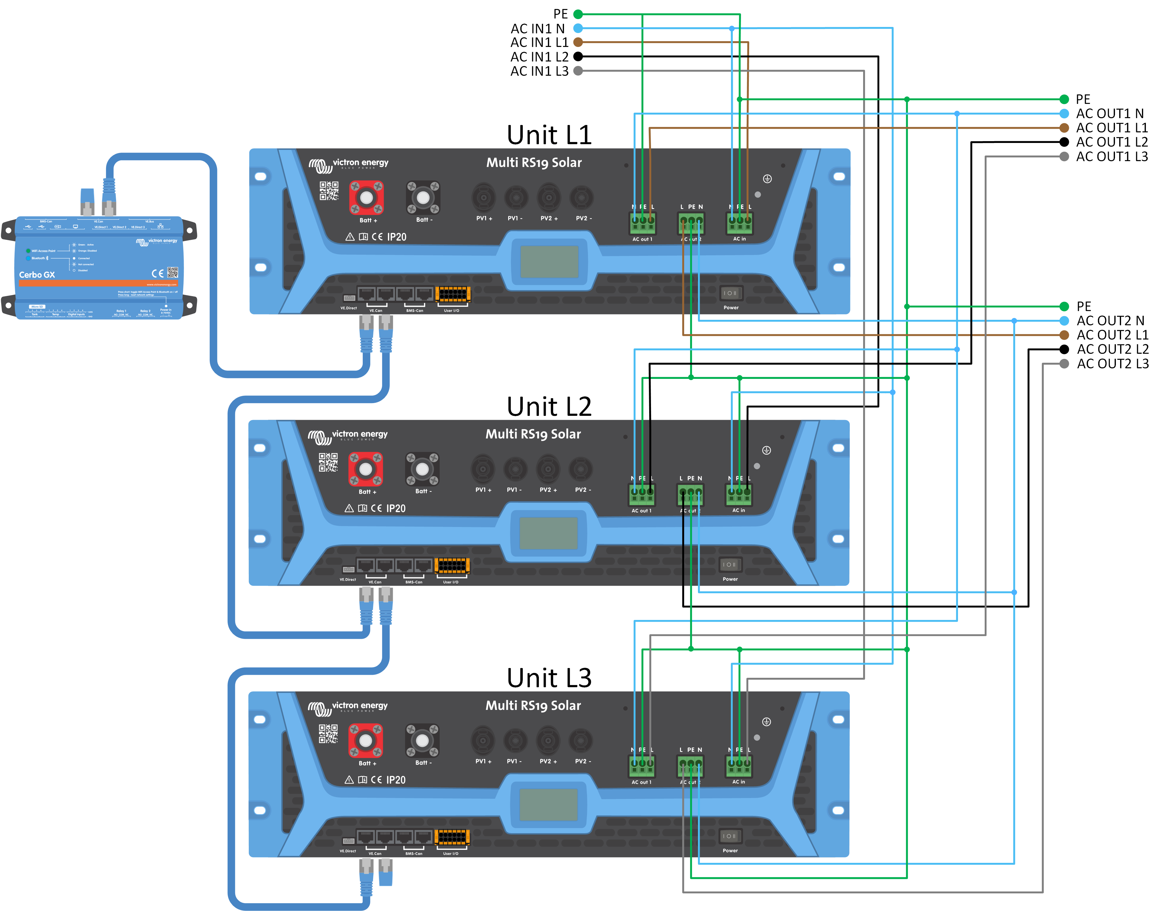

3 phase installation
The Multi RS19 Solar supports single phase, and three phase configurations. It does not currently support split phase.
The factory default is for stand alone, single unit operation.
If you wish to program for three phase operation, it requires 3 units.
The maximum supported system size is 3 units in total, with a single unit on each phase.
All Multi RS19 Solar units must be connected to each other via VE.Can connections, with a VE.Can terminator at the start and the end of the bus.
Once the units are connected to the battery and via VE.Can they will need to be configured.
