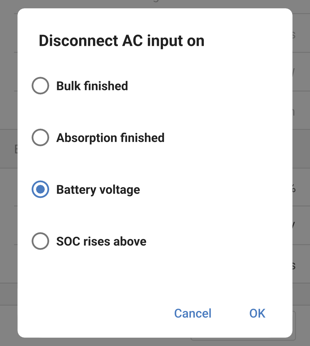

  • Disconnect AC input on: Tap this field and then choose a battery condition by which the AC input will be disconnected.
  • Disconnect when voltage is higher than: If "Battery voltage" is chosen in the previous field then you can define a battery voltage above which the AC input will be disconnected.
