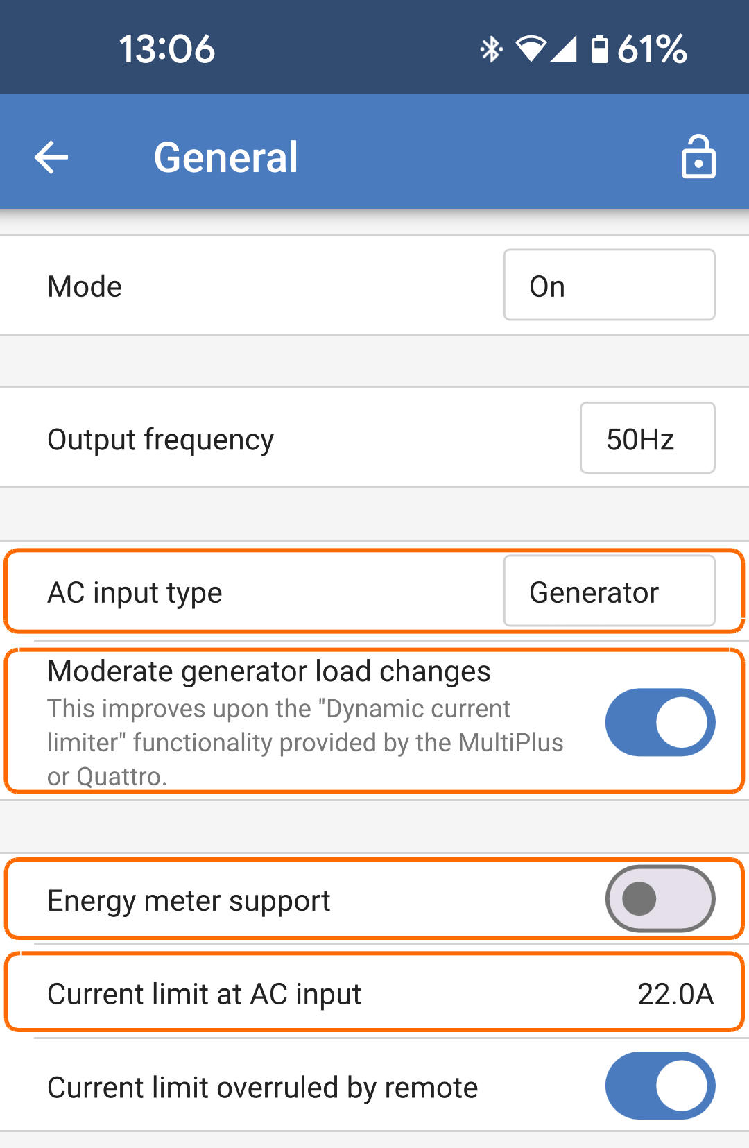

Set the following option on the General settings page:
  • Set the "AC input type" to "Generator".
  • "Moderate generator load changes" should be switched on.
  • Ensure that "Energy meter support" is switched off.
  • Adjust the input current limit to suit the power output of the generator.

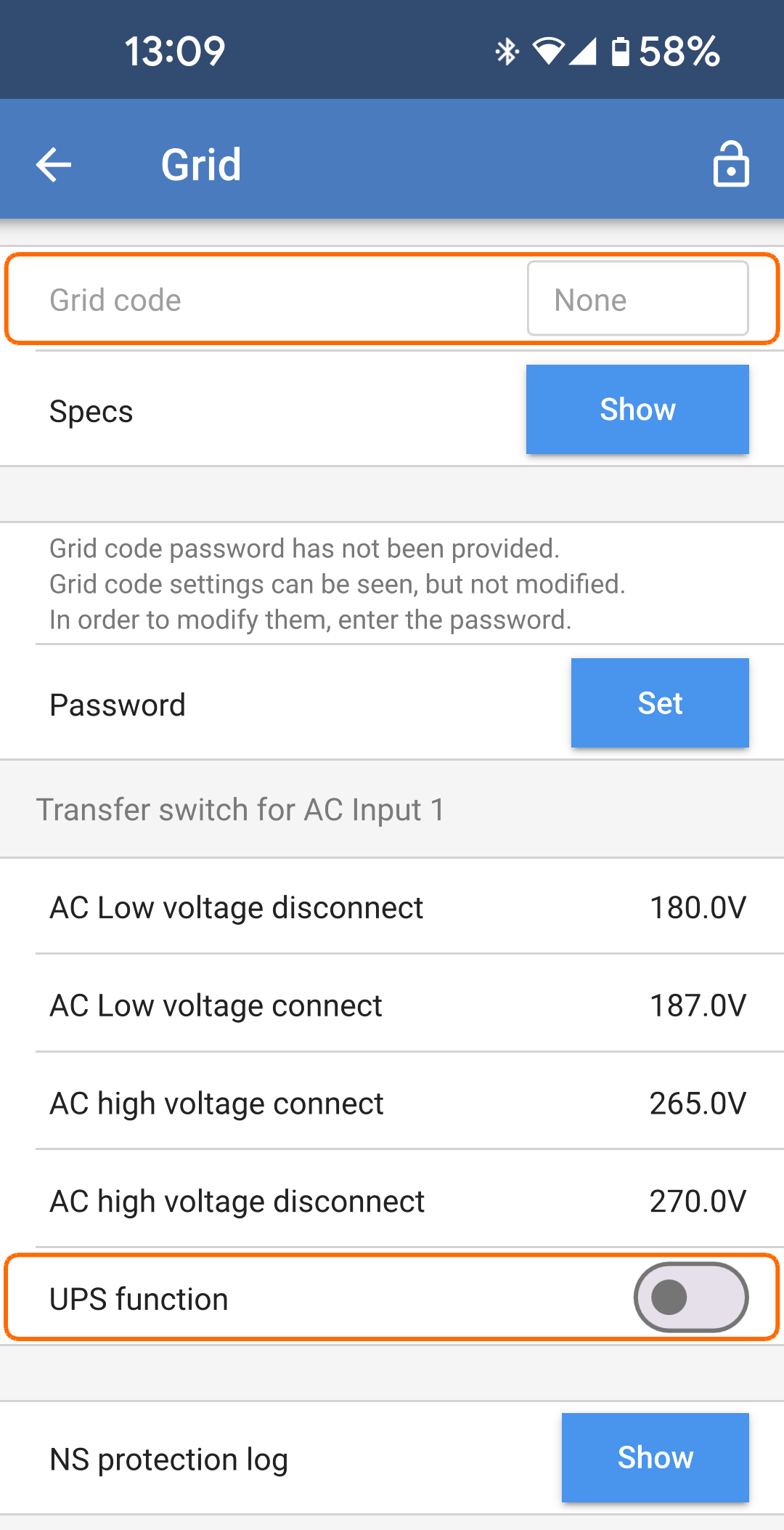

If no grid code is set then set the following on the Grid page:
  • Check that the "Grid code" is "None".
  • Switch the "UPS function" off.
    The 'UPS function' restricts the acceptance of an AC input to a very precise sine wave so that in the event of a fluctuation in the AC supply it is possible to maintain an apparent continuity of supply to the loads. This is incompatible with most generators and should be disabled when using a generator to improve reliable acceptance of the AC supply.

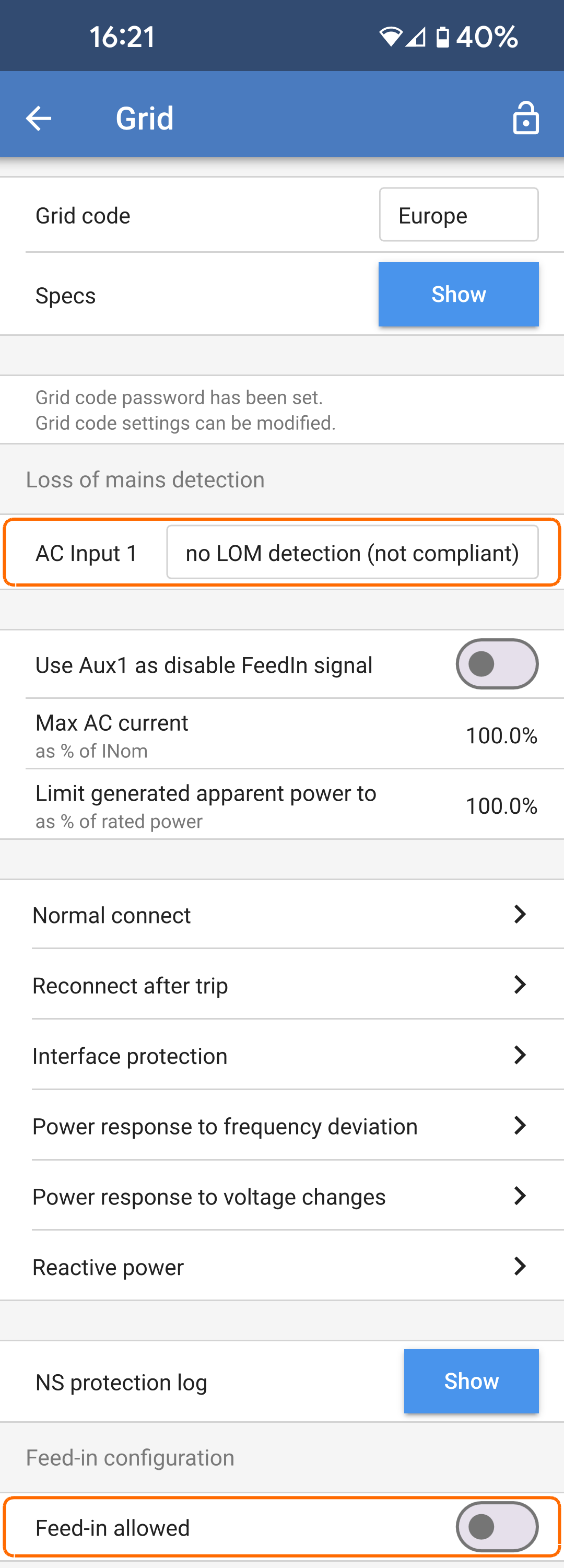

If a grid code is set then set the following two parameters on the Grid page:
  • The AC Input 1 LOM detection should be set to "no LOM detection (not compliant)".
    Caution
    Do not disable LOM detection when the Multi RS19 Solar is connected to the grid.
    This option is only to be used when a generator is connected at the AC input.
  • Disable feed-in by switching the "Feed-in allowed" option off.

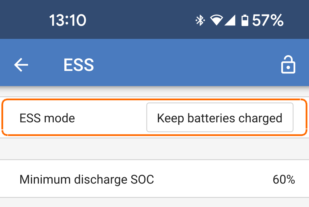

Ensure that the ESS mode is set to "Keep batteries charged".
