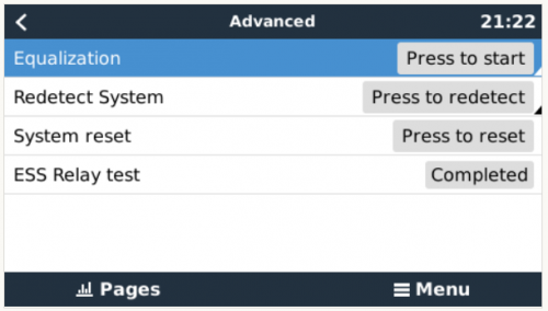

3.4 Advanced menu
Equalisation
Starts equalisation. See Multi or Quattro documentation for details.
Redetect system
Redetects the type of inverter/charger and its features & configuration. Use this feature when, for example, a VE.Bus BMS used to be part of a system, and is no longer.
System reset
Restarts the inverter/charger when it has stopped retrying. For example after a (very) heavy overload; or three overloads in a row.
ESS Relay test
Shows the status of the ESS Relay test. Only relevant when its an ESS system. See Q9 in the ESS Manual FAQ for details

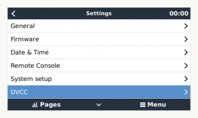

To enable or disable DVCC, see Settings → DVCC in the menus:

GX Error #48 - DVCC with incompatible firmware
This error is raised when the DVCC feature is enabled whilst not all devices in the system are updated to recent enough firmware. More information about DVCC and minimal required firmware versions in chapter 4 of this manual.
Note for systems with BYD, MG Energy Systems, and Victron Lynx Ion BMS batteries:
Since Venus OS v2.40, released in December 2019, the DVCC feature is automatically switched on in case the systems detects one of mentioned battery/BMS types connected. And it is not possible to switch DVCC off in that case.
This creates an issue for systems installed and commissioned a long time ago, from before DVCC was available and later due to mandatory work for such systems.
The solution is to:
- Disable automatic updates; Settings → Firmware → Online updates.
- Roll back to v2.33; See Settings, Firmware and then Stored backup firmware.
- Make sure that DVCC is disabled again.
Please do consult your installer, to check if the battery system is managed with two wire control (no DVCC needed) or not:
In case there is no charge- and discharge- wiring between BMS, inverter/chargers and charge controllers, then DVCC is required for the above mentioned battery brands, and this also has certain minimum firmware requirements for connected Inverter/Chargers and Solar Charge Controllers.
Whats new since Venus OS v2.40 is (a) that it automatically enables DVCC when it sees the above mentioned battery types, and (b) that when DVCC is enabled, it checks the connected devices for the minimum firmware, and raises Error #48 in case the firmware of one or more connected devices is too old.
