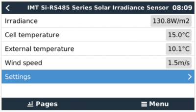

1.10 Connecting IMT Solar Irradiance, Temperature and wind sensors
Compatibility and wiring
The compatible types are the Si-RS485TC Series. The optional wind and temperature sensor are also supported.
The sensor is connected using RS485 wiring, and requires our USB to RS485 accessory cable.
Configuration of the sensor

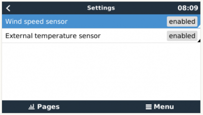

Normally, the Sensor should work out of the box. In case it does not, for example when the sensor has previously been used in another system, then:
- Download the Si-MODBUS-Configuration software tool from the IMT website.
- Configure the following settings: Modbus Address - 3, Baud Rate: 9600, Data Format: 8N1 (10 Bit).
For more support on configuring the IMT sensor, please contact IMT. Not Victron.
Connecting multiple IMT sensors
Its possible to connect multiple IMT sensors. A separate USB to RS485 converter cable is required for each sensor.

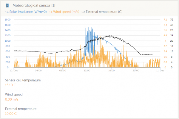

Usage
This picture shows how its visualised on VRM:

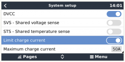

4.4.1 Limit charge current
This is a user-configurable maximum charge current setting. It works across the whole system. MPPT Solar Chargers are automatically prioritized over the mains/generator.
This setting is available in the “Settings → “System Setup” menu on the GX device.
Particulars:
1) In case a CANBUS-BMS is connected and the BMS requests a maximum charge current that is different from the user-configurable setting, the lower of the two will be used.
2) this mechanism only works for Victron inverter/chargers and Solar chargers. Other chargers, such as Skylla-i’s are not controlled and also their charge current is not taken into account. The same applies for devices that are not connected to the GX device, such as an alternator. Worded differently: the total charge current of the inverter/chargers and all MPPTs will be controlled, nothing else. Any other sources will be extra charge current, unaccounted for. Even when installing a BMV or other battery monitor.
3) DC Loads are not accounted for. Even when a BMV or other battery monitor is installed. For example, with a configured maximum charge current of 50 Amps, and DC Loads drawing 20 Amps, the battery will be charged with 30 Amps. Not with the full allowed 50 Amps.
4) Current drawn from the system by the inverter/charger is compensated for. For example, if 10A is drawn to power AC loads, and the limit is 50A, the system will allow the solar chargers to charge with a maximum of 60 Amps.
5) In all situations, the maximum charge limit configured in a device itself, ie. the Charge current limit set with VictronConnect or VEConfigure for the Solar chargers or Inverter/chargers will still be in effect. An example to illustrate this: in case there is only an Inverter/charger in the system, and in VEConfigure is charge current is configured to 50 Amps. And on the GX Device, a limit of 100A is configured, then the working limit will be 50 Amps.

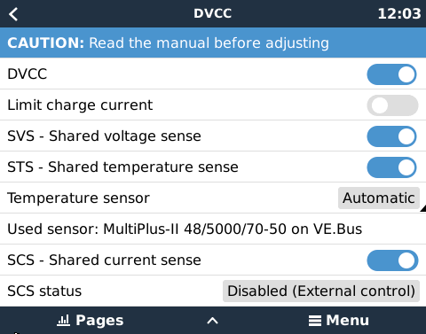

4.4.2 Shared Voltage Sense (SVS)
Works with VE.Bus devices and VE.Direct Solar Chargers.
The system automatically selects the best available voltage measurement. It will use the voltage from the BMS or a BMV battery monitor, if possible, otherwise it will use the battery voltage reported by the VE.Bus system.
The voltage displayed on the GUI reflects the same voltage measurement.
Shared Voltage Sense (SVS) is by default enabled when DVCC is enabled. It can be disabled with a switch in the Settings → System Setup menu.
4.4.3 Shared Temperature Sense (STS)
Select the temperature sensor to use; and the GX device will send the measured battery temperature to the Inverter/charger system as well as all connected Solar Chargers.
Selectable sources for the battery temperature are:
- BMV-702 battery monitor
- BMV-712 battery monitor
- Lynx Shunt VE.Can battery monitors
- Temperature inputs on a Venus GX (and same for other GX devices that have a temperature input)
- Multi/Quattro inverter/charger
- Solar Chargers (if fitted with a temperature sensor)
4.4.4 Shared Current Sense (SCS)
This feature forwards the battery current, as measured by a battery monitor connected to the GX device, to all connected solar chargers.
The solar chargers can be configured to use the battery current for its tail current mechanism that ends absorption when the current is below the configured threshold. For more information about that, refer to Solar charger documentation.
This feature only applies to systems that are not ESS, and/or don’t have a managed battery, since in both of those cases the MPPT is already externally controlled.
Requires MPPT solar charger firmware v1.47 or newer.

GX Error #48 - DVCC with incompatible firmware
This error is raised when the DVCC feature is enabled whilst not all devices in the system are updated to recent enough firmware. More information about DVCC and minimal required firmware versions in chapter 4 of this manual.
Note for systems with BYD, MG Energy Systems, and Victron Lynx Ion BMS batteries:
Since Venus OS v2.40, released in December 2019, the DVCC feature is automatically switched on in case the systems detects one of mentioned battery/BMS types connected. And it is not possible to switch DVCC off in that case.
This creates an issue for systems installed and commissioned a long time ago, from before DVCC was available and later mandatory for such systems.
The solution is to:
- Disable automatic updates; Settings → Firmware → Online updates.
- Roll back to v2.33; See Settings, Firmware and then Stored backup firmware.
- Make sure that DVCC is disabled again.
Please do consult your installer, to check if the battery system is managed with two wire control (no DVCC needed) or not:
In case there is no charge- and discharge- wiring between BMS, inverter/chargers and charge controllers, then DVCC is required for above mentioned battery brands, and this also has certain minimum firmware requirements for connected Inverter/chargers and Solar charge controllers.
Whats new since Venus OS v2.40 is (a) that it automatically enables DVCC when it sees above mentioned battery types, and (b) that when DVCC is enabled, it checks the connected devices for the minimum firmware, and raises Error #48 in case the firmware of one or more connected devices is too old.
