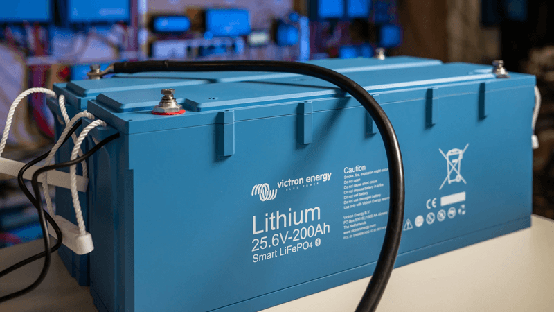

Leisure Batteries: The Core of Your RV Electrical System
Leisure batteries store the electricity that power devices and appliances. Whilst the RV’s starter battery powers factory on-board electronics like cabin lights, radio, and electric windows, it lacks the capacity to power campervan appliances. For the higher-capacity power storage that makes an RV a home on wheels, you must install leisure batteries.
victron-lithium-leisure-battery-hero-image
Leisure Battery Capacity
The capacity or ‘size’ of a leisure battery refers to the amount of usable electrical power it’s capable of storing. A bigger battery allows you to run a greater number of higher-power devices for longer before recharging. Battery capacity is quoted in amp-hours (Ah). The capacity of your chosen leisure battery is determined by the following factors:
  • The combined power draw of your on-board appliances in Amps (A)
  • The number of hours you want to be able to use each appliance every day
  • The number of days you want your battery to survive between charges
  • The usable capacity of your leisure battery
Usable Capacity and State of Charge
The usable capacity of a battery differs from the battery’s rated capacity in that many batteries shouldn’t be discharged until they’re empty. The degree to which a battery is charged is referred to as its state of charge (SoC). A battery at 100% SoC is fully charged, whilst a battery at 0% SoC is empty: fully discharged. Regular discharging to 0% or close to it significantly impacts a battery’s overall lifespan: that is, the length of time a battery remains usable. Think of how your phone’s battery gradually performs less well over the years, and imagine the same happening to the leisure batteries at the core of your RV electrical system. To preserve your batteries, regular deep discharging should be avoided. A lead-acid battery discharged to 0% can be rendered completely unusable if it's left that way, necessitating a full replacement.
Image comparing the usable energy of lead-acid vs. lithium batteries
Battery Chemistries: Lead-acid and Lithium
This is where different battery chemistries come in. The principal difference between lead-acid leisure batteries and lithium leisure batteries is that lead-acid batteries should only be discharged to around 50% SoC, whilst lithium batteries can handle more frequent discharging to 20% or even 0%. Lithium batteries also have longer lifespans regardless of state of charge, charge more quickly, and weigh less. Our article on upgrading from lead-acid to lithium has much more information on the differences between the two types. For more information on the different types of lead-acid batteries, take a look at our deep dive article.
NOTE: Whilst lithium batteries can be fully discharged to 0% without immediate serious damage, regular deep discharging damages the battery over time, reducing its overall lifespan. For this reason, we recommend that lithium batteries are not regularly discharged below 20%.
For more detailed information on properly sizing your RV leisure batteries, take a look at our step-by-step guide. With leisure batteries covered, let’s take a look at how you’ll keep those batteries charged.

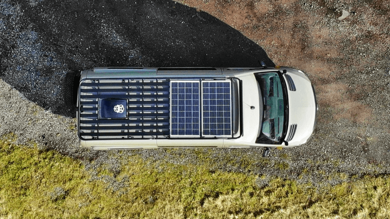

Solar panels can be mounted singly or in arrays of two, three, or more panels. The size of a solar array is determined by the size of the leisure battery it’s charging and how quickly that battery needs to be charged. Read all about solar system sizing in our handy guide.
rv-solar-array-top-down-view

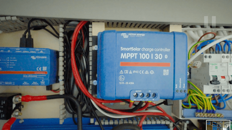

Solar Charge Controller
A solar charge controller sits between the panels and the electrical system, regulating the incoming power and safely charging the battery. Charge controllers come in two main types:
mppt-solar-charge-controller-installed-2

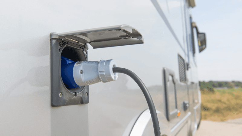

Shore Power Charging
Shore power refers to a fixed mains electricity connection; the term comes from sailing, where a boat is plugged into an on-shore distribution point when docked. RV users typically plug into a similar point or ‘post’ when parked at campsites, or they may run a cable from their home electricity supply.
A shore power connection has two functions:
  • Charging leisure batteries
  • Directly powering high-wattage appliances, bypassing the RV’s leisure batteries
These two functions are mediated by a battery charger. A battery charger takes power from the shore connection and uses it to safely and efficiently charge your leisure batteries. Generally, this power comes into the van via a shore power cable and an external shore power inlet, wired into a consumer unit. We’ll discuss consumer units in the section on fusing and grounding below.
rv-shore-power-connection-inlet
A battery charger is the simplest shore power solution, but an inverter/charger is more suitable if you want to run AC appliances off-grid, not just at a campsite. An inverter/charger charges your leisure batteries from shore power, converts DC battery power to AC mains power, and automatically switches between battery and shore power for seamless charging when you pull up to or leave a campsite. Our help me choose guide on inverter/chargers has all the information you need about these versatile, efficient devices. For a beginner’s guide to RV shore power in general, our explainer has everything you need.

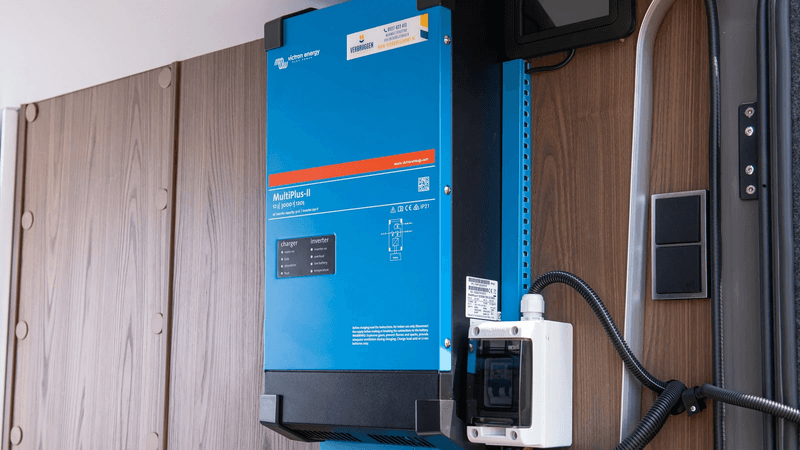

Inverter/chargers
As mentioned in the section on shore power charging, an inverter can be combined with a mains battery charger in a single unit, called an inverter/charger. This is a space-efficient solution with an easier installation than a separate inverter and charger. Learn all about the above factors and choose an inverter/charger that suits your needs with our handy guide.
multiplus-installed-in-rv

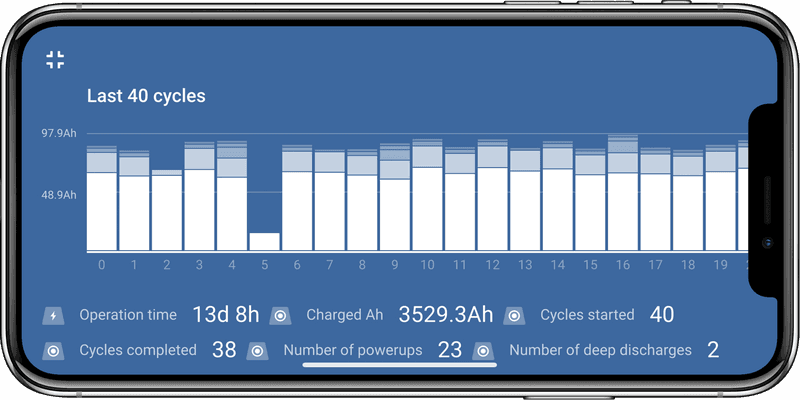

  • Historic data such as discharge depth and charge/discharge cycles
  • Other useful information like battery temperature, starter battery voltage, and battery midpoint in a series-wired battery bank
This data is visible using the VictronConnect app, an easy-to-use mobile dashboard. A simple screen display can be added by plugging in a BMV-700 display module, or by installing a BMV-712 Smart, which includes both Bluetooth and screen in one package, plus a configurable alarm for audible alerts and a programmable relay for automation.

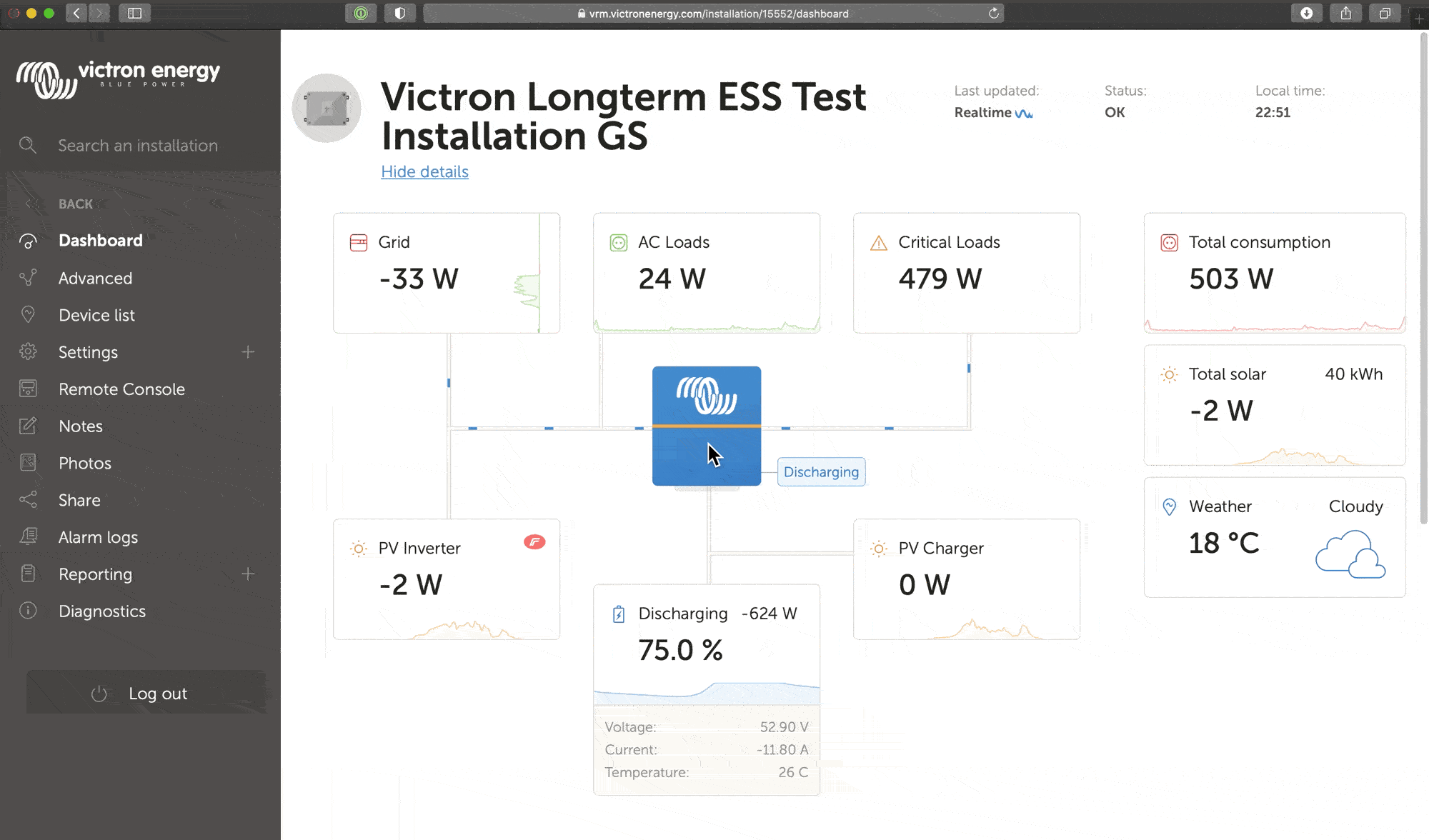

Going one step further, the addition of a communication centre like a Cerbo GX or Ekrano GX brings in data from your entire electrical system. It allows every device in the system to communicate with every other device, maximising performance. GX devices talk to the Victron Remote Management (VRM) dashboard, where you can remotely access granular performance data and fine-tuned control of every element in your electrical system. Discover everything you can do with the VRM dashboard here.
victron-remote-management-vrm-body-1

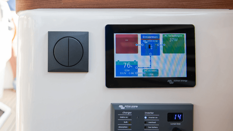

Complete your monitoring suite with a touchscreen display, integrating a monitoring and control dashboard into your van’s living area. Alternatively, choose the Victron Ekrano as your communication centre, which combines the functionality of a Cerbo GX with a large touchscreen in a single, compact device. You can also create your own DIY GX display using a repurposed Android phone or tablet and the Android GX WiFi Display app.
gx-touch-screen-in-situ

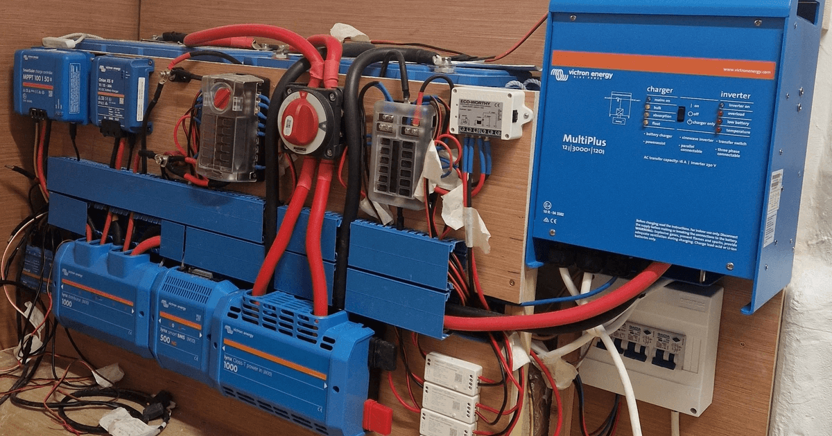

Wiring up your electrical system is made easier by starting with a wiring diagram. A wiring diagram is a schematic that clearly shows wire connections between components. From the wiring diagram, it’s easier to plan the gauge (thickness) of each wire, how each wire will be fused, and where distribution points fit in. Beginners to wiring might like to start with the Victron Toolkit App, or by reading our free ebook, Wiring Unlimited.
Distribution refers to the use of common connection terminals to organise electrical connections. The use of a busbar to distribute battery power, for example, allows a single battery cable to be split into multiple outputs. Your DC fuse box, powering your smaller DC loads (lights, pumps, fridge etc), incorporates busbars, again allowing for one input and multiple smaller outputs.
fuses-and-busbars-in-situ

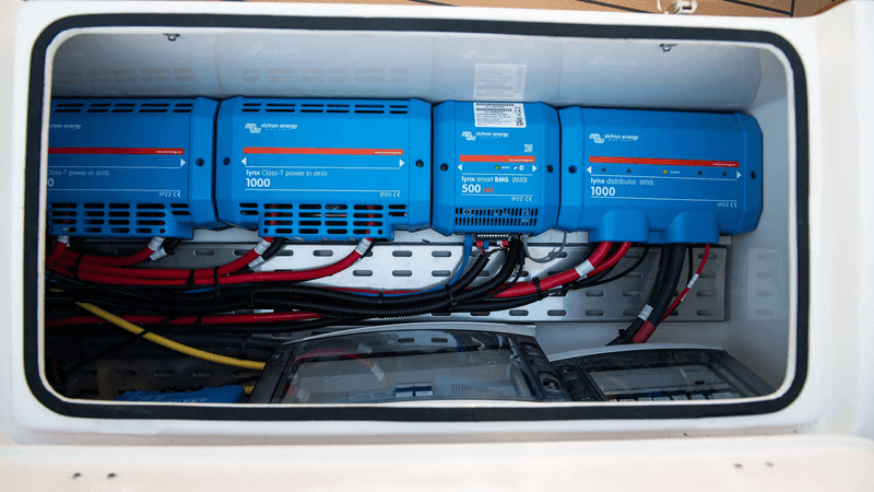

Victron’s Lynx Distribution system is a modular system based on a battery input terminal and a fused busbar pair. Power coming from the batteries is received by the Lynx Power In, a self-contained busbar with room for four battery inputs, plus a ground connection. The Power In connects without wires to the Lynx Distributor, a fused busbar which organises and sends power to your DC loads whilst displaying fuse status on the front panel. The Lynx system can be capped off with a Lynx BMS, which once again connects without the need for wires, and provides battery monitoring and connectivity like a SmartShunt. A Cerbo GX can be added to the Lynx system for sophisticated system-wide monitoring.
lynx-system-in-situ
The Lynx system is an excellent way of simplifying your wiring and distribution, all whilst bringing your DC loads into your VictronConnect app or GX-powered monitoring ecosystem.

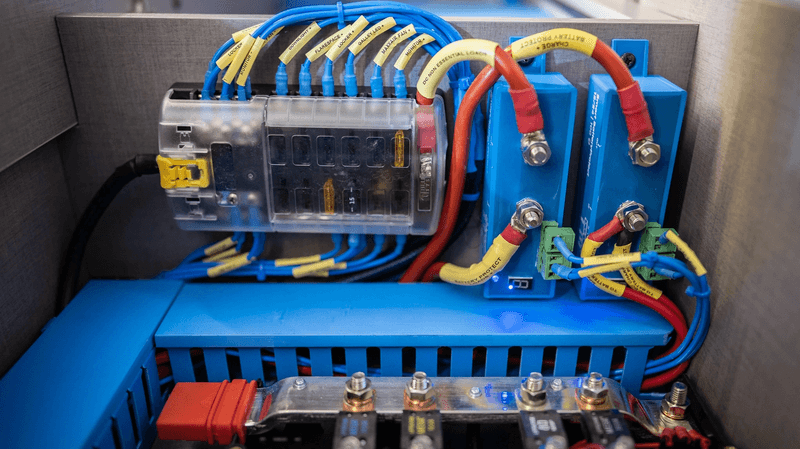

  • In-line fuses are individual fuses that sit within a single cable run. They’re integrated into the cable run with a fuse holder.
  • Battery terminal fuses are individual, large fuses, that specifically protect your leisure battery.
  • Fused busbars and fuse boxes organise fuses in a single unit, eliminating the need to fuse each individual cable run with an in-line fuse.
