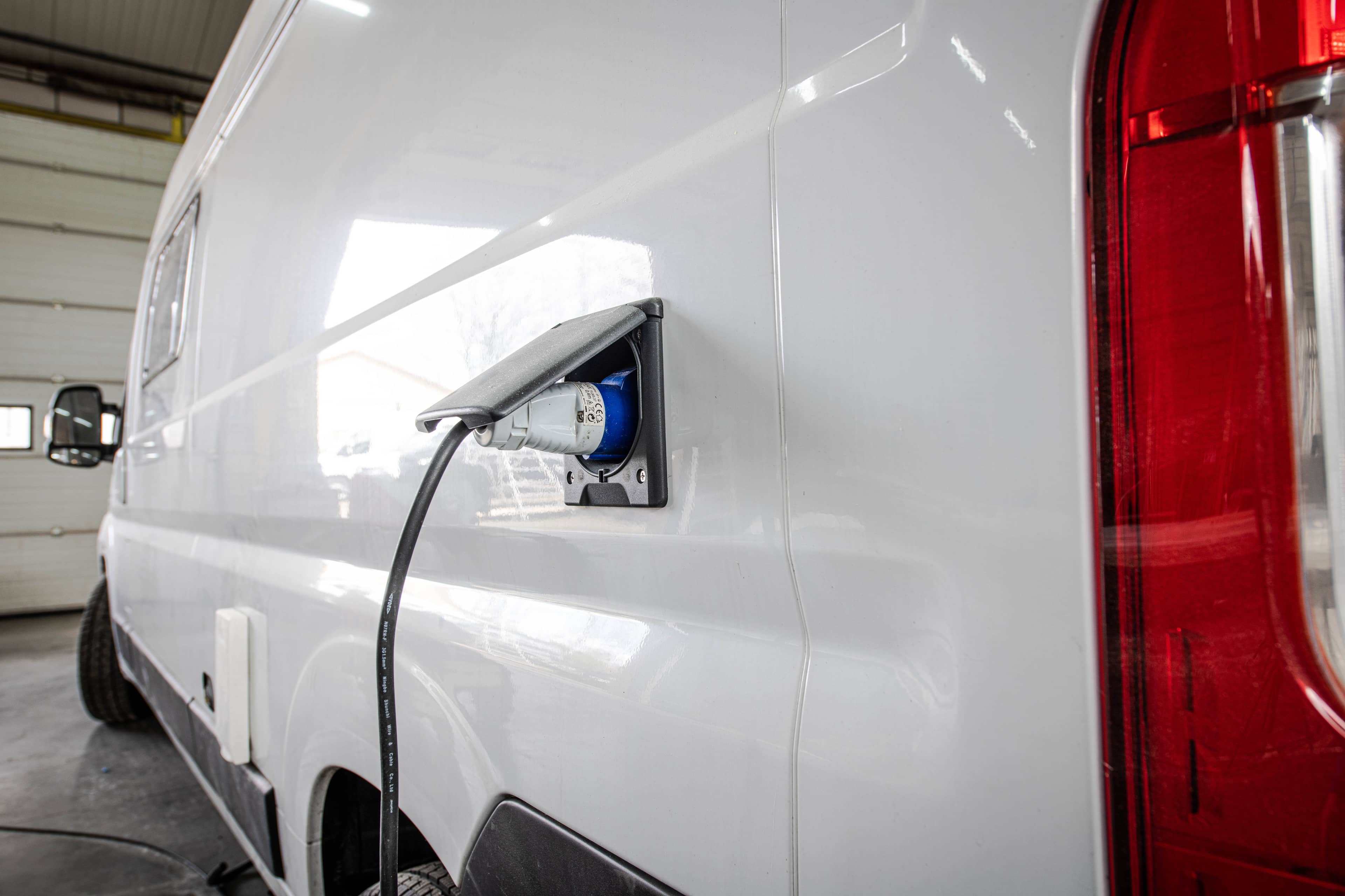

  • An external waterproof shore power inlet installed on the vehicle
  • A shore power cable

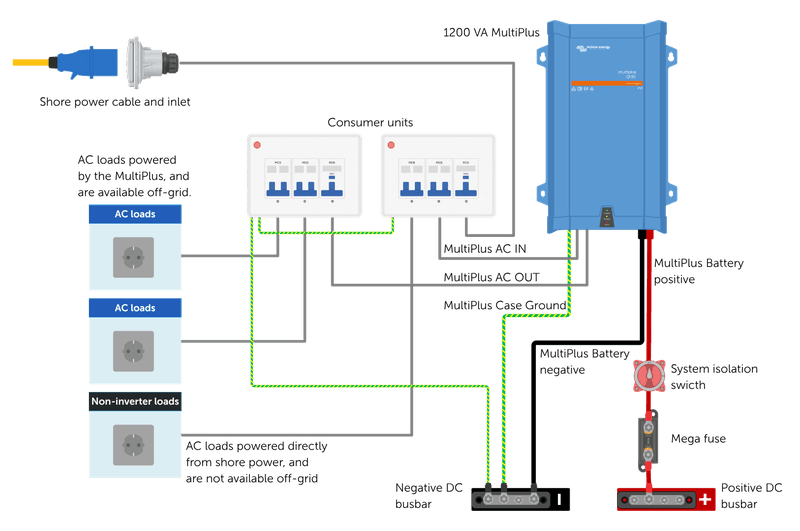

Shore power example diagram
The starting point of any incoming AC electricity is the consumer unit (also known as a distribution board or breaker box). This is where incoming shore power is protected and distributed to your AC circuits.
Within the consumer unit, there are:
  • RCD (Residual Current Device): Protects against electric shock by disconnecting the supply if a fault is detected. This is essential in any AC installation.
  • MCBs (Miniature Circuit Breakers): Protect individual circuits, such as sockets or specific appliances, from overload and short circuits.
So, a consumer unit protects you against electric shocks and fires, but only if the system is properly grounded too.
How does "grounding" work for inverter/chargers in an RV?
Grounding means giving electricity a safe path to flow into if something goes wrong (instead of through you!). In a house, that path leads into the ground. In a van, there is no ground to connect to, since the van sits on rubber tyres, which don't conduct electricity. Instead, vans rely on local bonding: the inverter/charger's DC negative and the AC Neutral output are both connected to the central negative busbar, which is connected to the vehicle's chassis, creating a closed loop.
If a fault occurs, current flows through the chassis and back into the inverter/charger via this loop instead of taking its normal path back through Neutral. (AC power normally travels to your appliances on one wire, called Live, and back on another, called Neutral, completing the circuit.) The RCD constantly compares the current going out on Live with the current coming back on Neutral, so the moment it detects a mismatch, it interprets this as current going somewhere it shouldn't (potentially through a person) and cuts the power in a fraction of a second.
How many consumer units do you need?
  • Single consumer unit, is used when you have either an inverter or a battery charger (not both combined):
    • With an inverter: the inverter's 230V output is wired into the RCD, and any 230V appliances or sockets are wired to the MCB outputs.
    • With a battery charger: the shore power inlet is wired into the RCD, and the battery charger plus any sockets used on hookup are wired to the MCB outputs.
  • Two consumer units are used with a combined inverter/charger unit, such as a MultiPlus or Quattro, and follows a similar path as above:
    • First consumer unit: the shore power inlet is wired into the RCD. One MCB output feeds the inverter/charger's AC input; the other MCB output can feed any non-inverter loads that only run on shore power.
    • Second consumer unit: the inverter/charger's AC output is wired into the RCD. The MCB outputs feed the loads you want to be able to run off-grid, since these are powered from the batteries through the inverter.
In short, every safe shore power system starts with a consumer unit to protect your circuits, and a properly grounded system so that protection actually works. From there, whether you need one consumer unit or two simply comes down to whether you're running a charger alone or a combined inverter/charger setup.
