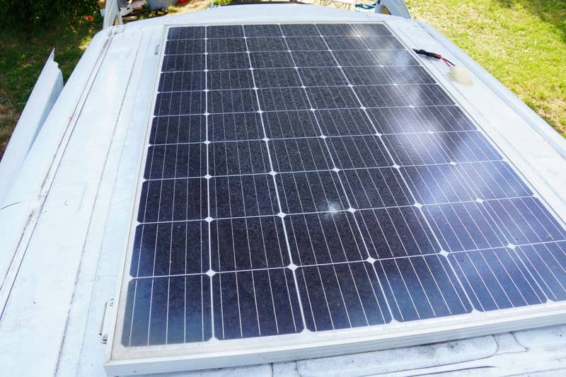

a. Rigid (framed) panels
Rigid panels have a glass front face and require a roof rack or mounting structure fixed to the vehicle. They are the most widely available option, and their price per Wp has fallen sharply in recent years. Depending on size and power, expect to pay between €0.50 and €1.00/Wp.
When it makes sense: Rigid panels offer the lowest cost per Wp and the longest lifespan. If your roof is flat and you are comfortable with a rack installation, or willing to hire an installer, they are almost always the most popular choice due to its cost and performance. A 600 Wp array of rigid panels might cost €400-500 in panels alone, but the rack and installation may add a bit more to that.

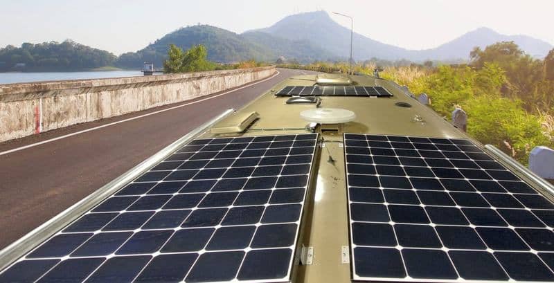

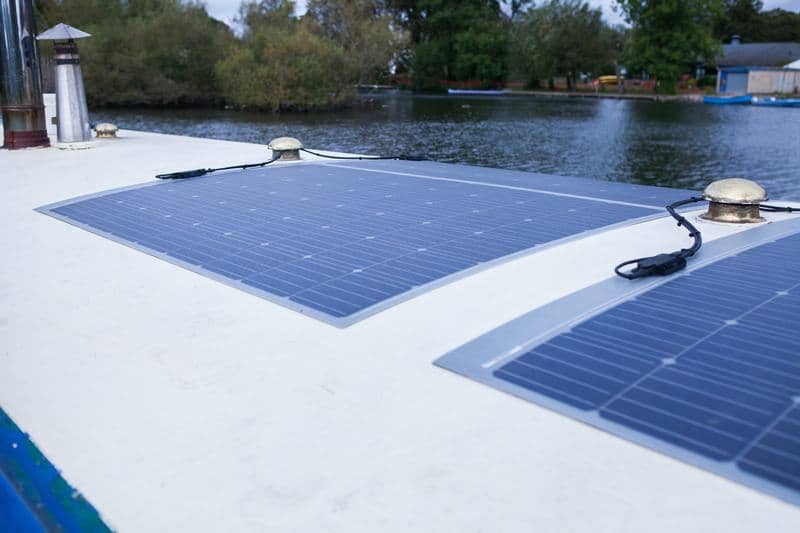

b. Flexible panels
Flexible panels protect their cells with a stack of flexible polymers instead of glass, allowing them to be bonded directly to the roof or body of an RV without any metallic structure. This makes installation simpler and keeps the roofline clean. Lower production volumes make them more expensive, typically around €2.00/Wp.
When it makes sense: Flexible panels are the most preferred choice for curved roofs, low-profile builds, or owners who want to avoid drilling or fabricating a rack, as they are glued to the surface. The trade-off is a shorter lifespan (the polymer laminate degrades faster than glass), lower efficiency due to the limited airflow underneath, and a higher upfront cost per watt. For a 400 Wp system, flexible panels might cost €800 vs. €300–400 for equivalent rigid panels.

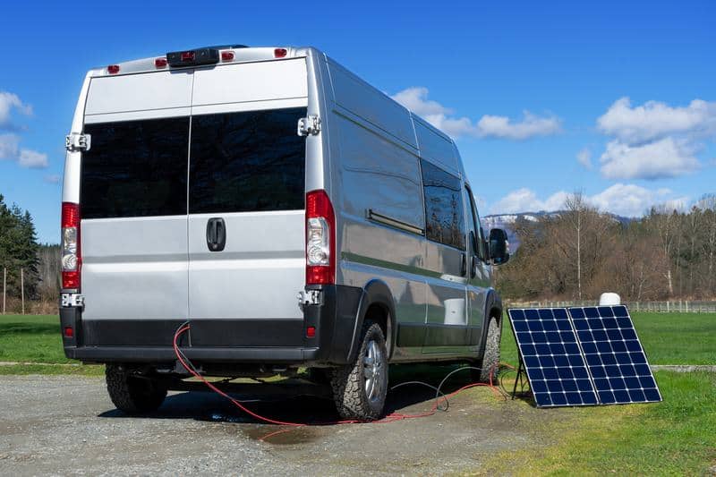

c. Portable/folding panels
Foldable panels
Portable panels (typically folding units with a built-in stand) are not fixed to the vehicle at all. You deploy them at your pitch and connect them to the system. They cost roughly €1.00–1.50/Wp for decent-quality units.
When it makes sense: Portable panels are ideal if you park under trees (you can position the panels in the sun no matter where your van is parked), if you want a low-commitment setup to test solar before committing to a permanent install, or if you want to avoid visible roof modifications and keep a more discreet look.
The limitation: You need somewhere to store the folding panels inside or under the vehicle. Some owners combine a small fixed array with a portable panel to top up capacity when needed (which requires two separate solar charge controllers).

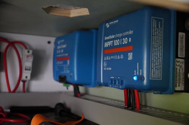

  • PWM (Pulse Width Modulation): A simpler controller that connects panels and batteries directly, reducing voltage to battery level without optimizing power output. For a 300–500 Wp array, a PWM controller typically costs €50–80.
  • MPPT (Maximum Power Point Tracking): This controller uses a DC-DC converter to continuously track the panel's maximum power point, optimizing both voltage and current. MPPT controllers recover 10–30% more energy from your panels compared to PWM, and the gap widens in cold weather and when panels are partially shaded. Expect to pay roughly €100–150 more than an equivalent PWM unit.
For most RV installations, MPPT is worth the additional cost, as you can get the most from your solar panels.
Combined solutions: It is worth knowing that some inverter/chargers incorporate a built-in MPPT controller, such as the Victron EasySolar and the Multi RS Solar. These all-in-one units combine the inverter/charger and solar charge controller in a single device, reducing wiring complexity and overall system cost. If you are planning a system with both solar and AC charging, a combined unit is worth considering.

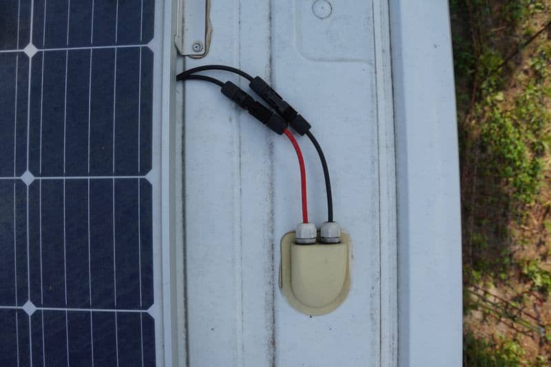

Solar cables and connectors
PV cable (typically 4 mm² or 6 mm²) is rated for outdoor UV exposure and the voltage ranges involved in solar strings. Standard electrical cable is not appropriate. For a typical van install, budget €30–80 for PV cable, depending on run lengths and cable cross-section.
MC4 connectors (the industry-standard plug used to join panels and controller) cost roughly €15–30 for a set of pairs, plus a crimping tool if you are making your own harnesses.
Cable entry housing
If you are running cables from the roof into the vehicle interior, a proper cable entry housing keeps water out and gives the installation a clean finish. A Victron Energy or equivalent cable gland costs €15–30.

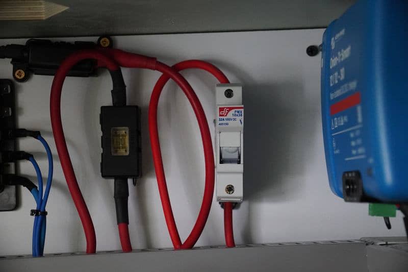

Fuses and protection
Every DC circuit needs appropriate fusing. For the solar circuit, a PV-rated inline fuse or MCB between the controller and battery is essential. For a complete installation:
  • PV inline fuse (between panels and controller): €10–20
  • Battery fuse or ANL fuse holder: €15–40
  • DC distribution: €20–60

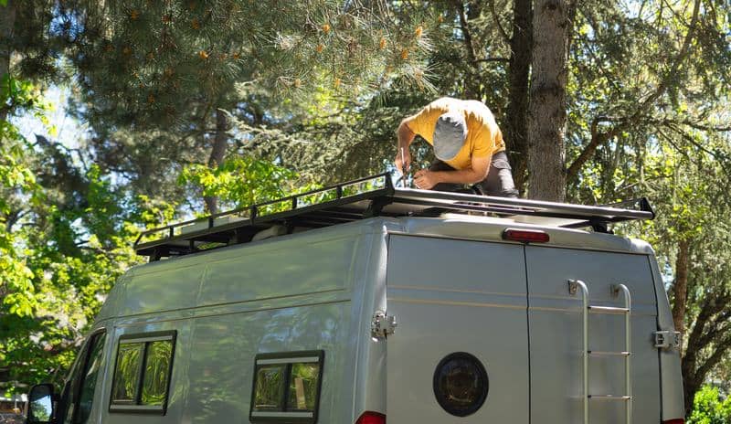

Roof rack
If you are mounting rigid panels, a roof rack could be a neat option. Pre-fabricated aluminum rail kits for one or two panels start around €100–200. A custom-welded steel rack from a fabricator could also be an option, of course, which would add to the price.

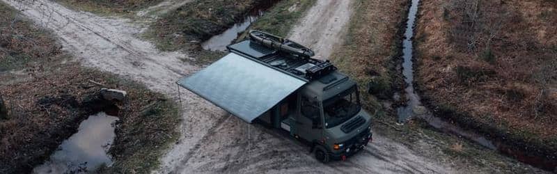

Entry-level camper solar systems - read more: https://www.victronenergy.com/blog/2026/03/27/four-season-rv-with-solar-power/
Read more about this system here.
Entry-level DIY system
Approximate total: €700–1,000
Suitable for occasional weekend use, phone and laptop charging, a 12V cool-box.
Solar system components:
  • 215 Wp flexible panel
  • Victron Energy SmartSolar MPPT 75/15
  • 1x 100 Ah AGM battery
  • Basic accessories

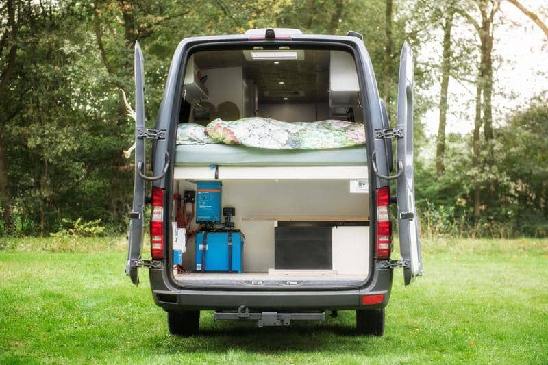

Mid-range RV solar system - read more: https://www.victronenergy.com/blog/2024/04/12/master-craftsmens-two-year-mercedes-conversion/
Mid-range DIY system
Approximate total: €1,800–2,500
Suitable to run all standard 12V loads (fridge, lighting, water pump, device charging) plus high-wattage 230 V loads for shorter periods (a few hours per day) for several days off-grid.
  • 610 Wp rigid panels
  • Victron SmartSolar MPPT 100/50
  • 2 x Victron SuperPack 12.8V/100 Ah lithium batteries
  • Accessories

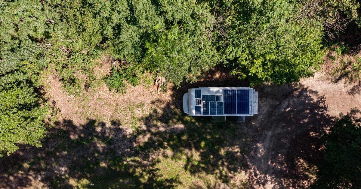

High-level RV solar system - read more here:https://www.victronenergy.com/blog/2019/04/04/9kwh-of-lithium-reserve-to-roam-the-roads/
Well-equipped campervan system
Approximate total: €3,500–5,000
Suitable for extended off-grid travel covering all standard 12V loads (fridge, lighting, water pump, device charging) plus higher-demand inverter loads such as an air conditioning unit or induction hob. Solar system components:
  • 800 Wp rigid panels
  • Victron SmartSolar MPPT 150/45
  • 3x Victron SuperPack 12.8V/100 Ah lithium batteries
  • Full accessory kit including roof rack, fusing, and cable entry
