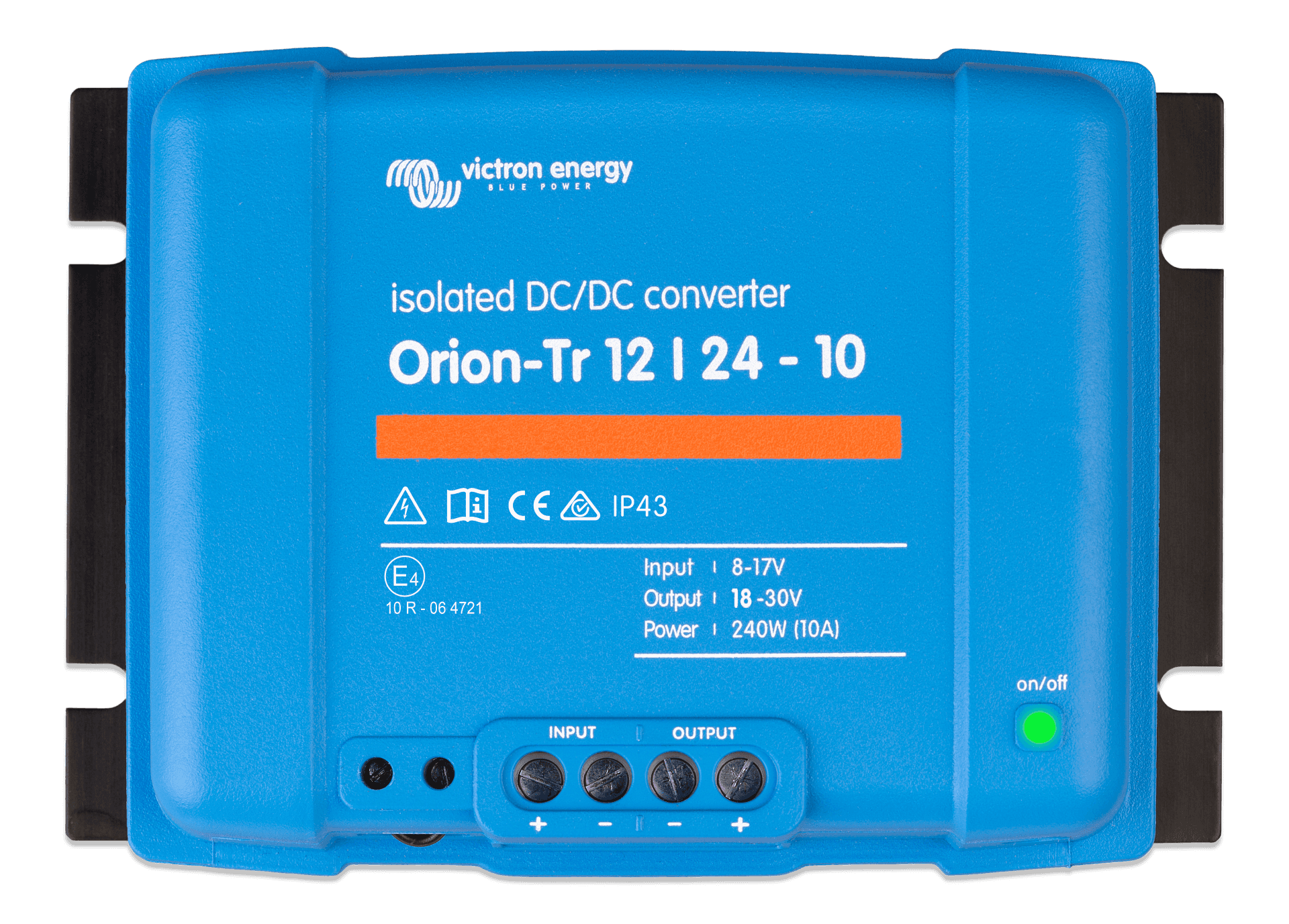

DC-DC converters
DC-DC converters
DC-DC converters are used when different DC voltages are needed. For example, they can convert 12 V DC from batteries for use with 24 V equipment, or vice versa, and allow alternators to charge battery banks.

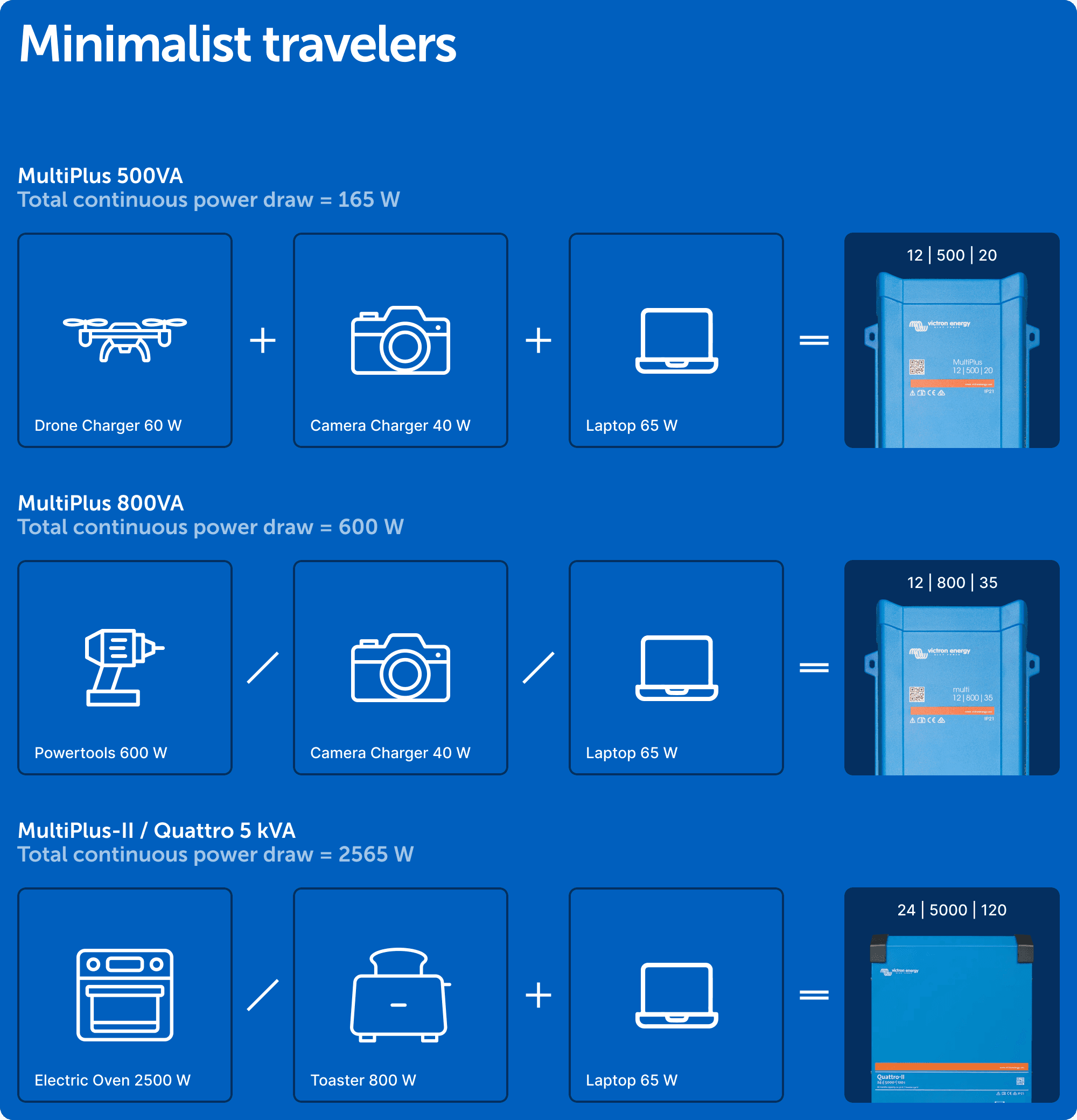

The inverter output power must be sized to support the highest expected continuous AC demand of the connected loads, including the combined wattage when multiple AC appliances are used at the same time. This section outlines the key considerations used to determine the required inverter output power.
Continuous load
The inverter output must be sized to support the highest expected continuous AC demand of the connected loads. In smaller or residential systems, this may include appliances such as laptop chargers, TVs, induction hobs, air conditioning units, and kitchen equipment. The same sizing logic applies to larger or more complex installations.
Combined loads
A common mistake is sizing an inverter based only on the highest-power AC appliance used off-grid. To avoid overloading the inverter, it’s also important to consider combined loads, meaning several AC appliances running at the same time.
For example, if a kettle is used off-grid while an induction hob is already on, the inverter/charger must be sized to handle both loads together. In many systems, not all loads are intended to run from the inverter, and non-essential, high-consumption appliances can be excluded.
Making a realistic estimate of which appliances are likely to run at the same time helps ensure stable operation during peak-use periods.

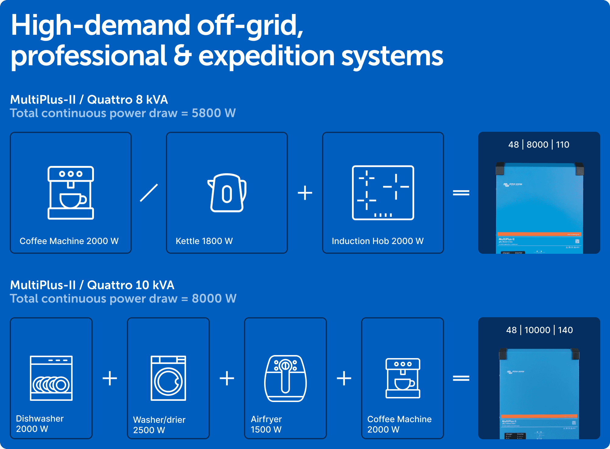

Minimalist travellers example
Comfort focused example
High demand off-grid example

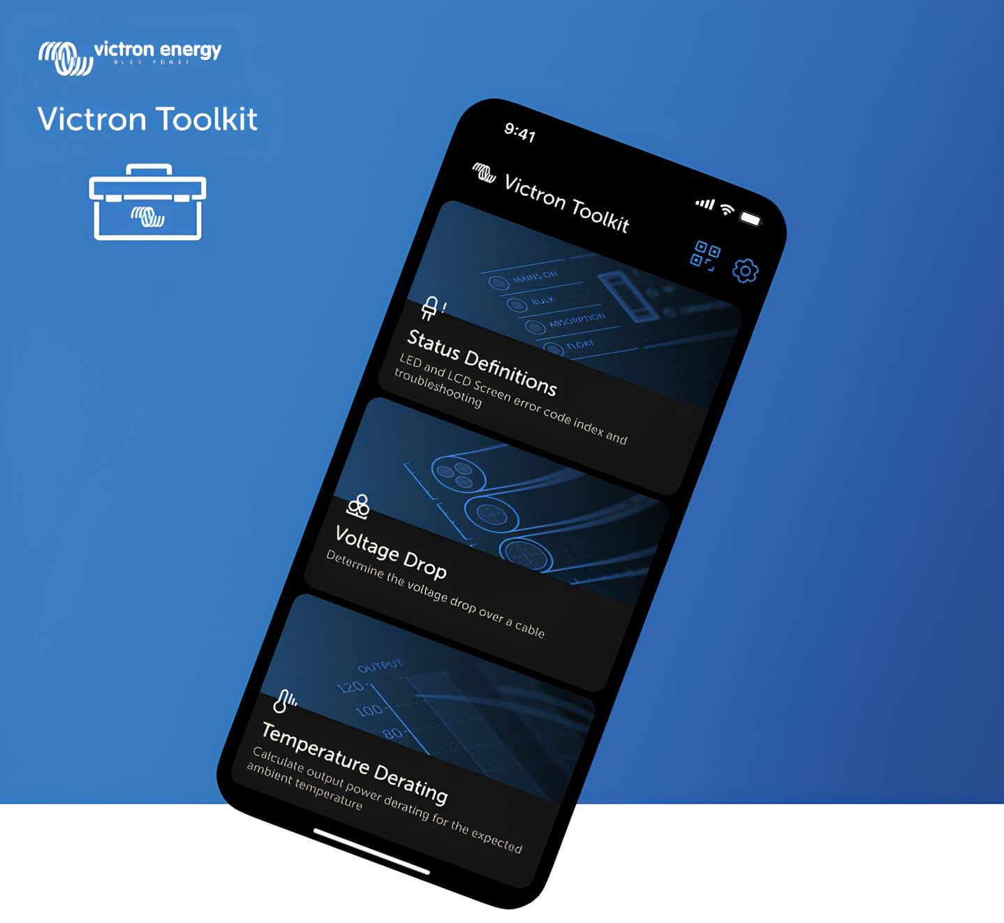

Victron Toolkit App
If you need help with calculations or troubleshooting, the Victron Toolkit App can help. It includes tools to calculate cable size and voltage drop, explains all LED codes for Multi and Quattro inverter/chargers, and helps calculate inverter and charger output derating for the expected ambient temperature.
Victron Toolkit App
