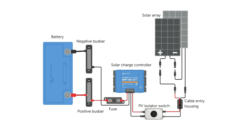

A typical campervan solar system is built around the following three main components:
1.Solar panels:
Convert sunlight into DC electricity. Two common types are used on campervans are:
  • Rigid panels: Mounted on brackets above the roof, they are durable and offer better airflow than flexible panels, making them more efficient and longer-lasting. Explore our BlueSolar solar panel range.
  • Flexible panels:Thin panels that can follow slight roof curves. They sit closer to the roof and are lighter, which can be useful if you want a discreet installation.
2. Solar charge controller:
Regulates the power coming from the panels and charges the battery safely. It prevents overcharging and helps maintain battery health. There are two main solar charge controller types:
  • PWM (Pulse width modulation):
    A simple and affordable option, but not very efficient. PWM controllers are typically used in smaller systems where panel voltage closely matches battery voltage.
  • MPPT (Maximum Power Point Tracking) solar charger:
    This is the preferred solar charge controller option due to its higher efficiency compared to PWM charge controllers.
    Within the Victron Energy MPPT range there are BlueSolar and SmartSolar models. SmartSolar MPPT chargers include built-in Bluetooth, allowing you to monitor and adjust the settings via the VictronConnect app.
    BlueSolar MPPT chargers do not include built-in Bluetooth, but their data can still be accessed by connecting them to a GX device, such as a Cerbo GX, or by adding a VE.Direct Bluetooth Smart dongle.
Load output
SmartSolar and BlueSolar MPPT solar charge controllers smaller than 100/30 also include a load output, which is not shown in the wiring diagram above. This allows small DC loads, such as lights or USB chargers, to be connected directly to the controller. The controller can automatically disconnect these loads if the battery voltage becomes too low, helping to protect the battery from deep discharge.
3. Battery bank:
And of course, we need a correctly sized leisure battery to store the energy received from the panels and other charging sources.
Additional Components
Alongside the main components, a safe and reliable PV system also requires:
  • PV isolator (photovoltaic isolator): A DC-rated safety switch that allows you to disconnect the solar panels from the charge controller for maintenance or emergency shutdown.
  • DC distribution: Such as a Lynx Distributor or a busbar. This provides a central point to connect batteries, chargers, inverters and loads, and helps organise the DC wiring.
  • Cables and protection components: Correctly sized solar cables, cable lugs, DC fuses and fuse holders. These protect the system against overcurrent, short circuits and overheating.
  • Installation hardware: Such as solar panel brackets (for rigid panels), cable entry housings and other mounting components.

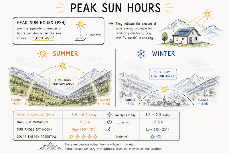

The watt rating of a solar panel shows the maximum power it can produce under ideal conditions, i.e. without partial shading or dirty panels.
But as you can guess, solar panels can't supply this power all day. Instead, solar calculations use Peak Sun Hours (PSH), which represent the equivalent number of hours per day when sunlight intensity averages 1000 W/m².
Average PSH values for different locations and seasons can be found online.
Peak sun hours vary depending on where you travel and during which months. An Alpine village in summer, for example, may get around 5 peak sun hours per day. So, an RV designed for summer trips in the Alps, with a daily energy consumption of 720Wh, would roughly need a 144W solar array to fully replenish that energy each day (720Wh ÷ 5 hours = 144W).
However, there's one more thing to consider. In the example above, we sized the battery bank to supply energy for 3 days without charging (optional, but we wanted more freedom), and concluded that a 200Ah lithium or 360Ah lead-acid battery bank would be a better fit for this system.
Now, let's assume, for a moment, that solar is the only charging source for this system (disregarding alternator and shore power charging). In this case, it would take roughly 18 peak sun hours to fully recharge the 360Ah lead-acid battery bank, or 15 peak sun hours to fully recharge the 200Ah lithium battery bank, using only the 144W array.
For an RV that doesn't drive around much and stays off-grid most of the time (i.e. relying mainly on solar to recharge), this isn't ideal, and a bigger solar array is recommended. Being able to fully recharge your batteries in 4-5 peak sun hours, using solar alone, is a much more practical target, since it means your batteries can realistically recover within a single sunny day, rather than needing 3-4 days of consecutive sunshine.
Based on this, you'd need to roughly triple the array size, to around 450-500W, to bring full recharge time down to about 5 peak sun hours. This is why solar arrays are often sized well beyond the daily-consumption minimum, especially for RVs that spend extended periods off-grid.

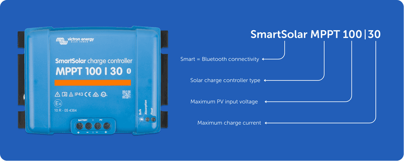

Victron Energy MPPT chargers are named directly after their two key limits: maximum PV input voltage and maximum charge current. Take the SmartSolar MPPT 100/30, for example:
Victron Energy MPPT names explained
This means the charger can accept up to 100V from the solar array and deliver up to 30A of charging current to the battery.
