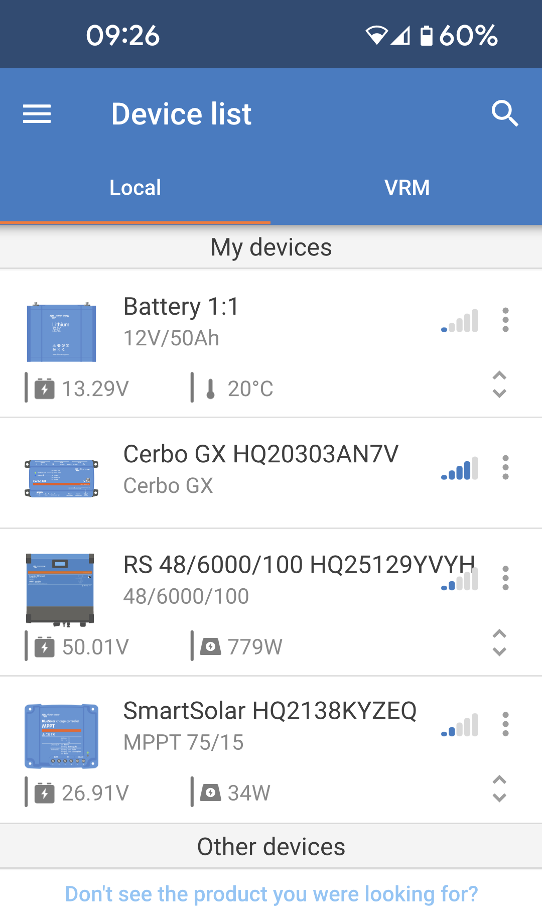

Device list
Local The Local tab lists all Bluetooth devices that are in range or any device which is connected by USB dongle. A GX device which is on the same network as the VictronConnect device will also be shown here, even if it is out of Bluetooth range. |
VRM If VictronConnect is signed in with your VRM account, then it will list all of your installations on the "VRM" tab, When you click on an installation, then the devices associated with that installation will be listed. |

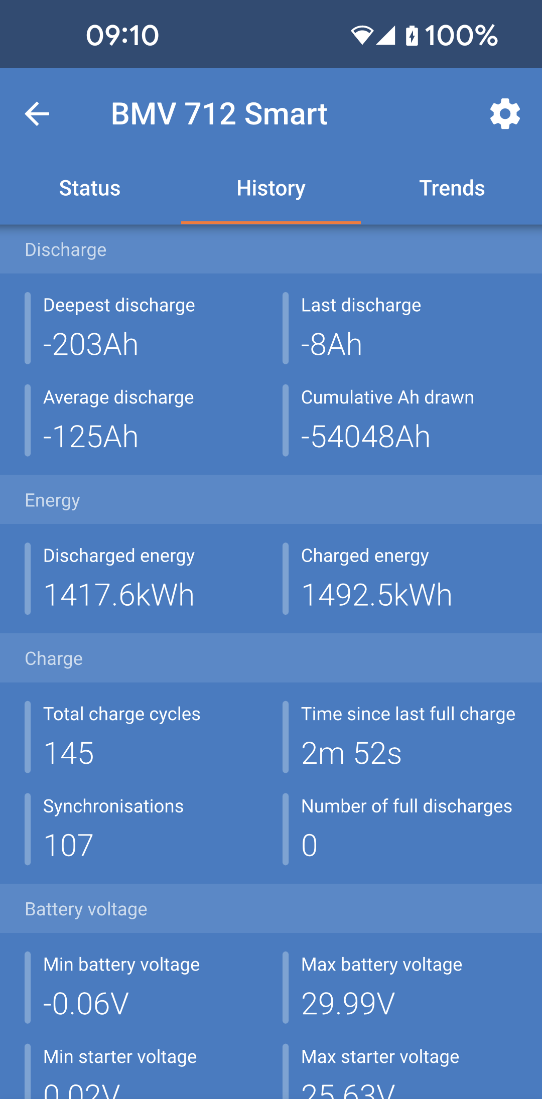

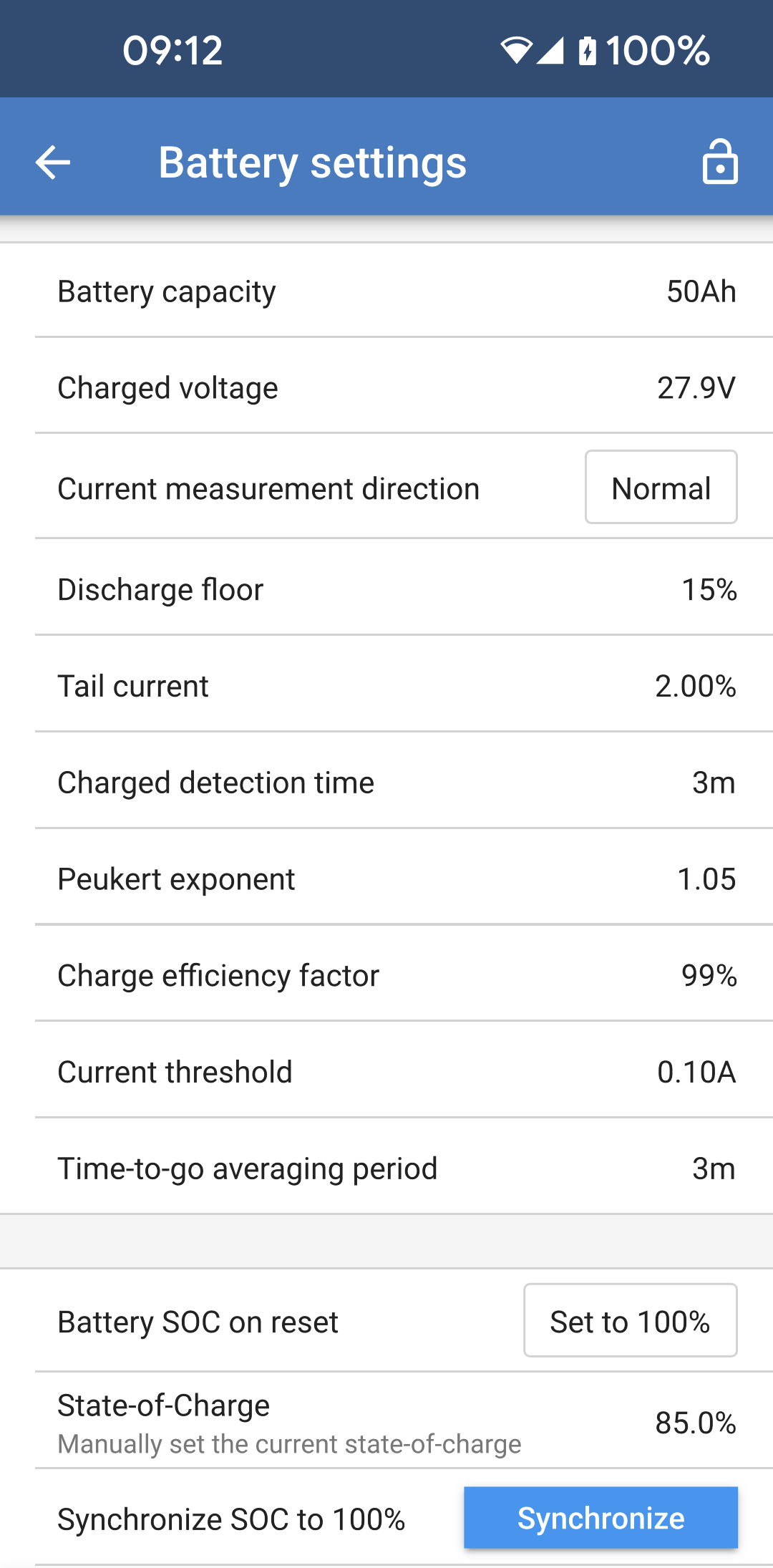

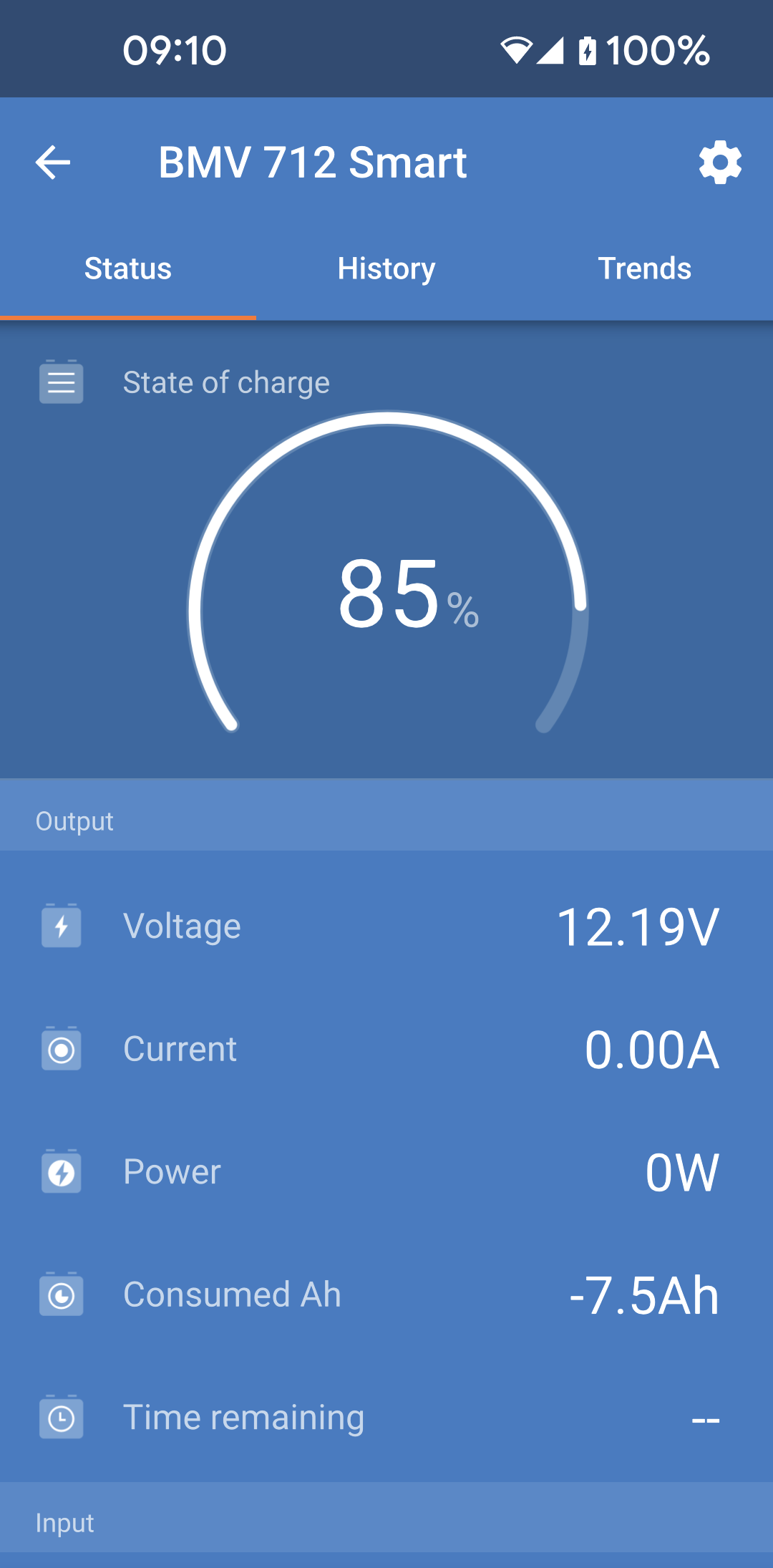

Clicking on 'Battery Monitor' will show the current state of charge, and allows you to toggle between screens showing more detailed information concerning the current battery STATUS, and HISTORY data.
To access 'Settings' click on the cog
icon at the top right of the screen.

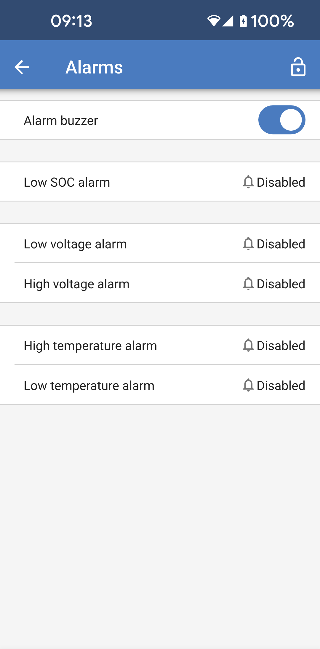

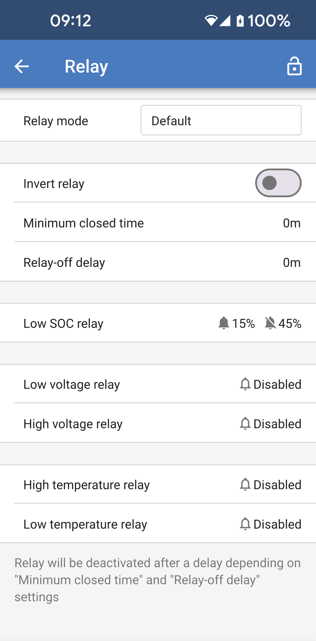

From 'Settings' you can change the data concerning your battery storage; set alarms and relays; change charging parameters; tailor the appearance and quantity of data displayed and set up or join an existing VE.Smart network.

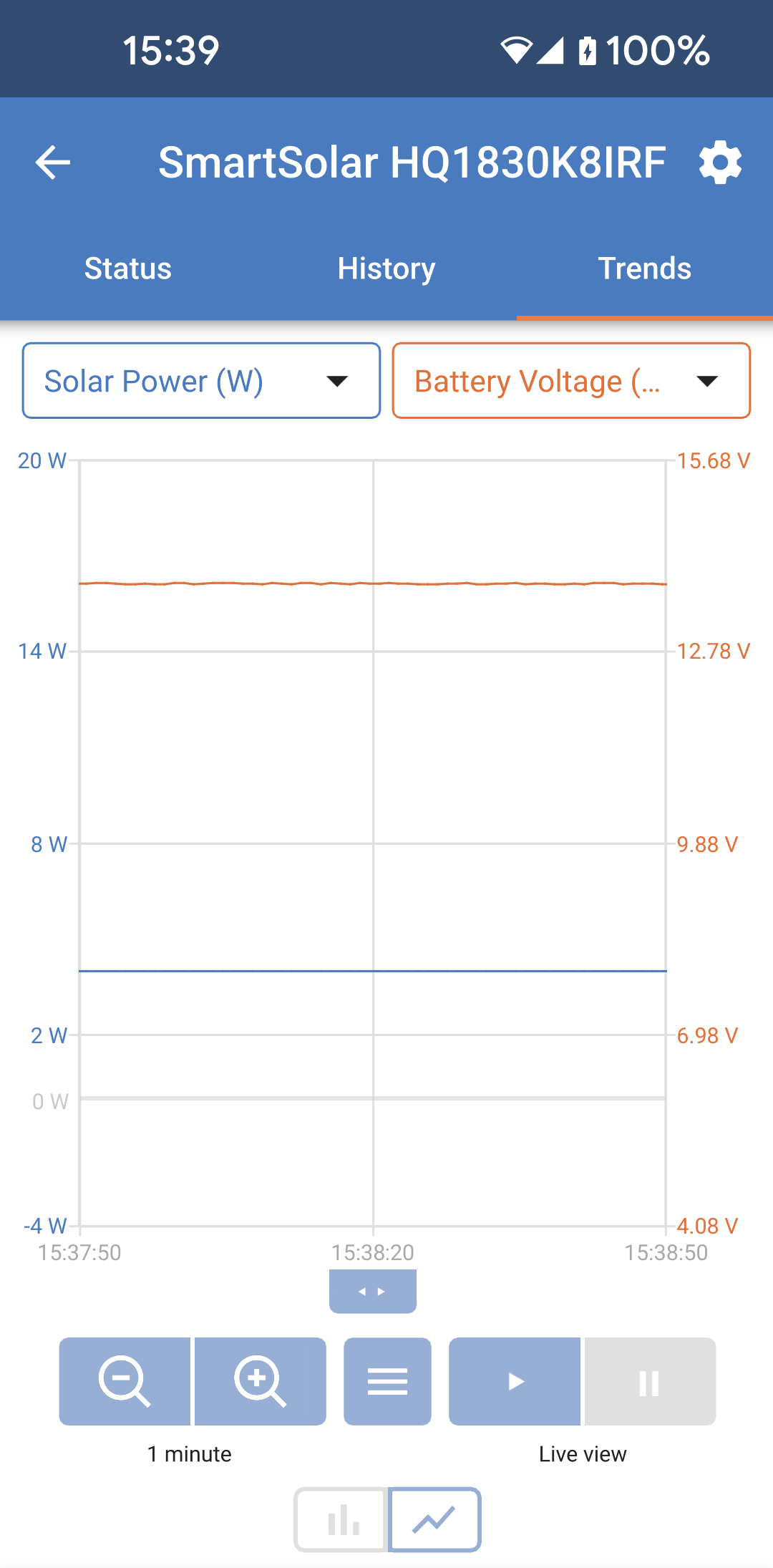

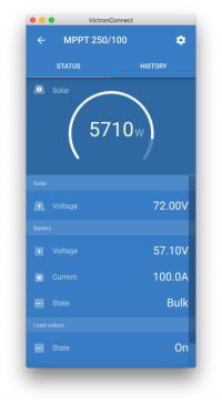

Solar Charge Controller pages

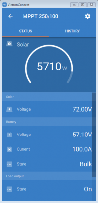

Clicking on your Solar Charge Controller product allows you to view the current charging status.

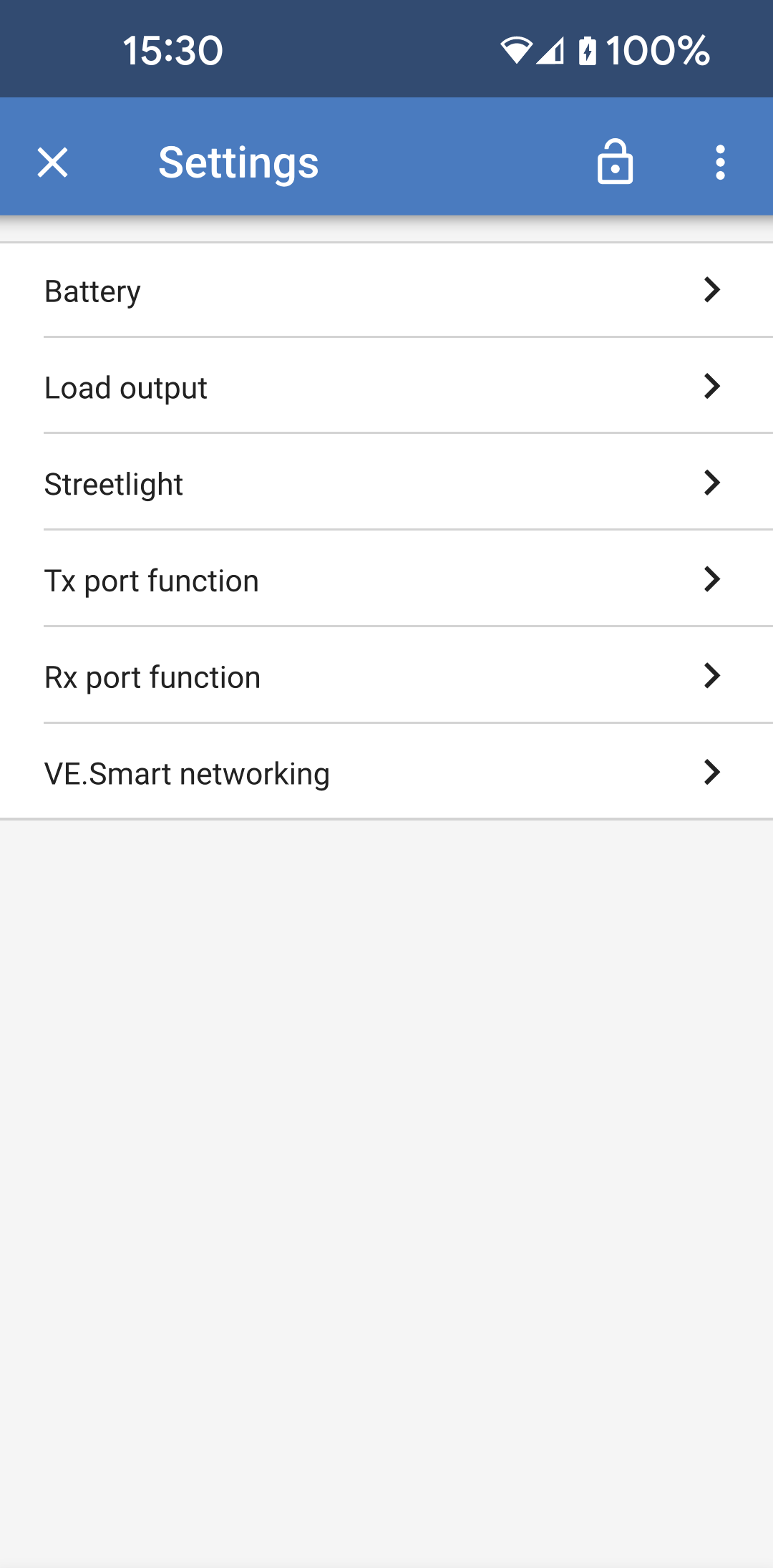

'Settings' will allow access to the extensive range of functions available on your solar charge controller, including programming the charge settings; initiating relays which are triggered by solar time, or by voltage parameters; together with comprehensive historical analysis.
For a full explanation of the Solar Charge Controller options follow this link.

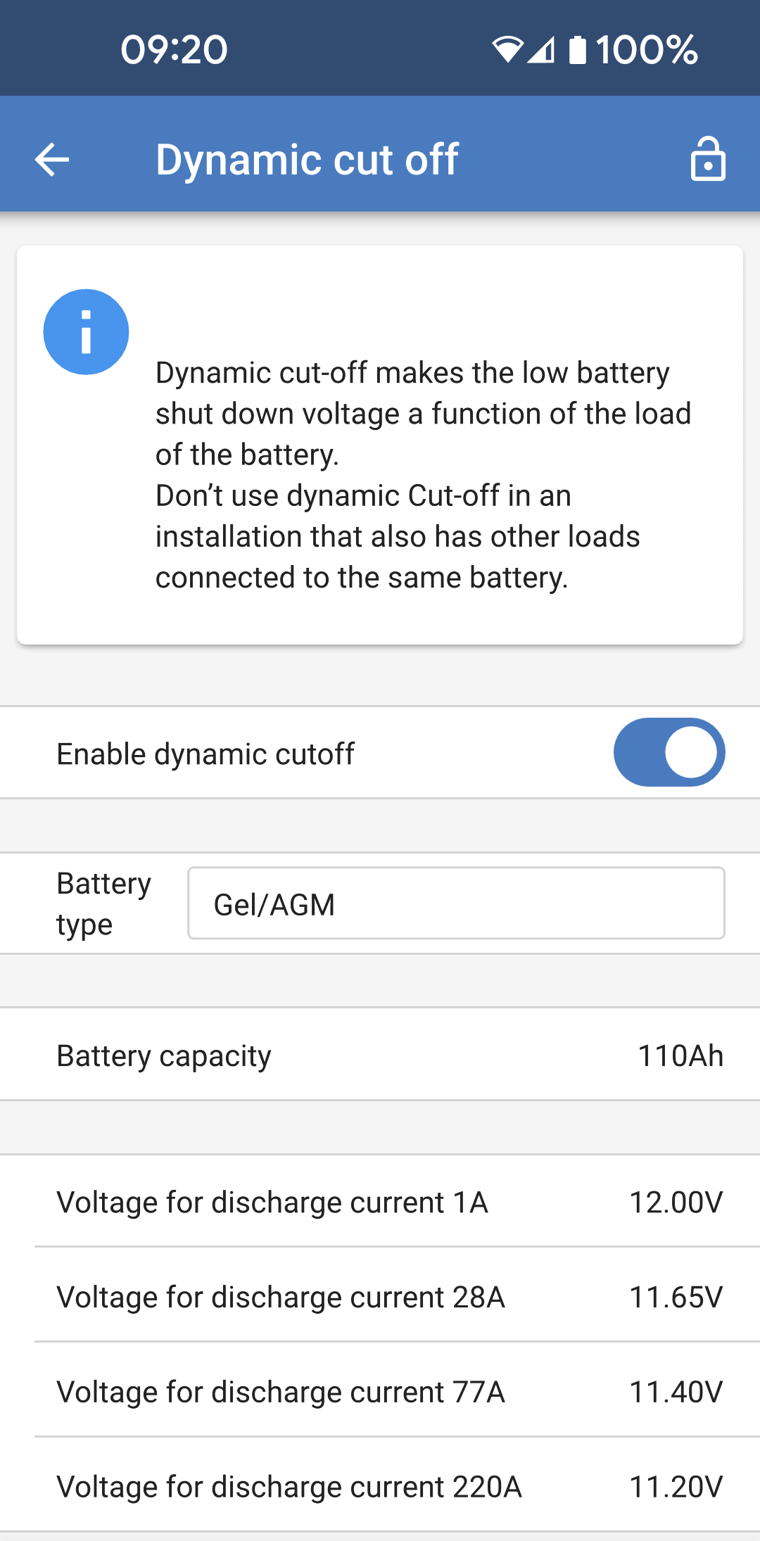

Inverter pages

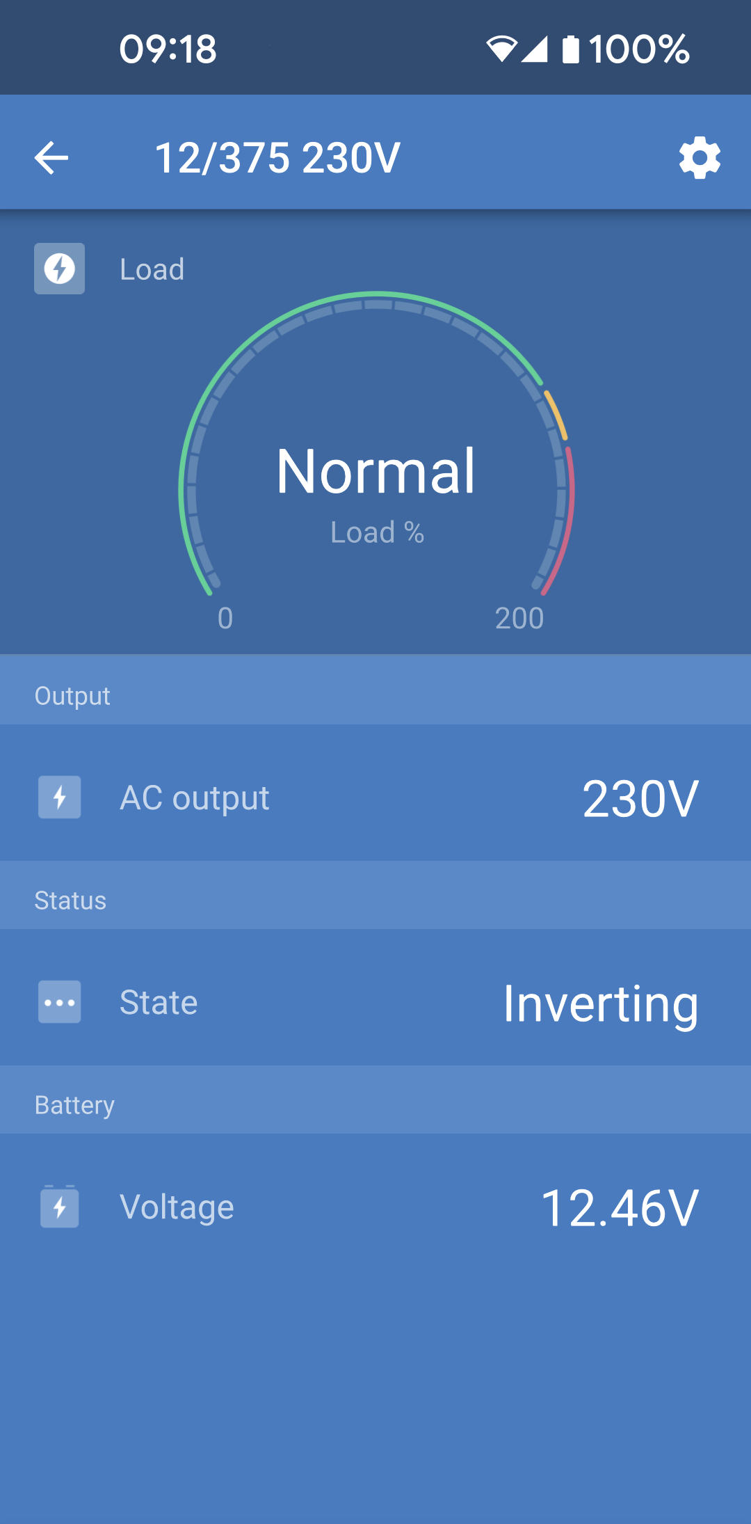

Clicking on the Inverter allows you to view dynamic data such as power-draw of connected loads; a power bar will show how hard your inverter is working, and you will find information such as battery voltage, etc.
'Settings' will allow you to set output voltages/frequency; set low voltage shut-downs, and restarts - together with their alarms; set a dynamic cut-off - based on load; together with other settings about which more information can be found here.

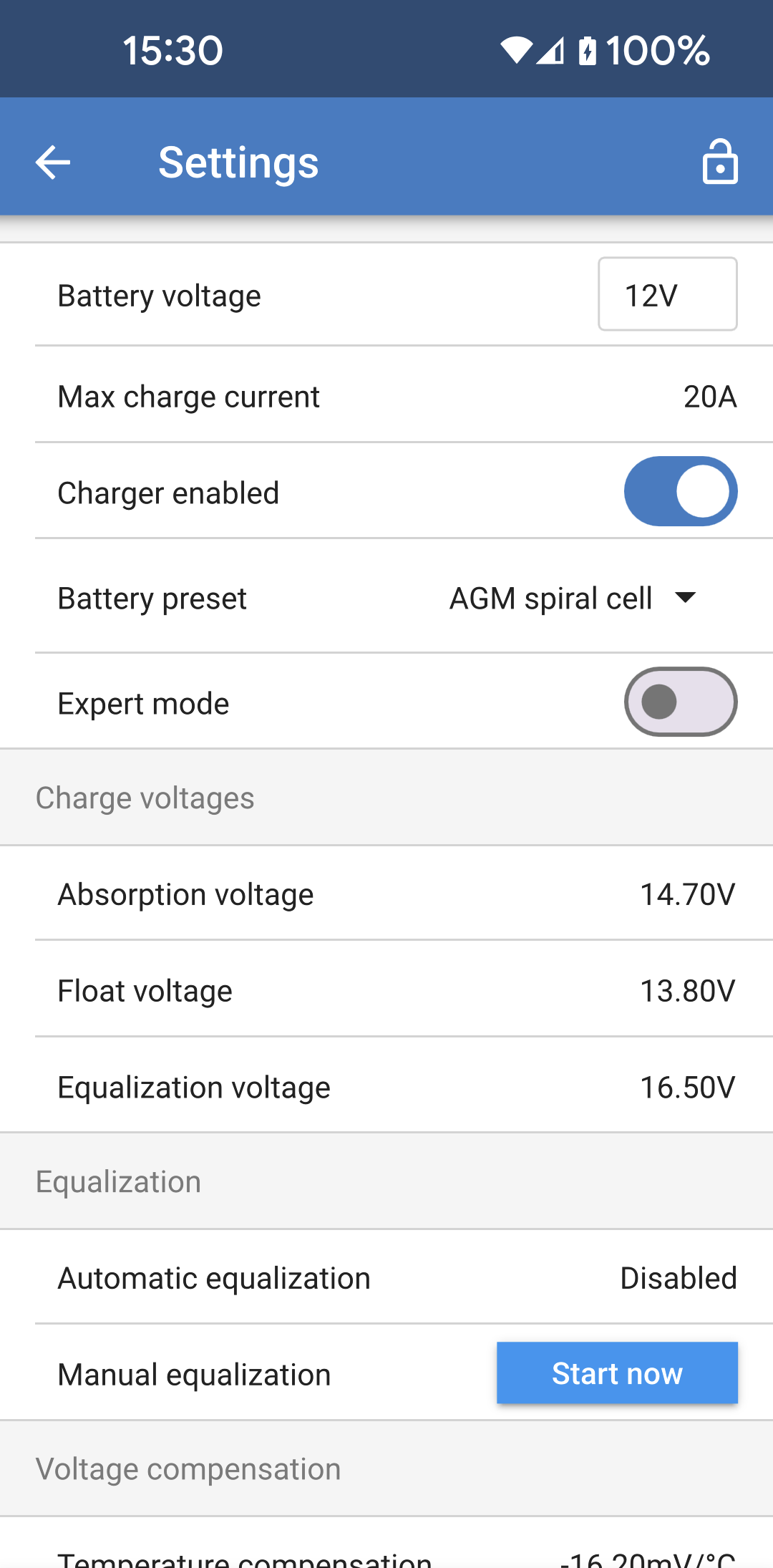

Blue Smart IP65 charger pages
The Blue Smart IP65 battery charger comes with Bluetooth already built-in. When the Blue Smart charger is powered-up it will be discoverable using the VictronConnect app on your phone or computer.
The 'home' page shows information about the battery voltage, charge current, and where your battery is in the charging cycle.
To access 'Settings' click on the cog icon

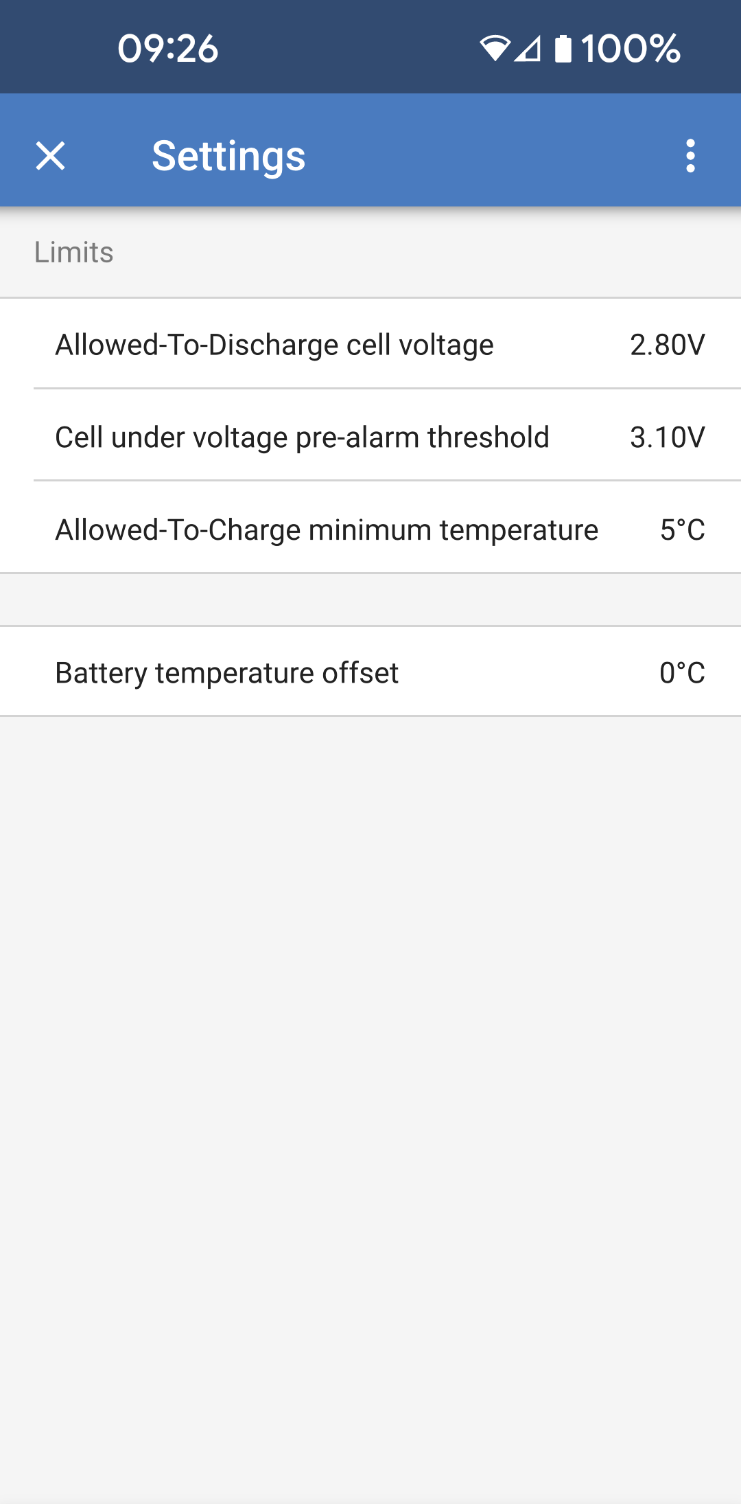

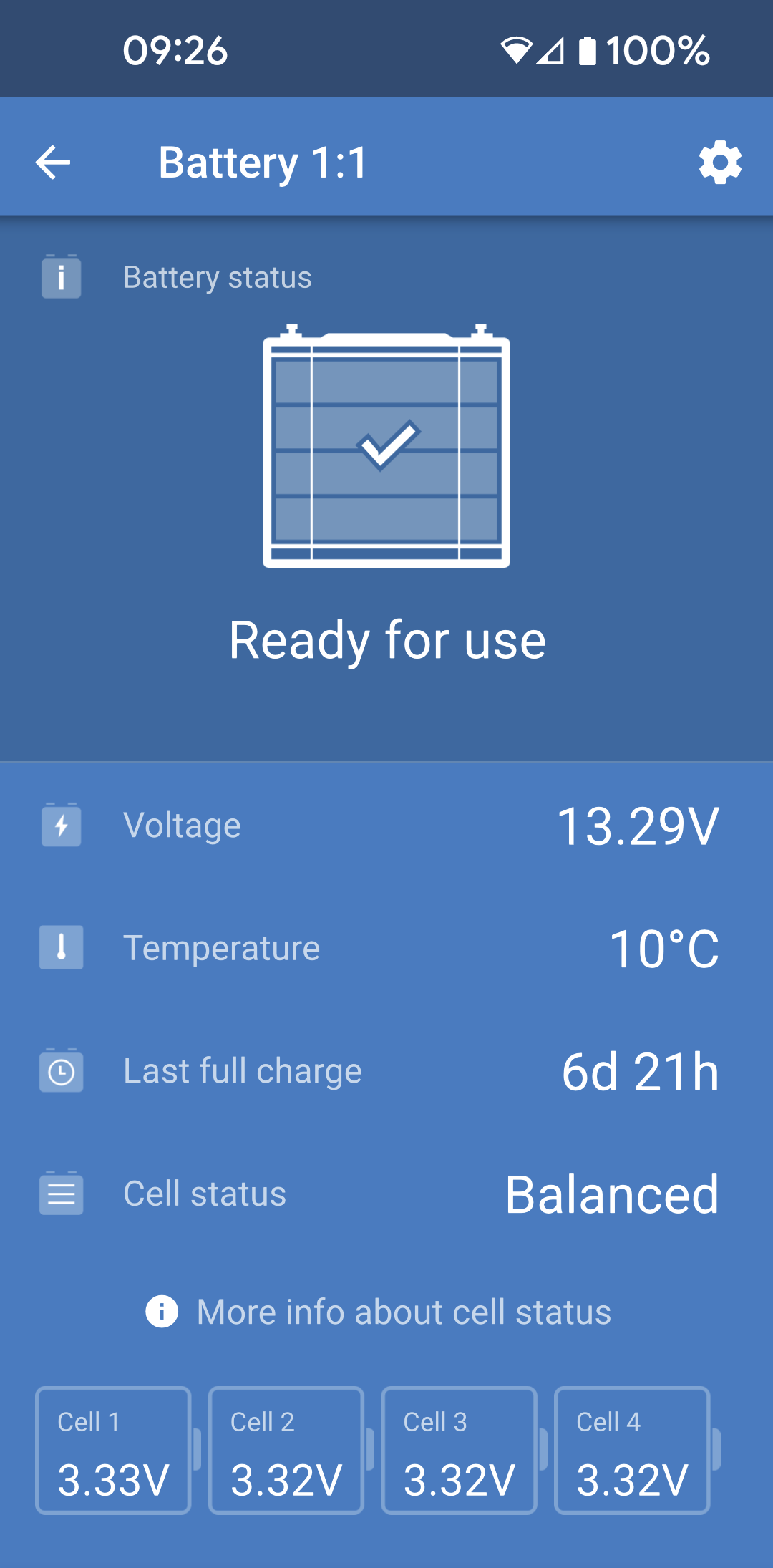

SmartLithium Battery

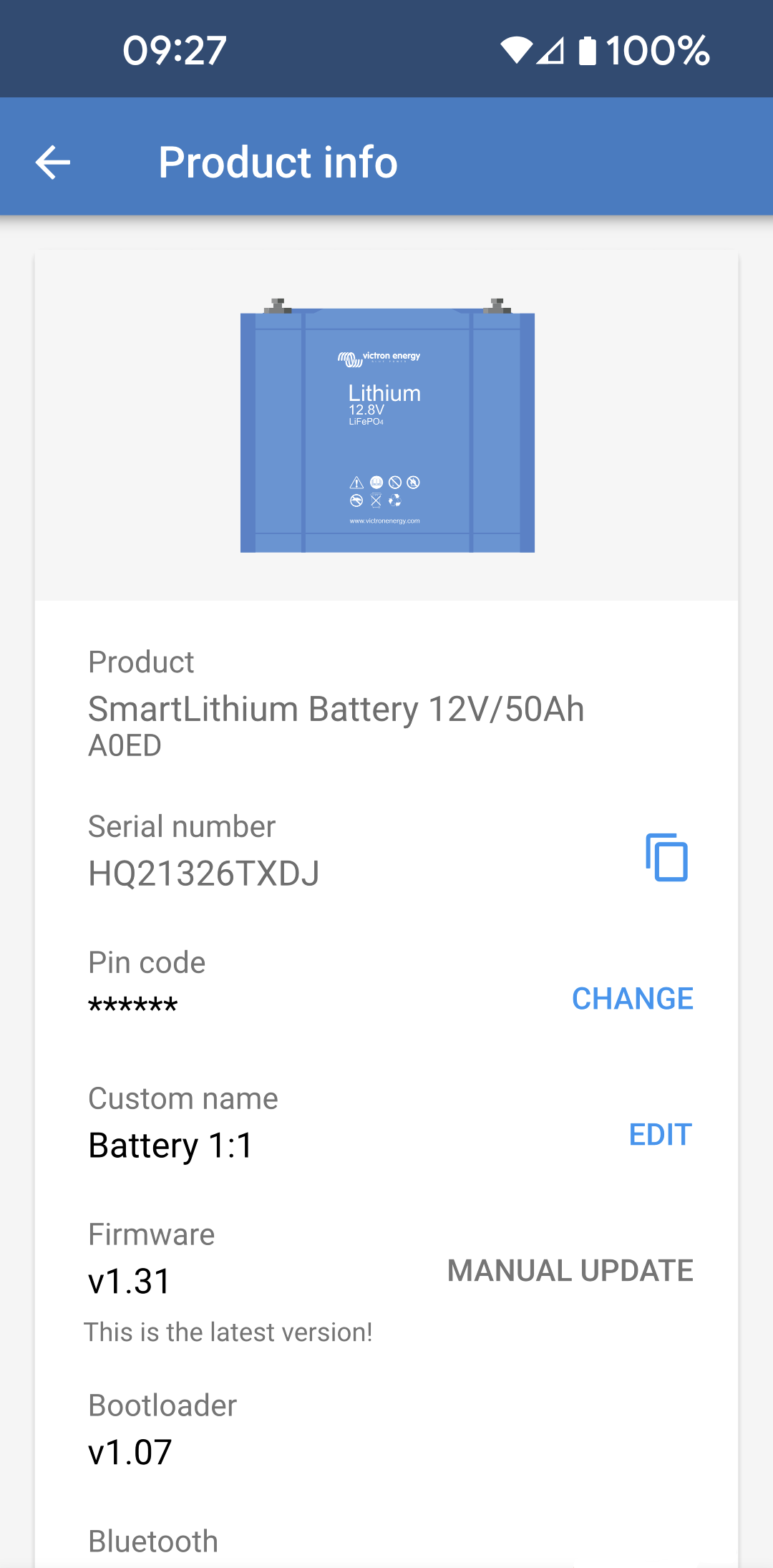

Lithium Batteries Smart have Bluetooth built-in. Clicking on the Lithium battery from the Device list will allow you to view live data about the battery status, voltage, and temperature. You will also see the voltage of each cell - which is an essential guide to battery health.
From 'Settings' you can change discharge and temperature parameters.

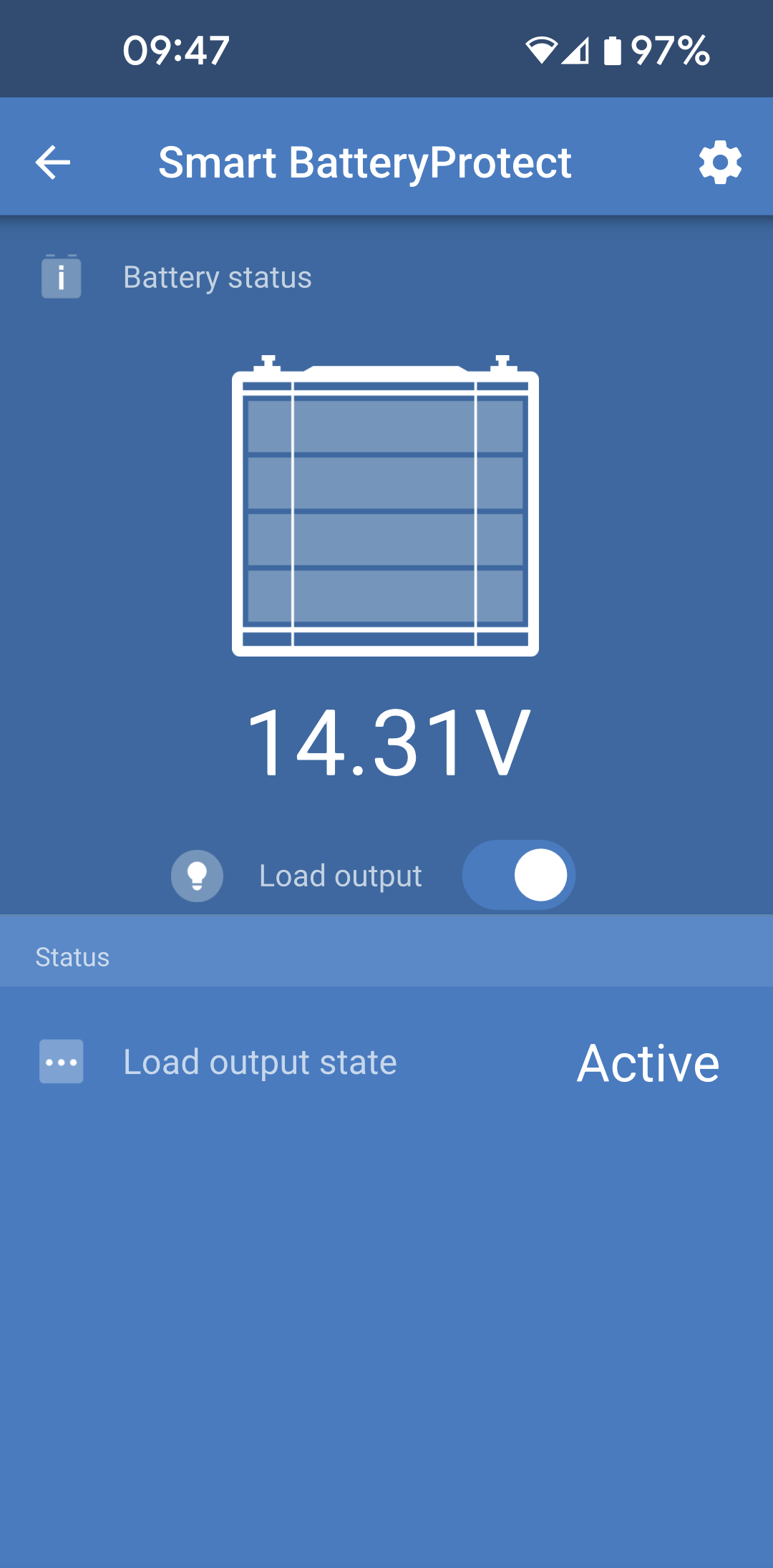

Smart BatteryProtect

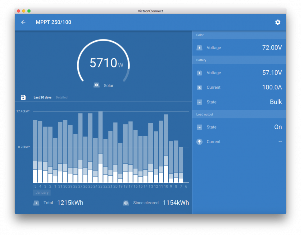

Windows

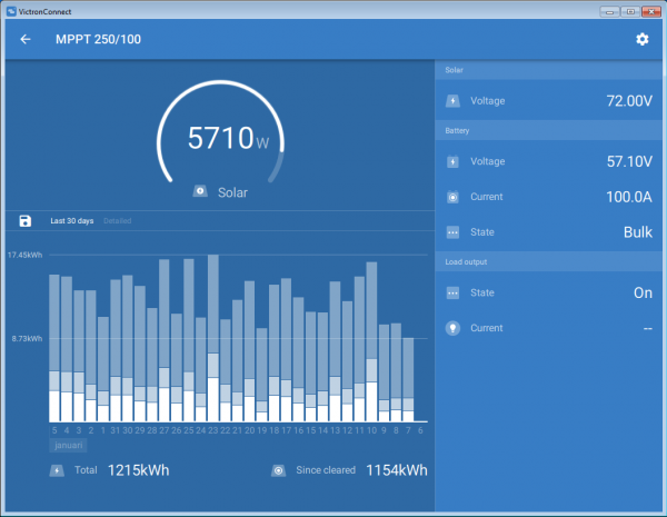

Here is a VictronConnect app screenshot from a PC using a version of the Microsoft Windows operating system showing information from an MPPT.
macOS
Here is a VictronConnect app screenshot from a PC running the Mac Operating System showing information from an MPPT.

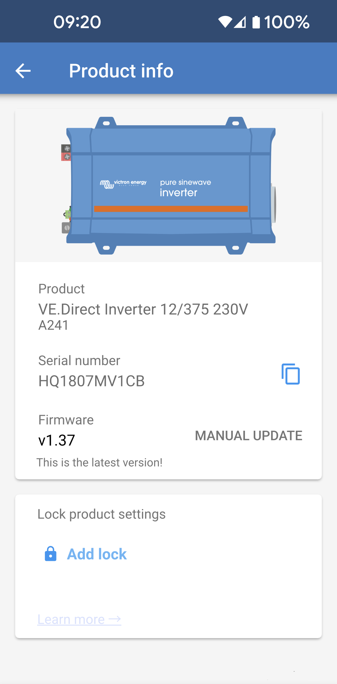

First, complete your connection; then go to the Product info page by clicking the button on the upper right:
For some products, it will be the settings icon:
. After opening that menu press
, and click Product info.For other products you'll find the
button on the upper right, which takes you straight to the Product info page.
If the product has the feature that Bluetooth can be disabled, you will see the field “Bluetooth” with a switch button next to the text “Bluetooth enabled”. Toggle the switch to off, the button will turn from light-blue to grey and a dialogue will be displayed to confirm your action. If you choose to “Cancel” the change Bluetooth will remain on and the switch button and text will return the “Bluetooth enabled” position.
For some products, a Disable button is shown instead of a toggle switch.

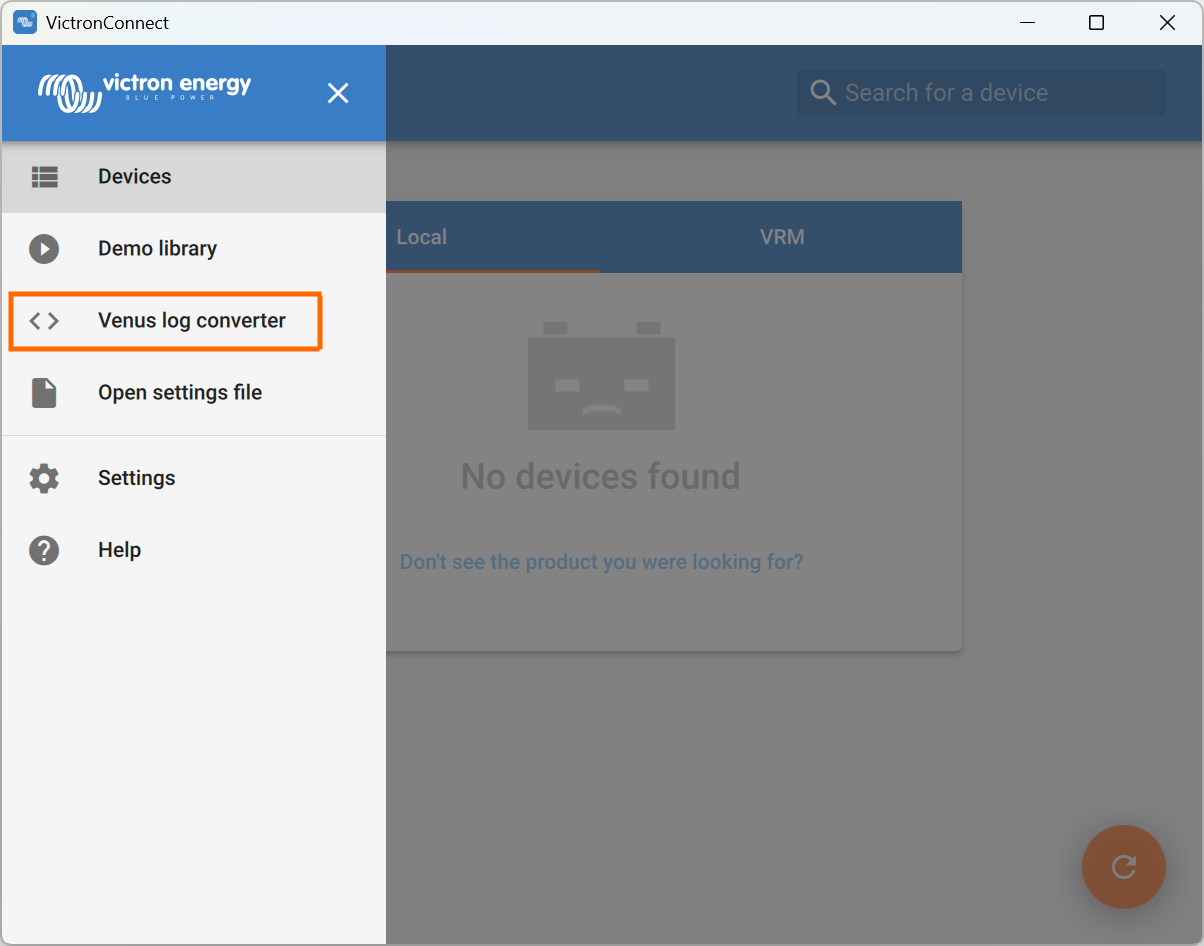

5.5. Importing and converting a GX Product Family database File
VictronConnect allows you to import and convert the .sqlite database log file (that is created by the VenusOS on the GX Product Family) to a Microsoft Excel .xlsx file.
This can be useful for remote sites without an internet connection, to upload the file to the VRM Portal, or if you do not wish to upload your data to Victron servers.

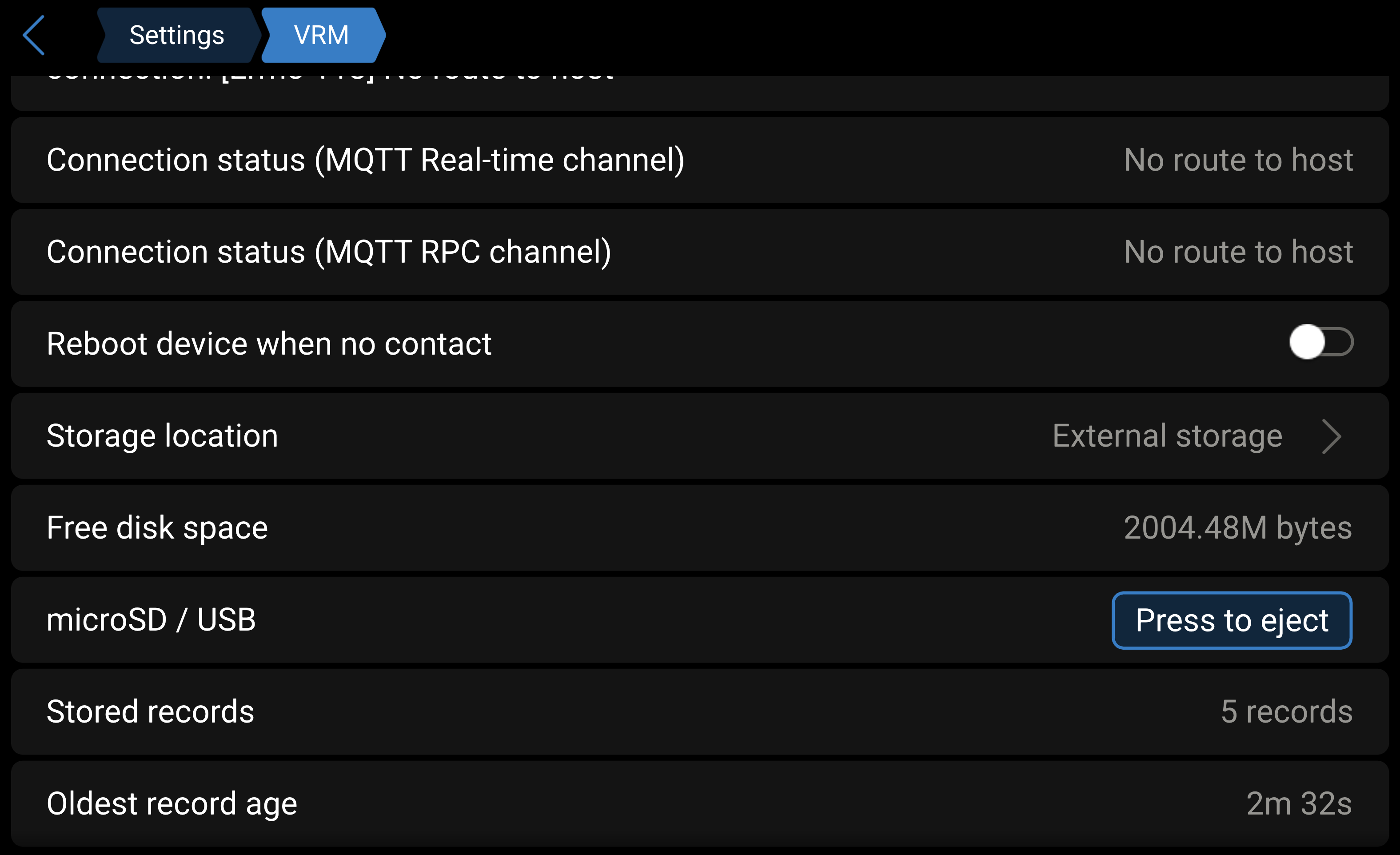

The "Venus database file" will be stored on an external microSD card or USB stick which must be connected to the GX device.
Note
Data will only be saved on the external storage device if the GX device is offline. If the GX device has a connection to VRM, then the log data will be pushed to VRM, and no data will be stored on the external storage.
It's important to eject the microSD or USB storage device before removing it from the GX device.
NoteThe "Press to eject" button will only be shown if an external storage device is detected.
Copy the database file (.sqlite file located in the root directory of the memory stick) to the local hard drive of the computer.
There is no upper limit to the size of the database that you can import, and it can potentially be many years of data, so please be patient during the conversion process.
This process does not require an internet connection, it can be done remotely on site, and your data will never come into contact with Victron servers.
Note if you would like to use the graphical tools of VRM, it is possible to ZIP compress and upload the pre-conversion database file to VRM as well.
