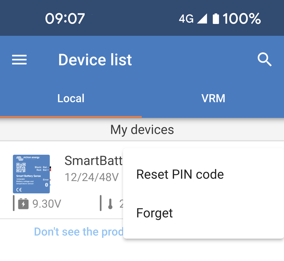

3.3. Bluetooth Smart - Resetting the PIN code
If the PIN code is lost, it can be reset to 000000. This also applies to products that have already been delivered from the factory with a random PIN code. Resetting with the PUK code will reset the PIN to 000000, not to the random factory PIN.
After resetting the PIN, ensure that you change it from 000000 to prevent unauthorized access.
Follow one of the steps below, depending upon the product:

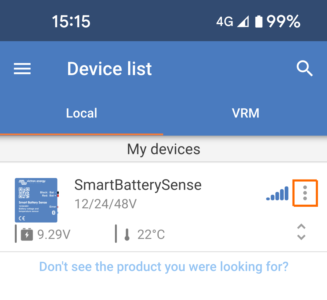

These steps apply to the following products: Blue Smart Charger IP22, Blue Smart Charger IP43, Blue Smart Charger IP67 Smart Solar MPPT charge controllers SmartShunt, BMV-712 Smart, Smart Battery Sense Lithium Battery Smart, Lithium NG Battery On the device list: tap or click the three-dots menu on the right side of the product description. A menu will pop up offering a 'Reset PIN code' option. Click that, and enter the PUK code. The PUK code can be found on the product label, on the back of the product. |

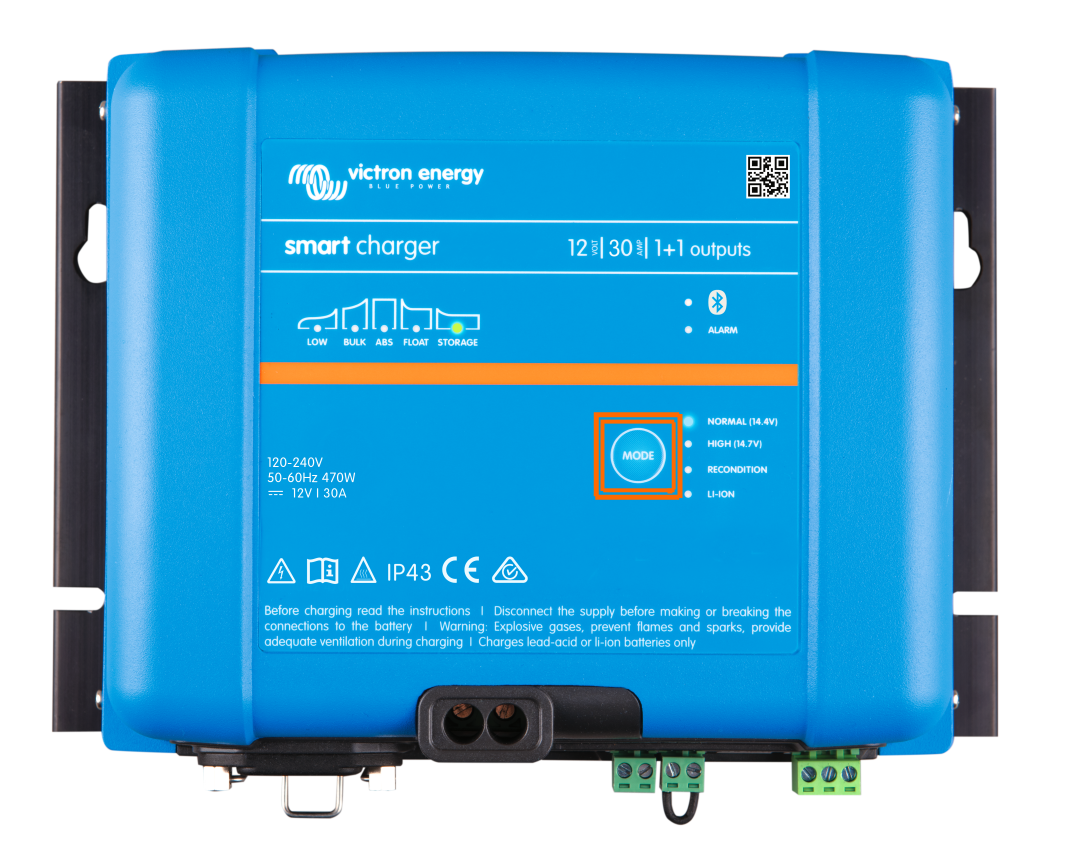

Some chargers feature a Mode button, allowing you to reset the PIN code by holding it down for ten seconds until the blue LEDs flash twice. Blue Smart Charger IP22 Blue Smart Charger IP43 Blue Smart Charger IP65 |
