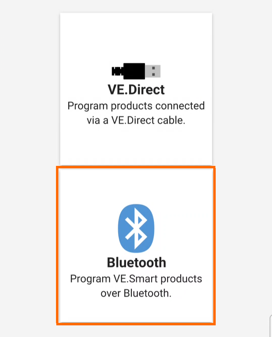

One of two connectivity methods can be used:

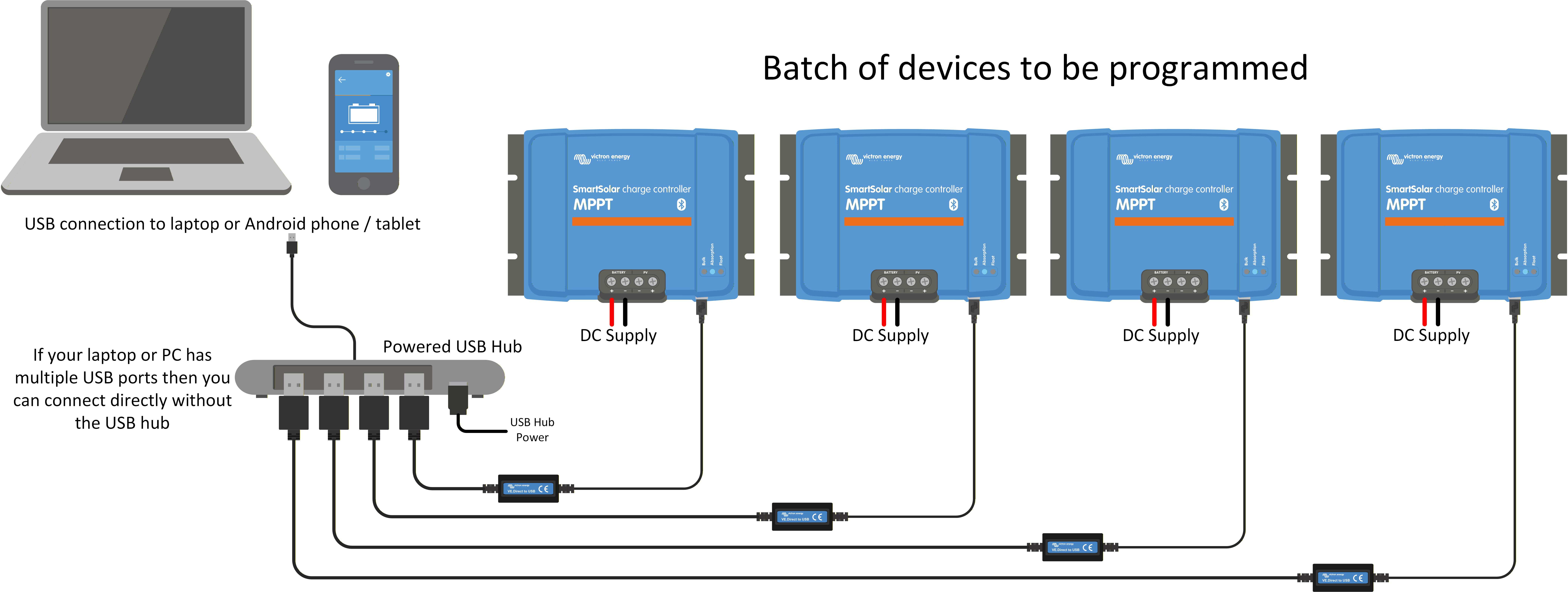

  • Wired: Use VE.Direct - USB cables and a standard USB hub to connect multiple devices to the VictronConnect instance.
    This method can be faster especially for large batches.
    A Victron VE.Direct to USB interface cable is needed per device in the batch.
  • Bluetooth: Scan the product QR code of each device and then let the VictronConnect Batch programming process the devices as a batch.

  • A VE.Direct to USB interface cable for each of the devices in the batch.
  • A USB port to connect each of the VE.Direct to USB interface cables. Use a powered USB hub when using a phone, tablet or if your computer doesn't have enough USB ports.
    Note
    Make sure the USB hub is compatible with your device and operating system.

Connect each device to a power source first.
Connect the VE.Direct to USB interface cables.

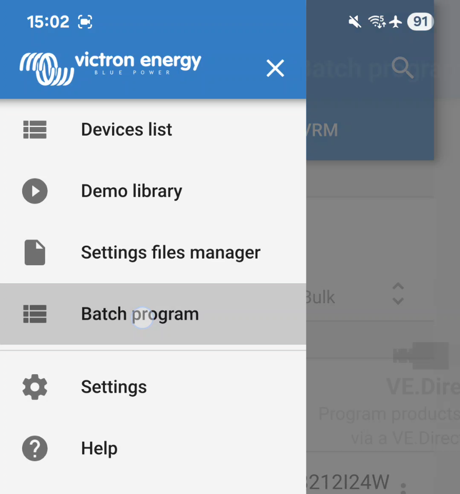

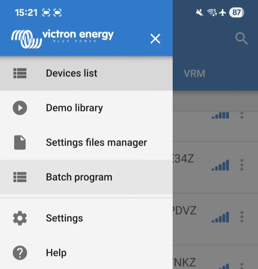

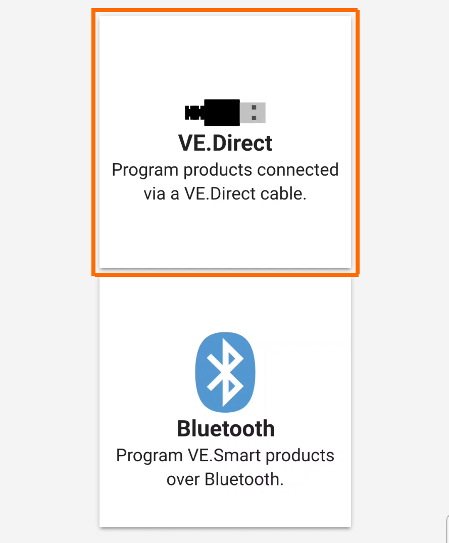

  • From the main menu, select Batch program.
  • Choose VE.Direct.

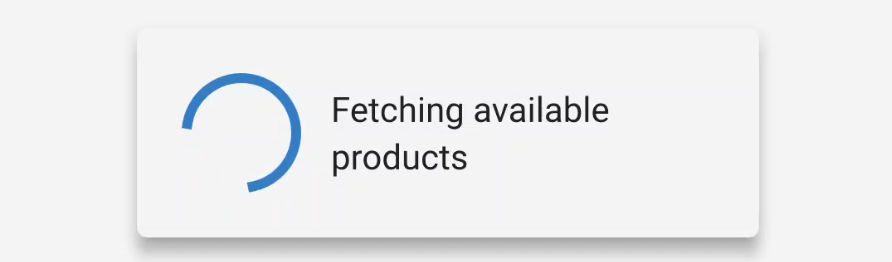

  • Allow some time for the connected products to be fetched. It may take a while depending on how many products are connected.

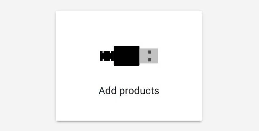

  • After all products have been fetched, tap the Add products button.

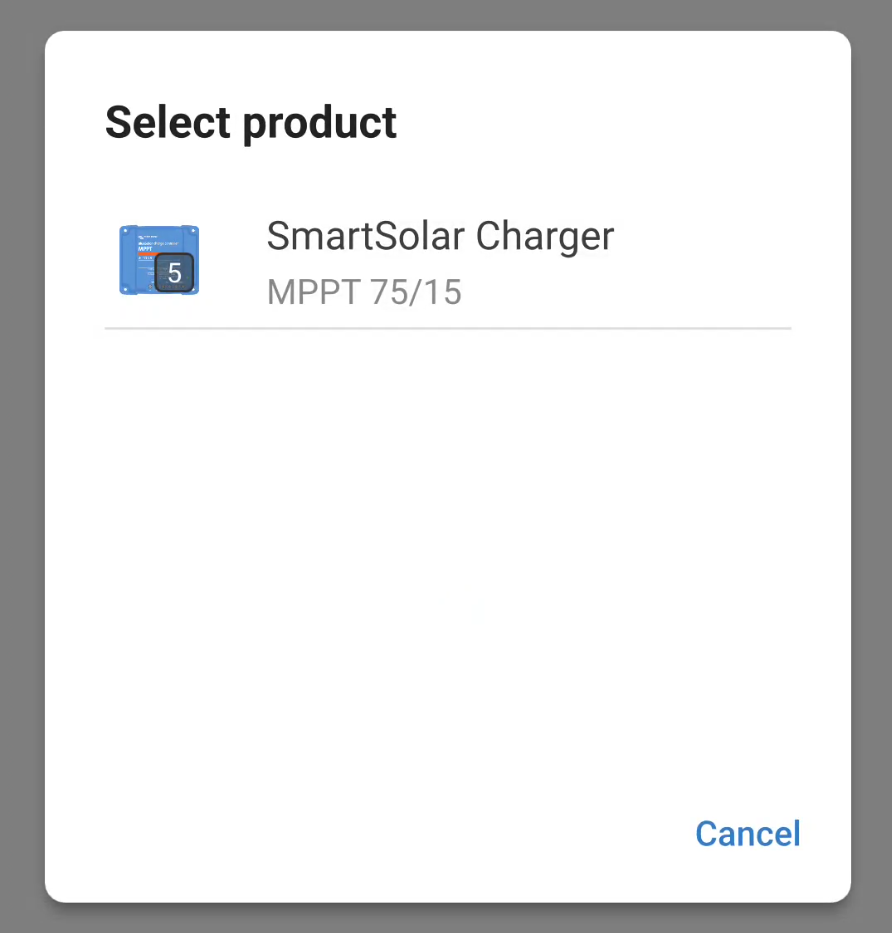

  • Products of the same model will be grouped together, along with the number of products in the group.
    Note
    You can only program one group at a time.
  • Tap the product group to proceed with programming that group.

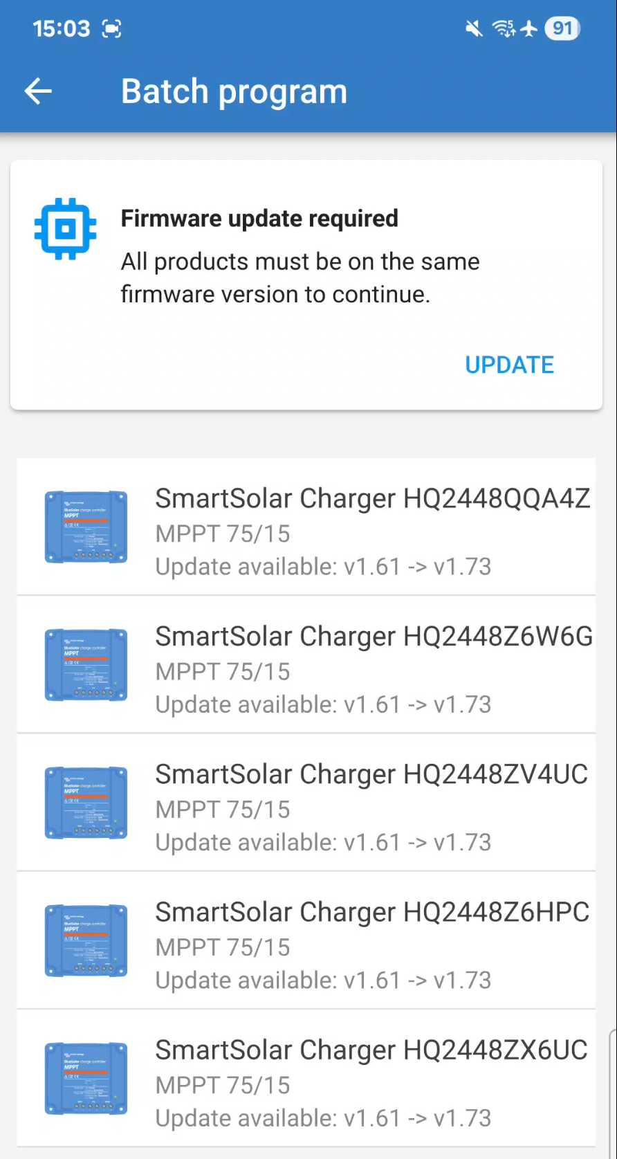

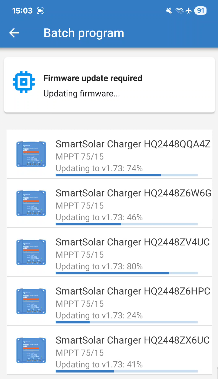

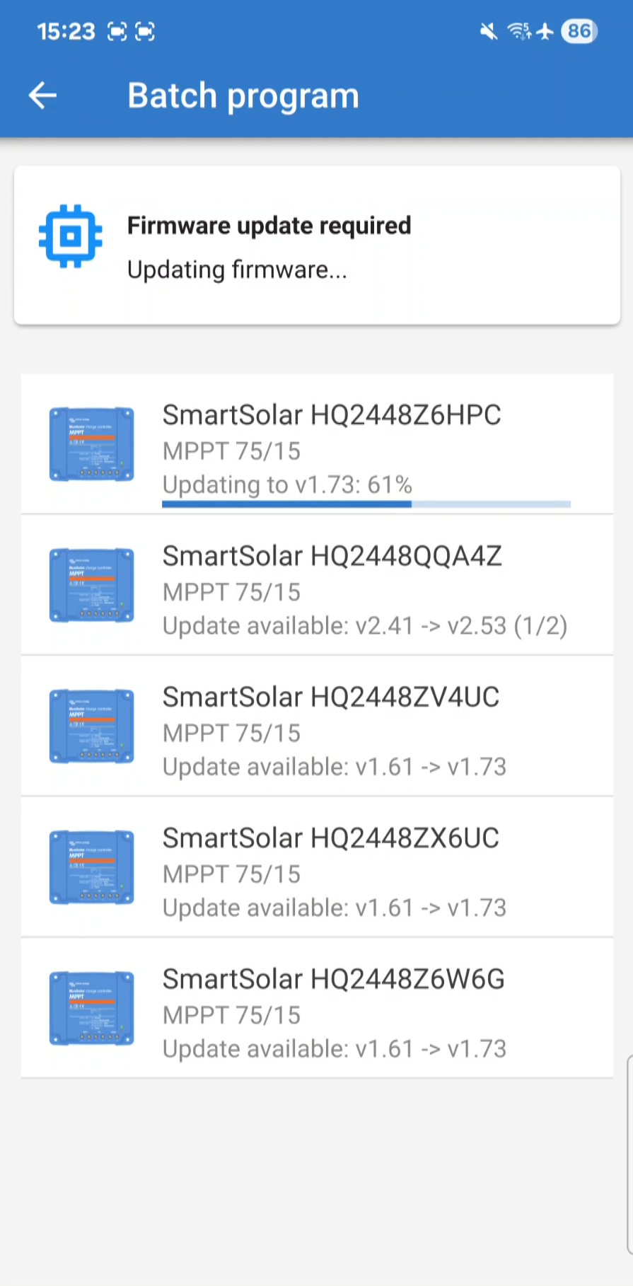

A firmware update may be required. The firmware details of each product will be shown.
The latest firmware version available for this product will be applied from the firmware library.
  • Tap the Update button to update the firmware on all devices that need it.
The firmware will be updated on all devices in parallel. You can track the progress for each device with its progress bar.

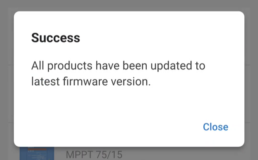

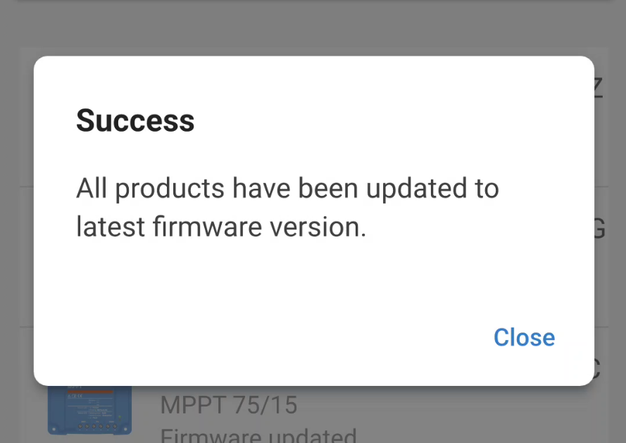

A popup box will be shown once all of the products have been updated to the latest firmware.
  • Tap Close to continue.

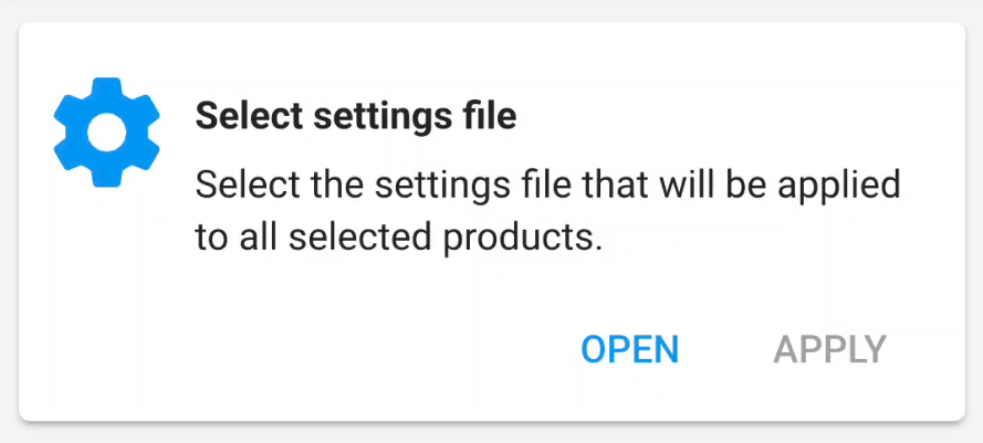

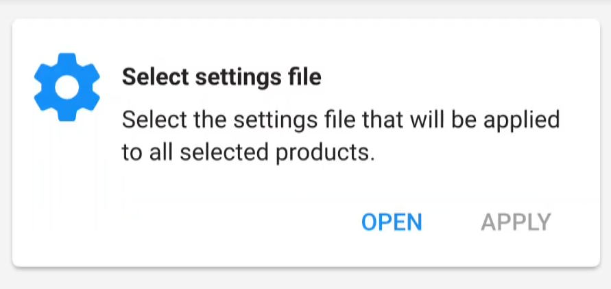

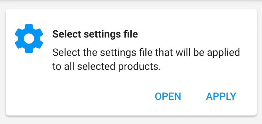

After the firmware updates are complete, you can apply a settings file to all products in the group.
  • Select Open to choose your settings file.
If you don't want to apply a settings file, you can exit the process by using the back button at the top left.

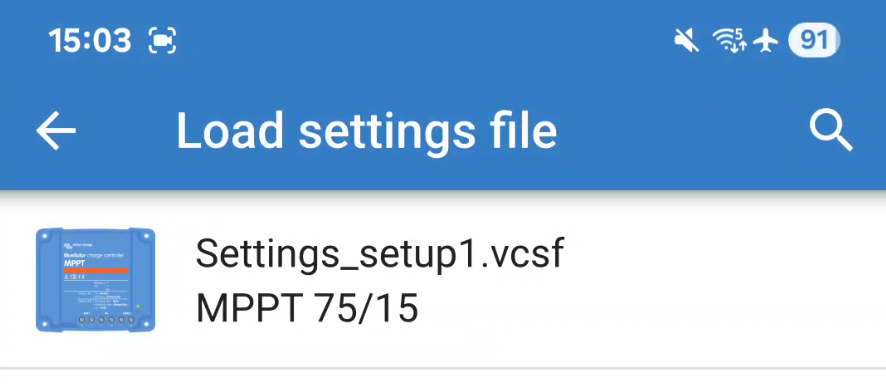

Your settings file library will open, allowing you to load a suitable settings file from the list.
  • Choose the settings file to suit the products in the group.
Note
Make sure the settings file matches the products you are applying it to.
  • Tap Apply to proceed.

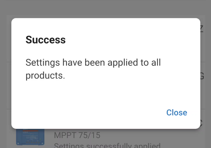

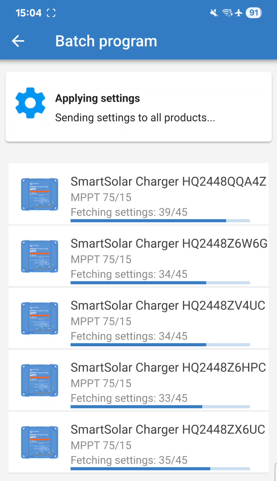

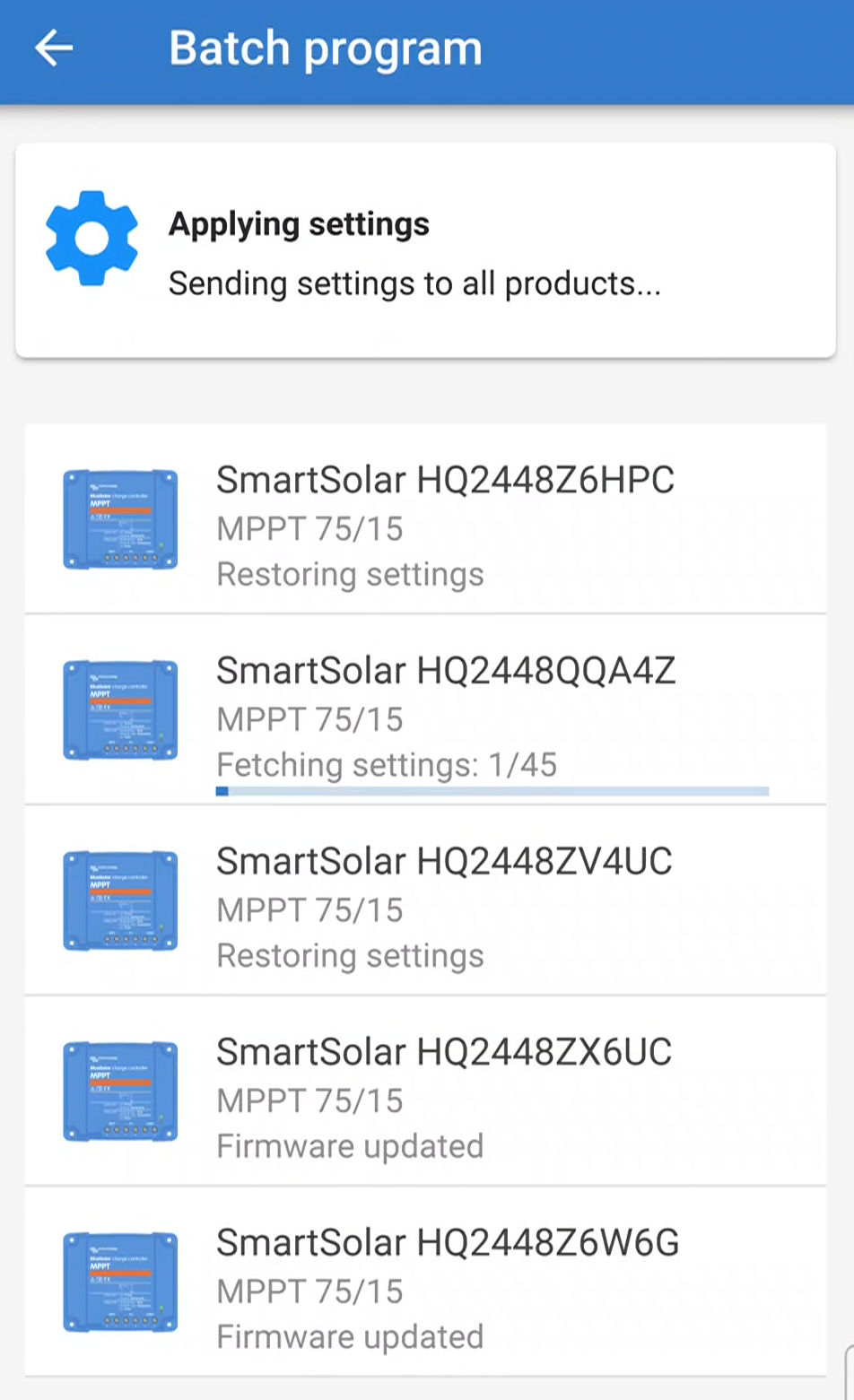

The settings file will now be sent to all products in the group at the same time. Each product has its own progress bar to show the status.
A popup will show after the settings file has been successfully applied to all products.

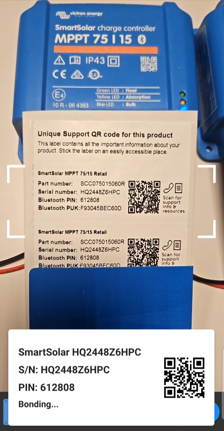

Have each QR code label ready to scan for each product in the batch. Products are added to the system by scanning each label for each product.
Warning
Keep each product label with its corresponding product. Take care not to mix up or confuse the labels.

  • From the main menu, select "Batch program".
  • Choose Bluetooth.
  • Wait for this process to complete.

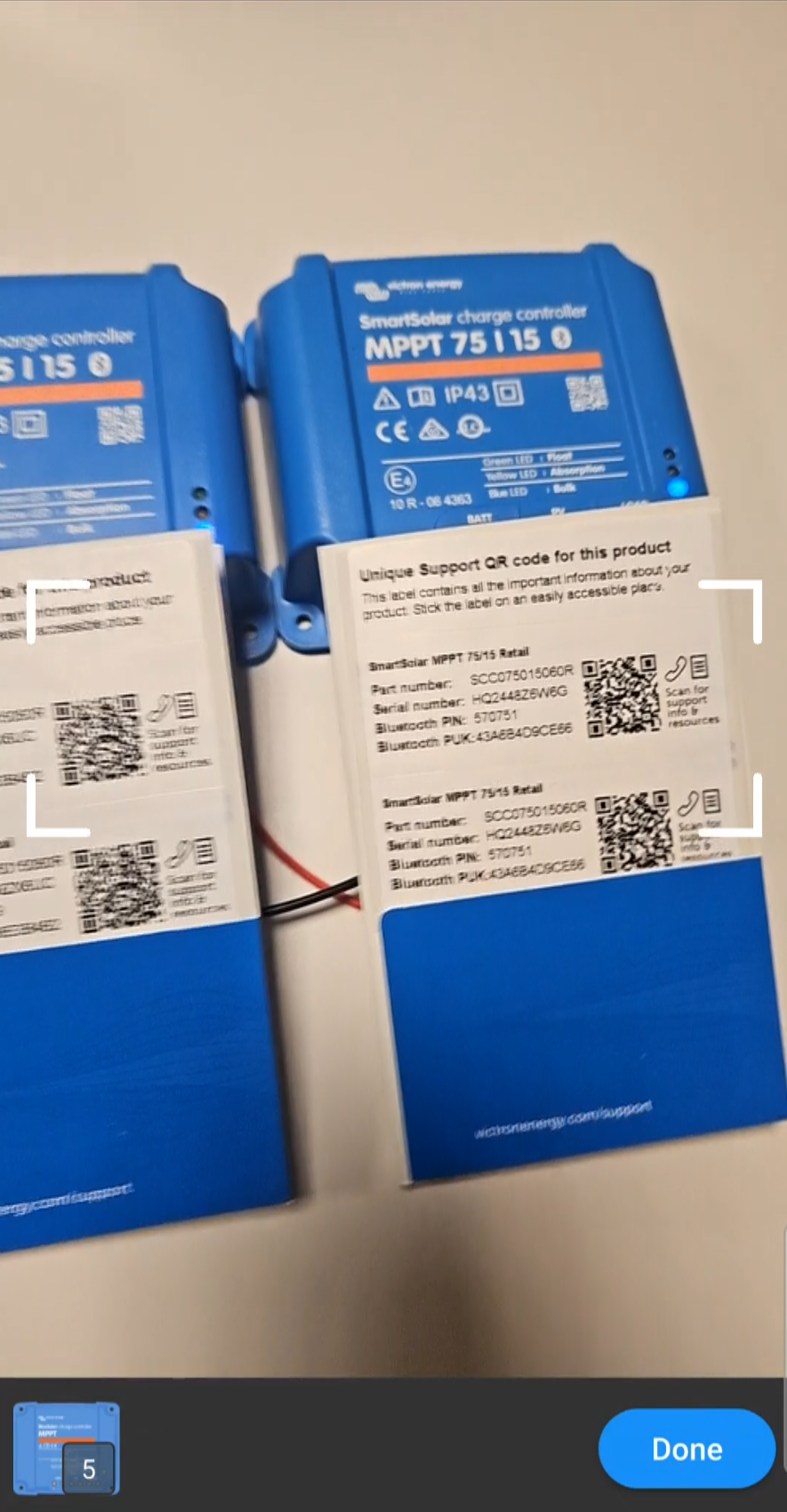

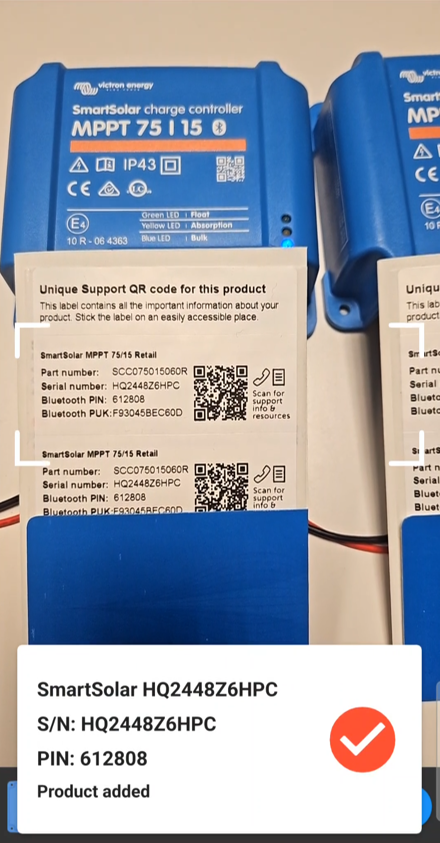

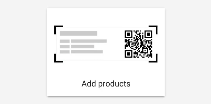

  • When all your product labels are ready to be scanned, tap "Add products".
You should expect your phone camera to open up to allow you to scan the QR codes on your product labels.
A window at the bottom of the screen replicates the details of the label as scanned.

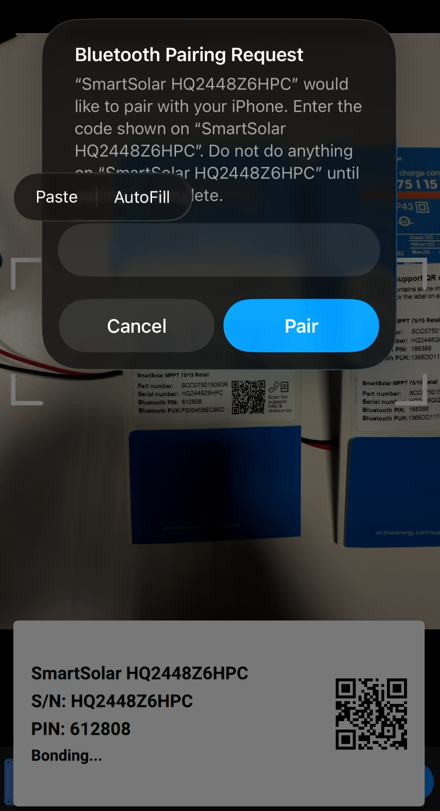

  • Wait to the bonding process to complete.
Note
This step only applies when using an iOS device!
Although the Bluetooth PIN can be read from the QR code, it cannot be applied automatically.
A pairing request will pop up where you need to enter the PIN for the product you are currently scanning.
  • Enter the PIN for the product currently being scanned and then tap the pair button.
  • Wait for the bonding process to complete.
Tip
Upon scanning, the PIN is copied to your clipboard. Paste it into the pairing box.
A tick will appear once the product has been successfully added.
  • Now scan the next product label.
  • Repeat the scanning process for the rest of the labels.
Note
Do not tap the Done button until you have scanned all the labels.
  • Tap the "Done" button after you have scanned the final label.

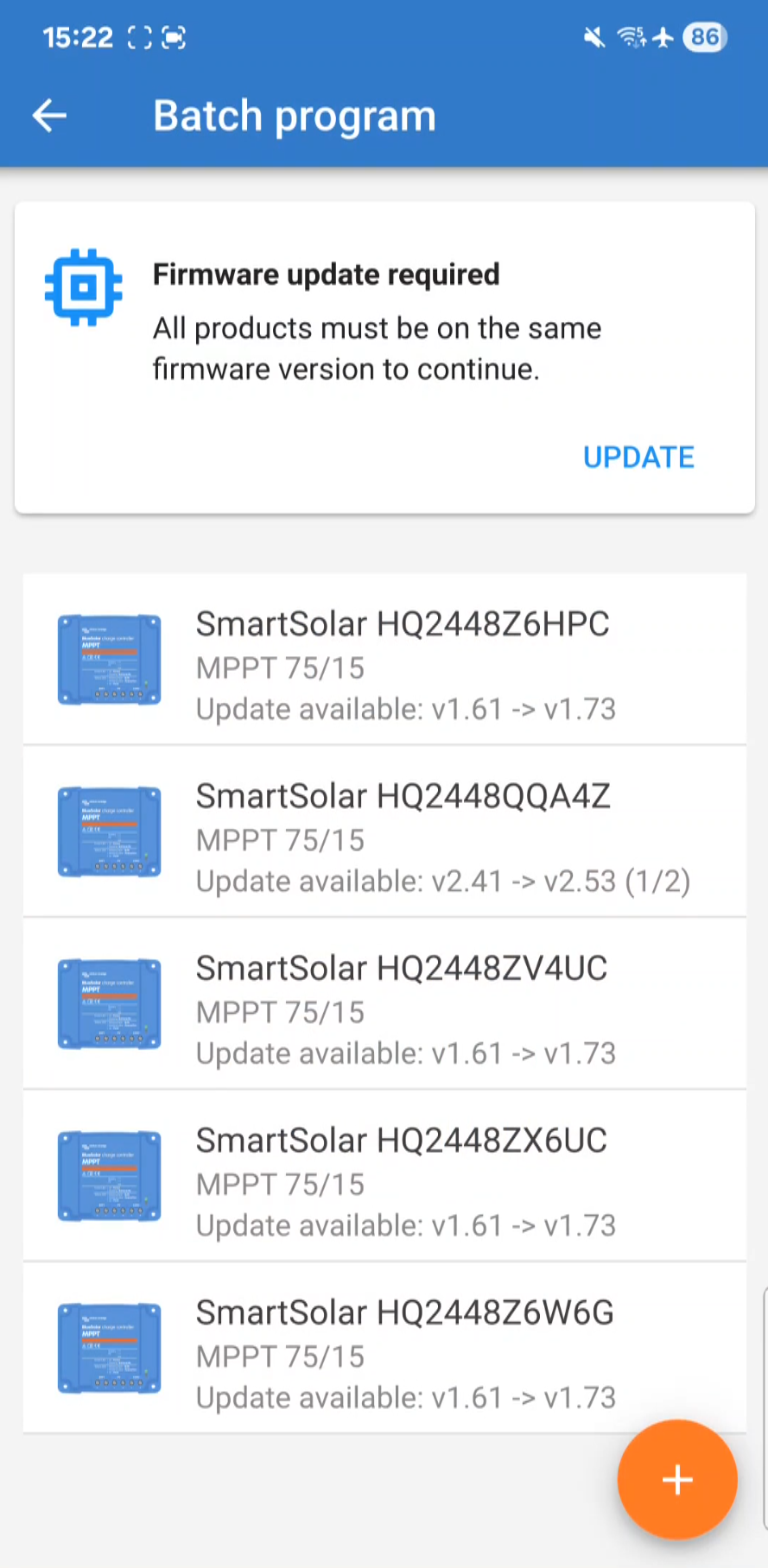

All of the scanned products will be listed.
Tip
To add more products, tap the orange + button in the bottom-right corner to scan additional QR codes.
  • Tap the "Update" button to update the firmware on all devices that need it.
  • The firmware will be updated on each device one at a time. You can track the progress for each device with its progress bar.
  • Wait for the firmware update process to complete.
Note
Some products may have two firmware updates, one is for the main CPU and one for the Bluetooth CPU.
  • Select "Open" to choose your settings file.
Note
  • After choosing your settings file, tap "Apply" to program it to the batch.
  • The settings file will now be sent to all products in the group at the same time. Each product has its own progress bar to show the status.
  • A popup will show after the settings file has been successfully applied to all products.
