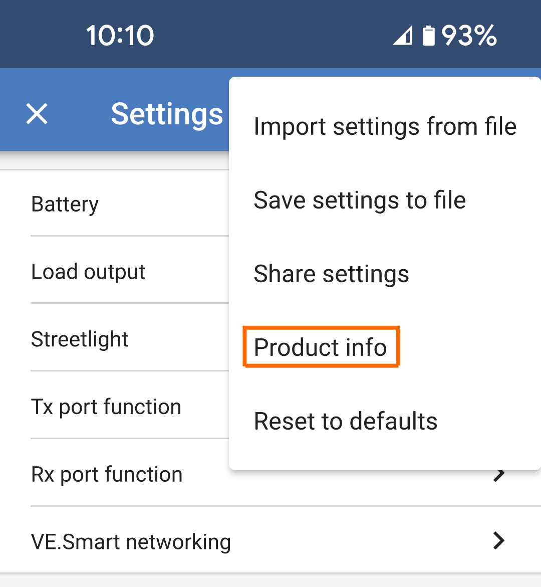

Now go to the product info page:
NoteIn this example, the firmware is up-to-date. If the firmware is not currently up-to-date, then you might just see an UPDATE button instead. |
NoteThe file list will only display firmware files which match the product you are connected to. |
The Firmware update page shows the current firmware version and the new version to be installed.
