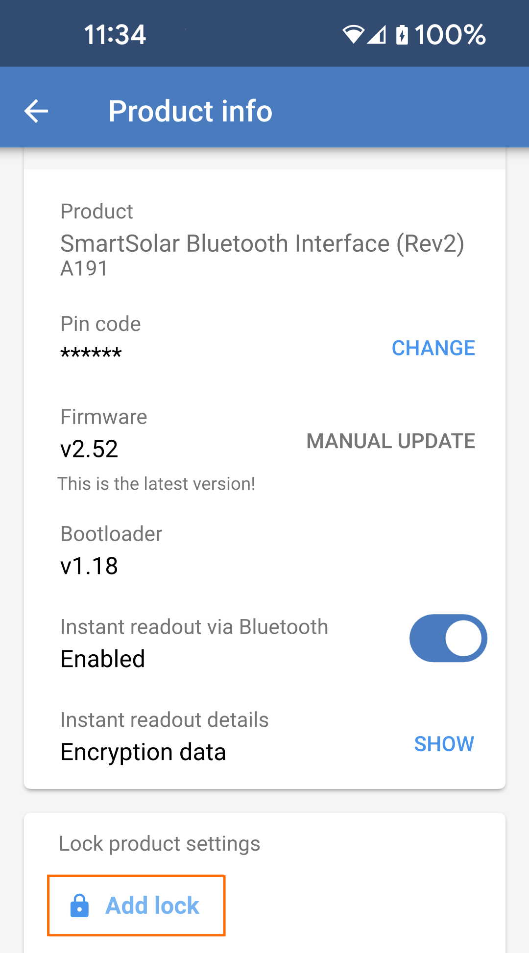

The product lock feature can be found on the "Product info" page.
  • Scroll to the bottom of the page.
  • Tap "Add lock".

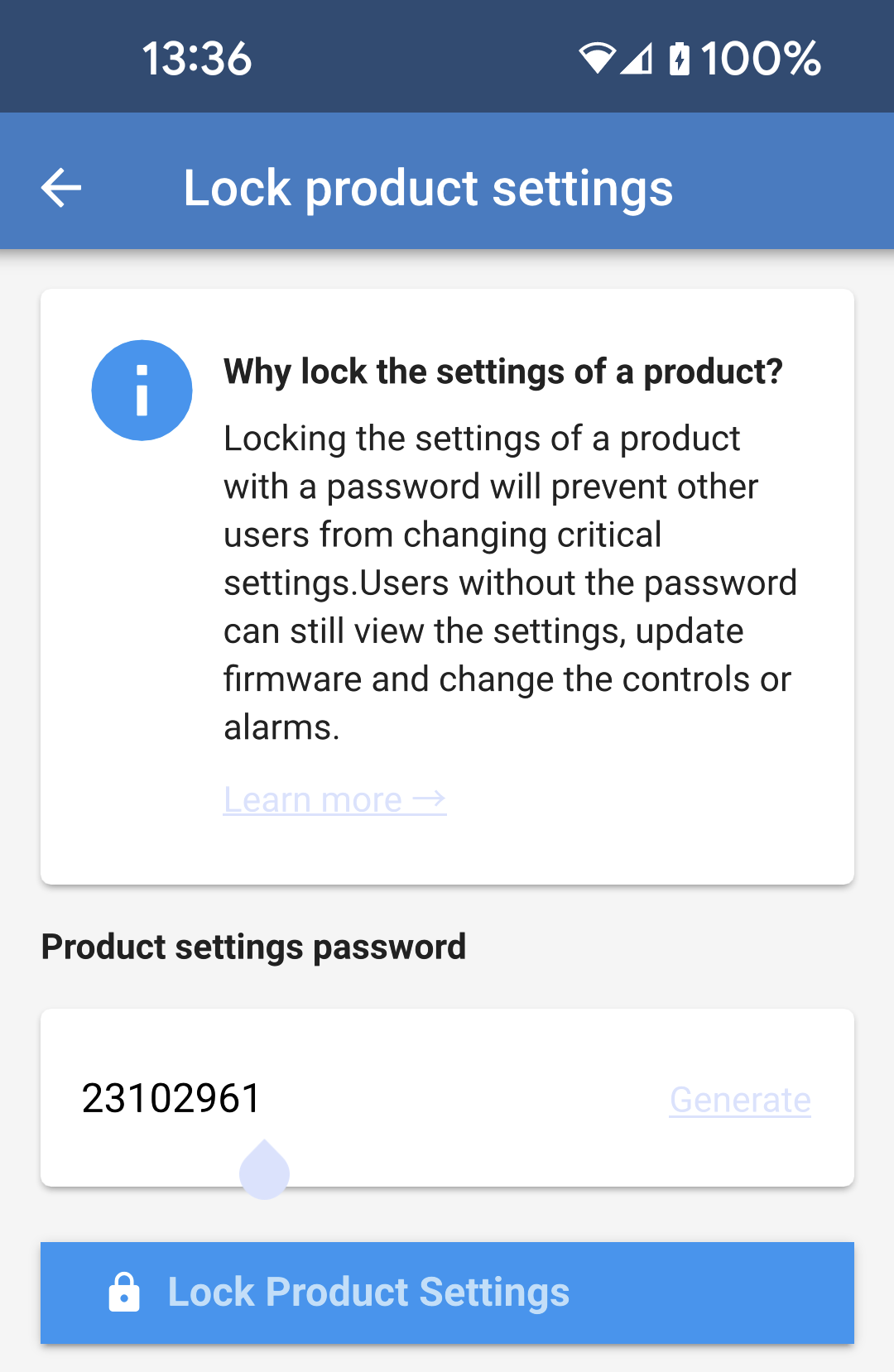

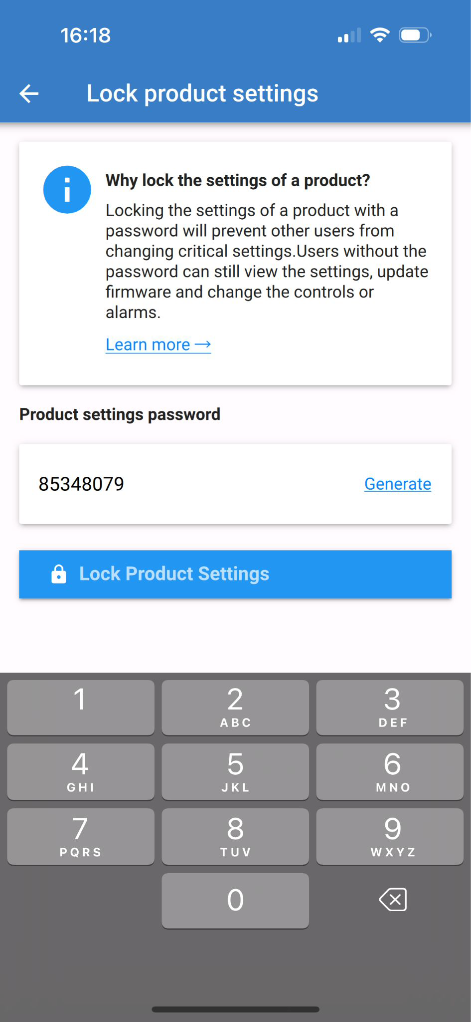

Choose a settings lock password.
  • Type in a password of at least 8 numbers.
If you tap the "Generate" button, a random password will be created.
Tip
Touch and hold the password if you want to copy it for use on other products in the system.
Note
Don't use the same password across different installations.

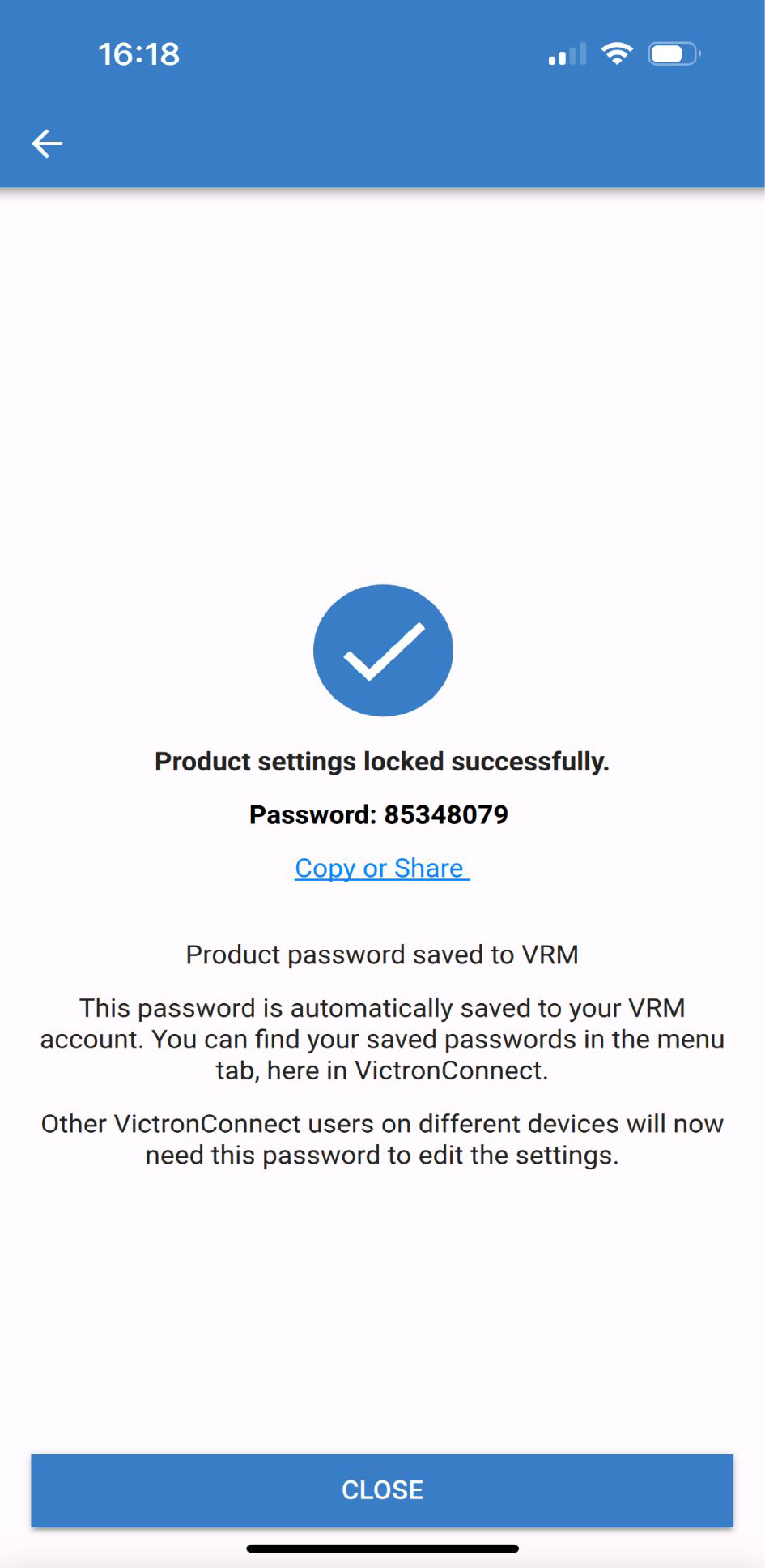

The password is automatically stored on the phone and in your VRM user account, so there's no need to worry about losing the phone or tablet.

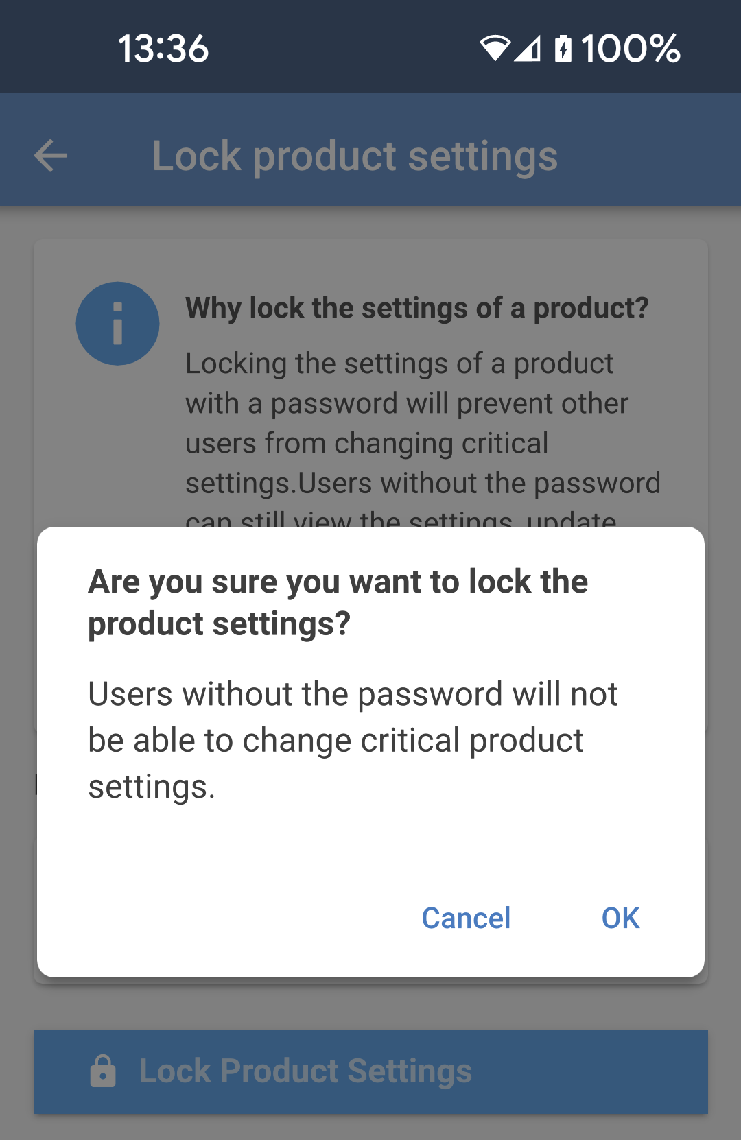

  • Tap the Lock Product Settings button to proceed.
  • Choose OK on the confirmation popup.
Now the product lock has been applied.
The password is shown for you to make a note of it.
  • Tap "Copy or Share" just below the password to email it to someone, for example.
  • The Close button will take you back to the Product info page.

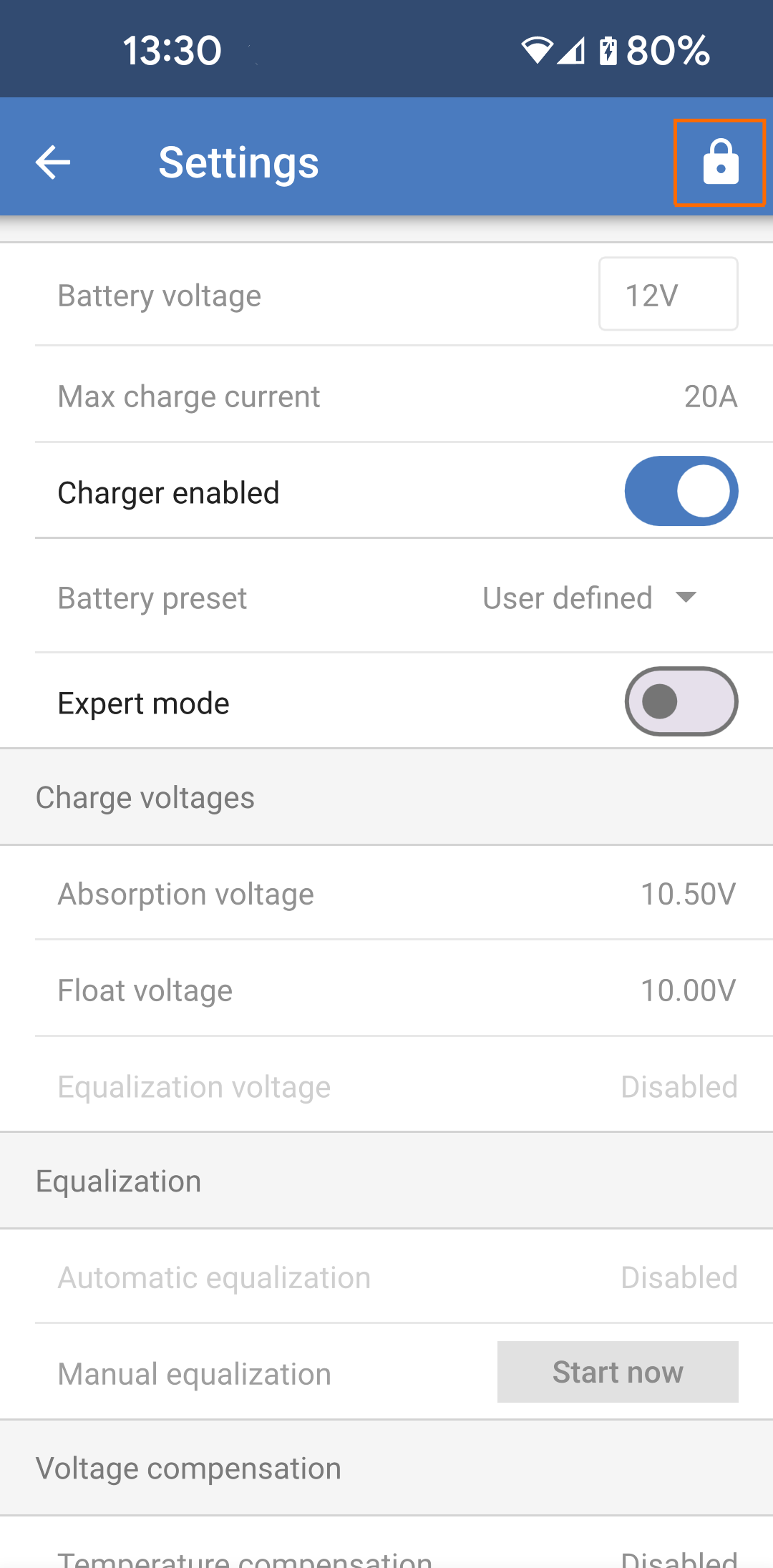

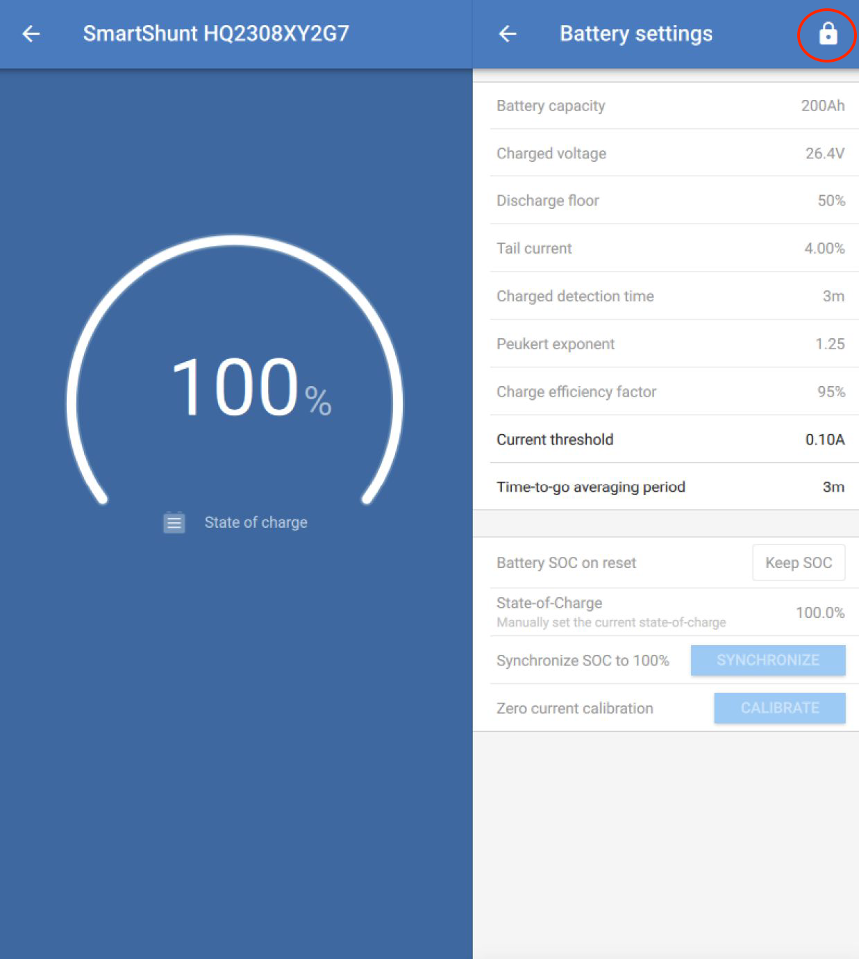

A lock icon in the top right of any settings page indicates that some settings are locked and cannot be changed.
The greyed-out settings are locked and cannot be changed.

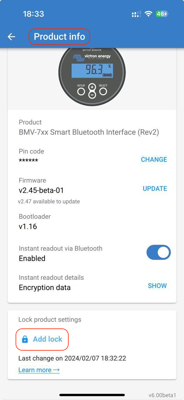

Step 1 - Go to the lock feature
  • Go to the 'Product info' tab of the Victron product
  • Click on 'Add lock' to start setting the product settings lock
Step 2 - Choose the password
When you click 'Generate', VictronConnect will suggest a random password. Alternatively, you can enter your own code.
Tips:
  • You can use the copy button to copy the password and use it for other Victron products in the same system that you might want to lock with the same password.
  • Do not use the same password for all installations.
  • The password is automatically stored on the phone and in your VRM user account, so there is no need to worry about losing the phone or tablet.

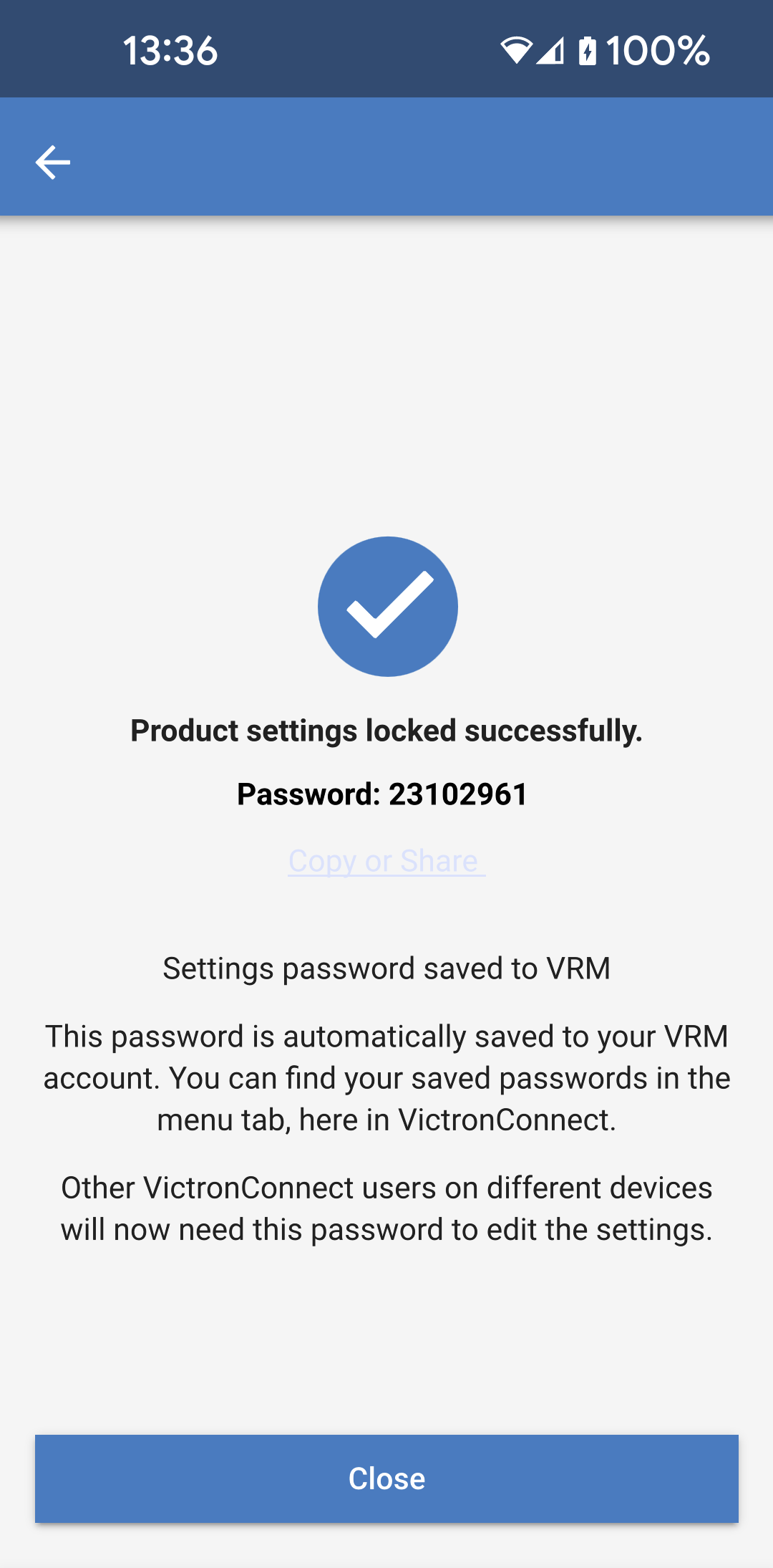

Step 3 - Confirmation screen
  • The product's settings are now locked for other users
  • Clicking on 'Close' takes you back to the product

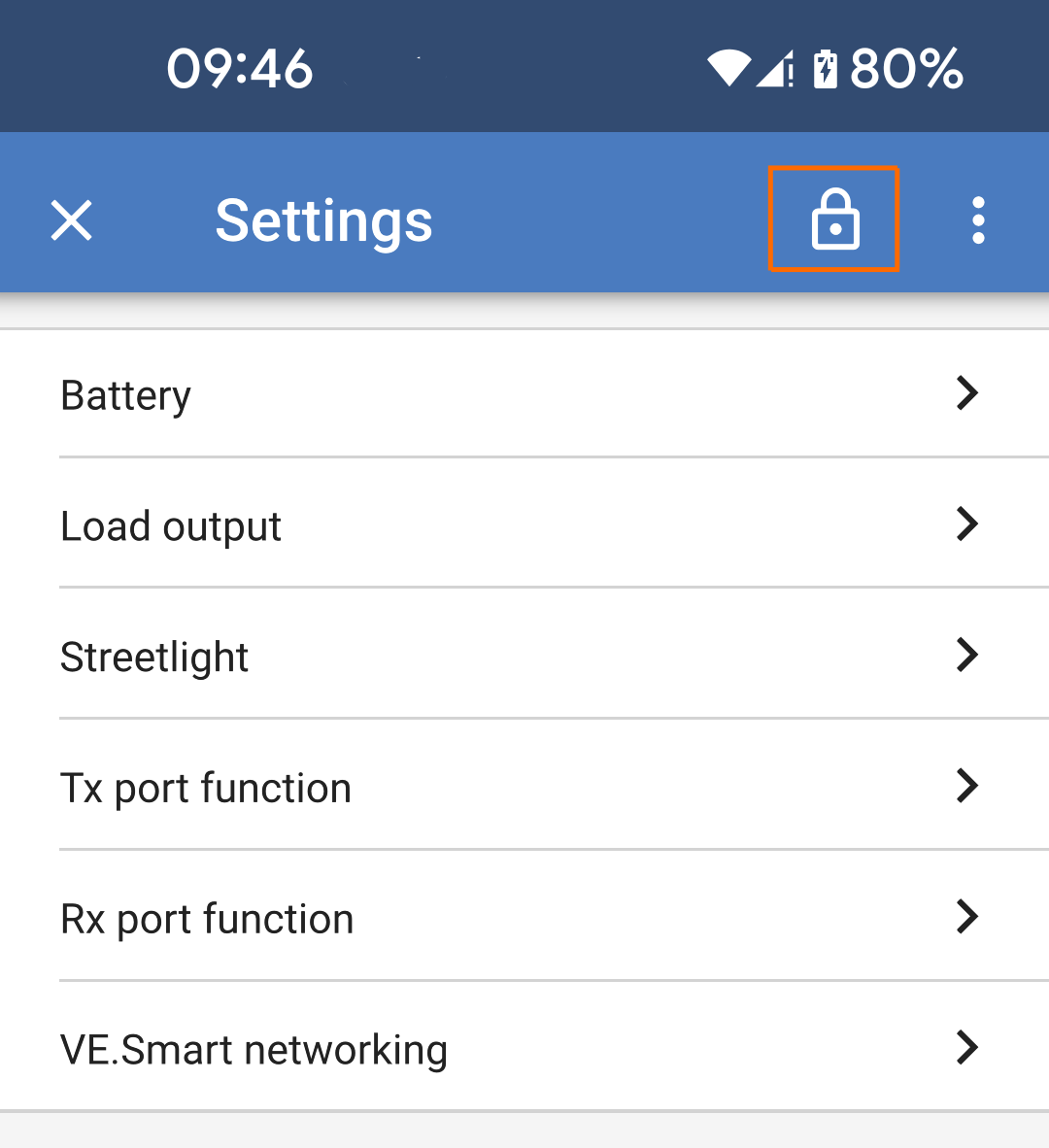

  • Now that the product settings are locked, a lock icon is presented in the top-right corner of the product settings screen.
  • Press the lock icon to enter the password and unlock the settings. For more information, see the next section.
  • Settings are not editable as long as the product settings are locked.
  • Some settings will remain editable by the user. This applies to mostly harmless settings and/or relate to user preference.

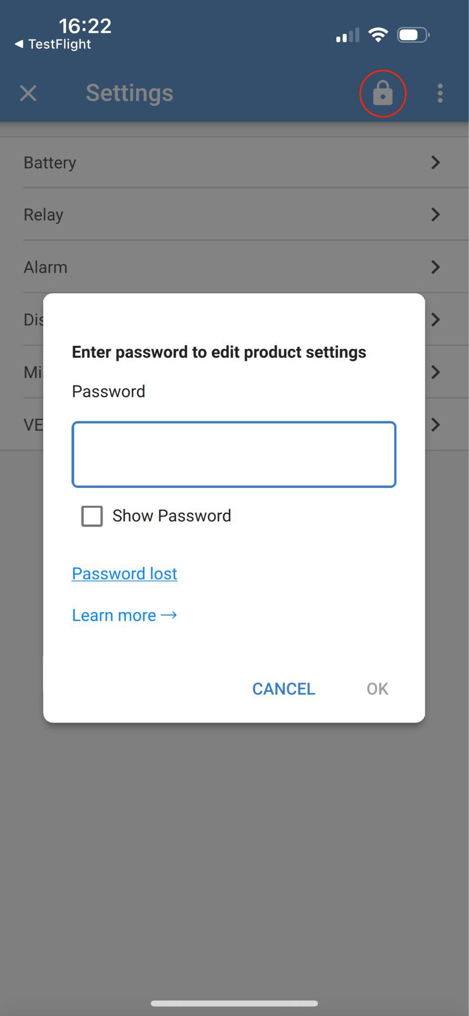

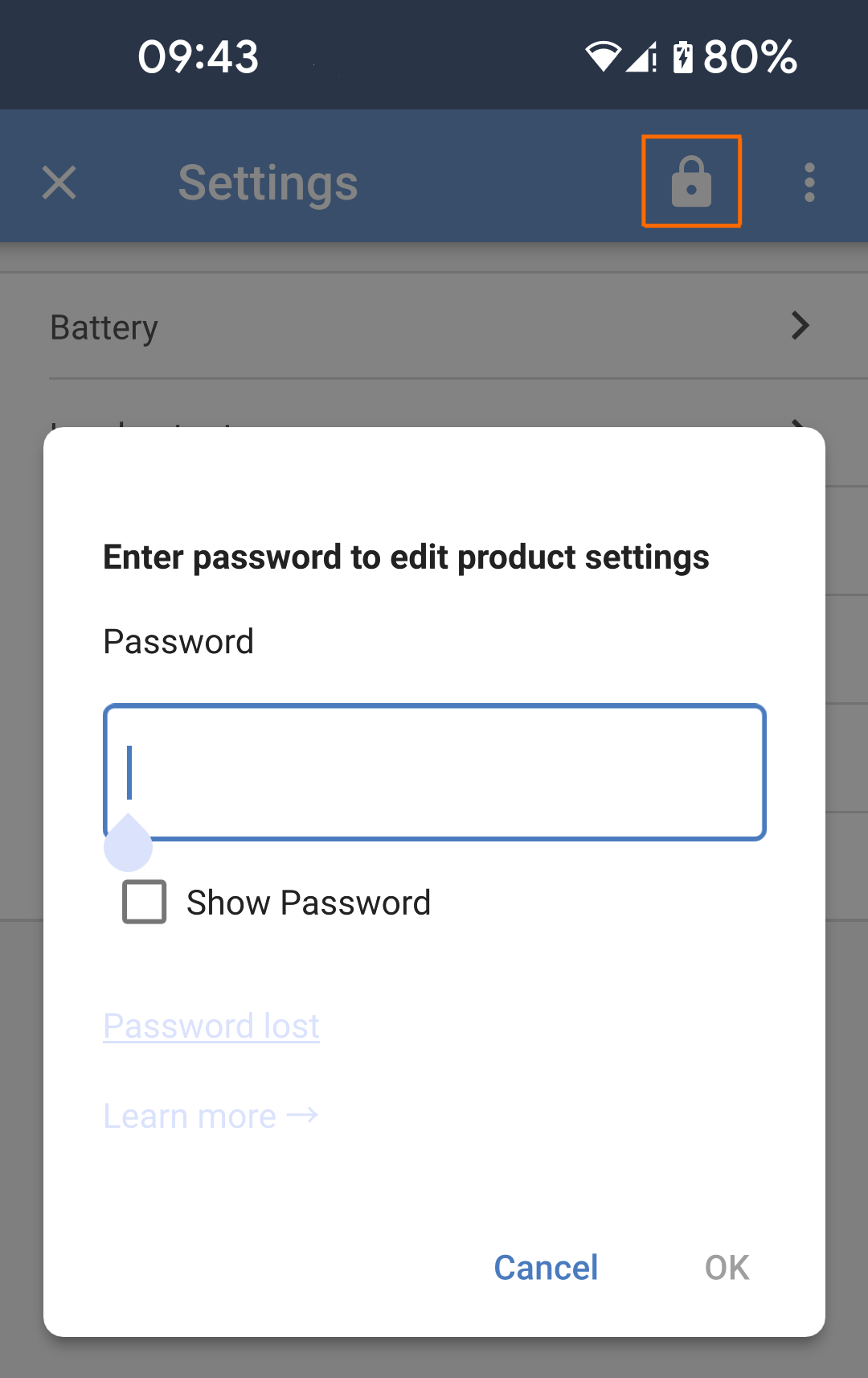

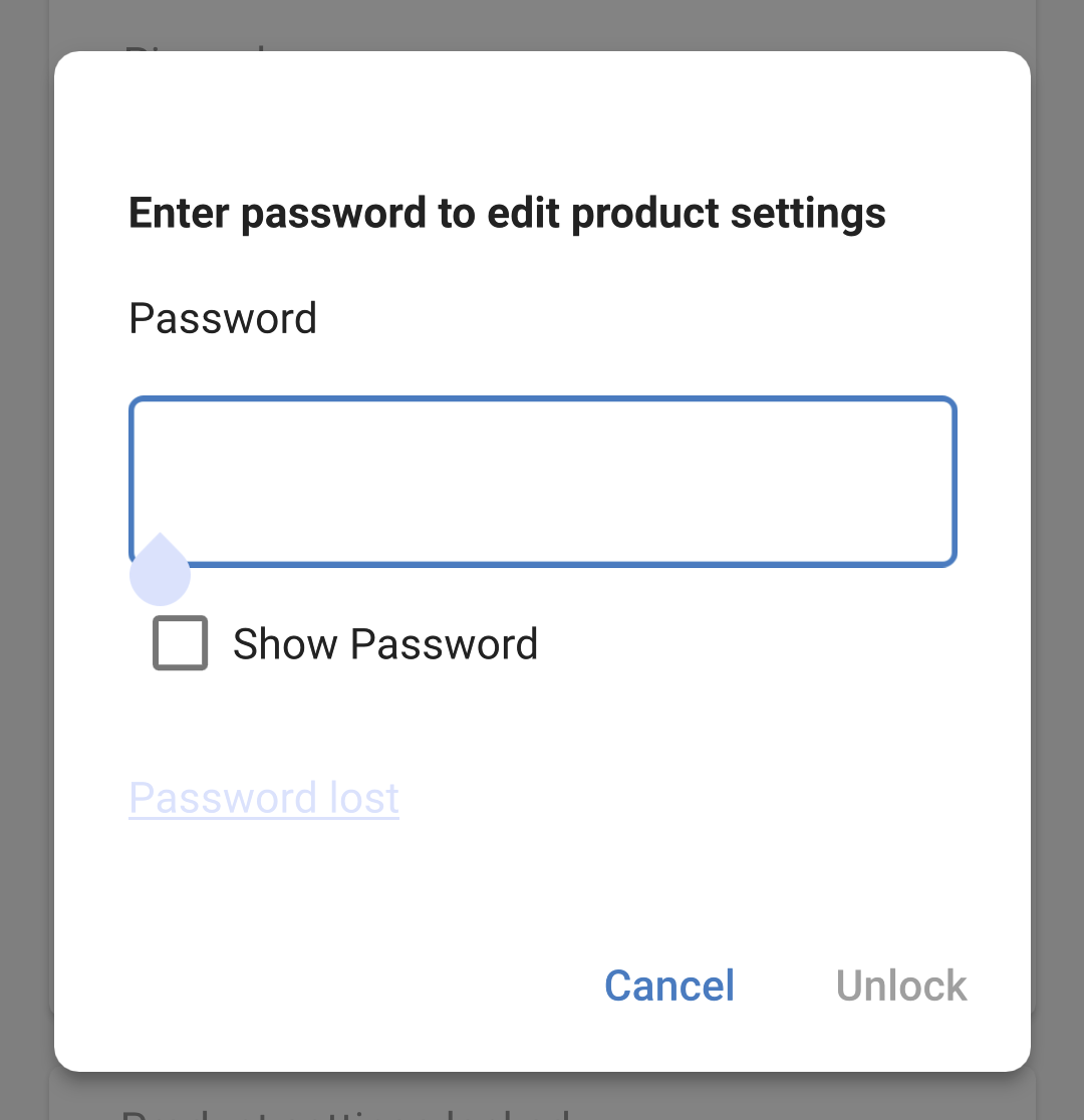

When attempting to access all settings on a locked product, you'll see a locked icon in the top right of the settings pages.
  • Tap the lock icon.
  • Type the password in the popup box.

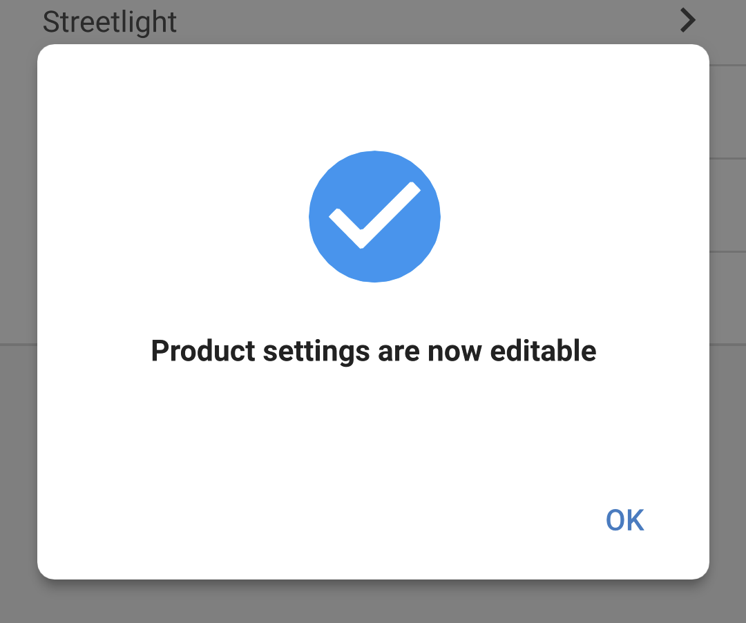

A pop will confirm that the settings can now be edited.
  • Tap OK to proceed.

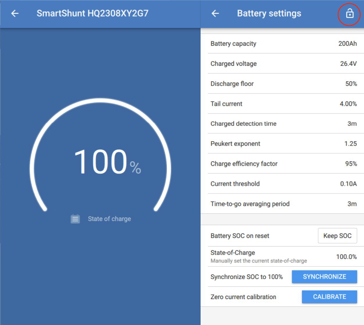

The lock icon is now unlocked, indicating that the settings can be changed.
Step 1 - Obtaining access
  • After connecting to a locked product, there is the lock icon on the upper right. Click that icon to unlock.
  • Enter the 8-digit password to unlock the settings.
  • Clicking on the 'Password lost' link will start the password loss process. VictronConnect first prompts the user to contact the installer. Upon further clicking, the user can remove the password by entering the PUK code or connecting via a VE.Direct cable.
  • The 'Lean More' link opens this section in the VictronConnect manual.
Step 2 - Access granted
  • The lock icon is now open, indicating the settings can be edited.

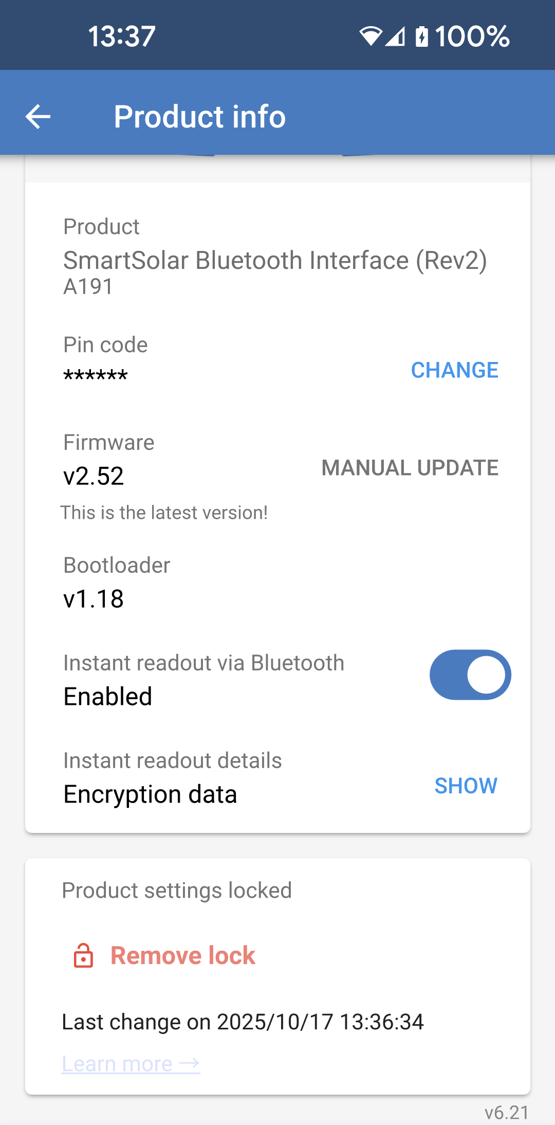

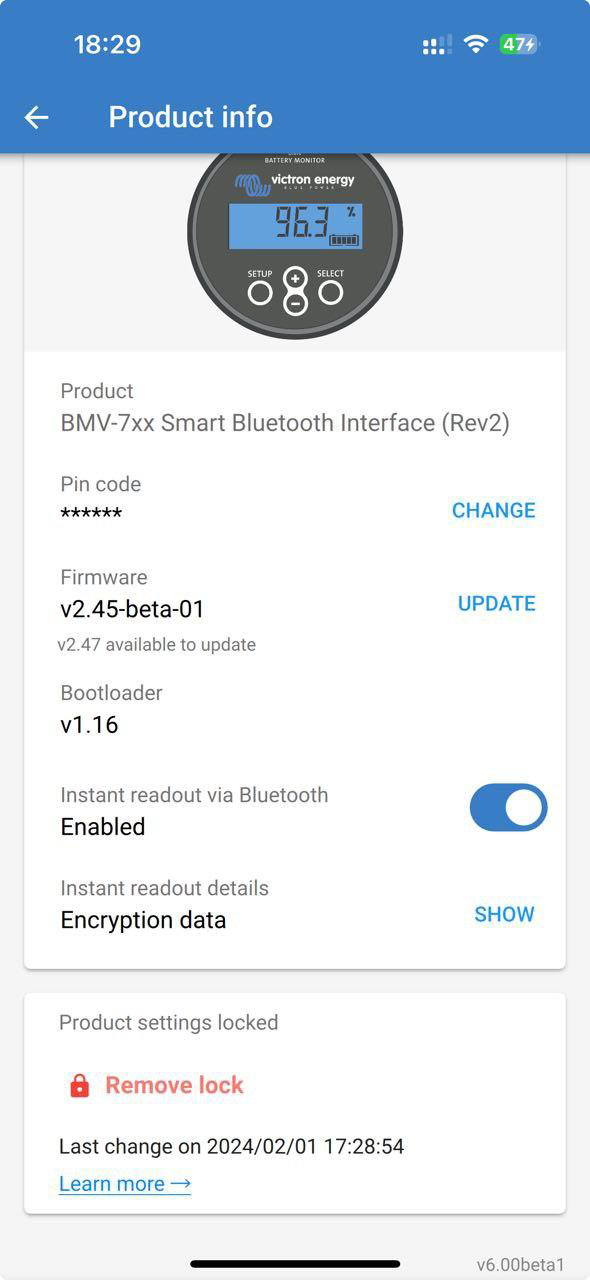

The settings lock can be removed from the product from the product info page.
  • Tap "Remove lock".

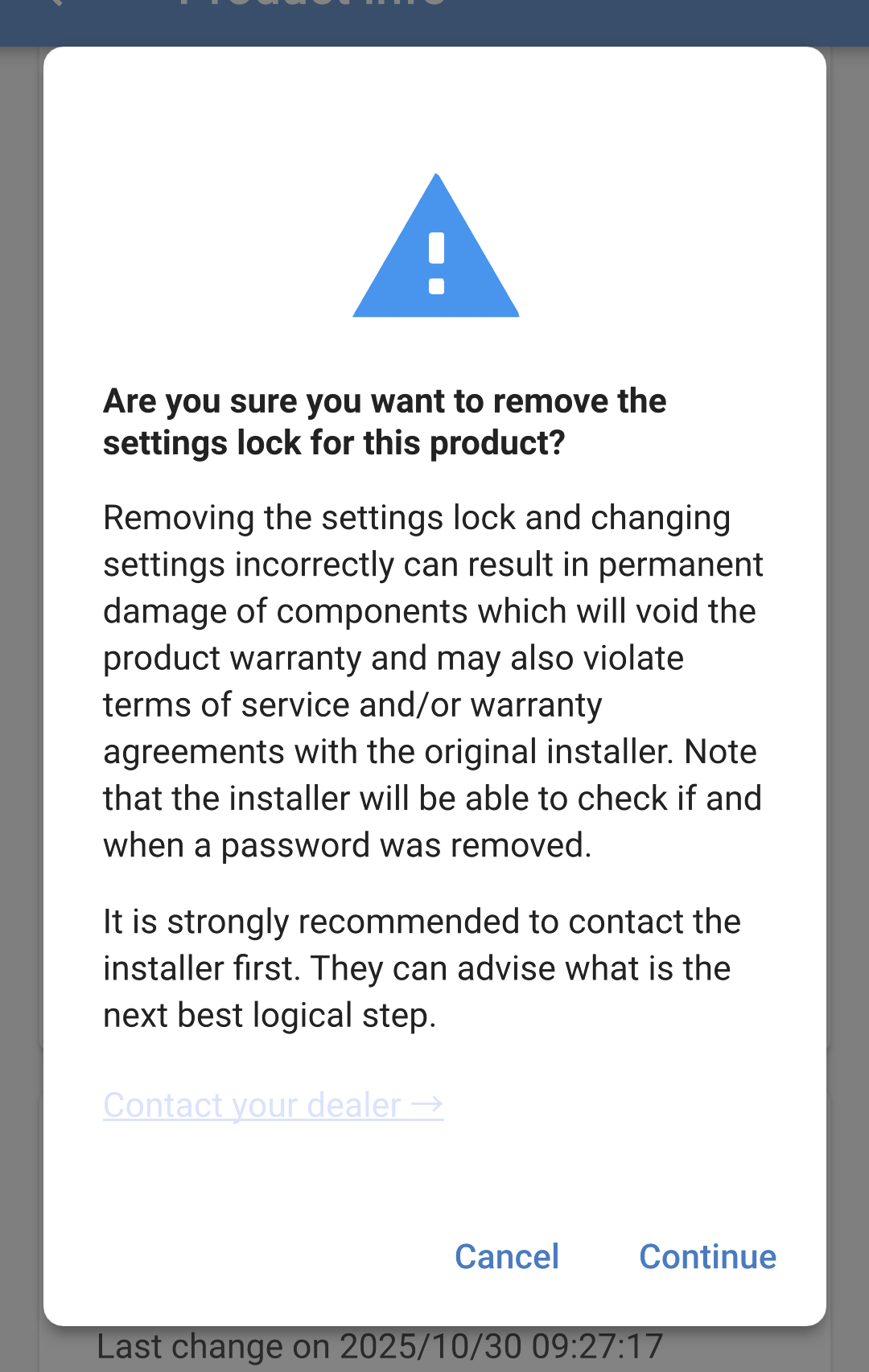

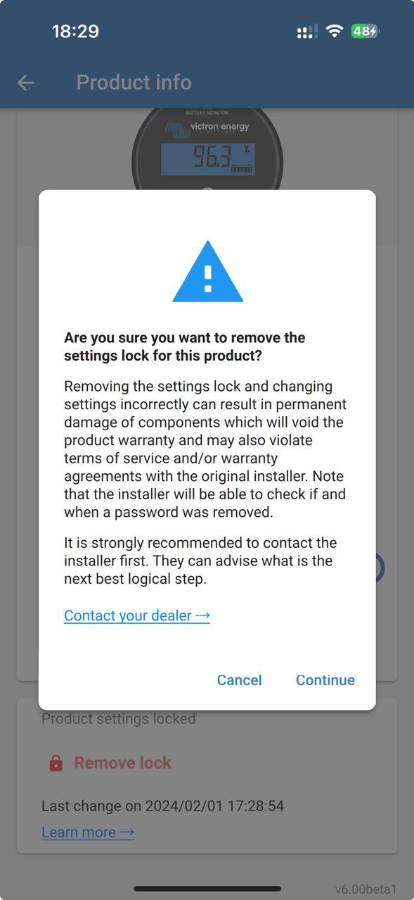

A warning message will pop up with reasons not to remove the settings lock and advice to contact the installer first.
There is a link at the bottom of the popup providing steps to contact your installer.
  • Tap "Continue" to proceed.
  • Type the password in the popup box, and tap "Unlock".

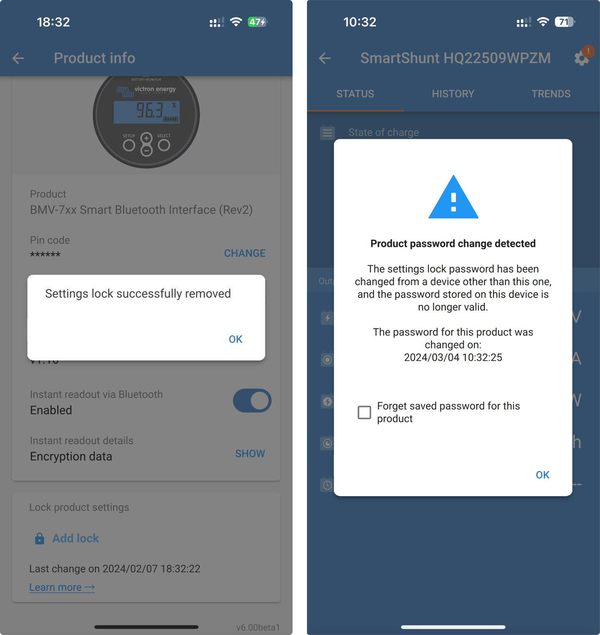

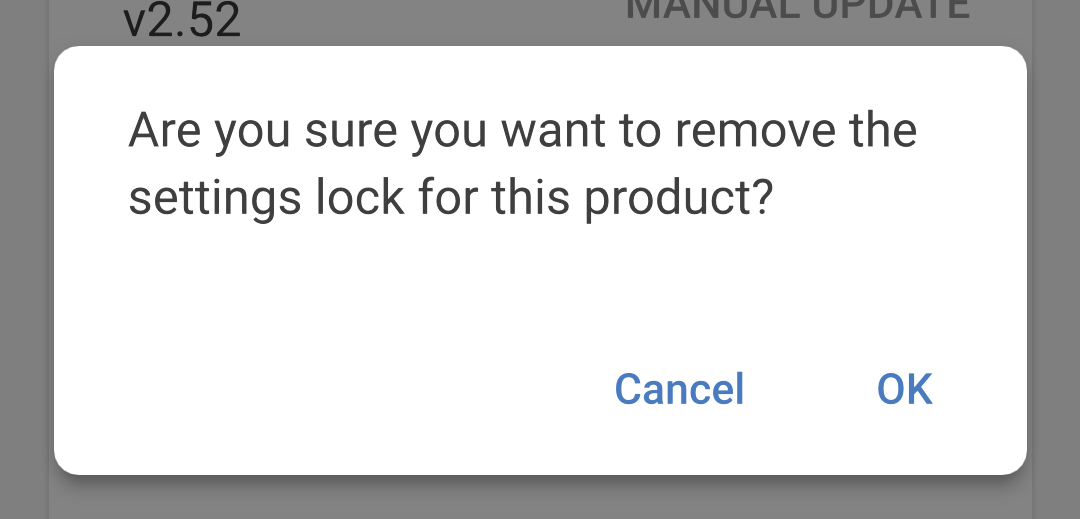

  • Select "OK" in the next popup confirmation box.

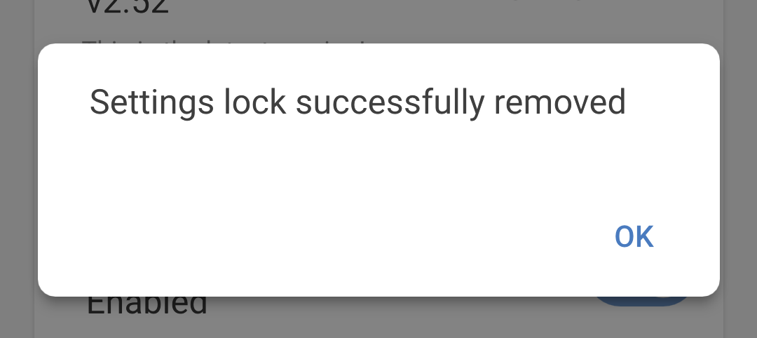

Now the settings lock has been removed.
  • Select "OK" in the popup box.
The next time the installer reconnects to the product, they'll receive a notification that the product lock status has been changed.
The popup warns the installer that the settings lock status has changed along with a timestamp.
  • Tick the checkbox to forget the saved password for this product.
  • Tap "OK" to clear the warning popup.

Step 2 - Acknowledge the warning
  • The user first sees a warning explaining why they should contact the system installer and not remove the lock.
  • The warning also states that removing the lock will be noticed by the installer, like removing a tamper seal.
  • Find the contact details of your dealer via your product serial number on the Victron Support web pages by clicking on the 'Contact your dealer' link.
  • Click on 'Continue' to continue the lock removal process.

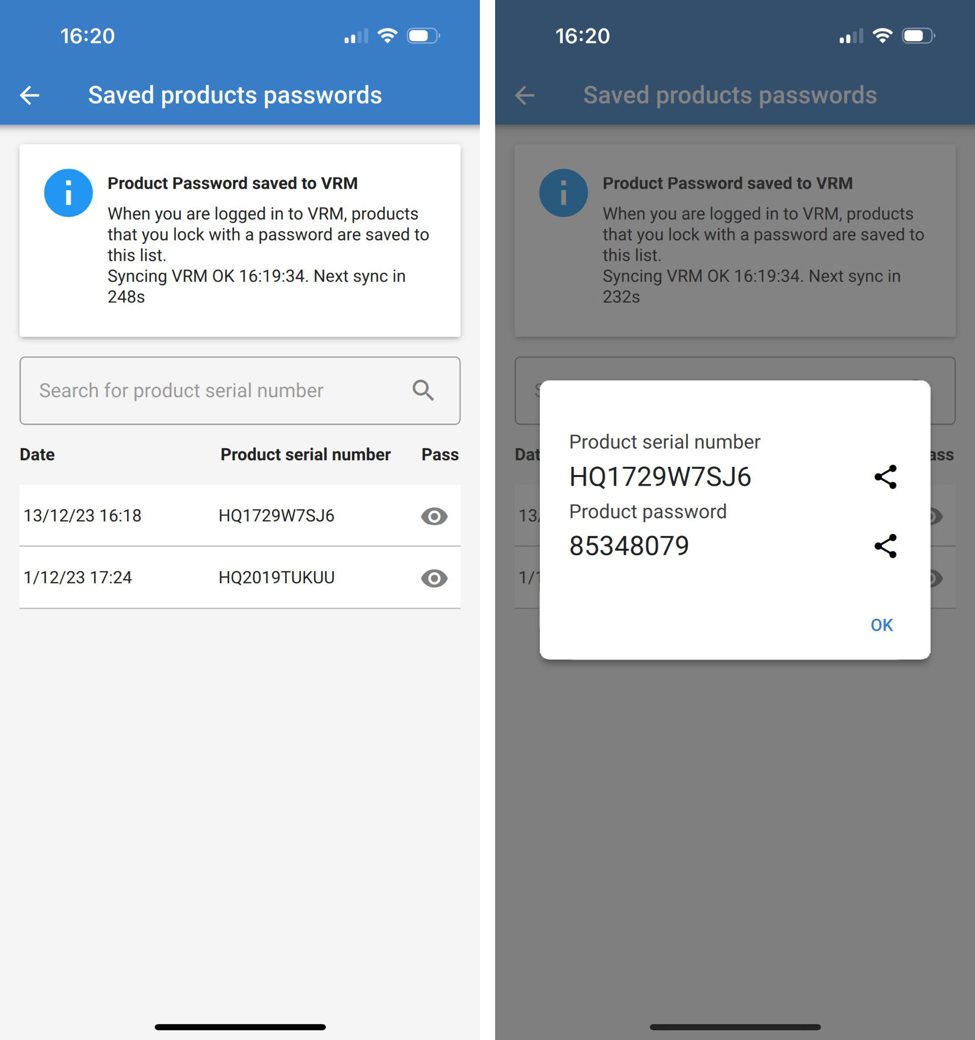

12.4.5. Built-in password manager
In the main VictronConnect menu, there is a new entry called 'Saved product passwords'.
It shows all serial number/password combinations stored on the phone.
When VictronConnect is logged into VRM, then these are automatically backed up to the VRM user account and synchronised with your other phones or tablets in case logged into the same VRM user account.
Not connected to the internet while setting up a system? No problem - VictronConnect automatically stores them in the background and will regularly check if there is a connection. The sync status is displayed at the top of the page.
View or search all saved passwords for your VRM account in one list.
Easily see and copy the product password to send to colleagues or end-users. Only visible when logged into the installing VRM account.
