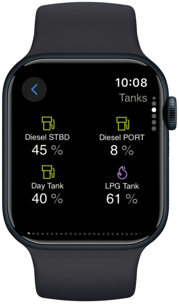

  • Tank Levels: Monitor fuel, water, LPG

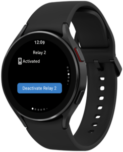

  • Relay Switching: Toggle relays

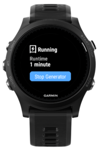

  • Generator Control: Start/stop generator

Q: Can I control my system from the watch?
A: Yes. Relay, EV, and generator controls are supported.
