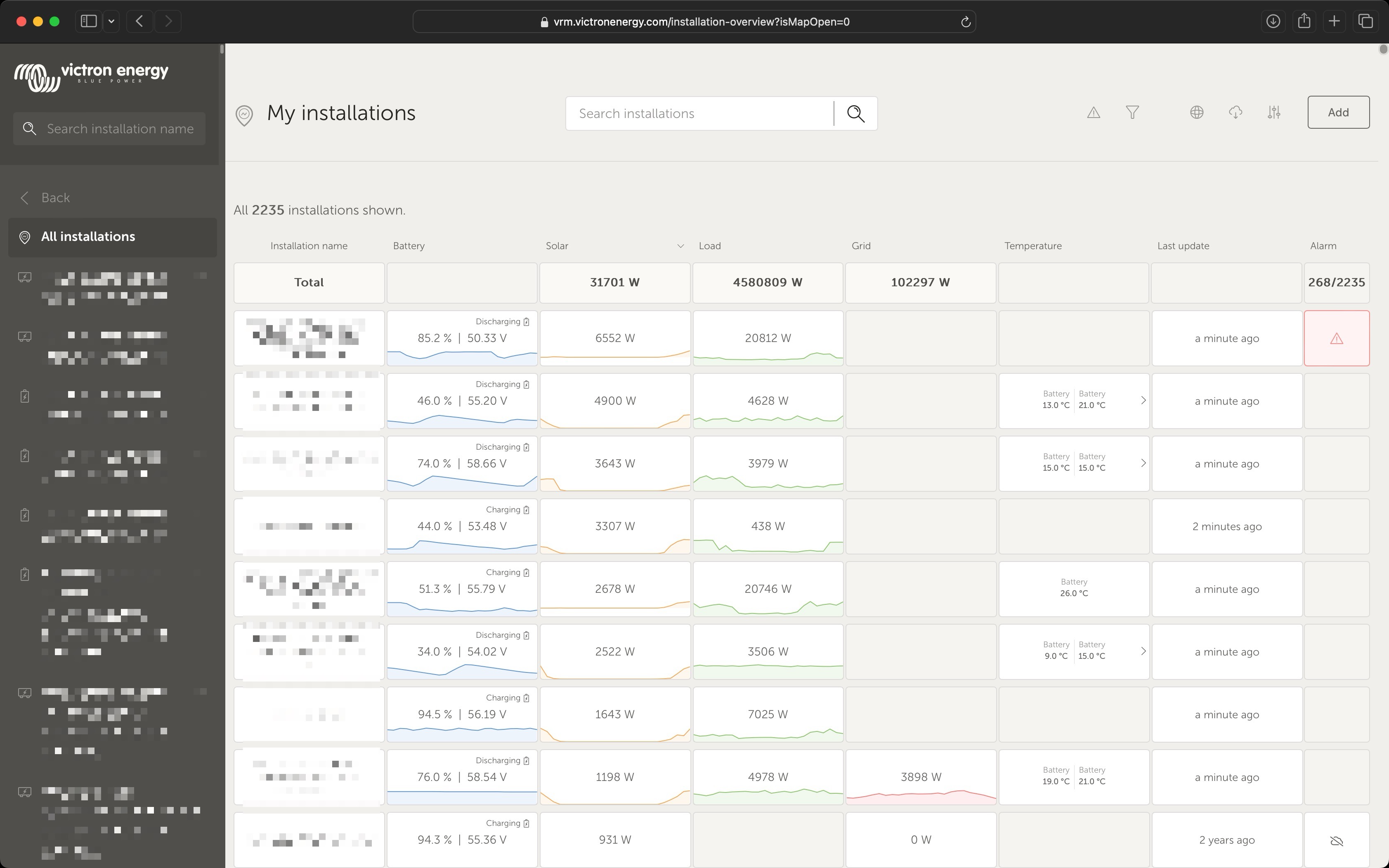

The installation overview is shown when there is more than one site connected to your VRM account.
VRM installation overview will display the latest (even real-time) data available from your fleet of systems. You can view power consumption, solar generation, tank levels, battery status, and more, accessible via desktop or mobile.
Installations with an active alarm are shown at the top. Hovering with your mouse over the alarm status on the right shows a tooltip with details of the raised alarm(s).
Installations that were last seen three months ago, and longer, are moved to the bottom of the table.
You can sort the installation list by any of the available information by clicking the table headers.
If you have over 100 sites you may find the main overview window takes longer to load. If you wish to quickly go to a specific site by name, use the sidebar menu. This loads only the site names and stays extremely fast for operators with 1000's of sites.

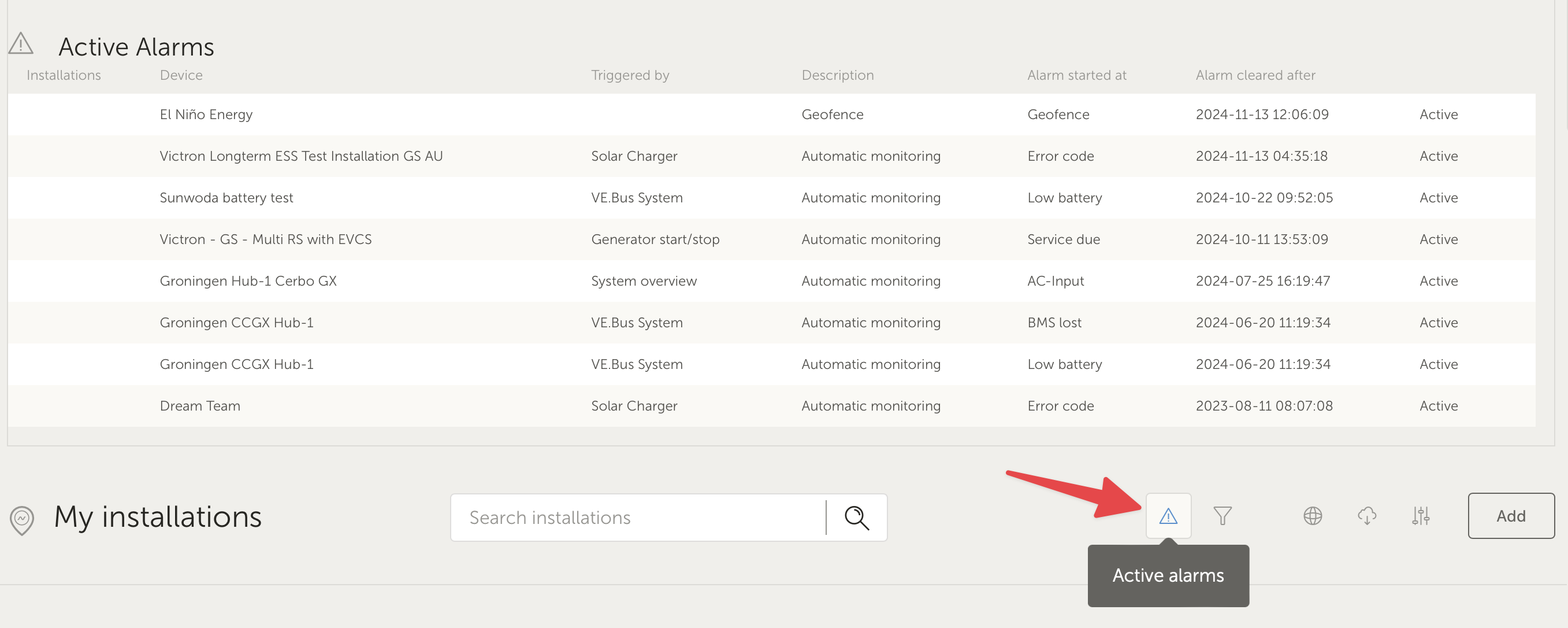

By clicking the triangle on the top of the VRM Portal, you see an overview of all currently active alarms.

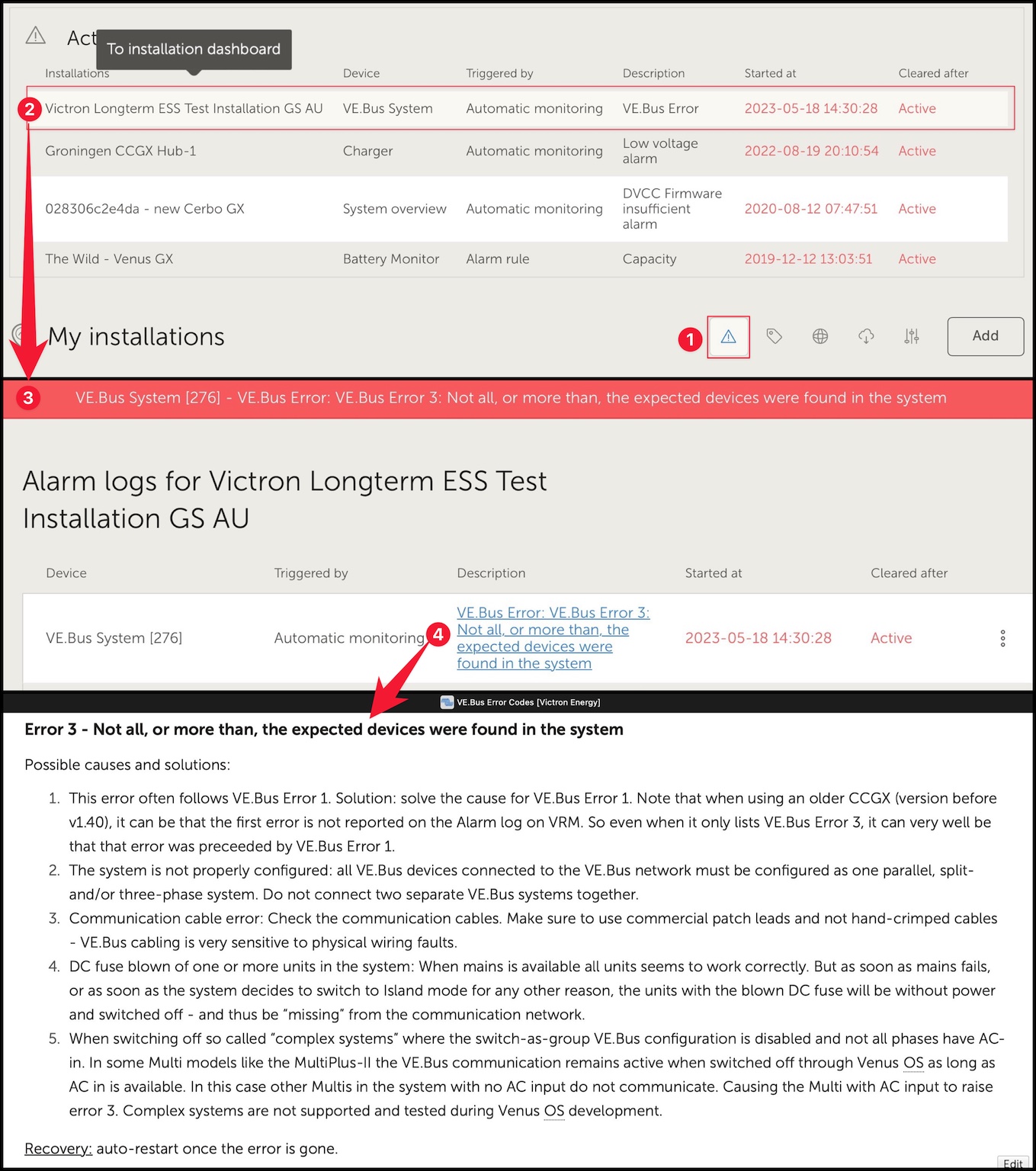

13.2.1. Active Alarms
Clicking the triangle on the top right of the overview, will reveal all currently active alarms.
If the alarm comes with specific documentation (such as the MPPT and VE.Bus Error codes), you can click through for the description to see exactly what the alarm code means and find troubleshooting suggestions for clearing it.

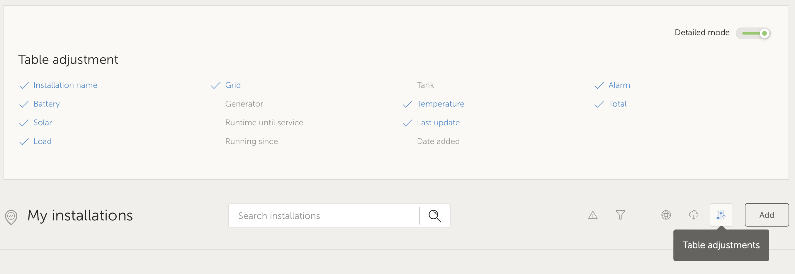

13.2.2. Detailed mode and column configuration
Clicking the table adjustment button in the top right allows you to hide and reveal which columns are shown, and also enable/disable the detailed mode.

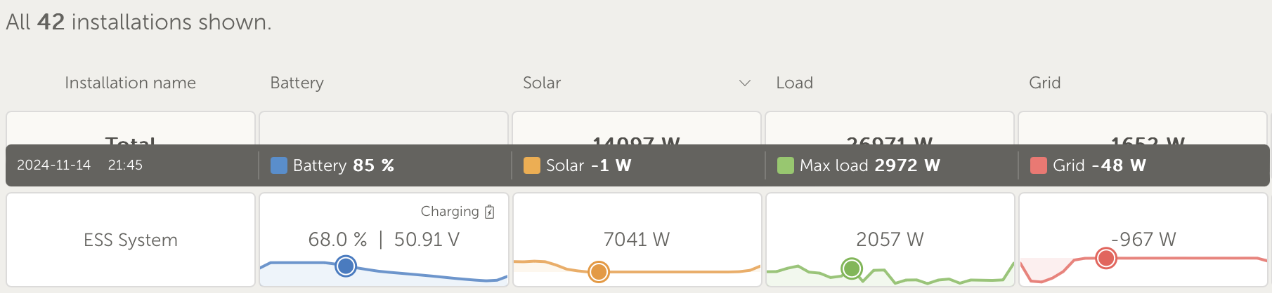

Detailed mode enables Mini-graphs that provide detailed insights into the loads, solar, and grid performance of different sites in your overview for the last 24 hours without the need to open each one of them separately.
This can help quickly identify issues and signal load spikes early on.
Hovering your mouse over the mini-graph will pop up a bar that displays the value at that time. Note the latest value is still shown in the main cell.
Depending on the number of sites you have in your fleet you may find performance is improved by disabling this feature.
On some platforms, e.g. mobile phones, this feature may not be available, or only available in landscape mode, due to small screen size.

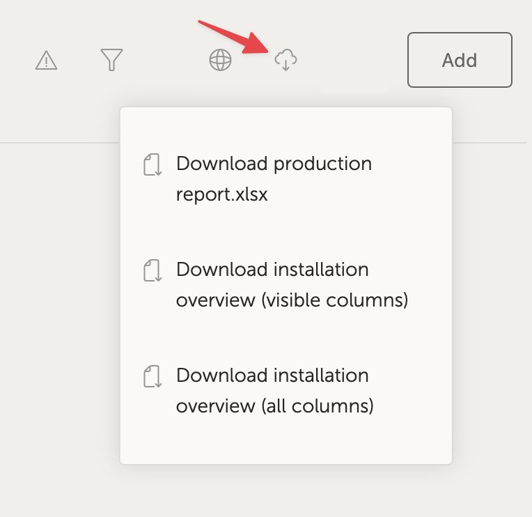

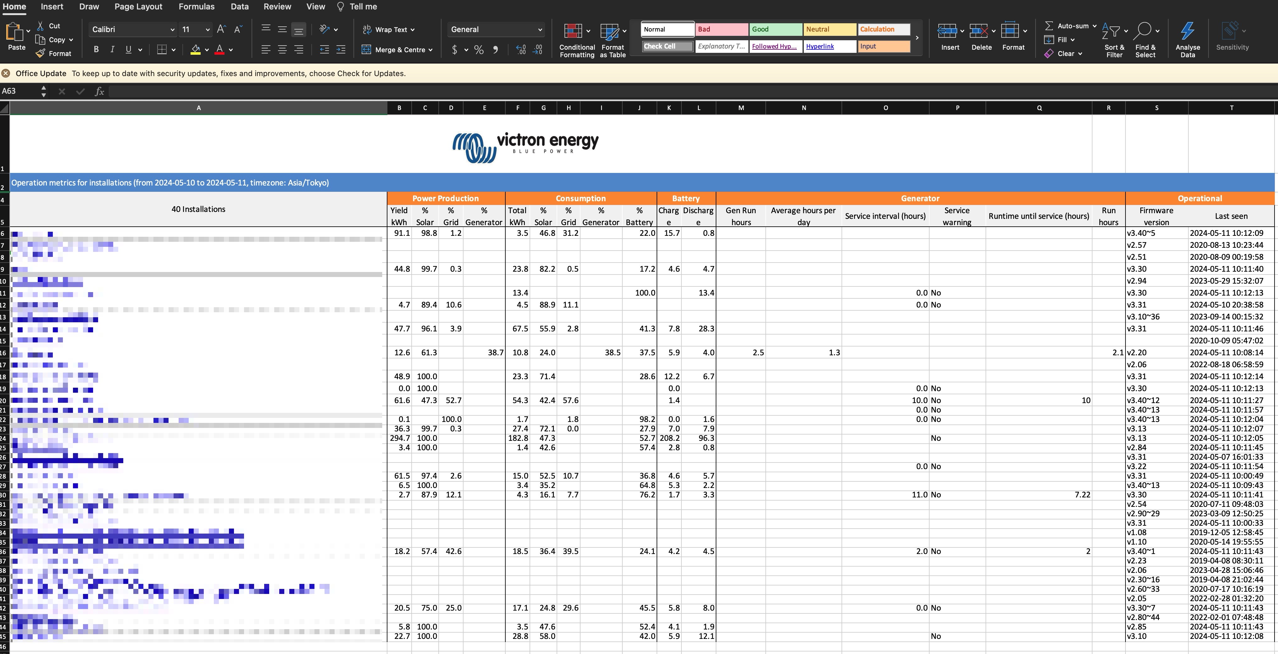

13.2.3. Downloads
There is a download feature on the installation overview page that allows you to export only the systems shown (filtered list), all systems, and a production report.
Here is an example of the production report:

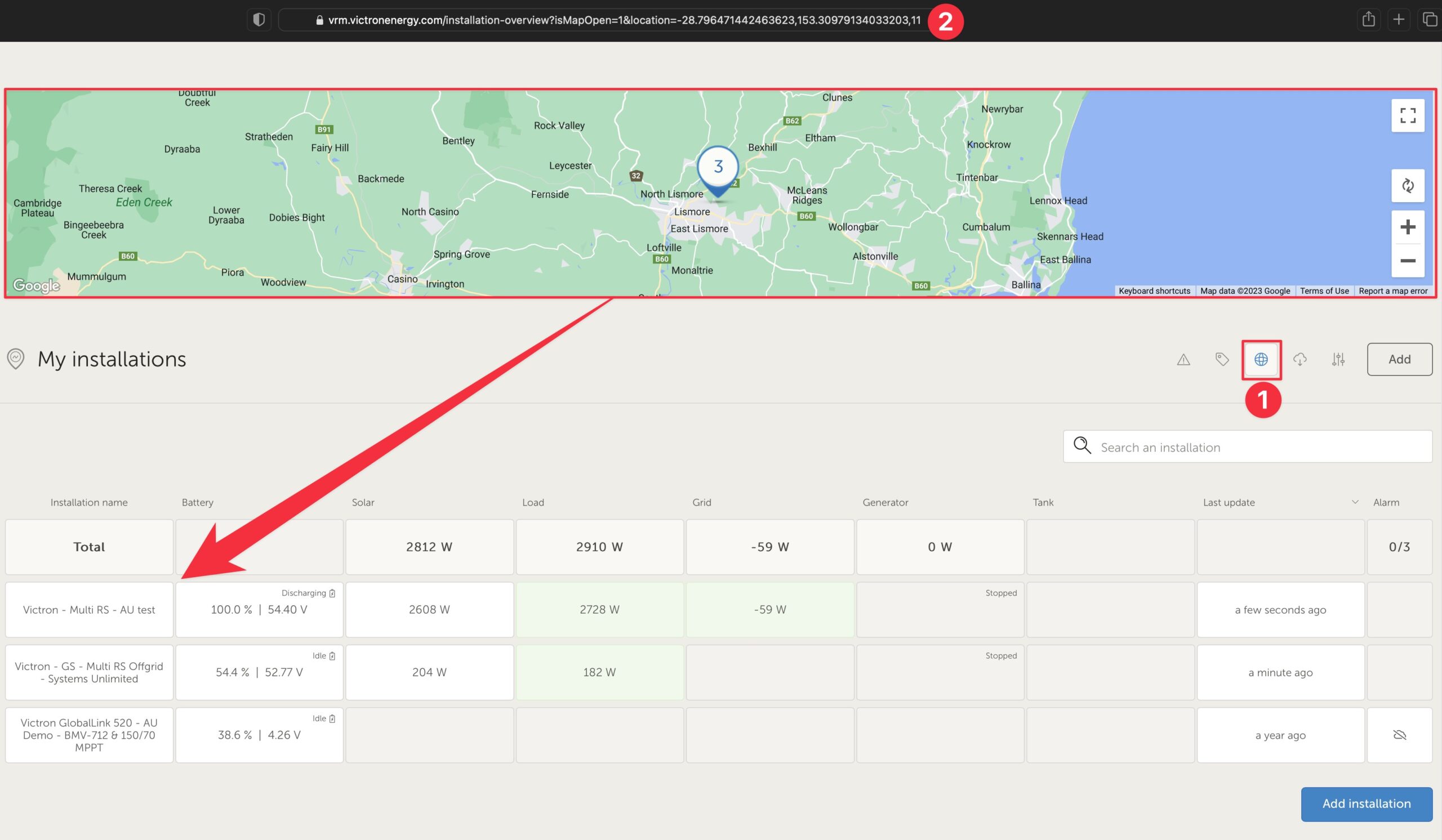

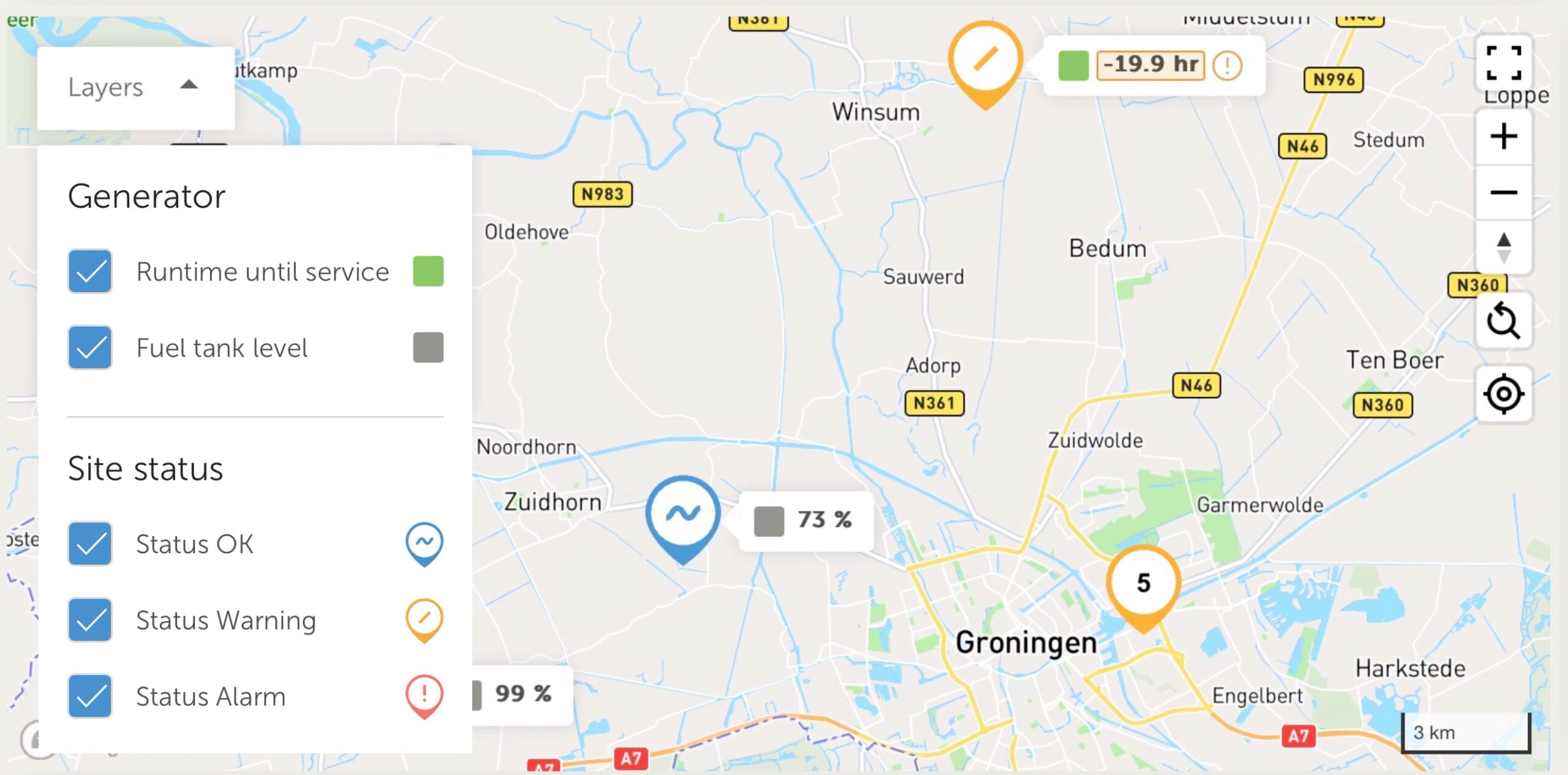

13.2.4. Map
The systems visible on the map filter the visible systems shown in the installation list below.
The visible map coordinates are displayed in the URL bar of your browser.
This means you can customise the visible system views to your preference, then bookmark the page in your browser for quick access.
This feature becomes even more powerful for systems with a dynamic location set by a GPS. For instance, if you operate a fleet of vehicles with Victron systems containing a GX device and GPS module, you could create a location bookmark and filter view to only show systems in your service workshop.
The filter's visibility may vary depending on the width of your browser window. Different devices may display a different list of systems from the same link if the screen resolution varies.
You can also click to reset the zoom level to see all your installations.
Opening the Map into a full screen view allows you to hide based on site status and generator tank levels and service times.

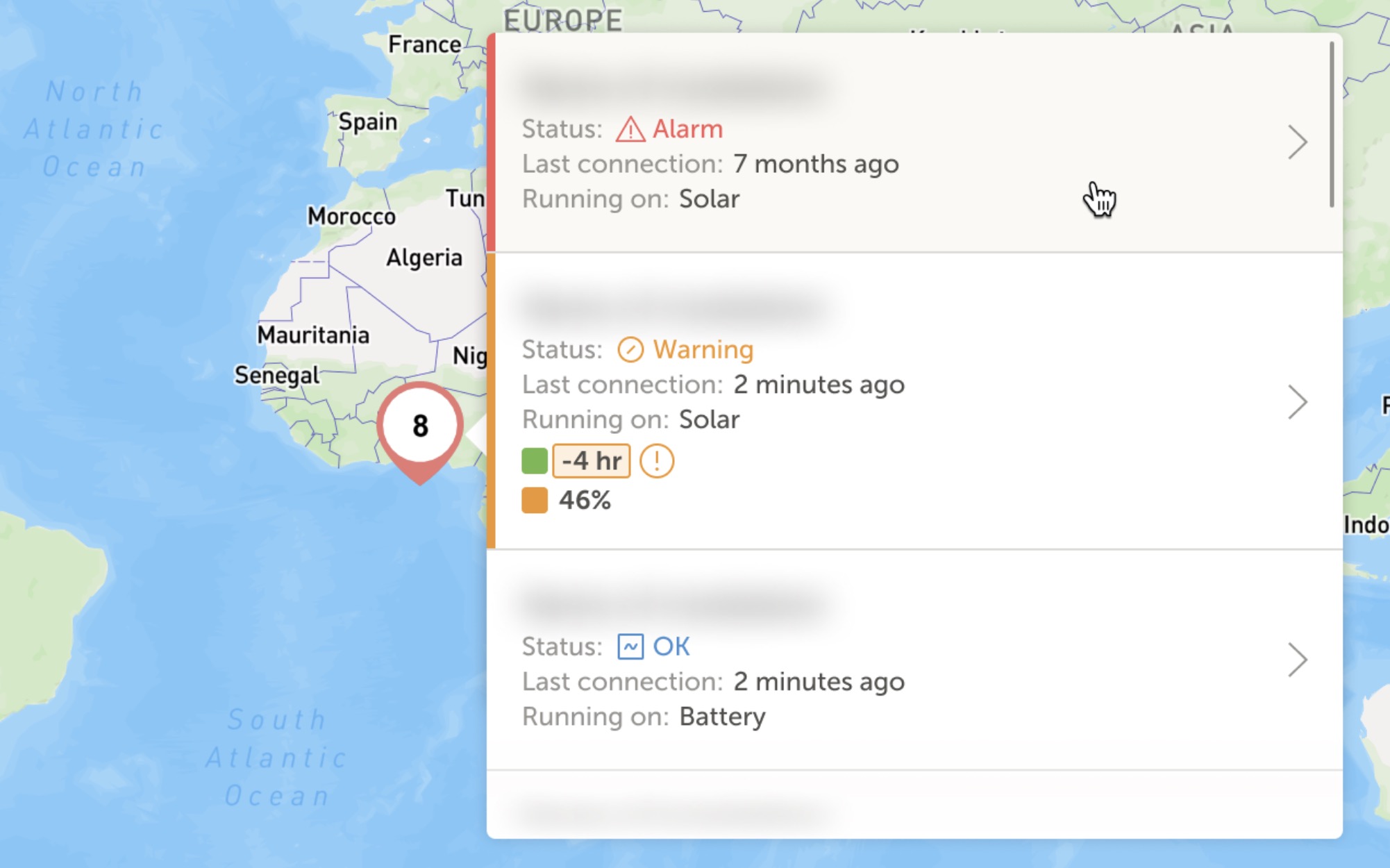

If more than one side is located in the same location, clicking it will reveal more details (names are blurred out in this example).

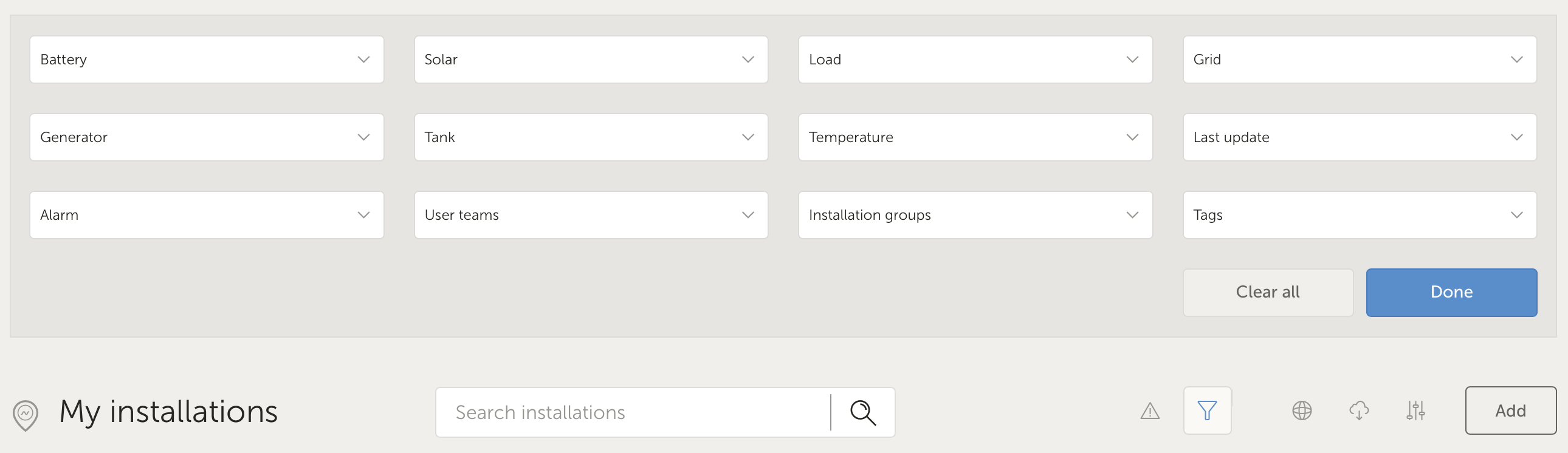

13.2.5. Filter
The filter bar allows you to filter the installations shown by various parameters:
The filter bar stores all filters in the url, so you can quickly share the filtered installation overview or bookmark it for your periodic checklists.
You can clear the applied filters even if the filter bar is closed by clicking the clear filters button that is shown in the top right of the installations list when a filter is applied.

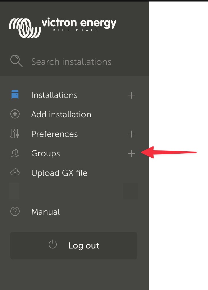

The 'Groups' settings are accessible via the top level menu of your VRM account.

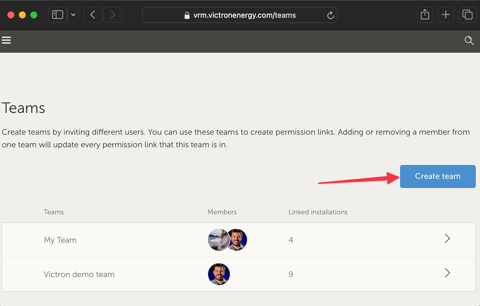

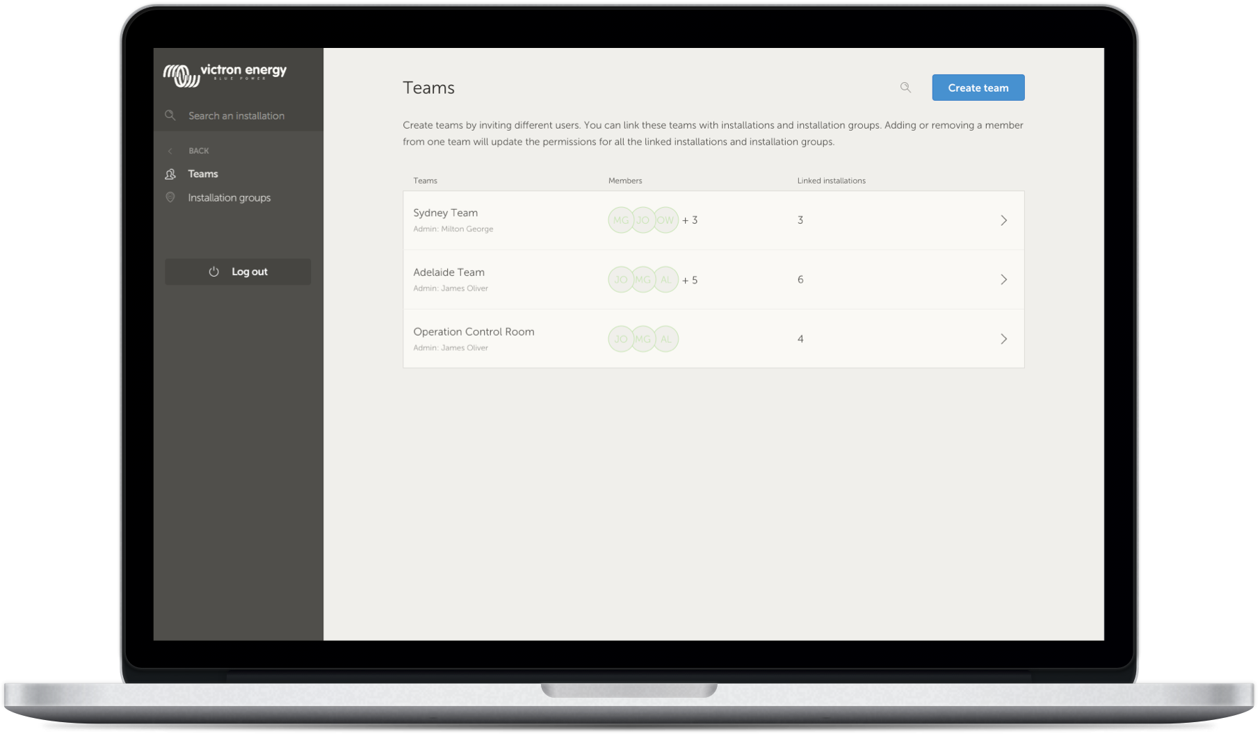

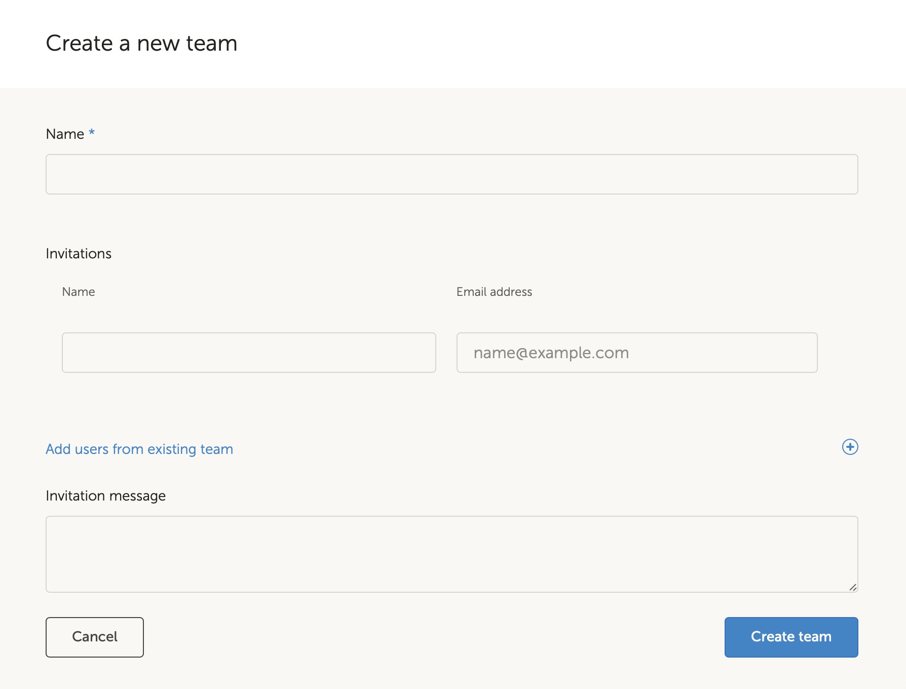

Creating a new team
You can create a new team by opening the Groups menu, selecting Teams, and Create Team.
When creating a new team you are automatically made the team Admin.
Team Admin can name the team, invite other VRM users to join, and add users from another existing team.
Adding an existing team can save time if you already have a big team, and then quickly add or remove individual people who you don't want in the new group before saving the selection.

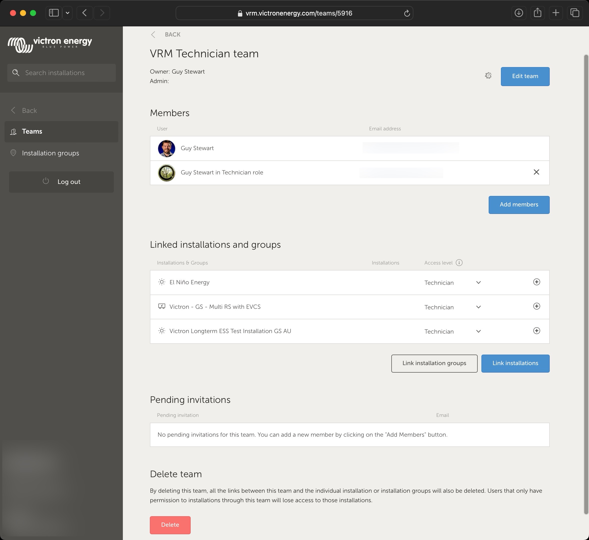

Once you have created the new team and added other users, the team will appear in the teams page. From there clicking to open the team will allow you to add additional users, and also link specific installations, and installation groups.

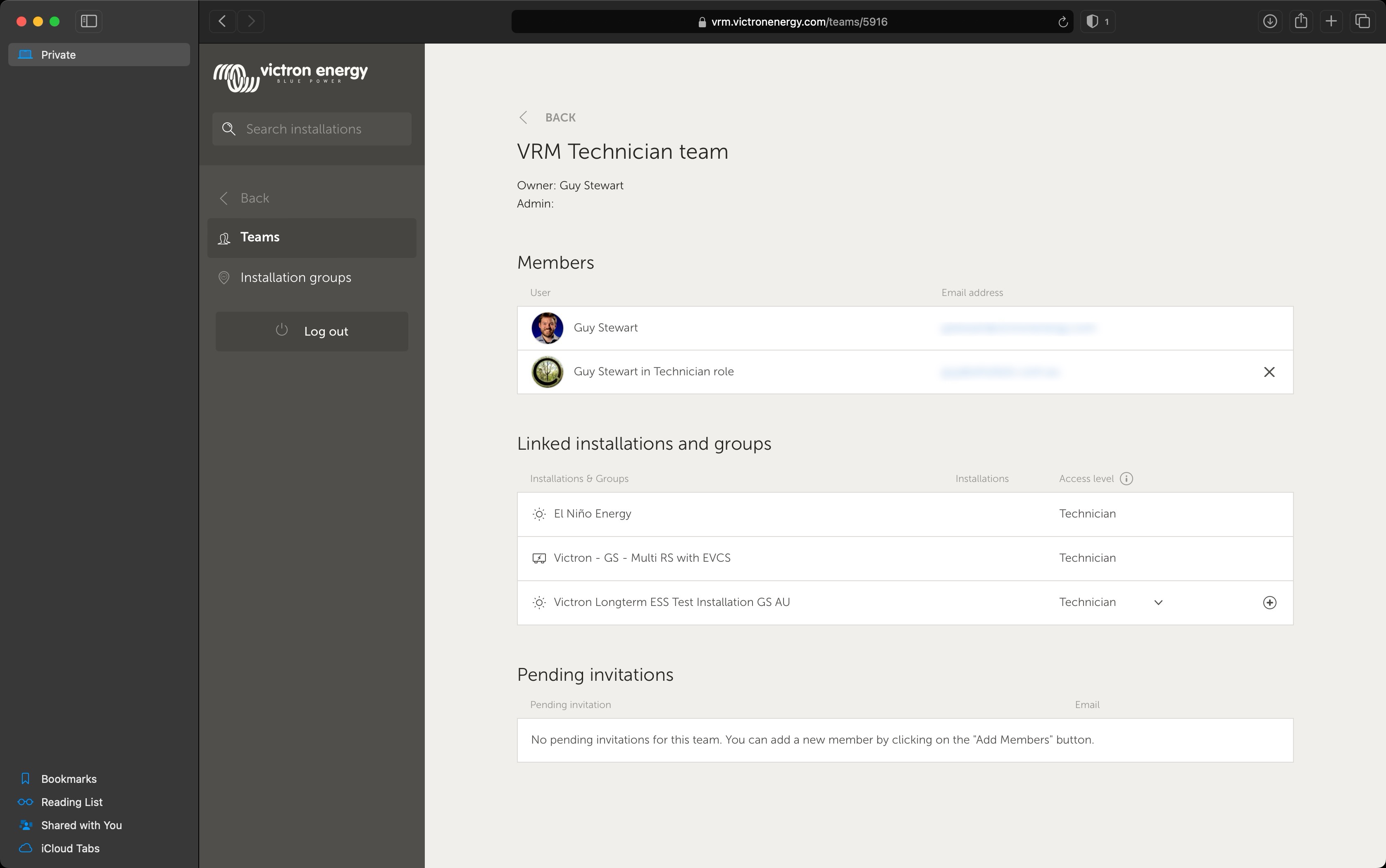

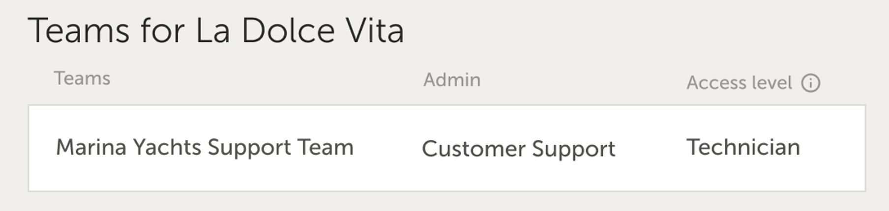

If you have Admin control for a specific installation, you can share control with a team. If you have Technician or User (read only) access you can not.
Depending on the access level you have the options shown will vary.
Above is how the Team menu is shown as an Owner or Admin of the team
Above is how the Team menu is shown as a member of the team
In this example the technician member of a team is able to change their access level for only the one installation that they are also an Admin of in VRM (either individually, or as part of another Team that gives them Admin user access).
The members of a teams details are not shown to people who are not part of the team. For example of you have a support team that is given access to end-user installations, the end-user will not be able to see the support team members individual names or email addresses, only the name of team, the Admin and their Access level.

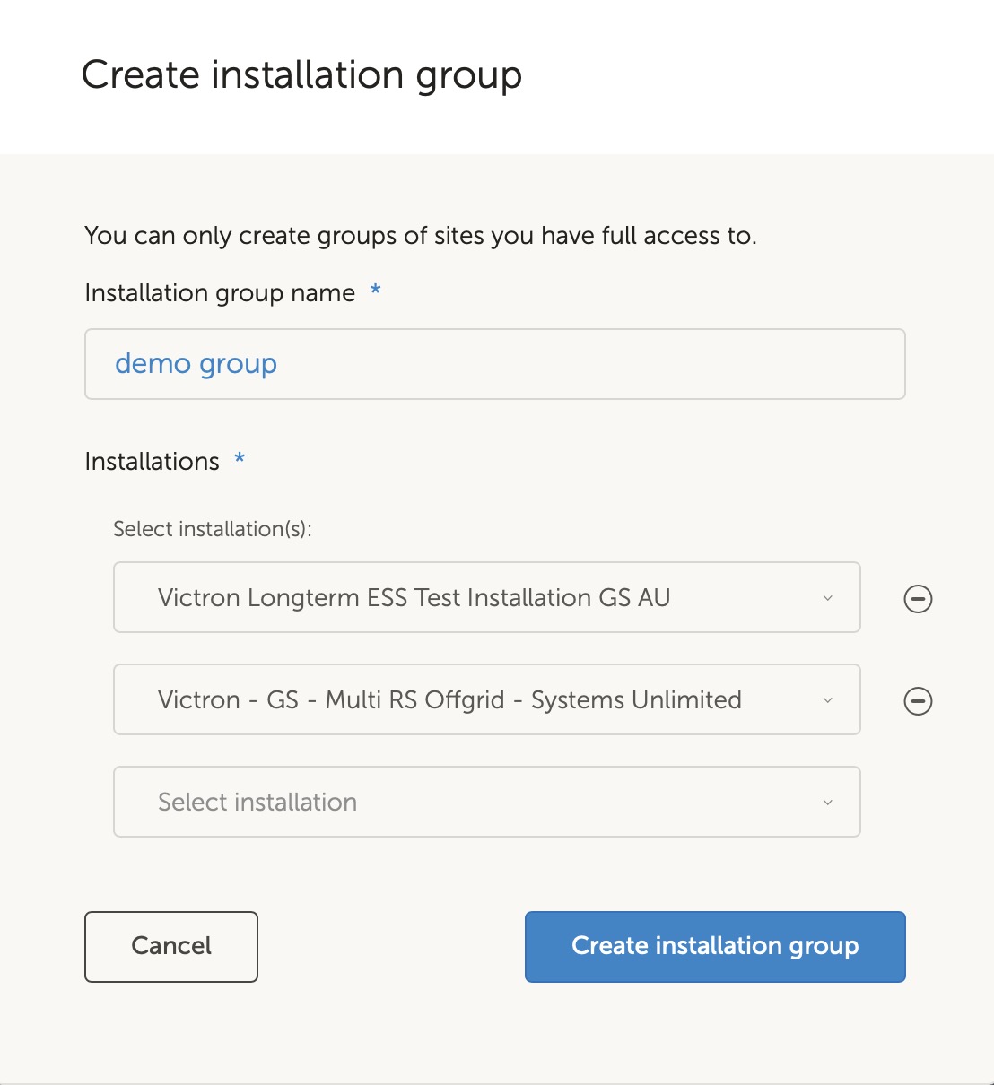

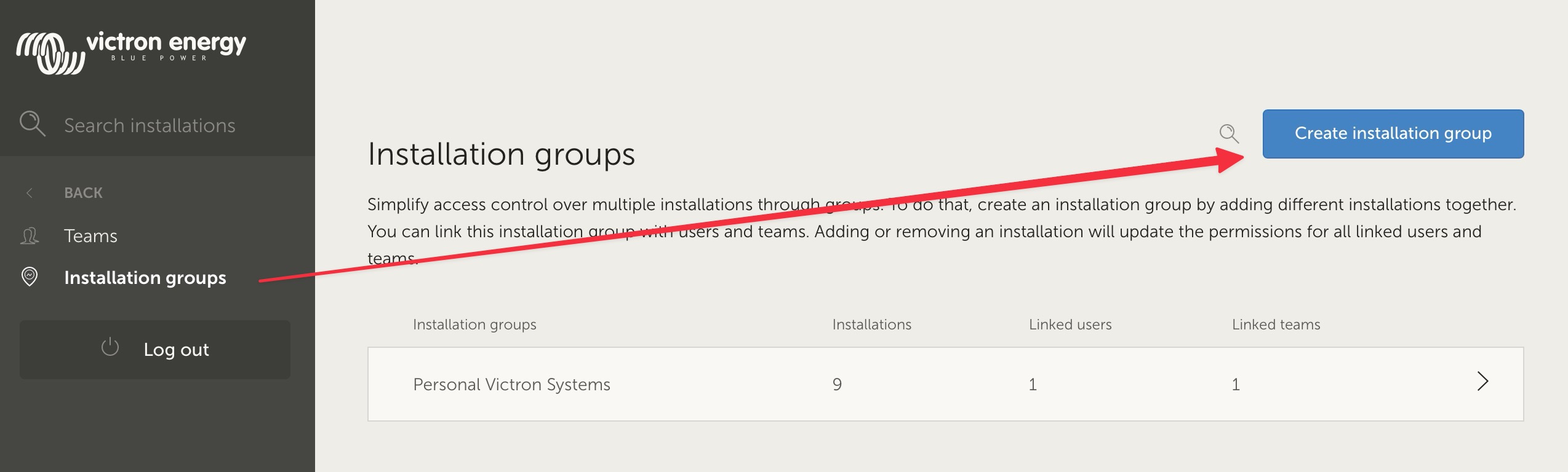

Creating a new Installation group
You can create a new installation group by opening the Groups menu, selecting Installation groups, and Create Installation group.
Add an installation group name, select the installation from the pull down menu, or using the search tool. You can only add installations that are already linked to your VRM user account.
