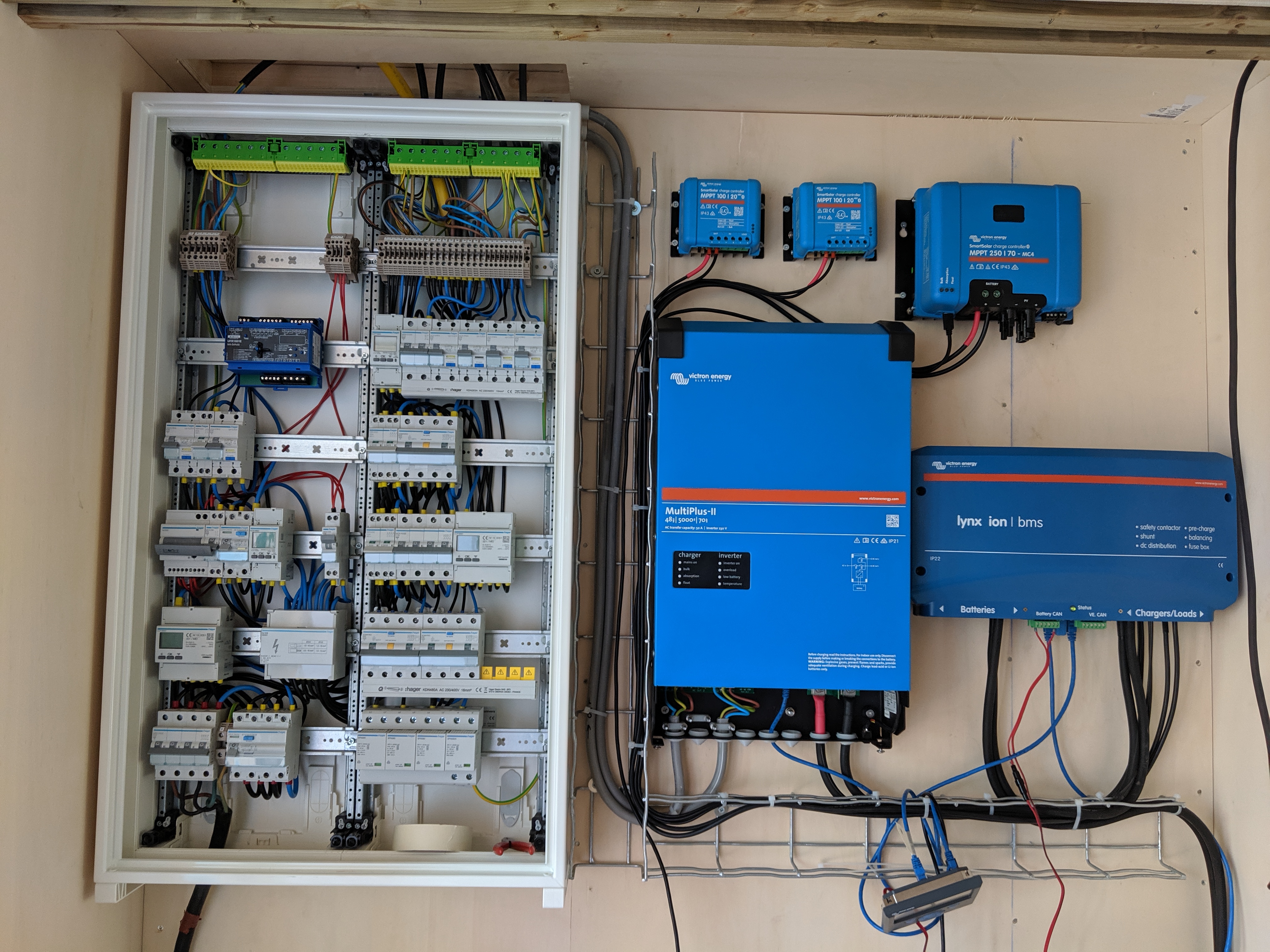

Lawrence’s job on the team was initially to design and build a working solar system which complemented the team’s building concept. It was a small project (5 kWp of panels + 6 kWh battery system powering a typical residential installation). He was particularly driven because solar technology is his major area of interest at TU Delft and he welcomed the opportunity to gain some practical experience.
Victron seems ideal…
He noticed fellow students elsewhere in the university using a 48V Victron Energy System together with a separate 350VDC system to test different charging voltage levels for e-bikes …and elsewhere a lighting project was also using Victron equipment …after investigation Lawrence was very interested in the Victron capability of integrating DC circuits at different voltage levels through a single DC distribution system. He contacted Victron’s Johannes Boonstra to discuss Solar Decathlon Europe in the hope of gaining ideas.
Lawrence explained: We have three different types of PV arrays and had planned for two different DC circuits (ISB-C and LED Lighting). Victron’s modular MPPT chargers and Lynx Ion BMS allowed us to integrate all the different generators and loads into a single DC bus, connected to a single inverter. This was something special that other brands that I encountered could not have done without more inverters and converters. In the end, Victron helped us install a functional DC distribution system that is expandable and perhaps a bit over-engineered for a traditional residential home.

We are super grateful for all the support Johannes has provided us, even during emergency situations such two weeks ago when the inverter started behaving erratically in Hungary, he took the time to trouble shoot it successfully from the Netherlands using the system’s remote management facility.
