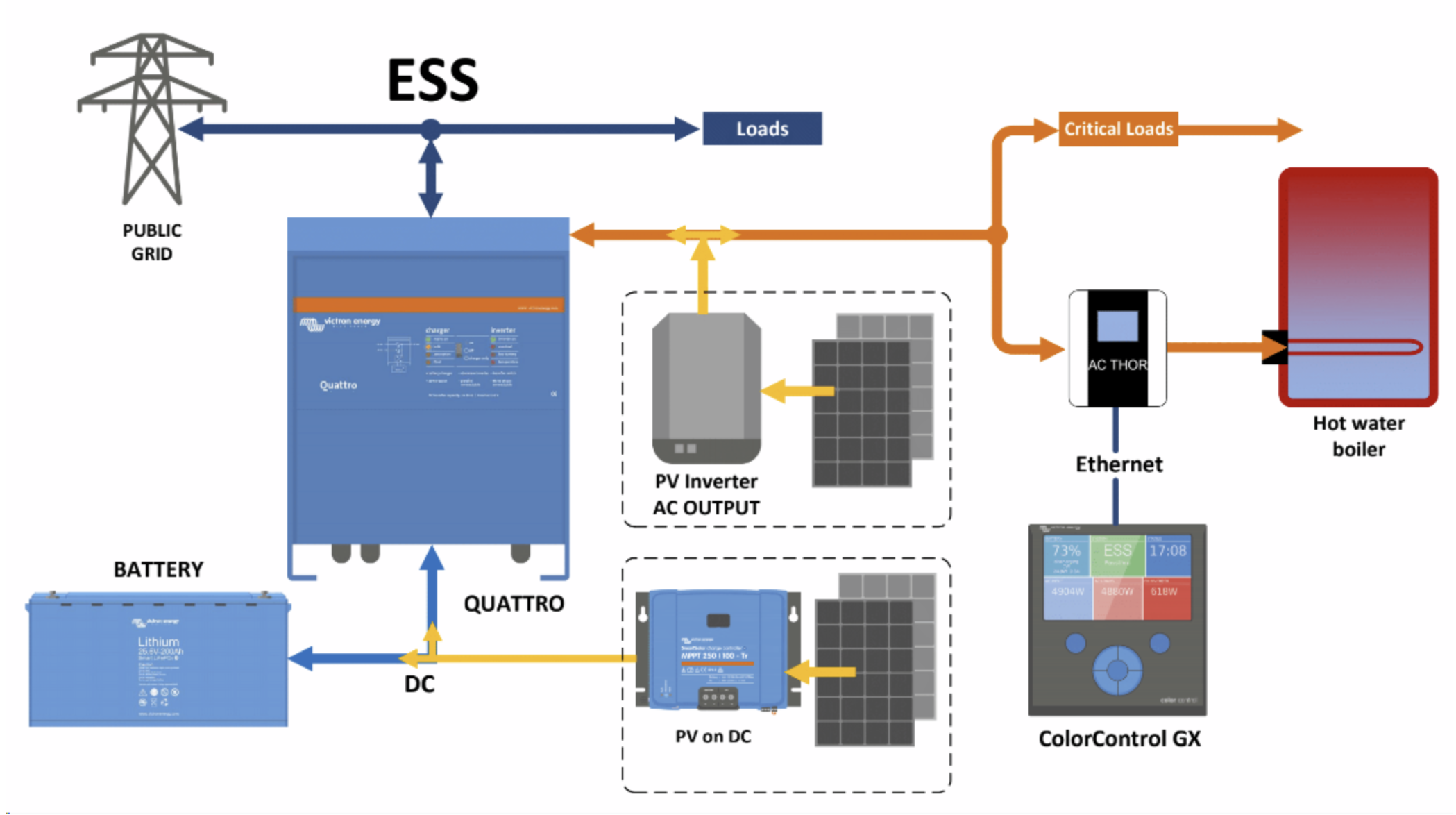

AC.THOR is connected via ethernet to the Victron GX device – such as the Color Control GX. Metering takes place every second, so any change in circumstance – a load being turned on elsewhere in the house, for example – is quickly detected and the power provision to the immersion heater is either reduced or terminated.
The following schematic shows how AC.Thor might be integrated with a Victron Energy Storage System:
