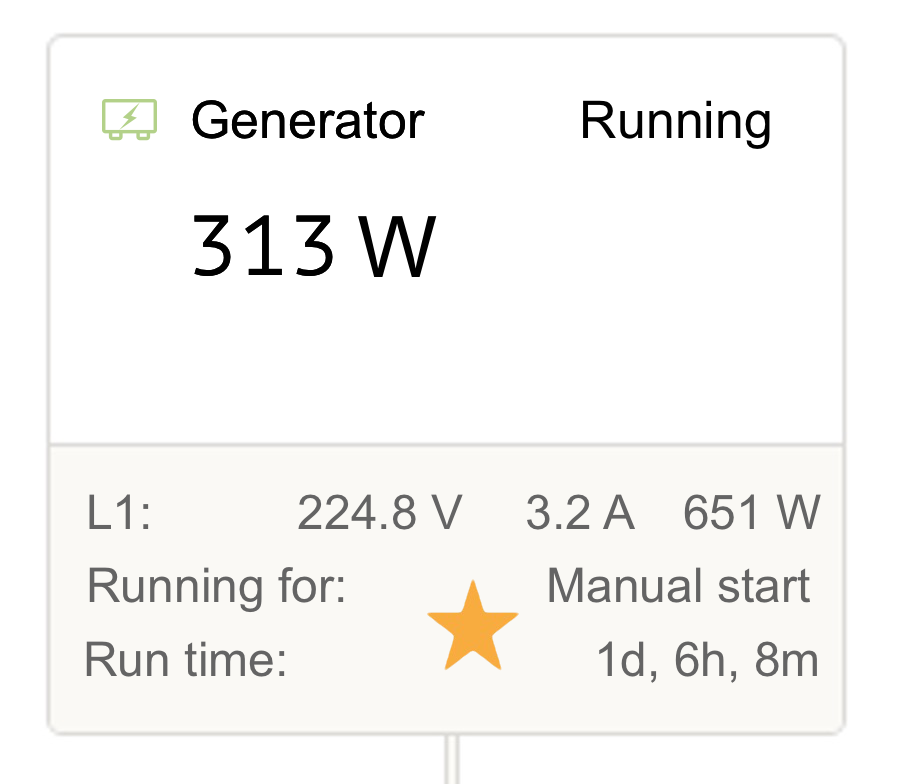

#5 – VRM Dashboard improvements
More information has been added to generator view (running/not running, last run, why it’s running, and more) on the VRM Portal Dashboard, when enabling the Detailed view.
More detailed information about AC input (grid/shore) as well as AC Loads, including frequency has been added.
