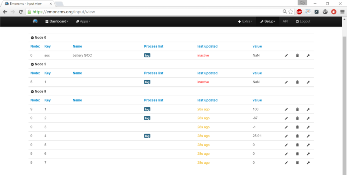

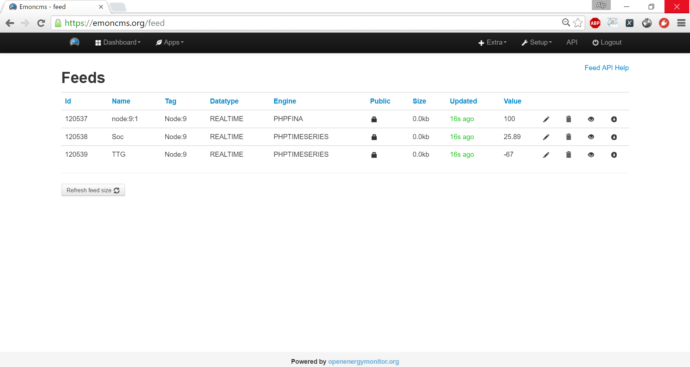

Second and third screenshot show the configuration:
