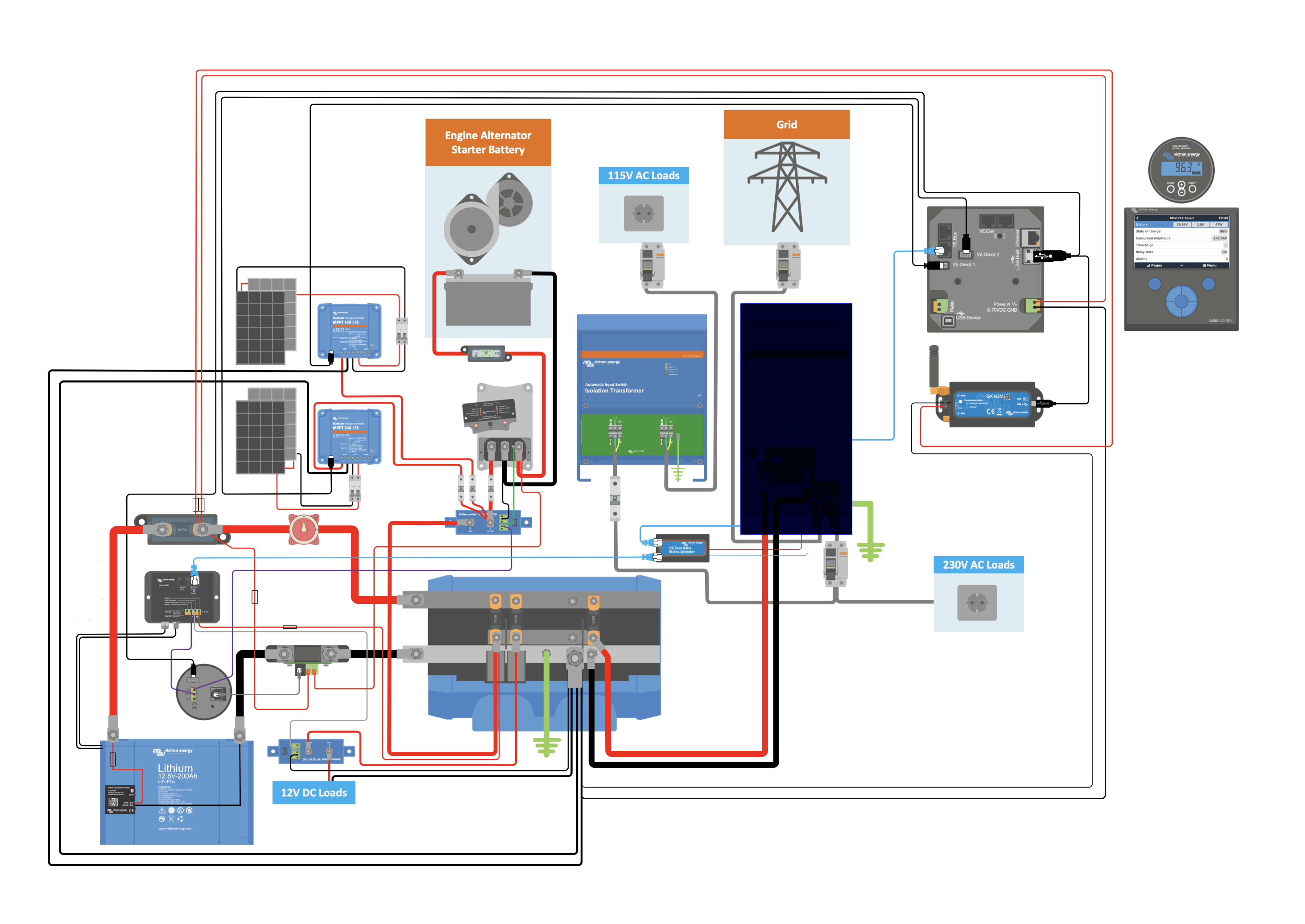

Schematic
In response to a reader’s question, asking for a schematic of the installation, Héctor Cortés of DSPSolar tells us that he modified the following drawing. He says:
