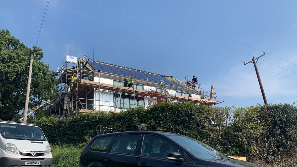

There’s a new video on our channel which follows system designers Off Grid Engineering as they install a 6kW PV ‘Glass Roof’ with 15.36 kWh Lithium storage – and explain their choices.
Interestingly, the overhead power cables of the local electricity grid pass directly over the building site of this new build house, yet the owner – Jim Watt – decided not to connect to the power grid, but to supply his new build house in a Shropshire village, UK, with off-grid electricity.
Close proximity of a power cable doesn’t always mean that connection to the grid will be straightforward or inexpensive. Often in rural locations in the UK there is insufficient capacity to add a new connection to the existing infrastructure – or the transformer is distant and so a cable has to cross someone else’s land, requiring permission, legal agreement and ‘easement’ payments. Cost of connection can escalate to a six-figure sum.
