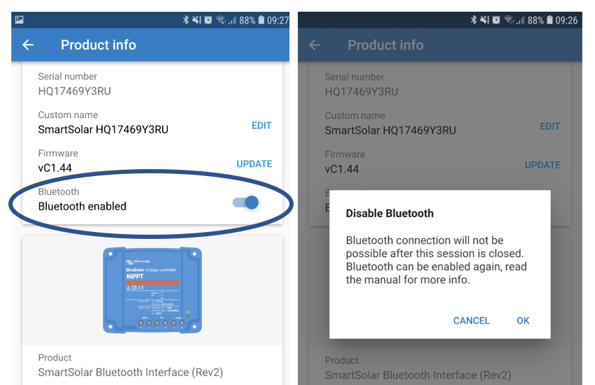

More products have the Disable Bluetooth option
In some cases, the installation type requires disabling Bluetooth. For security reasons for example: there is nothing more secure than simply disabling the feature.
With this new version, Bluetooth can now also be disabled for SmartSolar Chargers, the Phoenix Inverter Smart family and the Impulse-II Smart Chargers.
For other products, like the BMV-712, Phoenix Smart IP43 Charger and the Smart Battery Protect it was already possible to disable Bluetooth.
There is only one last product family for which this is not possible yet, all the Blue Smart Chargers, i.e. the IP22, IP65 and IP67 models. It’s a top priority for us to finish this, you can expect more news soon.
The Disable Bluetooth option is in the Product info page:
