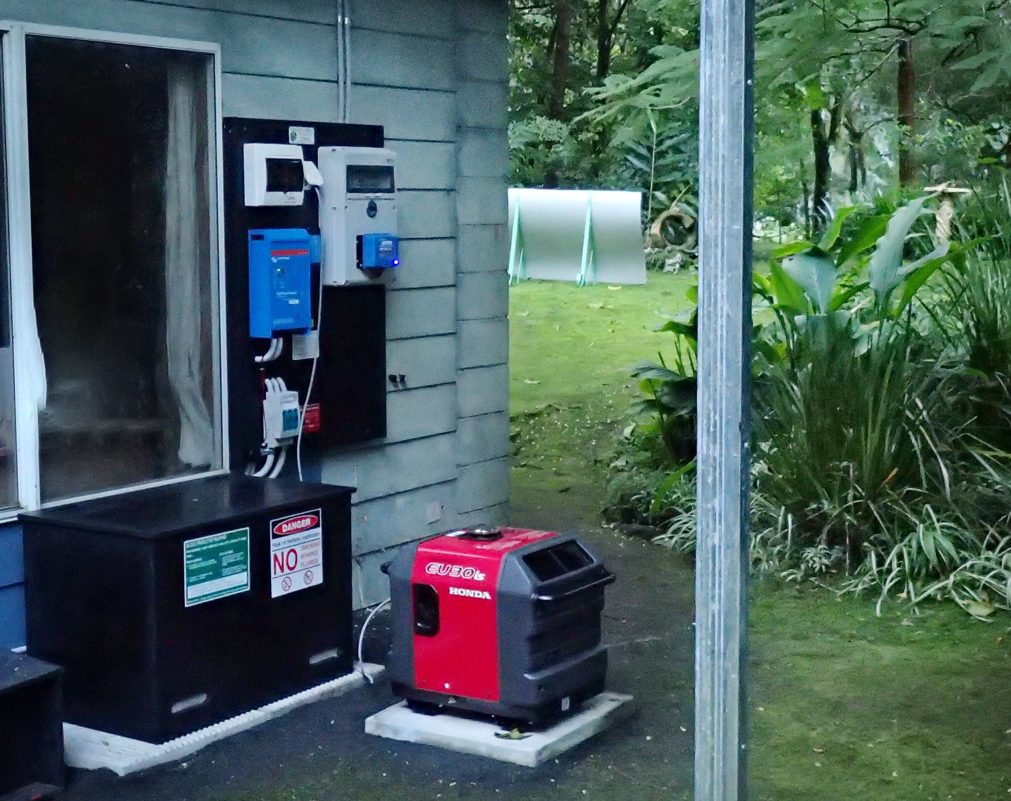

We had an example of a competitor’s battery inverter/charger from a major German manufacturer that refused to stay connected to the very common Honda EU30. While we do not advise our Victron system customers to buy inverter-based generators – if they already own them, we are able to make them work.
OLYMPUS DIGITAL CAMERA
For our nautical friends, this can be further complicated by variable shore power supplies.
