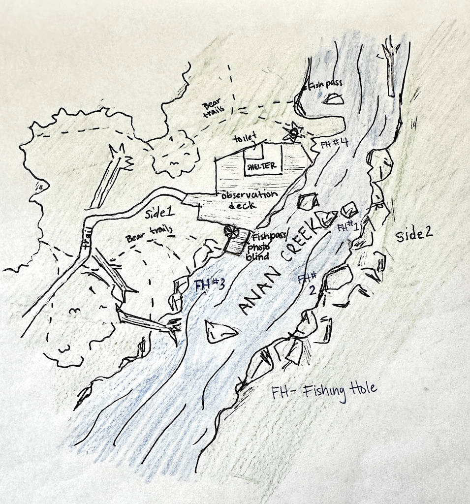

The cameras have been placed in a unique location where both Black and Brown bears are seen to cohabit – at the remote Anan Wildlife Observatory. “There are bears all over Southeast Alaska, but here at Anan we see both species interacting, living together, and raising their young right here along the river,” says ranger Jen Kardiac of the US Forest Service.
From early July through August, the Anan Creek draws bears from the surrounding area to feast in one of the largest pink salmon runs in Southeastern Alaska. Located deep in the Tongass National Forest, just 2400 lucky visitors a year get to watch the bears fish and interact along the creek – visitor numbers are limited to minimise environmental impact. This new installation allows anyone around the world to tune in ‘LIVE‘.

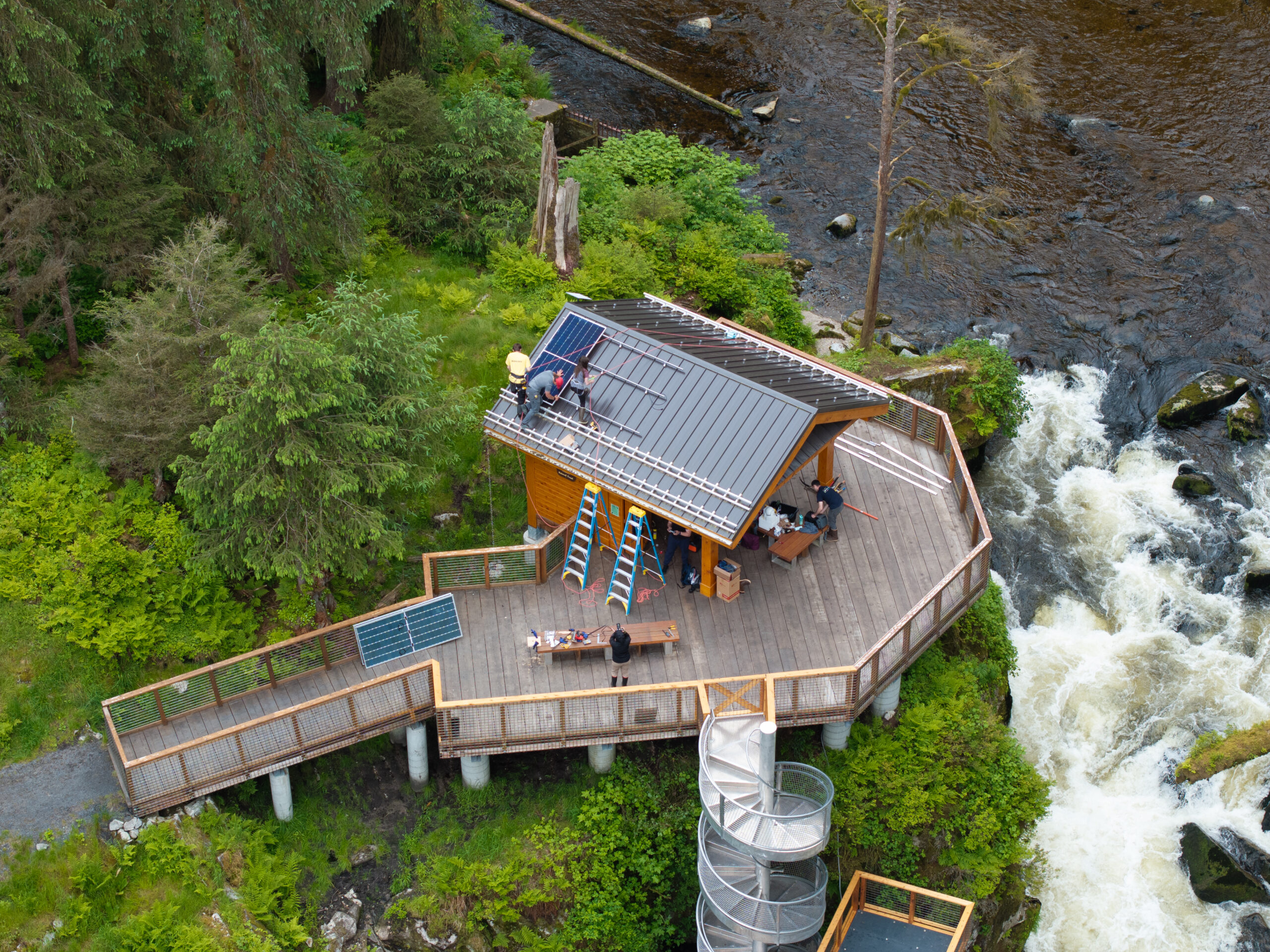

The Forest Service asked that the camera system be operational for at least seven months of the year – from mid-March to mid-October – and that it should be mostly solar-powered …quite a challenge in Southeast Alaska, where it rains much of the spring and fall.
“We had to look at weather and irradiance data to try to estimate how much power our solar panels could collect. We took data from another solar system that’s been operating on a floating ranger station for about 10 years, and used that information to estimate the performance of components installed in that same environment,” says Brian.

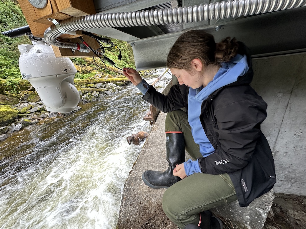

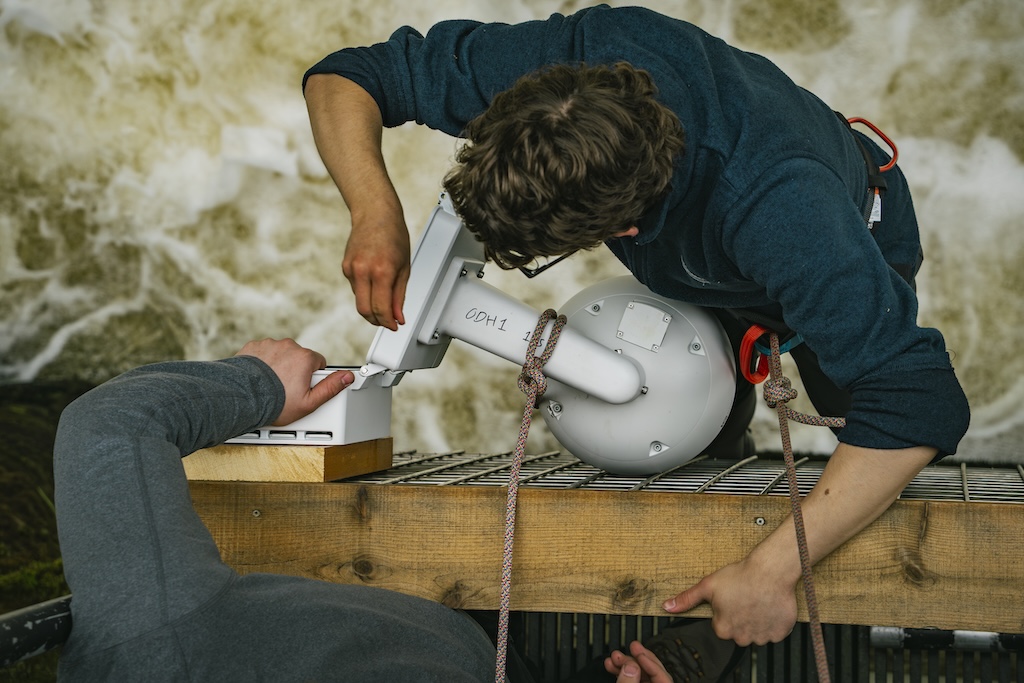

“The cameras run 24/7; they have a normal camera lens during the day and an infrared camera to pick up bear activity at night.”

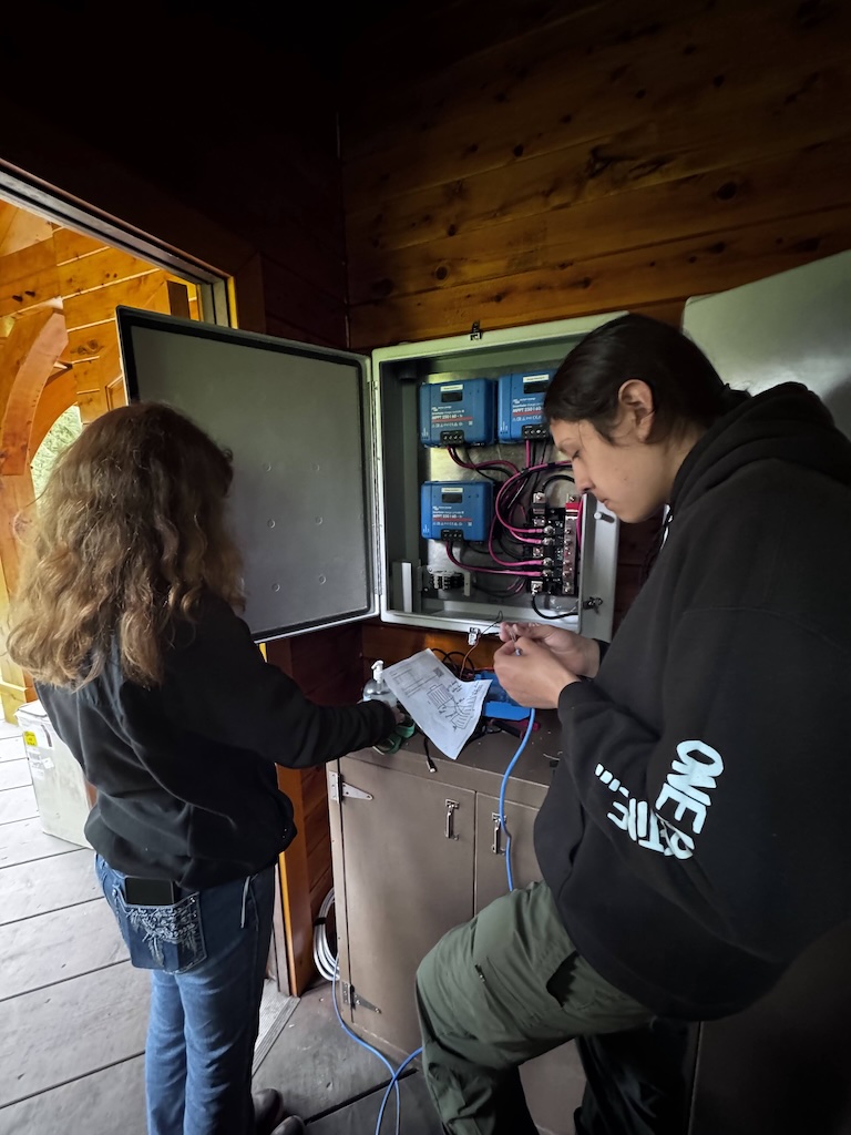

Brian really liked their choices: “All the components were super easy to use and configure. Things just worked, which was really nice. We’d done a lot of work ahead of time, so each of the kids knew what each component did, and how they should be wired.”

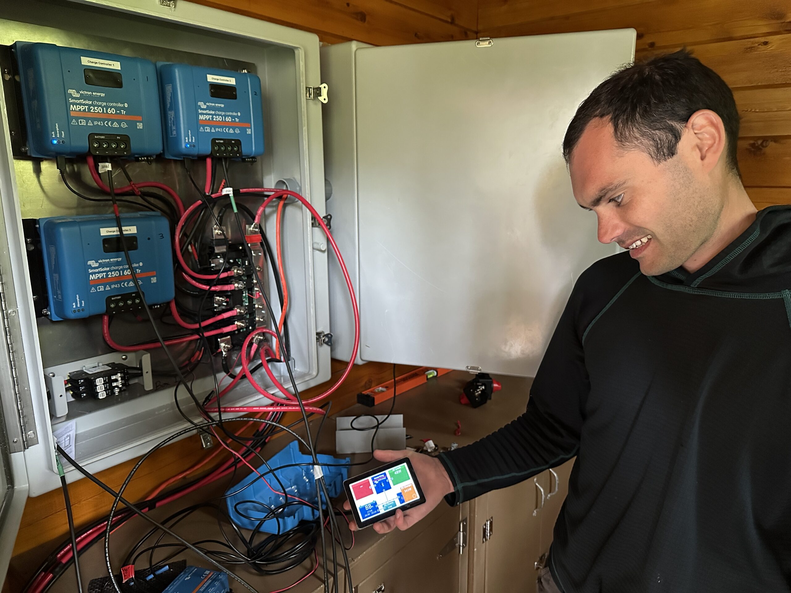

After a few days, when the students had everything installed, something with the power system wasn’t working. They called Reid Loessberg at the Victron distributor Intelligent Controls, who also provide support to the Explore.org tech team.
A firmware update and some basic tweaks to the programming of the charging setup was needed  – via  the Victron Remote Management portal VRM. The firmware updates were installed, settings were adjusted for the installation, and some quick troubleshooting got them back up and running. Keeping the focus on educational aspect of the facility and the installation process, Reid was able to join the team remotely and  help guide the student-led crew through the final details of the installation, and before long they were ready to go.

The system was installed in 2024. Ahead of this summer season the students took the power system back to their classroom, preassembling everything onto a mounting board -and then reinstalled it in a separate room at the observatory so that the Starlink could send a cleaner signal. The Forest Service requested two more cameras on the upper falls – a location where there is no observation deck.
“We knew that our batteries could handle the additional load,” says Brian “because the cameras don’t draw that much power themselves. The heaviest load is the Starlink and TV monitor when turned on.“
“Every morning for the last week, we’ve been logging into VRM just to make sure things are still working; we see that all four cameras only use a hundred watts of electricity, and we’re seeing that information in real time. Just the other day we had  2000 watts at 60 amps coming in. It was amazing, and the kids and I were saying, ‘Wow, that’s a lot of power!’”
