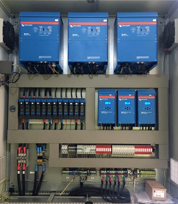

System design
The solar array is 12.6 kWp and feeds a VRLA battery storage bank from Hoppecke, which has 60kWh of total energy storage.
The power system is designed for 3-phase, which includes a pre-wired plug’n’play control cabinet utilising:
