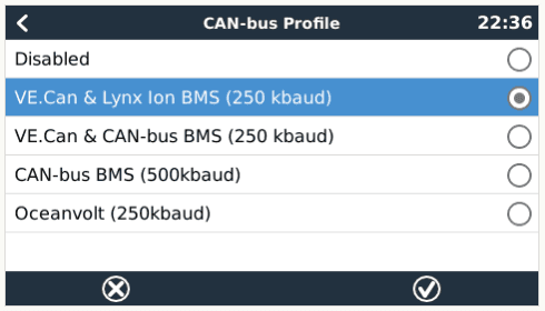

  • Improve canbus port selection. There are now four profiles to choose from:
    Existing CAN bus service settings are converted to the matching profile during the upgrade.
