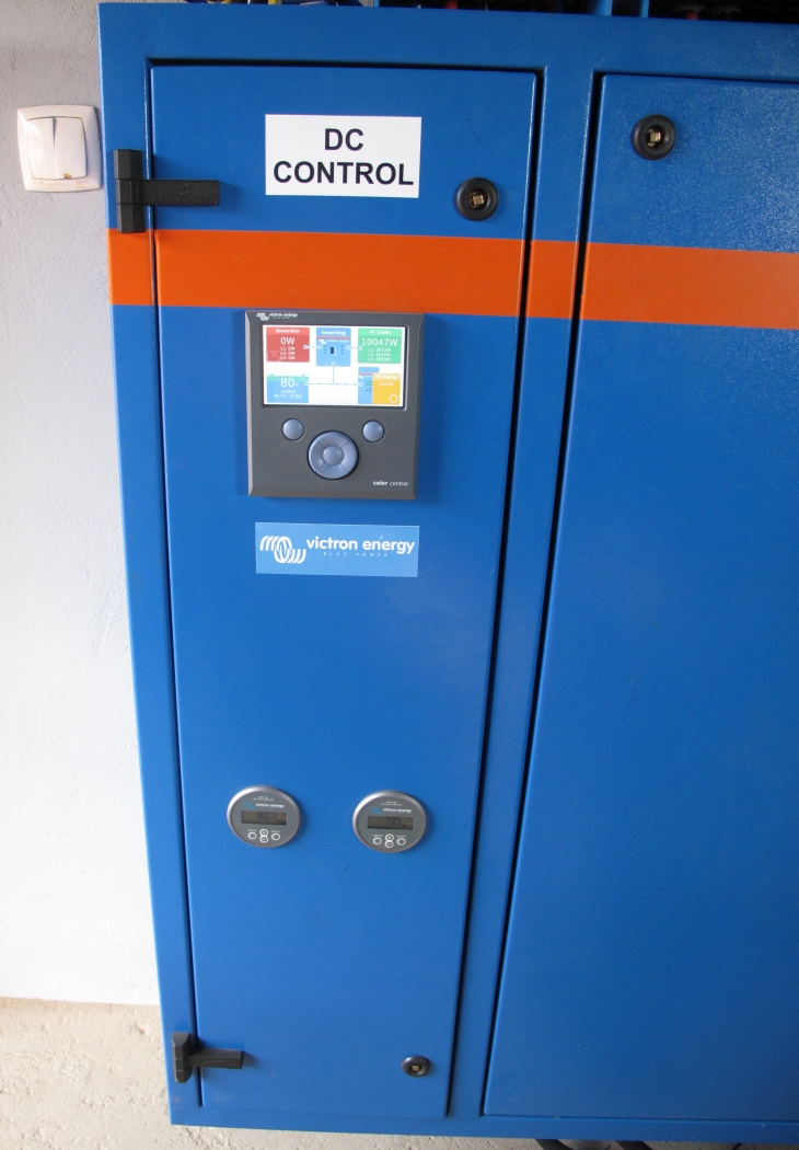

Energy system configuration
The off-grid system consists of a three phase 30 kVA system with 38kWp solar power, 2,400 Ah battery bank with a 40kVA back-up generator. Three Victron 10kVA Quattros in a 3-phase configuration and nine DC-coupled 150/85 MPPT Victron Energy solar charge controllers are all installed in/on one cabinet, including two battery monitors and a Color Control GX.
The 38 kWp solar power is generating an average energy of 180 kWh per day, which is partly used by the lodge during the day and also stored in the battery bank for night use.
During overcast days and high night loads the generator automatically starts based on the SOC (State of Charge) setting in the BMV battery monitors. The Color Control GX is connected via long range Wi-Fi to the Wi-Fi satellite router which connects to the internet for remote monitoring and management.
The entire lodge can run from solar including the borehole pump, water treatment plant, the diving compressor, the cold and freezer rooms, fridges and other restaurant and bar equipment. During the night the load is minimised by using timers switching off non-essentials to minimise the use of energy from the battery bank during the night.

- Supplied and installed ‘blue Victron Energy cabinet’ with 6000A bus bar and incorporated Victron Energy equipment into cabinet.
- Supplied and installed Wi-Fi system at the lodge for CCGX.

- Manufacturer of cabinet and support to Technical Solar for installation and commissioning on site.

Monitoring: Victron Energy 1 x Color Control GX and2 x BMV-702 battery monitors.
