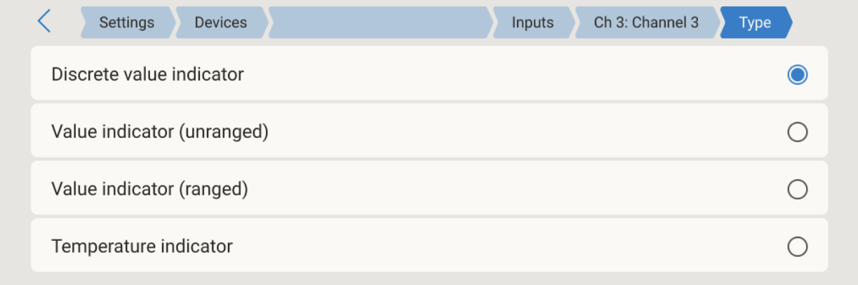

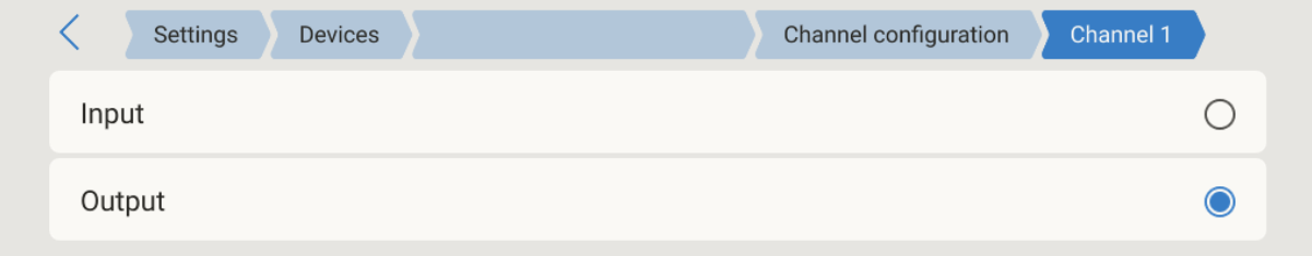

The layout of the Switch pane is determined by the configuration set in the Setup menu of each connected device. Controls and indicators can be grouped to simplify the interface. |
Supported devices for the Switch pane are configured through the device’s Setup menu. The following options are available:
For supported devices, a channel can be configured either as an input or an output. | ![]() |
Supported control elements:
Supported indicator elements:

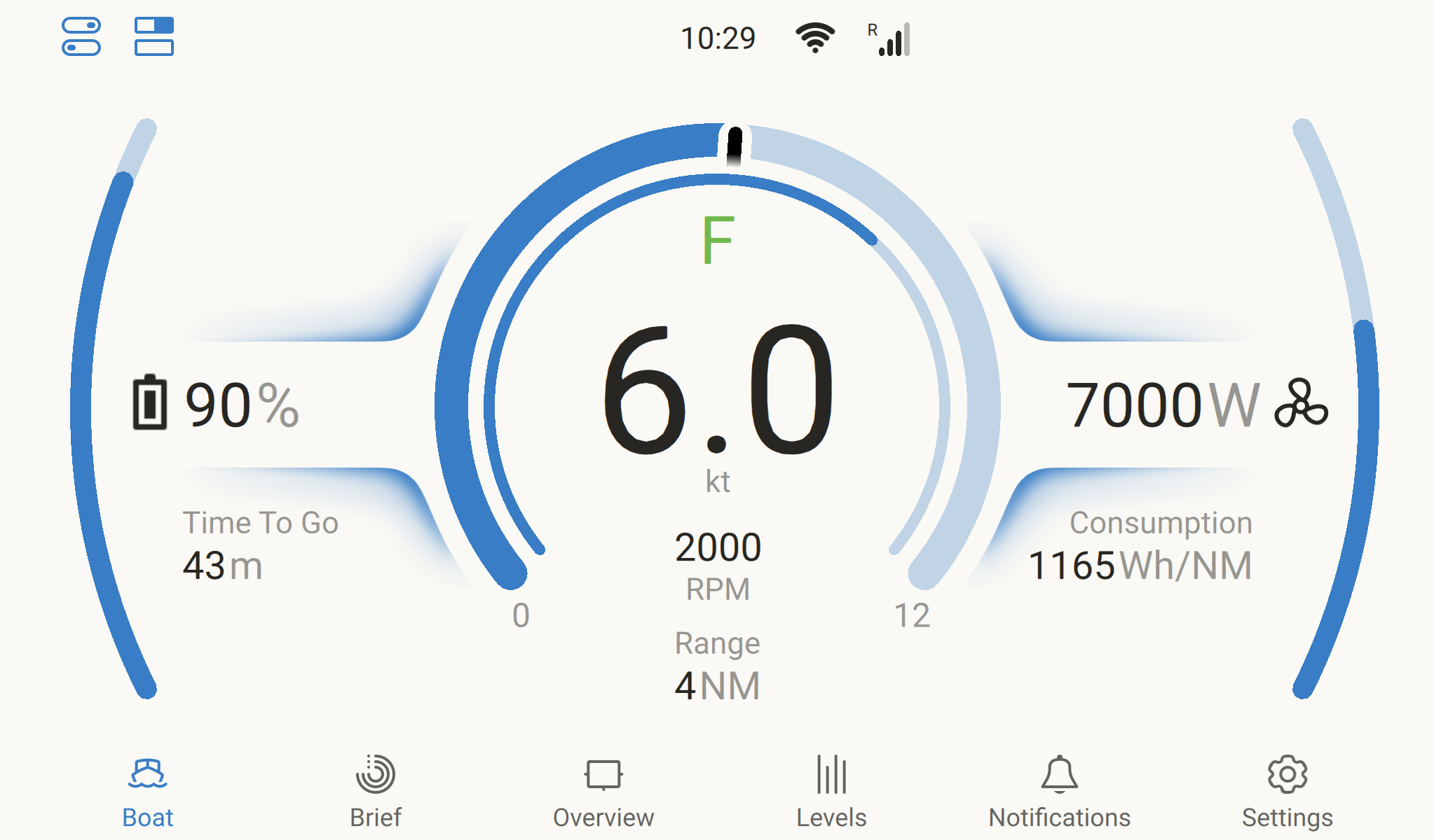

The Boat page is designed for electric and hybrid boats, combining battery status, engine RPM, GPS data and electric drive information on a single display.
Data can be received via NMEA 2000 or CANopen (VE.Can) for compatible electric propulsion systems, from a Victron SmartShunt configured as a DC Energy Meter – Electric Drive, or via custom Node-RED integration. Multihull vessels and dual-engine setups are supported, including configurable port and starboard electric drives.
The Boat page appears in the menu alongside the Brief and Overview pages, and can also be accessed remotely via VRM or on a GX display.
For a short introduction to the Boat page and its features, see the video below:

Example 3: NMEA2000-integrated propulsion engine
For propulsion integrated via NMEA 2000, the Boat page shows:
Example 4: NMEA2000-integrated propulsion engine with GPS
Same as Example 3, plus GPS. The Boat page shows:

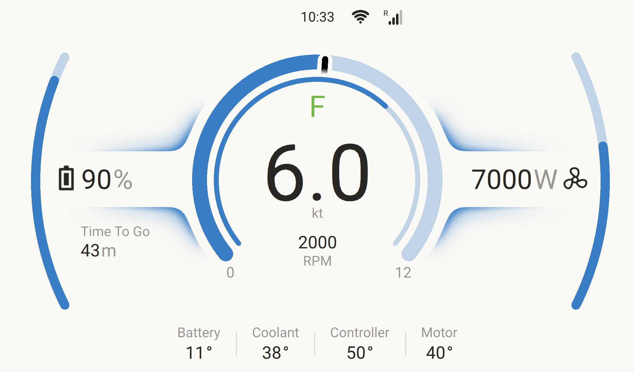

Example 5: Temperature monitoring
Temperature monitoring is disabled by default. Go to Settings → General → Display & Appearance → Boat page and enable Show temperatures.
Example 6: Range & Consumption
A connected GPS and E-drive is requires to display range and consumption.

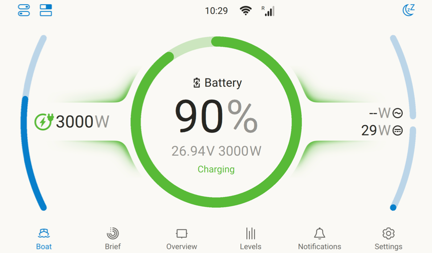

Example 7: Charging state

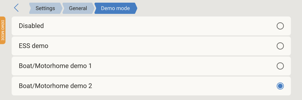

Open the Remote Console, or use the built-in display (GX devices with a screen).
Navigate to Settings → General → Demo mode.
Select one of the available demos:
ESS demo: A grid-connected Energy Storage System: inverter/charger, MPPT solar charger, PV inverter, grid meter and battery monitor.
Boat/Motorhome demo 1: A mobile installation: inverter/charger, MPPT solar charger, two batteries (house and hydraulic/bow thruster), four tank senders (fresh water, fuel, oil, black water) and a wireless temperature sensor.
Boat/Motorhome demo 2: A more extensive mobile installation: inverter/charger, alternator, MPPT solar charger, multiple batteries, fresh water, diesel and black water tanks, and several temperature sensors (fridge, freezer, cabin, outside).
The simulated devices then appear in the device list and on the overview pages, with live, continuously changing data. An indicator in the top left corner shows that the GX device is in demo mode.
To stop, set Demo mode back to Disabled.
