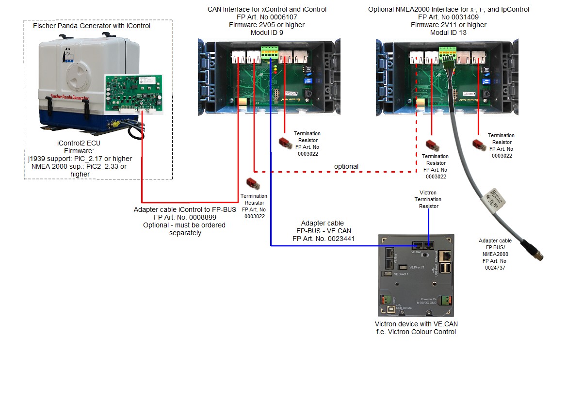

Besides driving the internal relay, the auto start/stop functionality can be also enabled to directly control supported Fischer Panda generators. For more information on how to connect Fischer Panda generators, see Cerbo GX & Fischer Panda generators.
There are many variations on the generator side for wiring and you should also consult your generator manual or supplier regarding their remote wire start configuration.

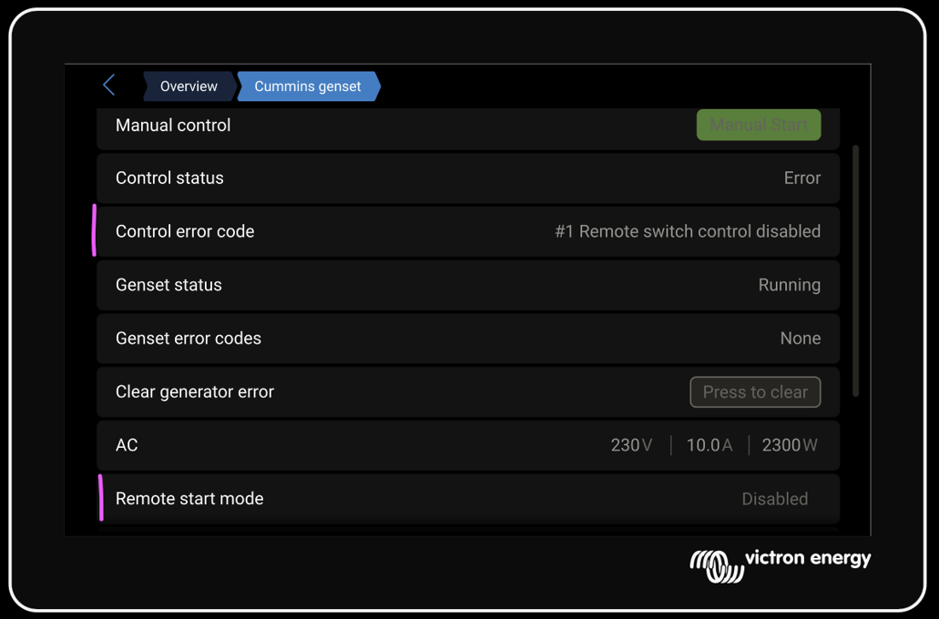

13.7. Troubleshooting
Fischer Panda: Generator does not start and "Remote switch control disabled" error is show
Enable the “AutoStart” function in the Fischer Panda control panel.

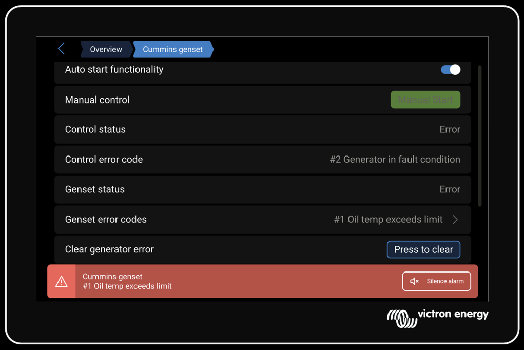

Fischer Panda: Auto start/stop function has stopped working after an error
Make sure that the issue is solved, then clear the error, and the auto start/stop function will work again.
