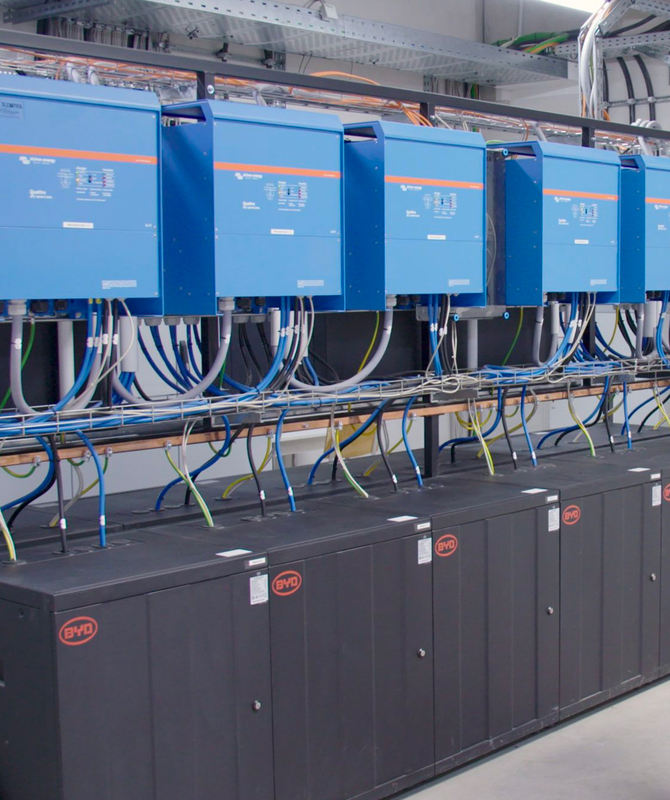

Lithium: 7x 13,8kWh BYD B-Box Lithium battery modules: This third party Lithium battery bank can provide ±80kWh of usable energy, enough to power the night-time loads and is ready to assist with peak-demands or support the solar array on cloudy moments during the day. Due to it’s fast charging capabilities the bank can be fully charged in ±3 hours by the solar array, or by the generator(s) when battery parameters get critical due to longer periods without sufficient solar yield.
The battery banks parameters are exchanged to perfectly work together with the wider Victron Energy system through a GX-device, which is required to manage charge and discharge limits, to exchange error codes and state of charge information. A GX device comes with the added advantage that this data also becomes available for monitoring in our free Victron Remote Monitoring (VRM) portal.
