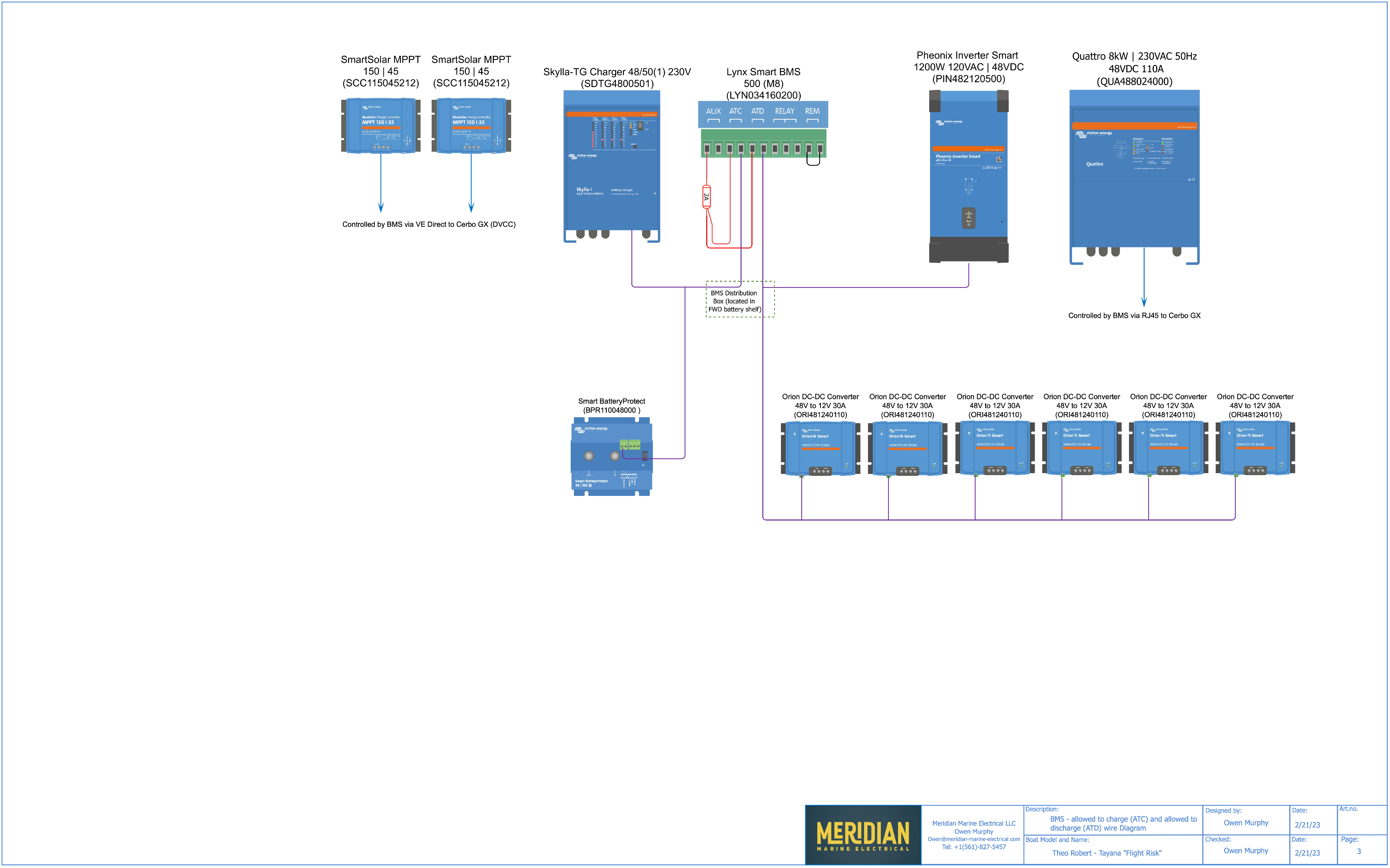

With any electrical overhaul, an electrician must first begin by deciphering the ship owner’s needs. How does the owner plan to use the boat? Appropriately sized battery banks, chargers, inverters, generators, distribution blocks, circuit protection, wire runs, diagrams, and equipment layout can then begin. I had already done much of the design in Saint Augustine prior to arrival but things change constantly and much of the puzzle can hardly be worked out without actually being aboard the project itself. Luckily, this was not Huffman’s first refit. The practice of ship overhaul is actually a bit of an ongoing hobby for him. Well educated in ship systems, he already had an idea of the equipment he wanted and we were thus able to corroborate a plan:
  • ●  48V DC LiFePO4 house bank capable of inverting all the power needed for the boat – Huffman client was avid about a 48V bank because he also purchased a cutting edge Integral Alternator which puts out a whopping 9KW but at 48V.
  • ●  A massive 48V to 12V converter system to step power down power from the batteries to nearly all of the ship’s 12V loads
  • ●  Charging via 2200W of solar – client was having an arch built on the stern to hold two 440W panels. Three more would be going up once the hard Bimini was constructed.
  • ●  Installing a 9KW Integral alternator on the engine that would replace the ship’s old generator
  • ●  230V 50Hz AC power distribution throughout – running outlets, microwaves, Starlink,washer/dryer, convection over, battery chargers, inverters, air conditioning, heating, etc. – Client spent a lot of time in Europe and 230V AC was his preference for utility and efficiency
  • ●  120V 60Hz AC power as a separate circuit that would power another set of outlets for American appliances
  • ●  A 24V DC battery bank with charging in the bow for windlass and bow thruster
  • ●  A 12V DC bank that would start the engine, run 8 powerful electric cockpit winches (2 new to be installed), and act as an emergency 12V load bank via parallel switching
  • ●  A DC to DC charging system that allows the boat owner to charge his electric dinghy directly from the ship’s house bank via plug-in at the stern.
  • ●  A state of the art marine grade Starlink system with boosters for wireless internet
  • ●  A complete Victron Energy – Cerbo GX network system
  • ●  A custom built navigation area that would include all the instrumentation and screens for all of the different systems of the boat in addition to VHF, chart plotter, AIS, etc

To say Huffman was a fan of Victron Energy would be a serious understatement. If Victron made the component, Huffman wanted it. So much so that we even installed blue LED lighting in the machine room to give ambiance to Victron’s signature blue boxes. Eight 24V 200Ah Victron Smart LiFePO4 batteries placed in four series pairs would make up the house bank with some 9,600KW of power. AGM batteries would make up the separate 12V and 24V banks used in starting the engine, running the eight electric winches, bow thruster, and windlass. I laughed at the numerous different voltages Flight Risk would contain. When you add the 230V and 120V systems to the list, the vessel Risk would have five different voltages pushing current throughout the boat, a big jump considering most boats this size average only two or three.
Fitting all the wire into the new built machine room turned out to be the greatest challenge of the ship. It had to look clean and too many wires can often make the process difficult. With our combined brain power we decided that Rocky would construct a few large panels. Each panel would sit off the wall on 3” spacers that provide the space I needed to conceal all the conductors behind the instruments for a more flush and clean look. Entering the machine room would feel like popping the hood of a Ferrari by the time we were through with it.
Often, one of the creative challenges of a rewire this large is coming up with new cable runs that can accommodate for the amount of conductors that have to be installed. Most of the old wire routes were ridiculously indirect or unusable from being sealed up by the original builder. You heard me right, I said sealed up!
Anyone who has worked in the marine industry or even owned a boat is familiar with this completely absurd and traditional practice. A grievance that I imagine goes back to the age of Vikings, we boat technicians are in a constant state of displeasure with builders who carelessly construct ship bodies around equipment with little to no concern for their replacement or serviceability. One in truth has to push the limits of contortionism and spelunking, unafraid to lose skin or scalp, glass fibers knifed into fingernails. We dangle upside down, one arm behind our backs, hose clamps buried in our ribs, into dark voids with live wires and soggy pits of mystery bilge ooze all while tooling with the utmost precision. This is all because serviceability gets a back seat when boats are made. Living space wins over workable space every time. I could most easily rant for another page or more of this maddening modus operandi but I think I will spare the reader my monologue.
With Flight Risk, at least half of the original wiring was sealed into the hull walls behind permanently installed paneling, much of it glassed over. My fish tape was fruitless. We could literally dismantle a major portion of the vessel or come up with new wire routing. Fortunately, I was able to squeeze much of the cabling into the ship’s ceilings, but most of it I had to snake elsewhere. Ships of this size do not have crawl spaces like homes. We technicians are usually left to install wiring, plumbing, and equipment through permanently mounted ship furniture.
On Flight Risk, conductors would snake off into so many three dimensional turns, I could end up using forty or fifty feet of wire to reach a component that was only some fifteen feet away. That might sound like no big deal until one realizes that it is not just one wire to be run, but possibly twenty, fifty, or a hundred through that same shared path. Each loom has to look clean and sharp, properly tied in, protected from chafe, scrutinized for parallel form. DC bundles need to be isolated from AC bundles, consideration for thermal buildup and corrosion has to be carefully accounted for. Proper cable sizing is an absolute must. To top it off, there is my own personal standard, serviceability for the owner or next technician.

Having so many different voltages also presented some challenges. Flight Risk’s new operating voltages are both European and American. Nearly all boats use pass-through power from shore when plugged in. This permits AC power to run appliances directly from the grid. Because my client plans to travel to Europe and the USA, we had to design the system so that shore power would travel directly into a 50A – 48V Skylla that can accept 230V 50hz or 240V 60Hz interchangeably without any issue or manual switching. The Skylla solely charges the 48V bank which then sends power out to everything else. The 8KW-230V Quattro Inverter/Charger, the 1600W-110V Phoenix Inverter, the two different battery chargers that power the 12V and 24V banks, and the six 48V to 12V DC to DC Converters – Orions, which send power to the 12V Panel. Despite this clever engineering, shore power was in fact an auxiliary need. Huffman really plans to run the boat almost purely from the sun and with his state of the art and Integral Alternator.
