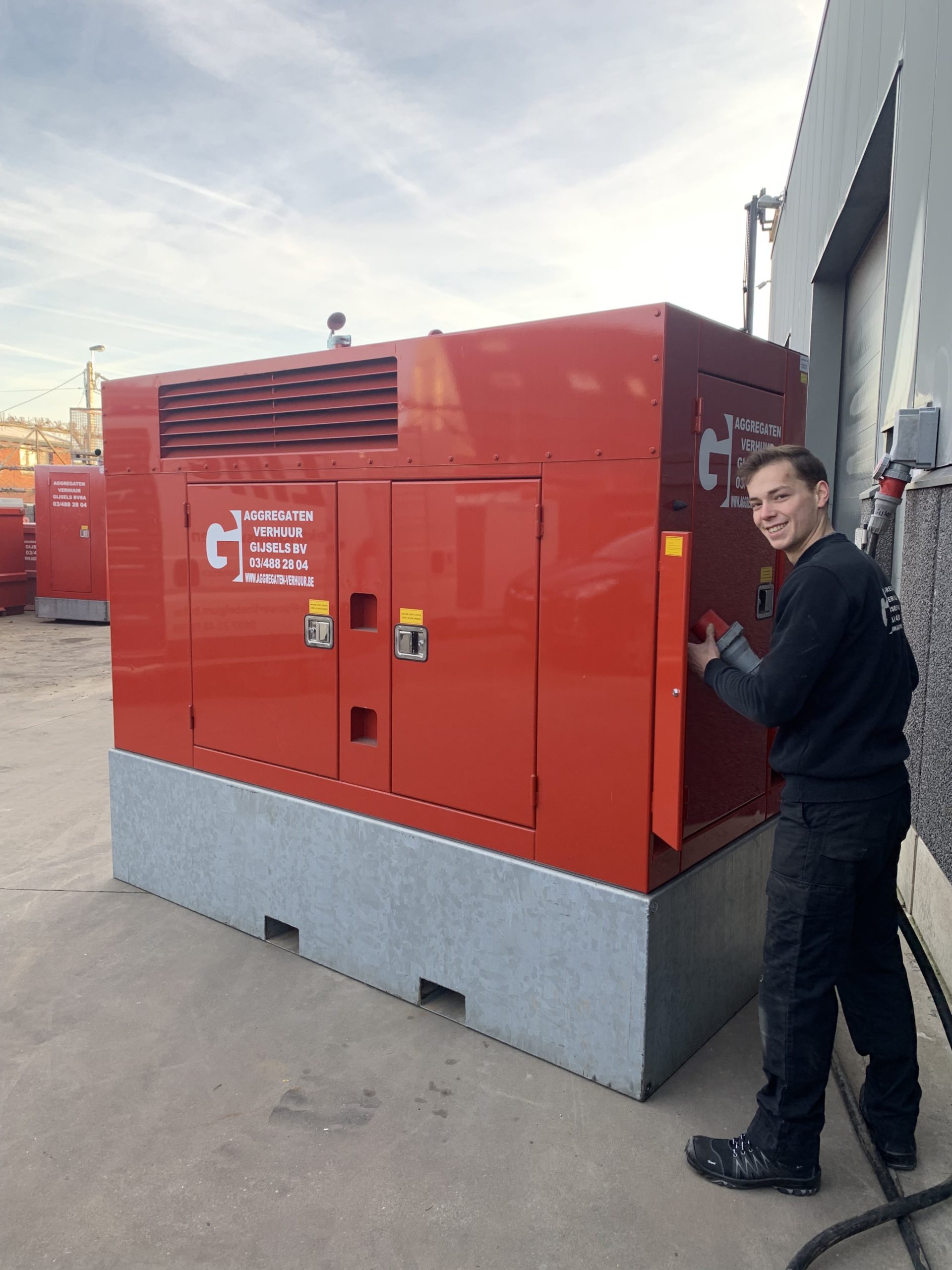

Until recently all the electricity generated during load-testing was dissipated as heat by a ‘resistance’ bank.  Elias Gijsels – the son of the company’s owner – happened to be working on a sustainability project at school and suggested the test-energy was stored and used to run the workshop and offices. He helped design and install a system – which includes a PV array – which allows the company to be power self-sufficient.
Elias Gijsels prepares to store the energy produced during product testing.

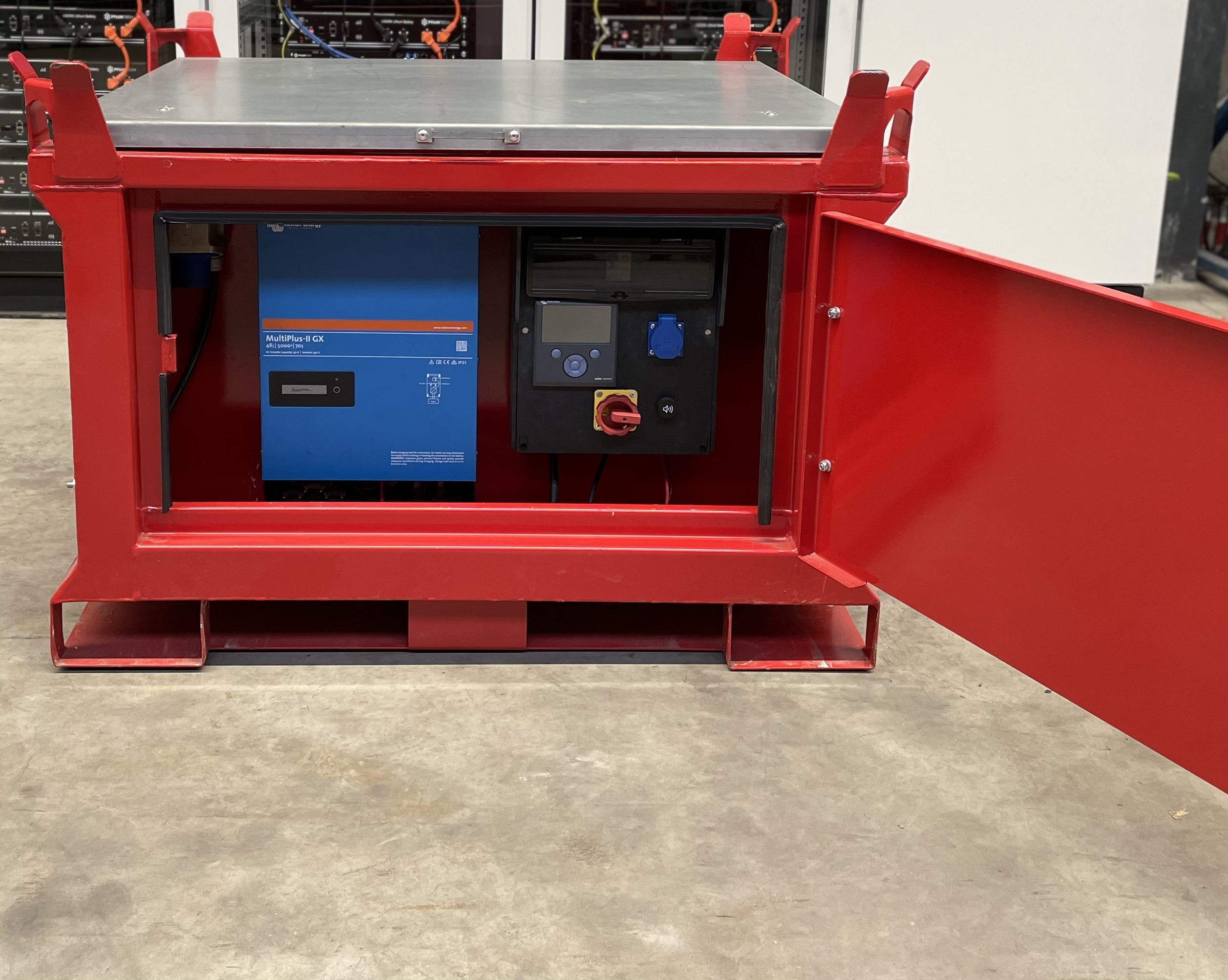

In order to comply with the National Grid power regulations in Belgium, Electrical Engineers Ysebaert.be – who advised and supplied the system components – incorporated a Break before Make transfer switch as seen on the system schematic below. This ensures that the private power system will not become grid-connected.
The system benefits from a solar array with PV Inverters maximising daytime consumption, and it is the company’s expectation to be energy self sufficient even when they have installed an EV charger for staff use.
The three phase system employs 3 x Quattro 15kVA Inverter Chargers together with Pylontech storage and is controlled by a Cerbo GX. Also in the build:
