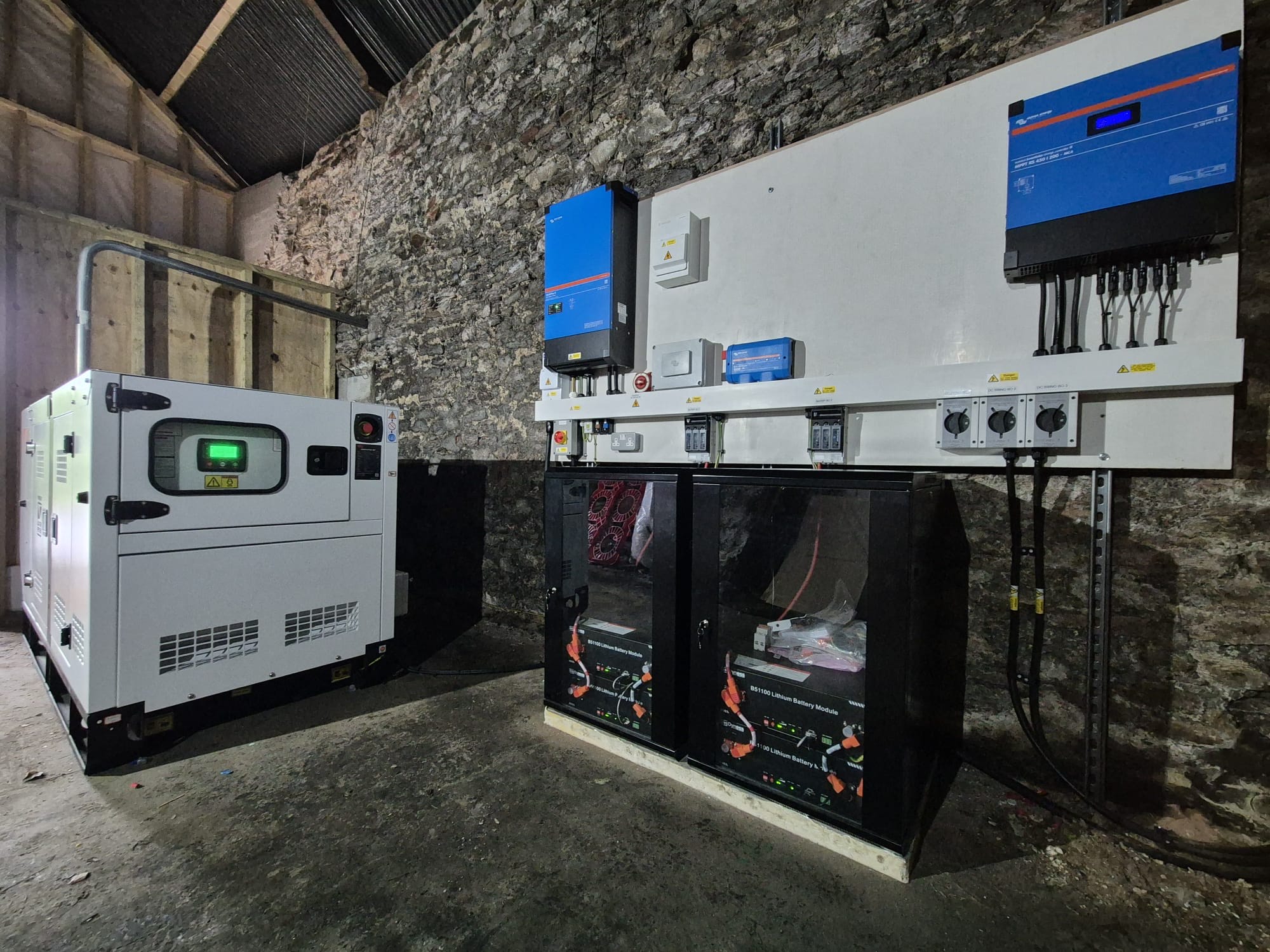

The new off-grid 15kVA state-of-the-art solar energy installation was built by Off Grid LiFe who understand and specialise in off-grid energy installations covering the south west of the UK. This installation comprises:
15kVA MultiPlus-II Inverter/Charger is powerful enough for any of the pub’s outdoor events.
SmartSolar MPPT RS 450V 200A solar charge controller harvests energy from the nearby ground mounted solar array with minimum cable losses.

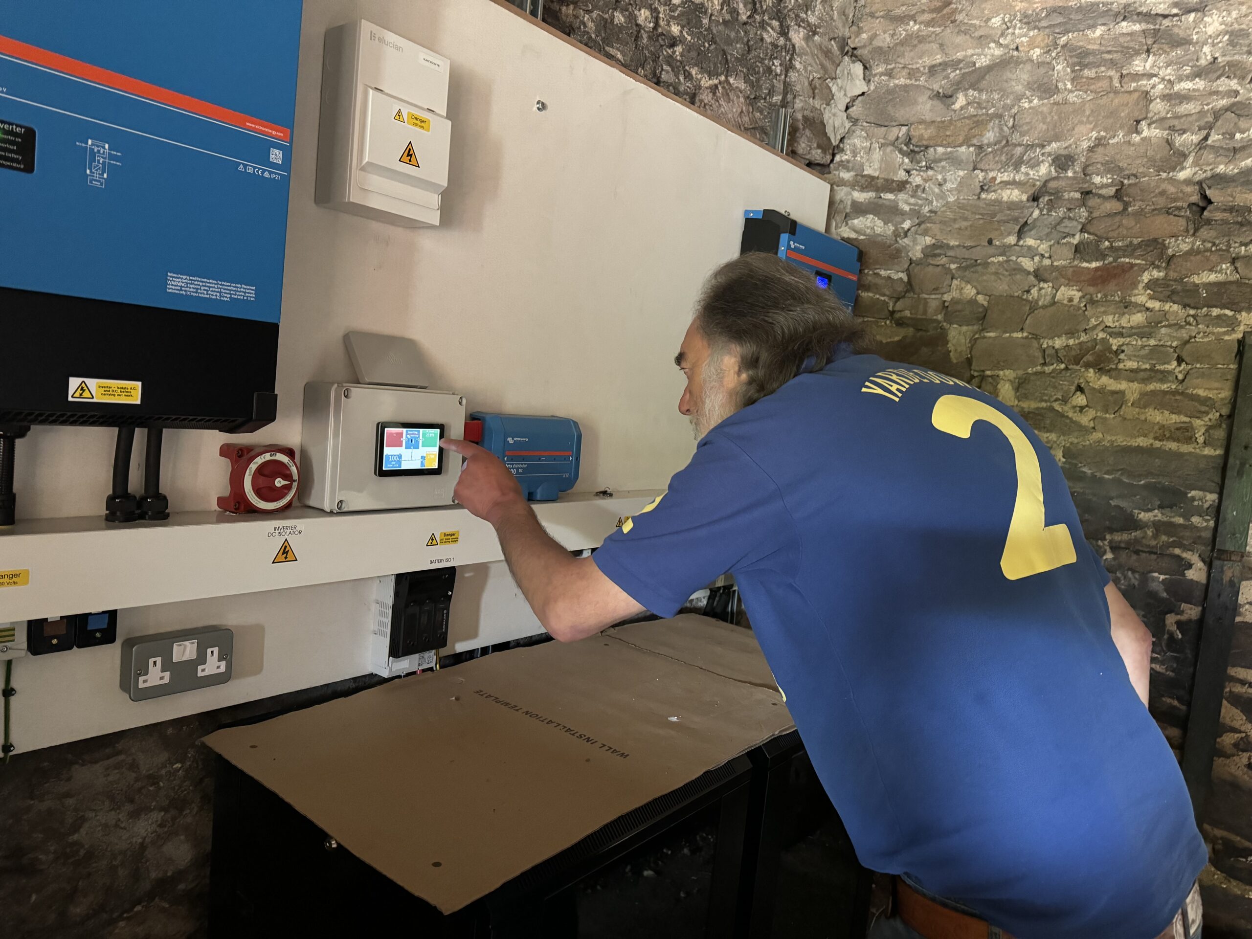

A Cerbo GX communication centre harmonises all devices, providing remote engineering access and many user features such as generator auto-start triggered by low-voltage or low-state of charge. The system can be interrogated by the GX Touch 50 user-interface display.
Lynx Distributor – DC busbar with monitored fuses allows for neat installations.
4 x Dyness 5.12 kWh LiFePo4 lithium batteries.
Lister petter 16kVA backup generator.
24 x JA solar panels of 420W each for a total output of 10.08kW mounted on seasonably adjustable ‘Cornish Rocker‘ frames. Using an allen key the south-facing panels can be angled to the sun’s zenith for optimal solar harvest – six or eight times a year, ideally.
A 16 kVA backup generator guarantees energy security, summer and winter alike, and allows for mini-music festivals to take place providing power for lighting, amplifiers, and mobile catering equipment.
