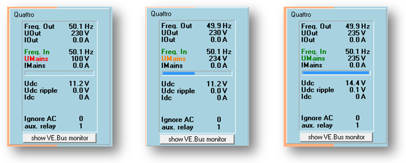

VEConfigure now indicates why grid/generator is rejected
With Multi firmwares xxyy460 and up, VEConfig will now indicate why the AC Input is rejected and will also show an indication of the remaining waiting time.
(After the waiting time the unit will connect to grid provided that there is no assistant which prevents the unit from connecting to grid and that the required relay test is performed.)
