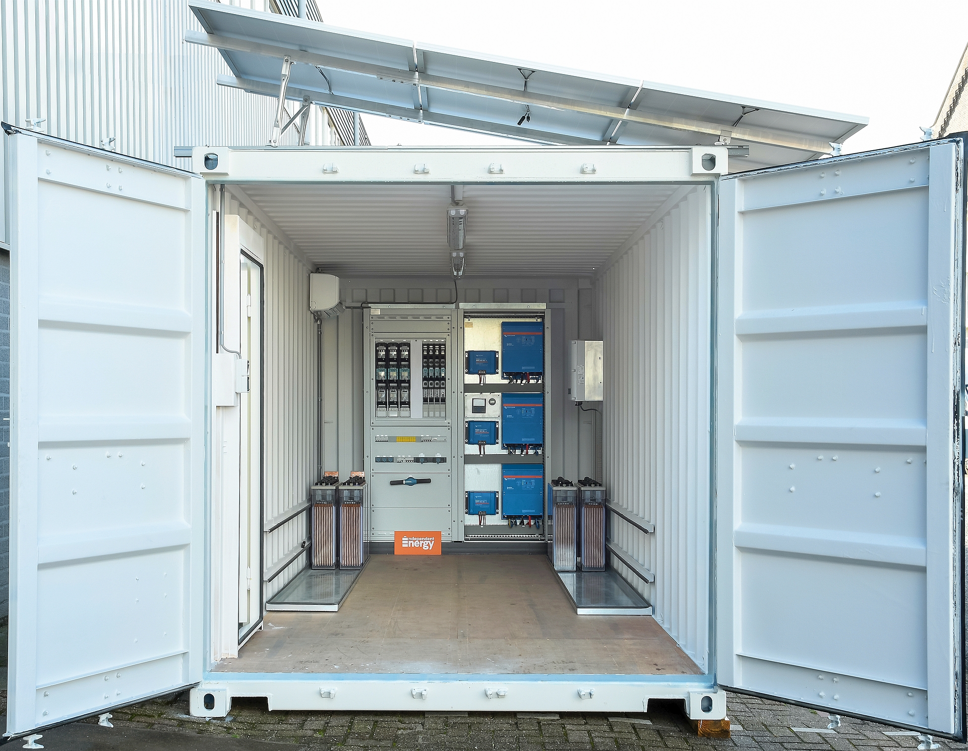

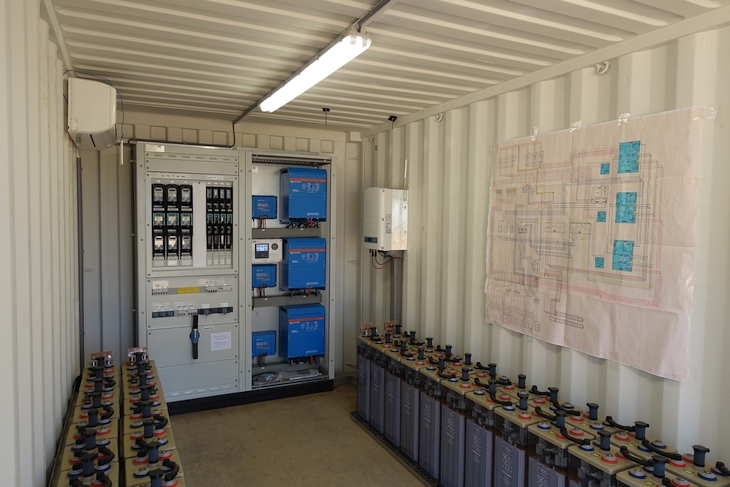

At their assembly line, in the Netherlands, Independent Energy designed, built and programmed a containerised 3 phase, 30kW off-grid system consisting of 18.7 kWp PV and 2,640Ah, 48V OPZS battery storage. In choosing Victron Energy components for the build, the following were installed in the container:
- 3 x BlueSolar 150/85 MPPT Charge Controller
- 3 x 10kVA Quattro Inverter/Charger
- 1 x Color Control GX
- 1 x BMV-700
Utilising integrated PV panels on top of the container and a special insulation coating along with an air conditioning unit inside the container – the batteries and equipment are all kept at the correct temperature, which ensures a long lifetime for the system.
To deal efficiently with the higher load during the daytime an AC connected SolarEdge Technologies Inc inverter was also installed.

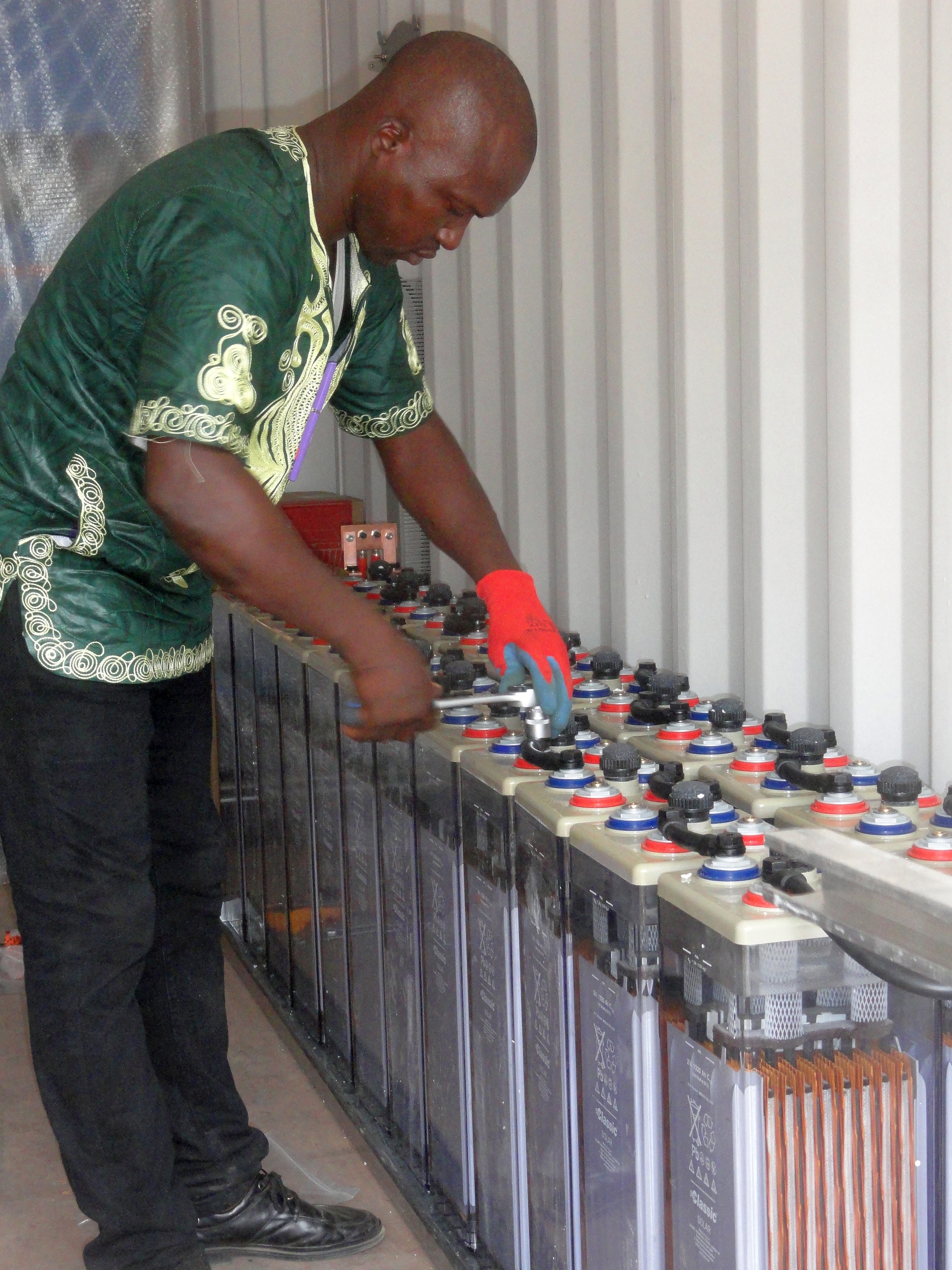

Upon completion and testing of the system in the Netherlands, all batteries, PV and mounting materials were loaded inside the container and shipped to Sierra Leone.

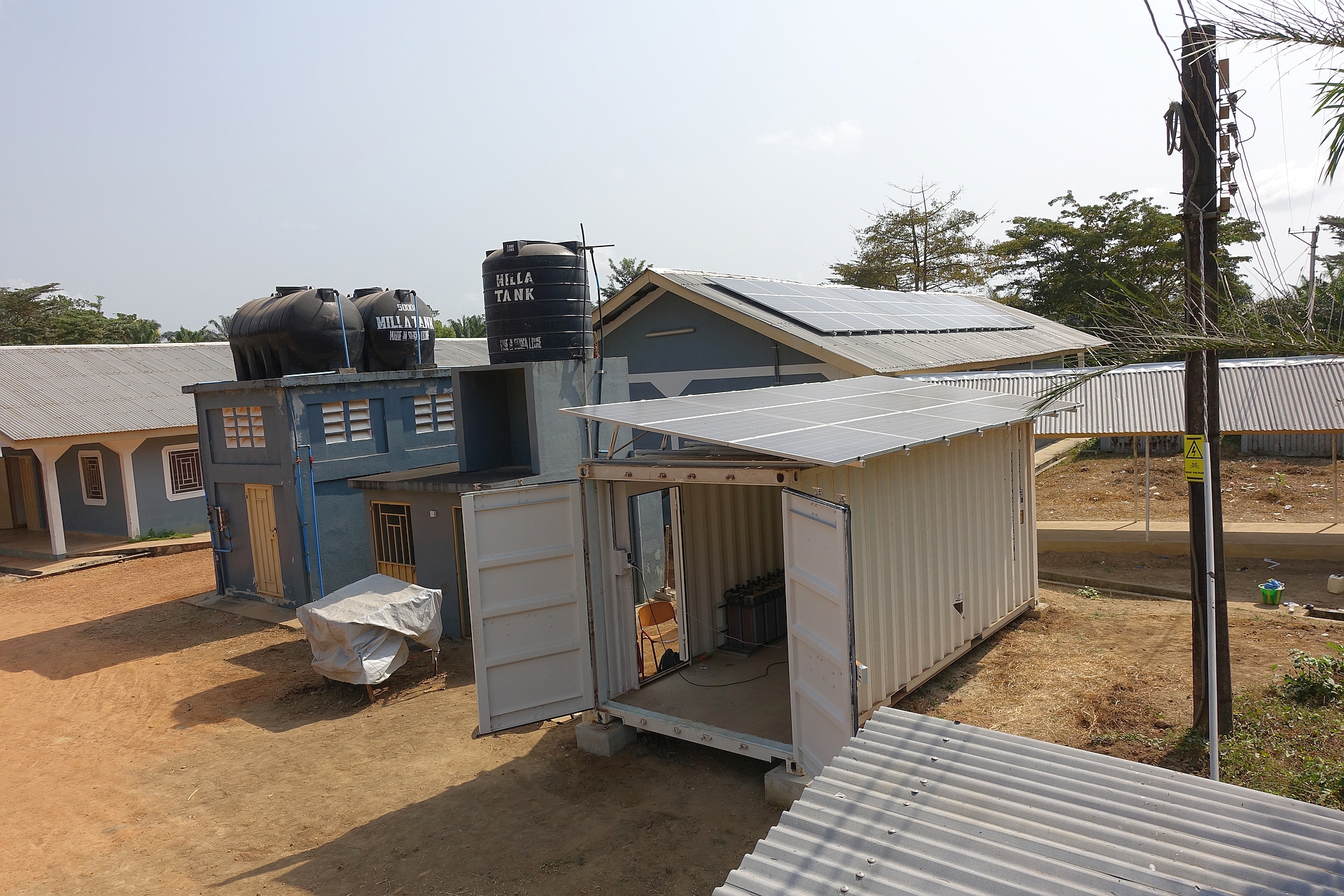

Upon completion the Independent Energy technical team followed the container and several weeks later installed the PV panels and connected the energy container to the hospital grid.
