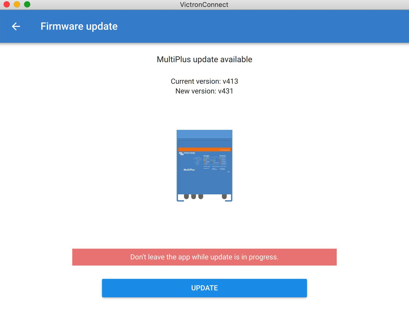

Once you are connected to the unit, enter the settings, select the Product Info from the top right dots.
VictronConnect comes with the most up to date versions of the firmware already, so an internet connection is not required.

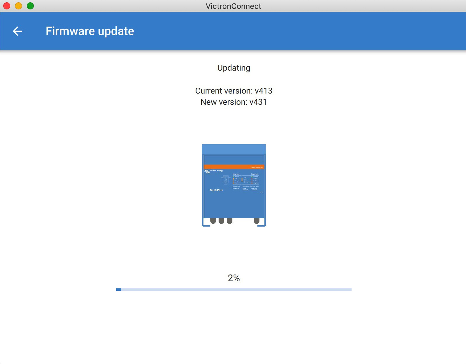

Click update and then do not touch either device until the firmware update is complete.
