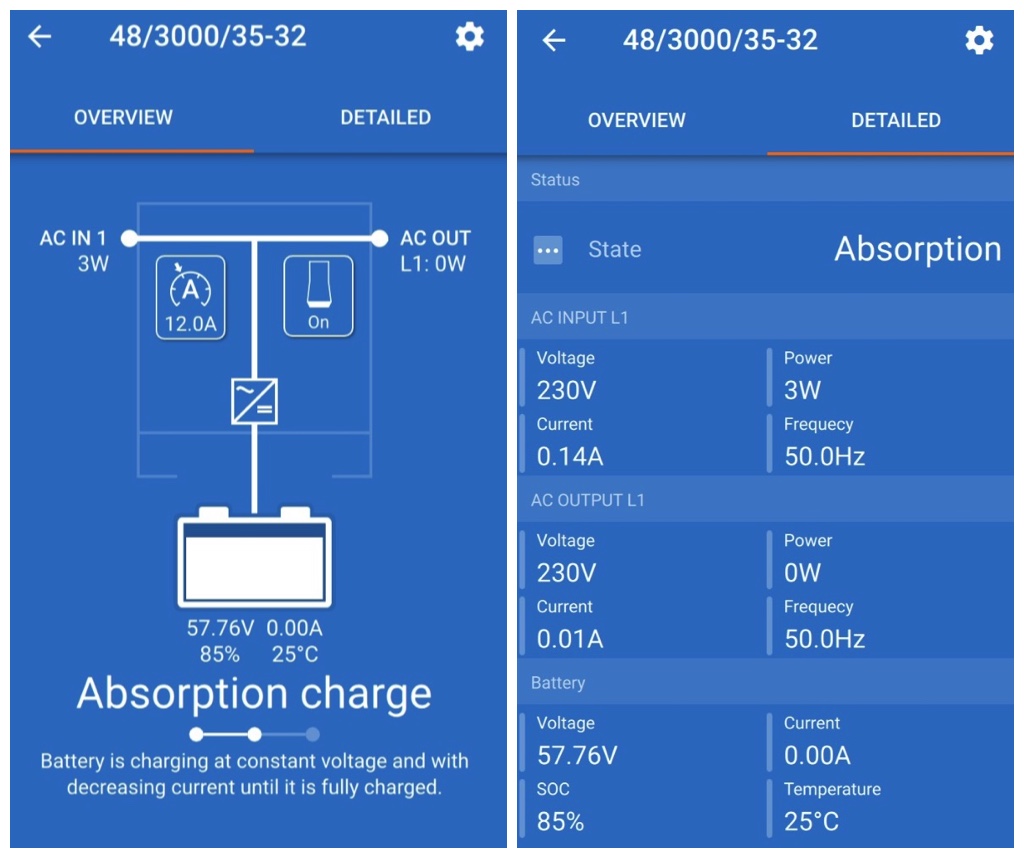

8. Status Mode
In this section:
Status is available on Windows, macOS, Android and iOS operating systems.
You can access Status by either the MK3-USB or via Bluetooth with the VE.Bus Smart Dongle.
From the status window it is possible to switch the device On / Off / Charger Only from the switch button icon. It is also possible to quickly adjust the AC input current limit (if the overruled by the remote panel setting is enabled).
For more information about this mode, and making the connection with the VE.Bus Smart Dongle, please watch this video:
