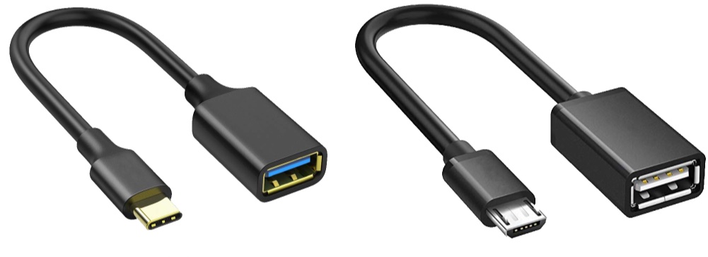

Connecting with an Android device will require an additional OTG cable to convert the USB cable from the MK3-USB to the data port on your device (typically micro-USB or USB-C).
This OTG adapter is not provided by Victron and will need to be sourced seperately.
